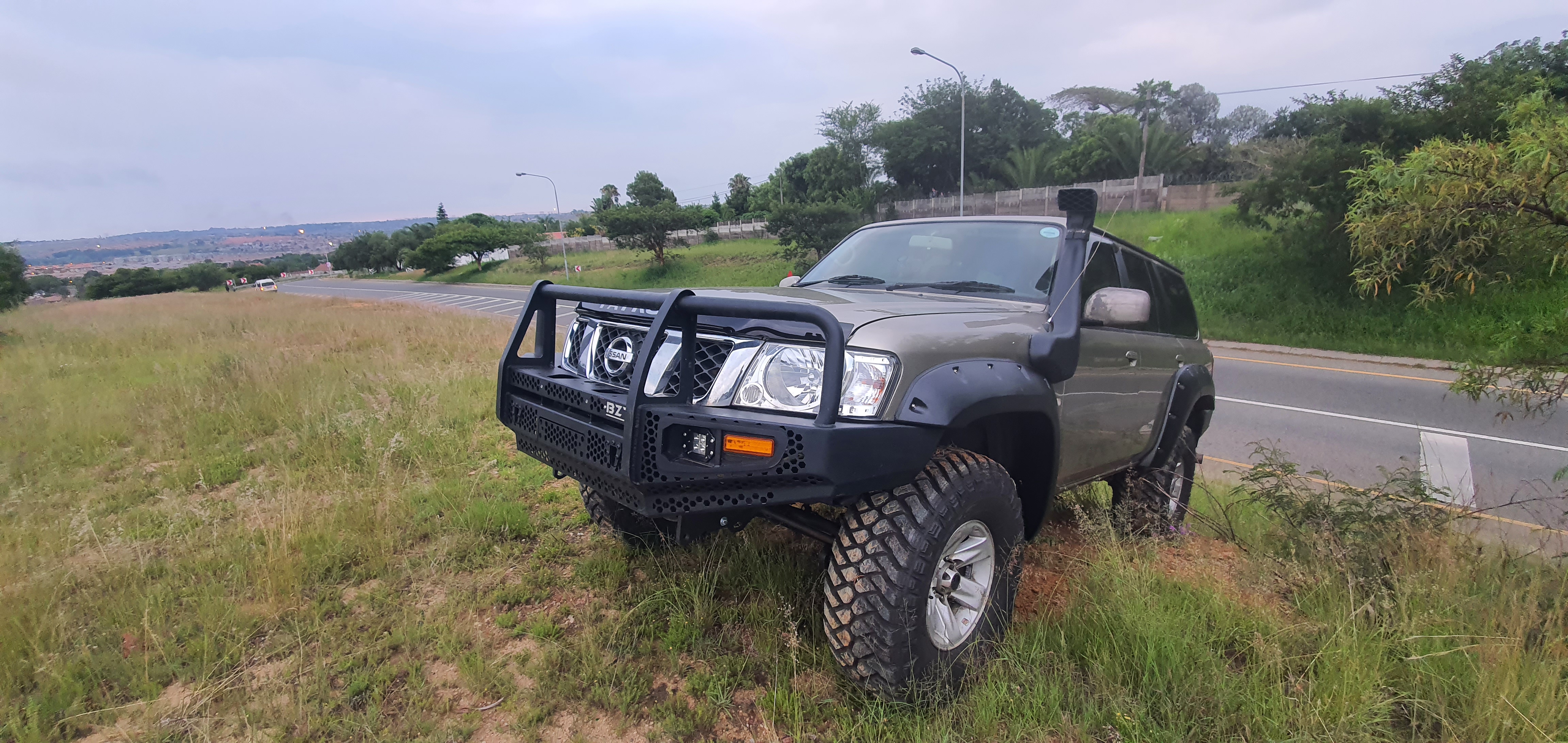

Re: Steel wagon rims and 35s
i run the 315 75 16 on both
my patrols at the moment ...all on 8j rims the maxxis 772 works great

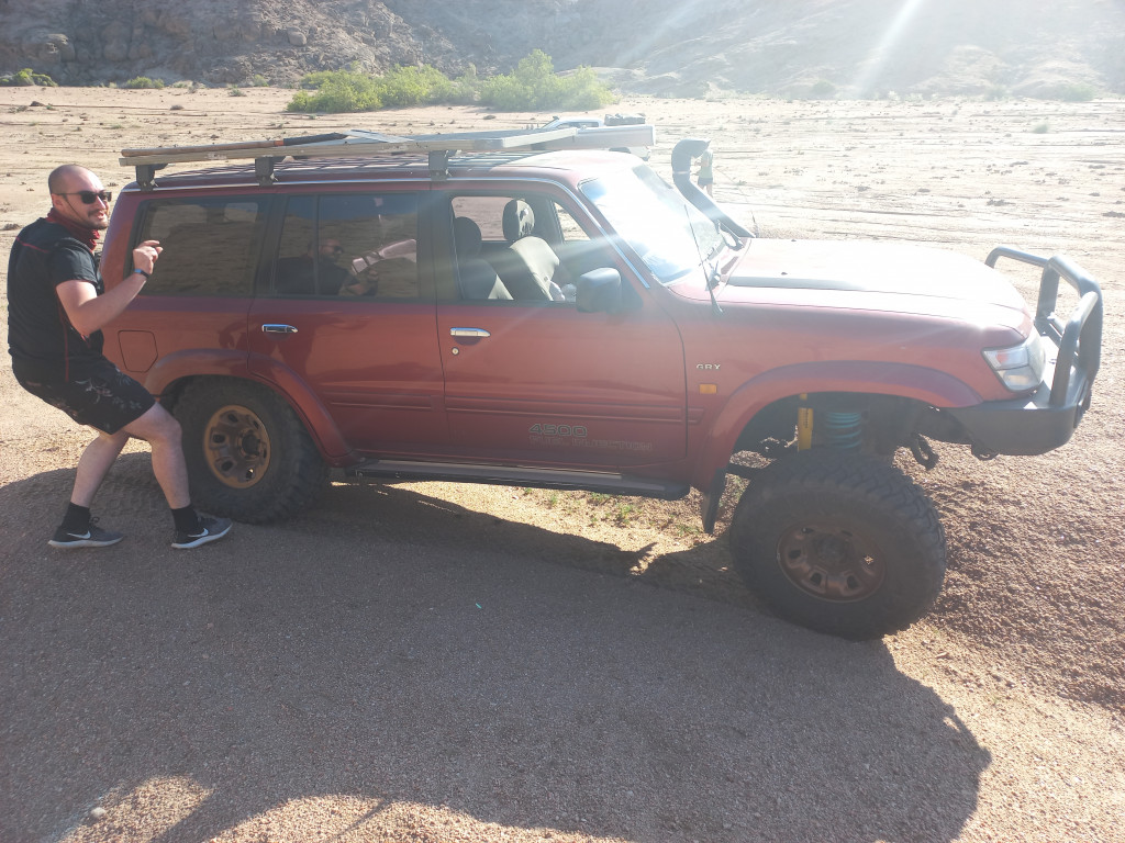

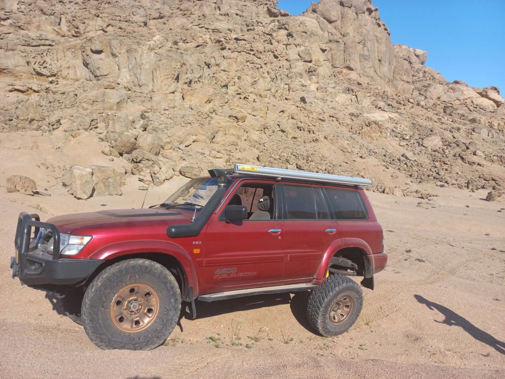

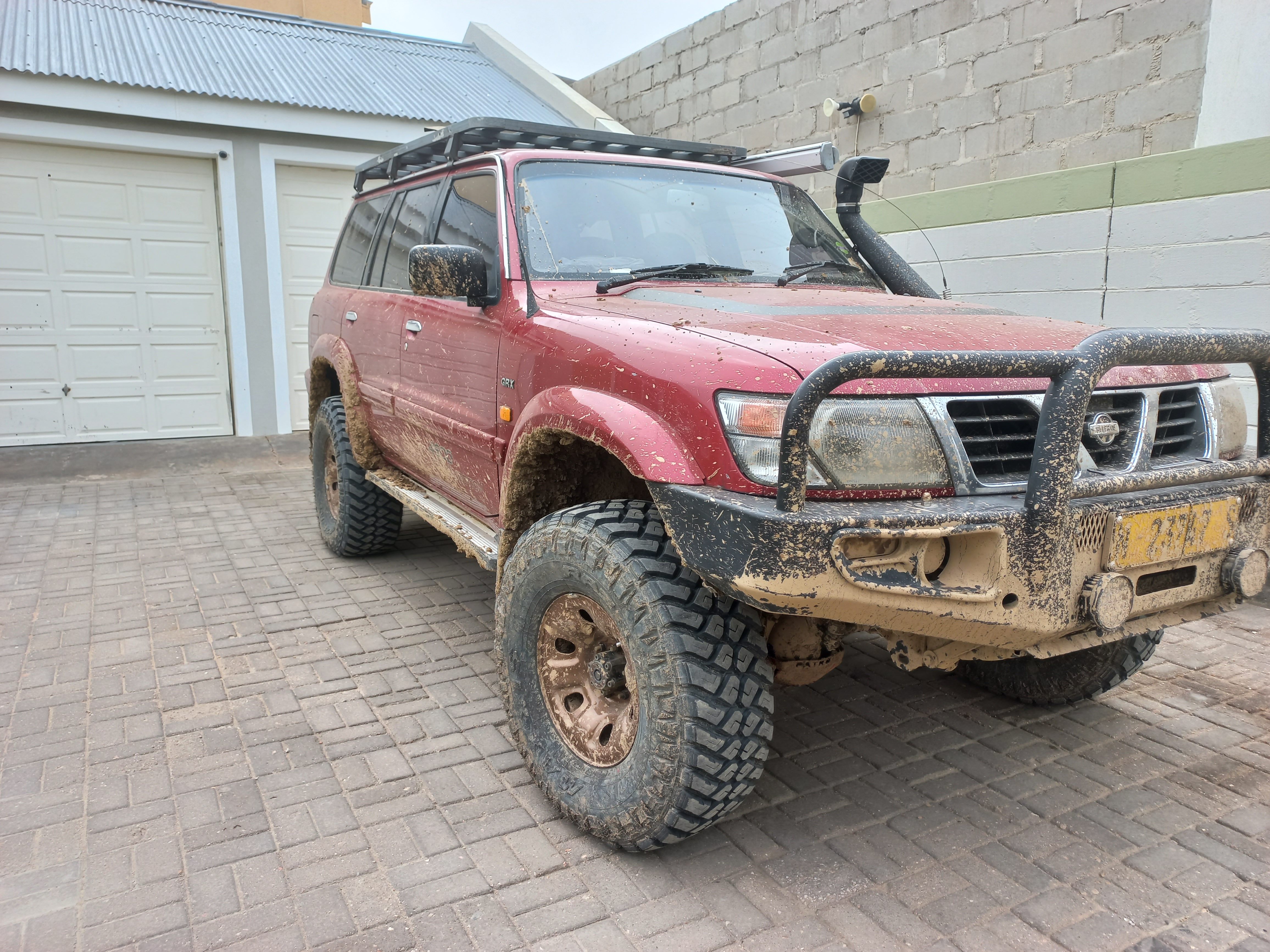

I am not exactly sure where to post this, but here it goes.
So I bought old steelies from a later model patrol, and had them painted. Everyone is running black rims these days, and I was looking for something different- not that a red patrol isn't different by itself.
I had however a very real issue gettiing hold of 35" tyres. Funnily enough, I could get 37" GY wrangler for cheap, as it was eating up a guys rubicon...but thought that then I would have to change diff ratios again.
With the awesome assistance of our own Tinus and the MD of Maxxis that probably gave the best customer service I have ever experienced, I got some Maxxis 772s. Honestly, If I didn't replace my bakkies tyres 3 weeks prior I would definitely gotten Maxxis for it as well. I will try and support them as they have supported me.
So yes, the suspensiom, rim and tyre combination is working brilliantly. I am honestly extremely happy. Just want to bring the colour of the rims in somewhere else on the vehicle.
Thanks for this forum and the great people on here
