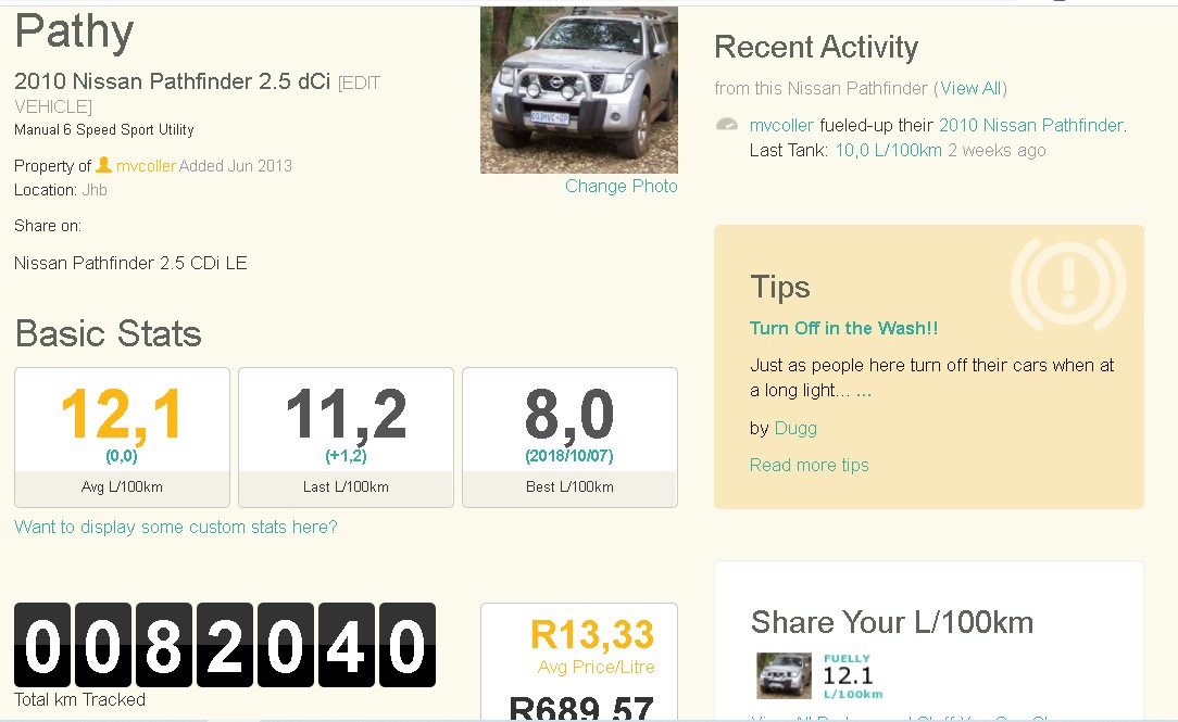

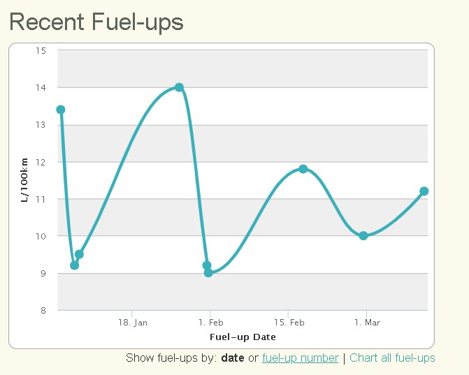

One of the best vehicles I have ever owned, luxurious, fast, comfortable, light on fuel and very spacious. I am tall, so my seat is far back. I have two adult sons are 6ft 3in and they both have sufficient space in the rear (centre) seat. As with all 7 seaters, the rear seats are for children and smaller adults. The floor is totally flat if all the rear seats are folded flat, and it gives you 2m of flat floor. The rear door window open upwards independently, so I can carry 4m long things easily....
My 2010 YD 25 has just clocked over to 200k km. In and around town I get 12lt per 100, if in bad traffic and I put foot, I may drop back to 14lt per 100km. On the open road with the cruise control set to 120 (about 115 GPS speed) I get anything from about 8 to 9lt per 100, and at 10kph lower speed, this can go as low as 7.5lt per 100kph
I use it as my daily vehicle, my Patrol is only for safaris and camping trips.
You will love it, much more nimble than the Patrol, and probably more space inside as well. I will not easily swap it....
The 4x2 and 4x4 options are selected via a rotary dial on the console, and there are 4 modes: 4x2H, Auto (automatically selects between 4x2H and 4x4H, depending on road surface), 4x4H and 4x4L(can only be selected with vehicle in neutral). My is a 6 speed manual model. It has traction control, which unfortunately turns off when going into 4x4L. It is capable enough, but I raised mine 50mm and fitted a front locker (www.Lokka.com), and is now unstoppable on most trails. it is however a LOOOONG vehicle. I often do garde 4 trails with it, but the length can be a hinderance sometimes on grade 4 trails. It does grade 3s with ease, but remember it has a front locker now (Can get one of those for about R8k via courier).
It was built as a competitor to the LR Discovery and the Prado, and I think it compares very well with them, certainly more reliable than the LR and a lot more classy that the Prado... (In SA they are the only 3 vehicles in that class)
The 4lt V6 Petrol version is a lot heavier on fuel, possibly nearly the same as the 4.8 Patrol. The 2.5 is powerful at 140kw and 450nm of torque, tows extremely well and even uphill, you can leave it in 6th. Unlike other diesels, it easily revs to 4500 or even 5000rpm, though I rarely do it, it really make oodles of torque low down, so much so that if you hoof it around a corner, it wheel spins and traction control comes in to limit it.

- Pathy Fuel consumption last 10 fill-ups.jpg (43.2 KiB) Viewed 5876 times
- Pathy Fuel consumption.jpg (123.13 KiB) Viewed 5877 times
