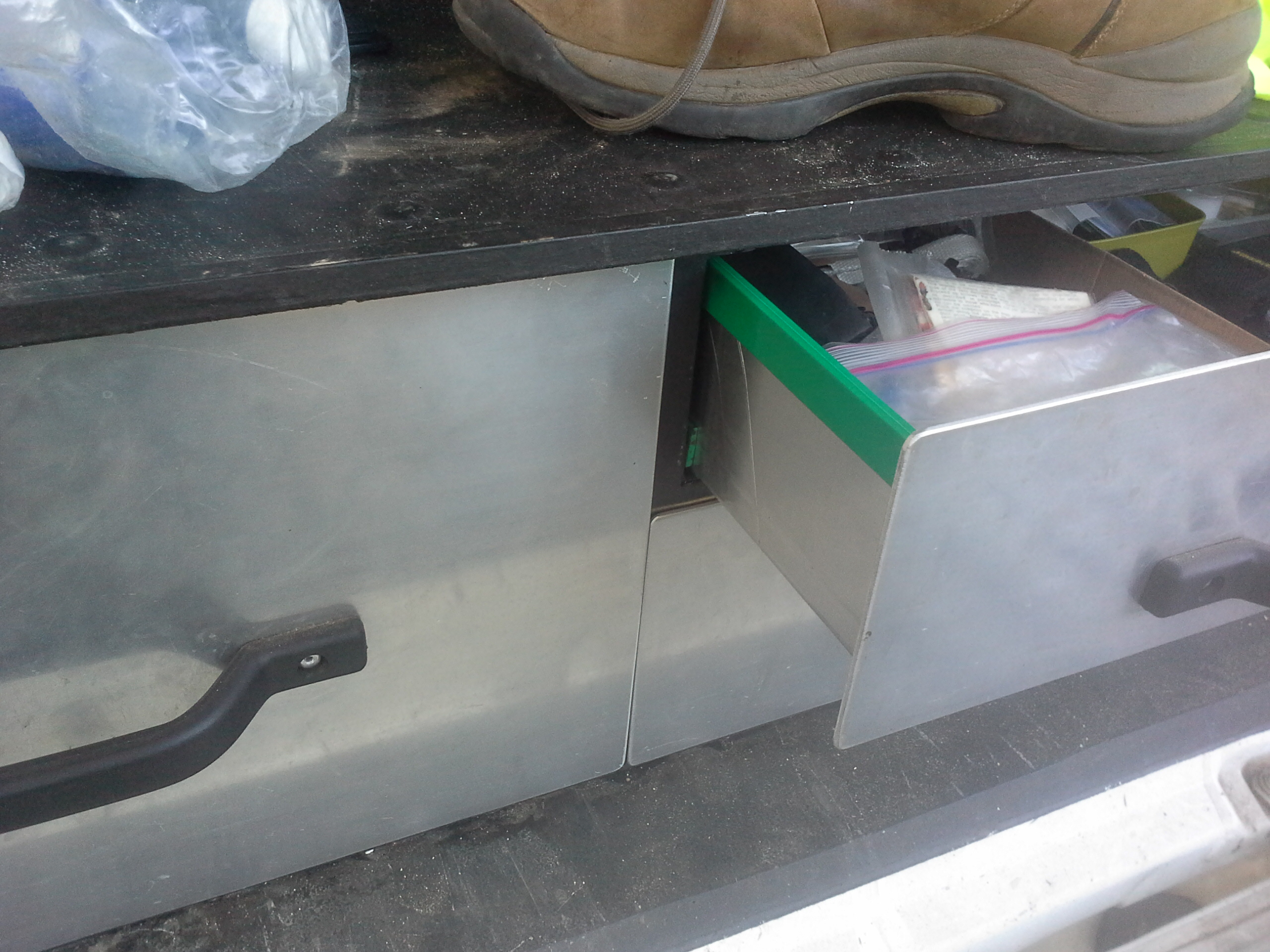

The bearings etc add a ton of weight and waste a lot of space. Burnco make drawers that consist of a 10mm square tube frame, alu drawers, and some sort of teflon type extrusion as runners. No wasted space and very light compared to the old fashioned designs out there.
I buy the bare frame and I stall it myself to satisfy my pedanticness
(Photo taken on a redundant tablet so hopefully the photo comes through ok)

I used that very same Teflon strip on my drawer system. There is a thread somewhere on here that shows what I did and how I did it, which also has the details of the Teflon strip and it's supplier. My frame is angle iron and flat bar, even more efficient in terms of space, and despite steel drawers, it weighs less than 30kg.
Having said that, on my trailer I used roller-style runners, as they just move more easily. My wife has trouble operating the teflon-supported drawers in the car when they are heavily loaded.

Ja the bottom bearing surface on mine sits on light guage angle iron
