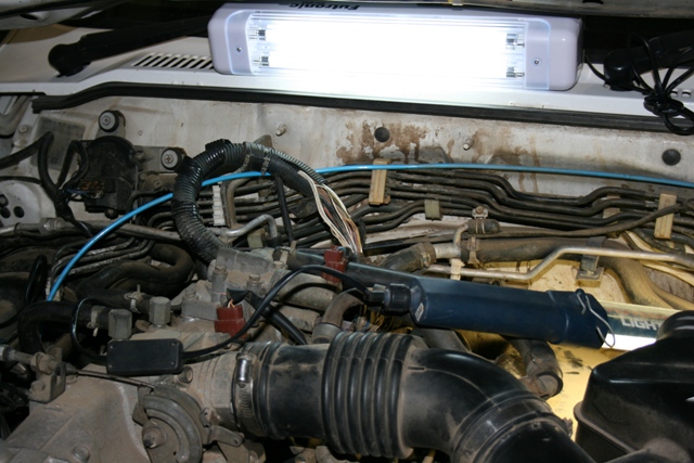

Looks like I have found the problem in the harness that was causing the fuse to blow. Will head down to the dunes and give it a test later on.
I popped into a friend of mines workshop in Wynberg to see if he could give me a hand in finding the problem. We parked the vehicle on the lot across from his workshop, and with the vehicle in low range held the brake and let the clutch out to see the movement of the engine in conjunction to the wiring loom. When he went in reverse I noticed that the engine lifting bracket was pulling the loom backwards towards the firewall. I then went home and left the patrol to cool down over night.
Now this is where a 75mm lift and 35's becomes a pain. This morning armed with a ladder and lying across the top of the engine, I pulled the loom out infront of the firewall, and what did I find, one of the white injector wires was chaffed through and black where it had been chaffing.
Harness fault.jpg (153 KiB) Viewed 2691 times
I then reinsulated the wire, wrapped the exposed part of the harness with insulation tape, and then pull plastic tubing over that to stop any further chaffing.
