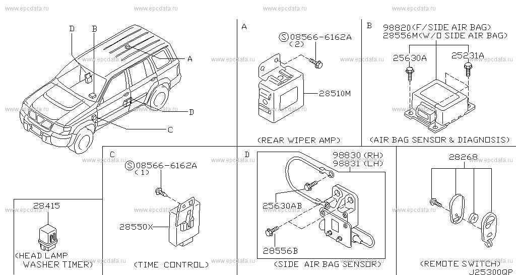

As far as I am aware aftermarket bumpers have little to no effect on airbag deployment. Your airbag module is under the handbrake with remotes on the sides.
Maybe something as small as a loose earth after the sideswipe.
