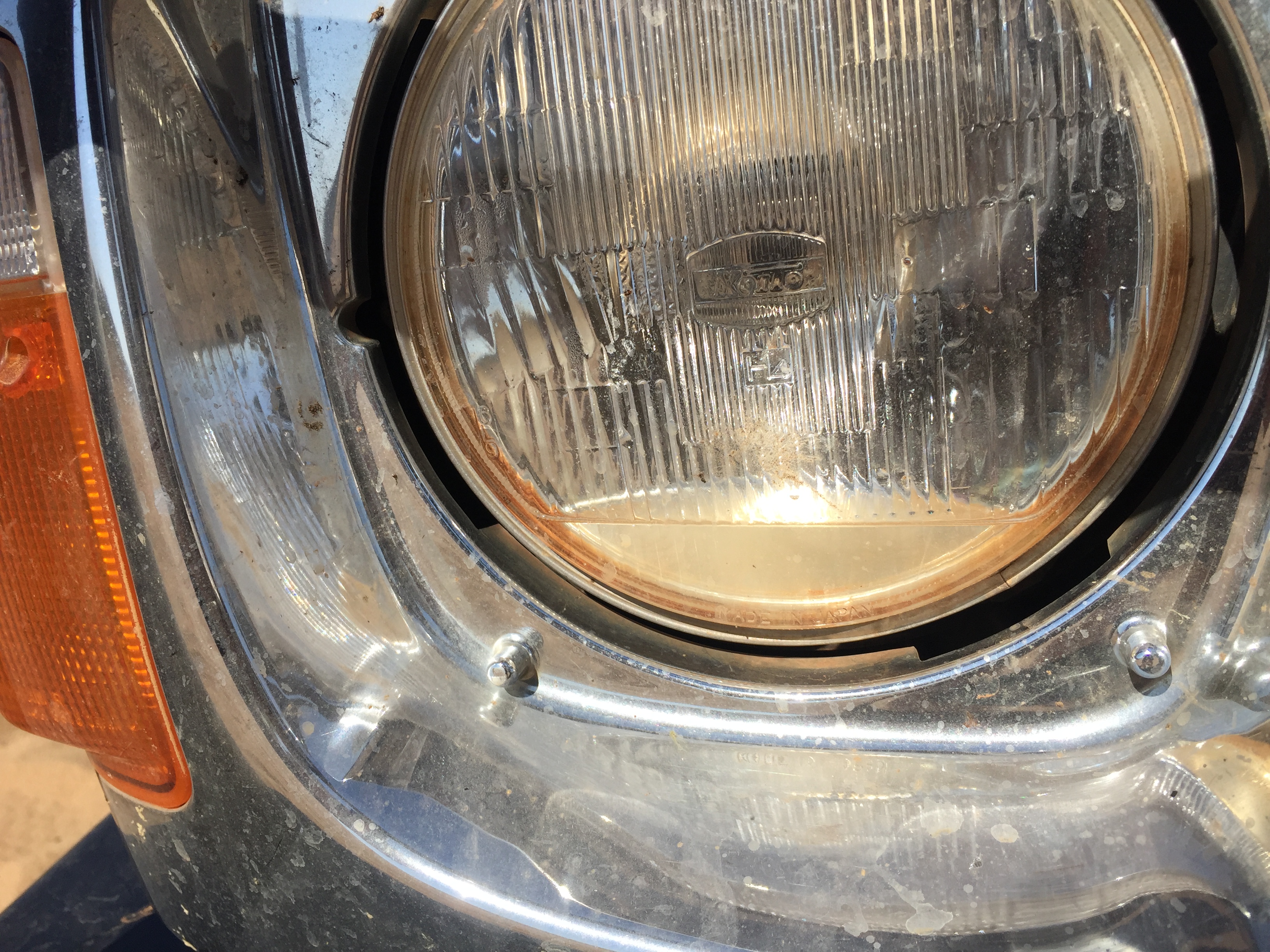

Re: Water in Headlight
my headlight after crossing the Groot Letaba in 2021... it dried up after a few months...
