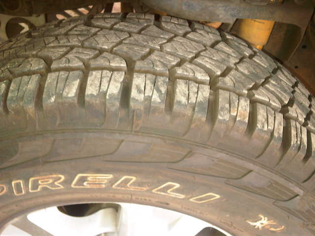

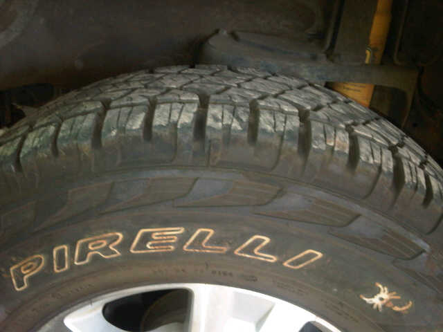

It is A/T tires.
See pictures for tread pattern.

Clem
Posts: 905
Joined: 19 Jun 2013 15:16
Full Name: Clem Daniel
Nickname: Clem
Current 4x4: Patrol 4.8
Has thanked: 39 times
Been thanked: 39 times
Re: Fuel Consumption after new tyres???
Post by Clem »
Not surprised your fuel consumption went up if you went from HT tyres to AT tyres. That alone will account for about a 15% difference in consumption.
