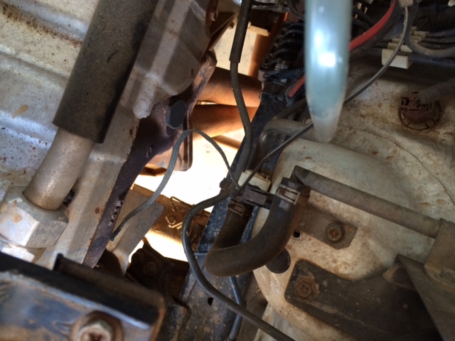

But: I found a loose earth cable in the engine bay, it is on the shield on the left side - could that be important?
- loose earth cable in left hand engine bay
- loose earth.JPG (130.53 KiB) Viewed 2543 times

That is a distinct pisabolity...haha. A poor earth can make nonsense.
