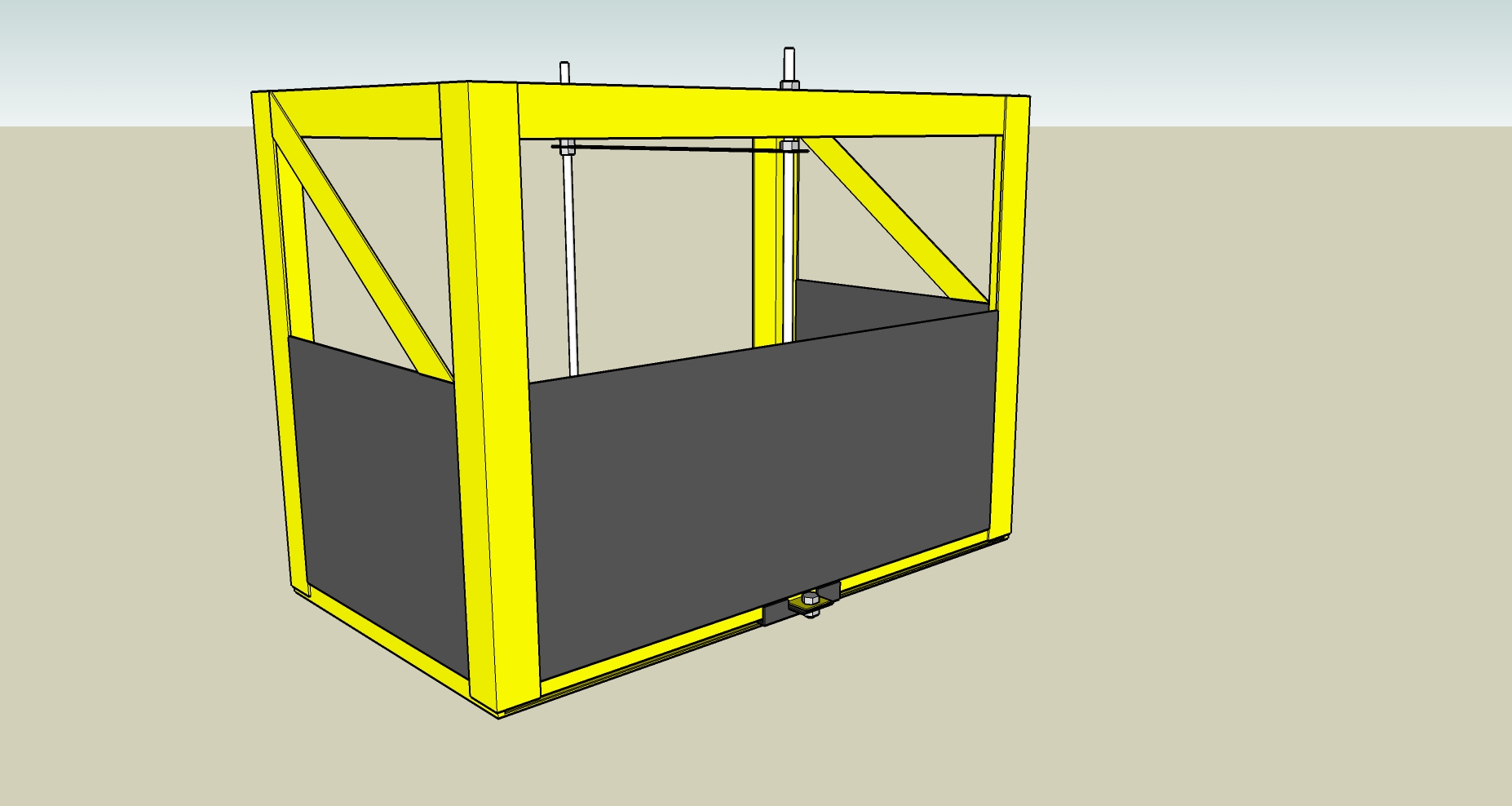

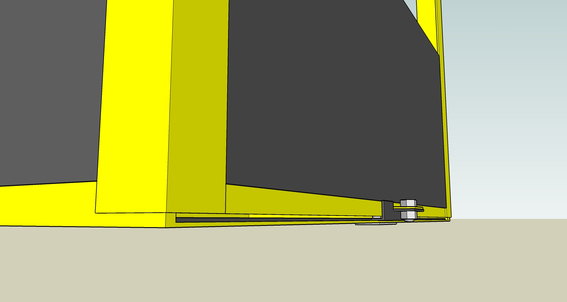

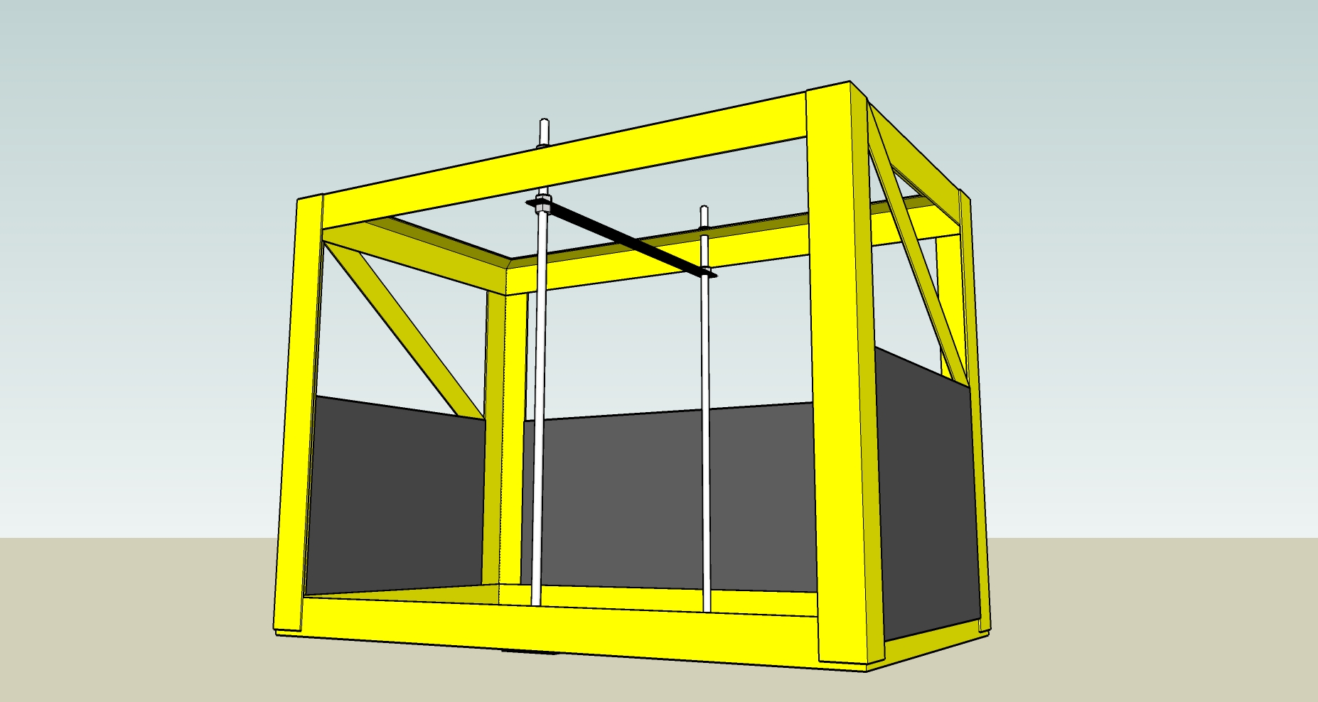

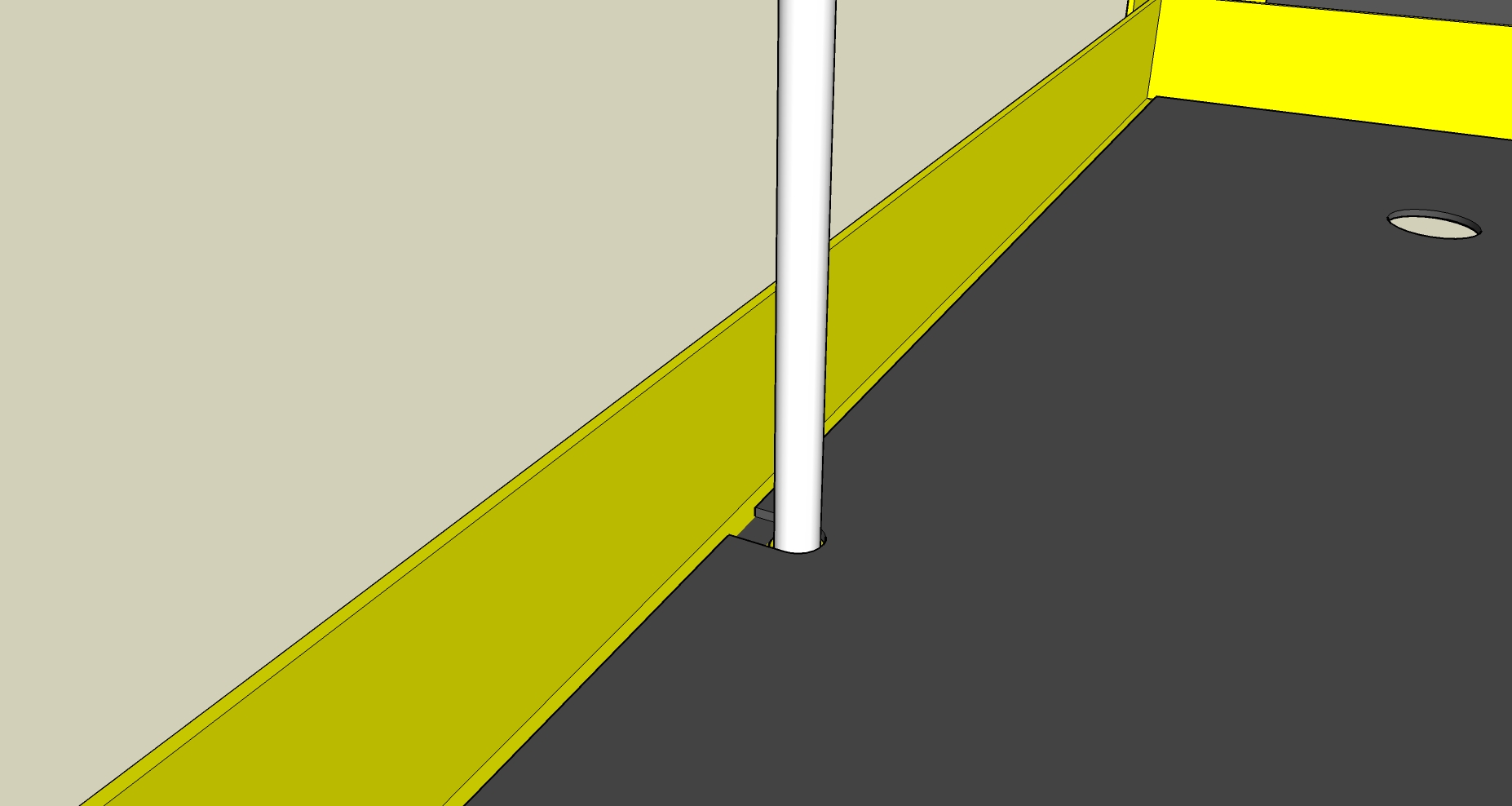

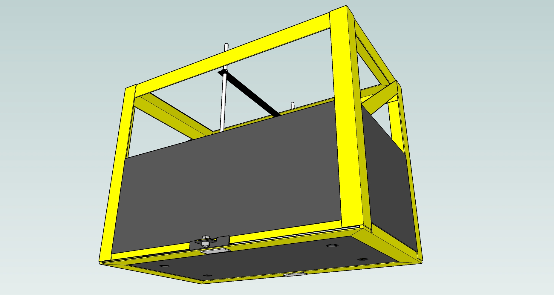

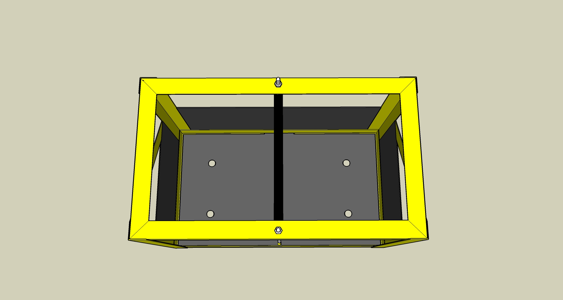

Just for starters....
Basic 25 x 25 angle iron frame work, with a slot in the front to allow the floor plate with water drain holes to slide out. Steel plate halfway up sides for protection and strength. Open side fixes to chassis.
To fit the battery in...
1) Battery clamp height to be adjusted and locked at correct height for battery on the threaded rod. This will be the rod closest to the chassis. The rod is fixed permanently to the top of the angle iron frame and to the bottom of the angle iron frame. Once this height is set you shouldn't need to worry with that again.
2) A little strength needed to lift the battery into the box from the bottom, and then slide the base plate in to hold everything in place. The second threaded rod fits into the hole in the bottom of the box opposite side to chassis and through the bracket that will hold the battery down. This also secures the base plate in place. There is a slot cut out of the base plate that the battery sits on.
3) Tighten bolt on the threaded rod to clamp the battery. If space allows a nut can be secured to the top of the threaded rod to secure the threaded rod in place.
4) Slap a bolt or padlock to lock the base plate ( double security )

I would suggest we make the box water tight with a breather. Also if possible have a side panel on hinges so easy access to terminals. I will also have a cut out switch in the cabin area so it can be isolated should something go wrong.
