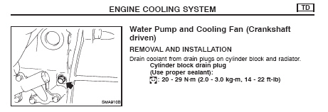

This is what the manual shows:

Thank you Herrie, I'll try and locate it on the engine.

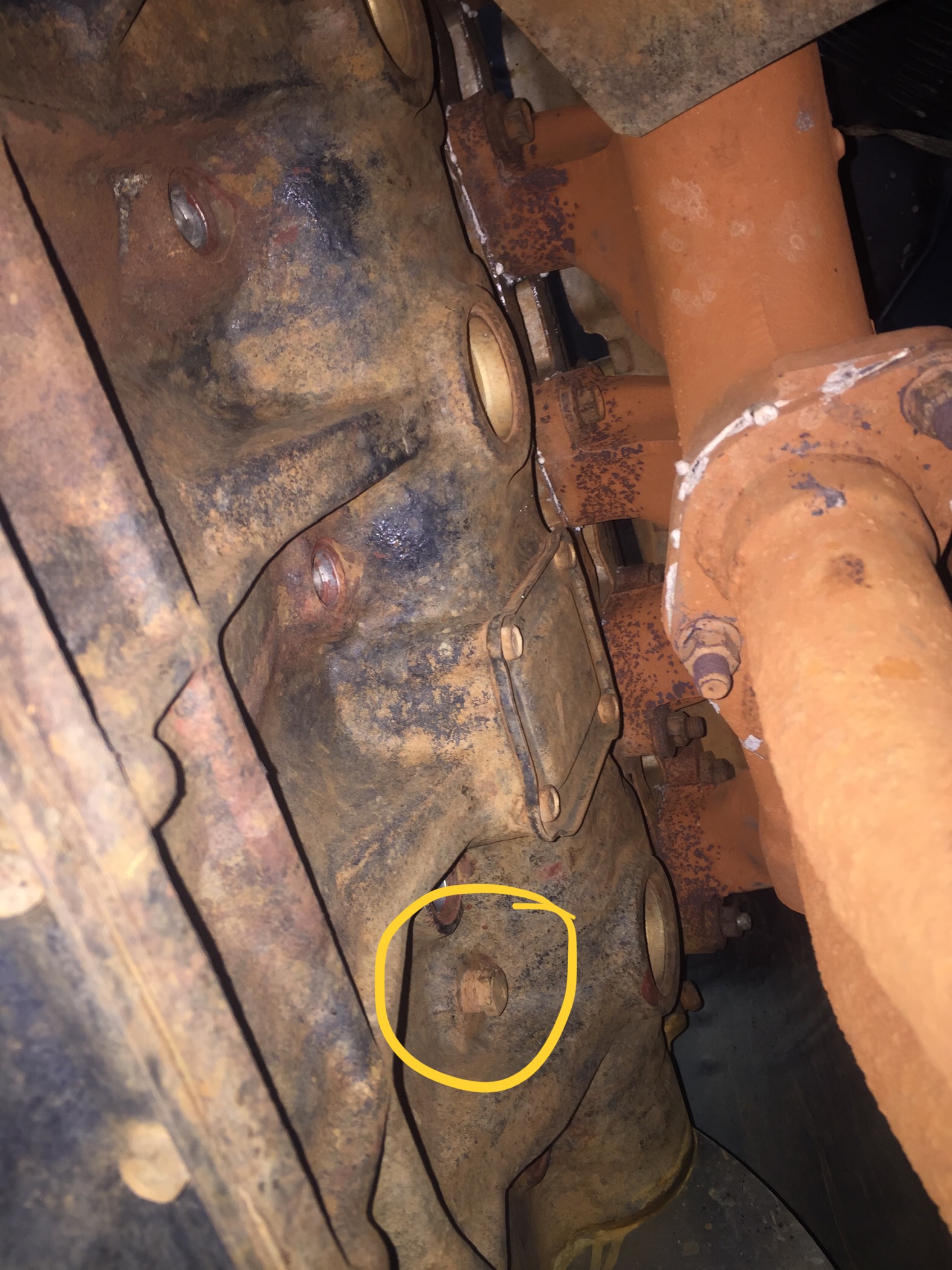

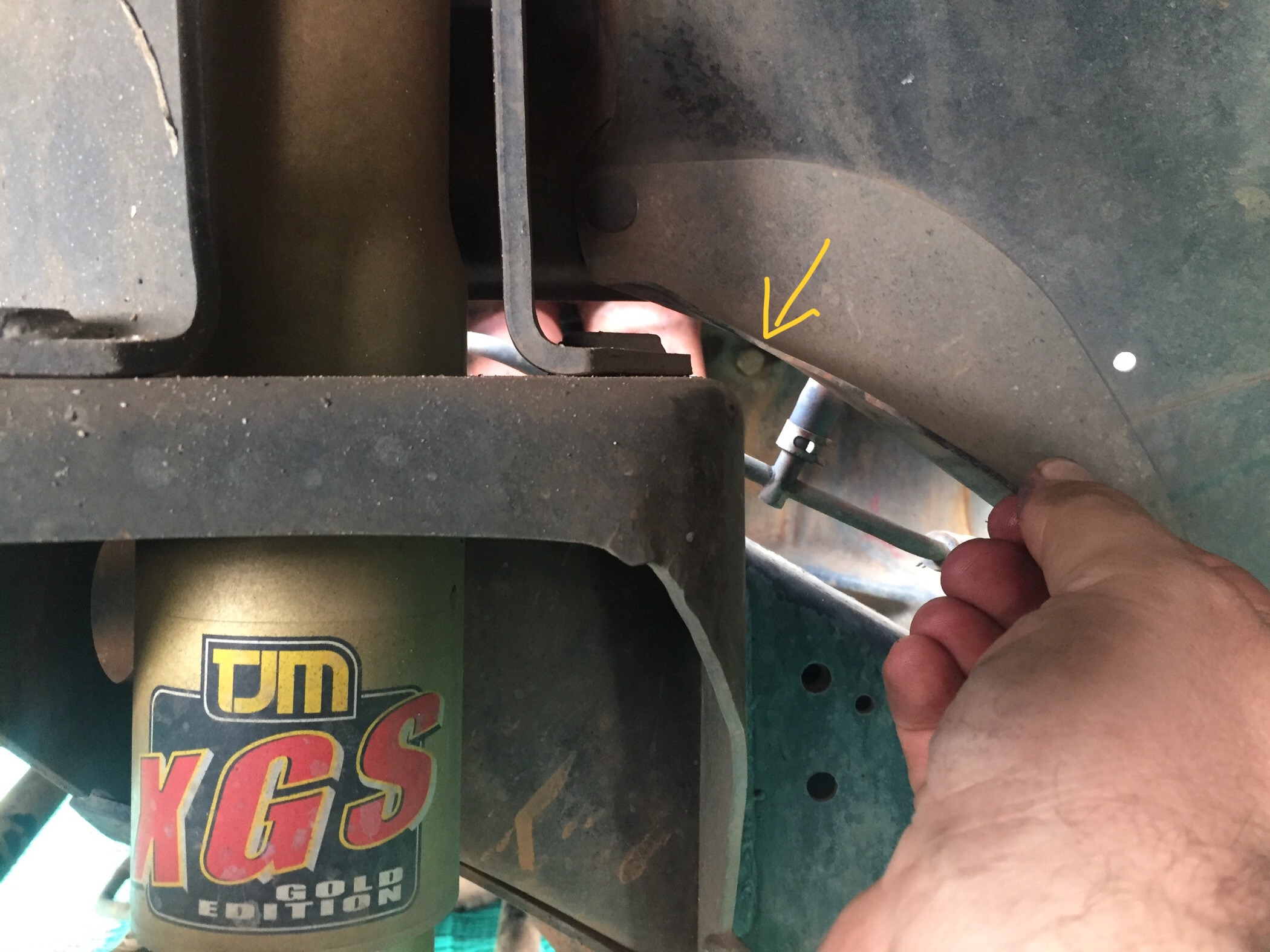

Re: Coolant Drain Plug on the Engine
Hy sit links van die enjin langs die blok by die ratkas,soos Herrie se prentjie. n 12 Socket met kort extension en ratchit sal die job doen.Jy sal van die kant onder moet in klim om by te kom en dan gaan jy te stadig wees en nat word wanneer die plug uit is
Doen dit wanner die water koud is

Everything went off like a dream, it made life a lot easier knowing where to actually look. A few things became apparent after I drained all the coolant.
1. There is no thermostat currently installed. I will try and find one as I feel that it would be better to have this in the system.
2. Patrols are very easy to service!
3. I was lucky (tall) enough to be able to unscrew the plug from above, therefore I didnot get wet!
Thank you for all the good advice!
