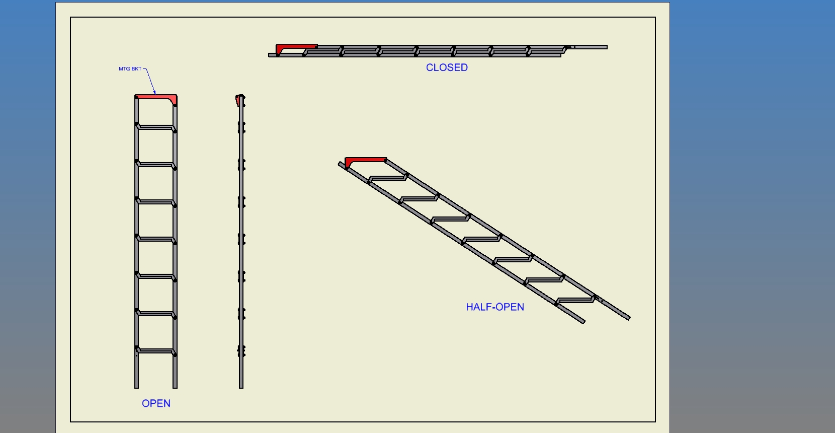

I have seen ladders mounted onto the "small" door of several 76 Cruisers, but am a bit concerned about the strength of this door. I have also seen several different itarations of a set of steps that attach to the spare wheel via a ratchet strap. Usually the steps are on the side of the wheel.
I also have designed a ladder that folds up to be a relatively narrow but long section. This can be attached to the side of the roofrack and then fold down:
In my case, it just clips onto the roofrack, as I have found it usefull in camp and even around the house.

David, if you want I can send you manufacturing drawings?

Would you use Aluminium, steel or stainless ( phew :doh: ... stainless may be a bit expensive to manufacture )

Cedric, I used mild steel and galvanized it. Not only cheaper, but easier to work with. Stainless would probably be the "ideal" material for this one though, but it's more difficult to find the square tubing that the legs are made from, and more difficult to weld (the steps are made in two pieces which are welded together).

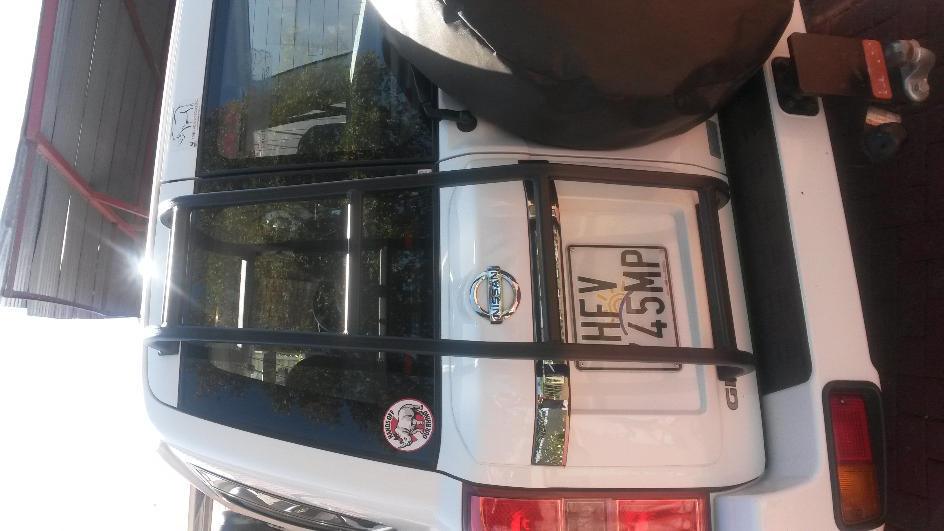

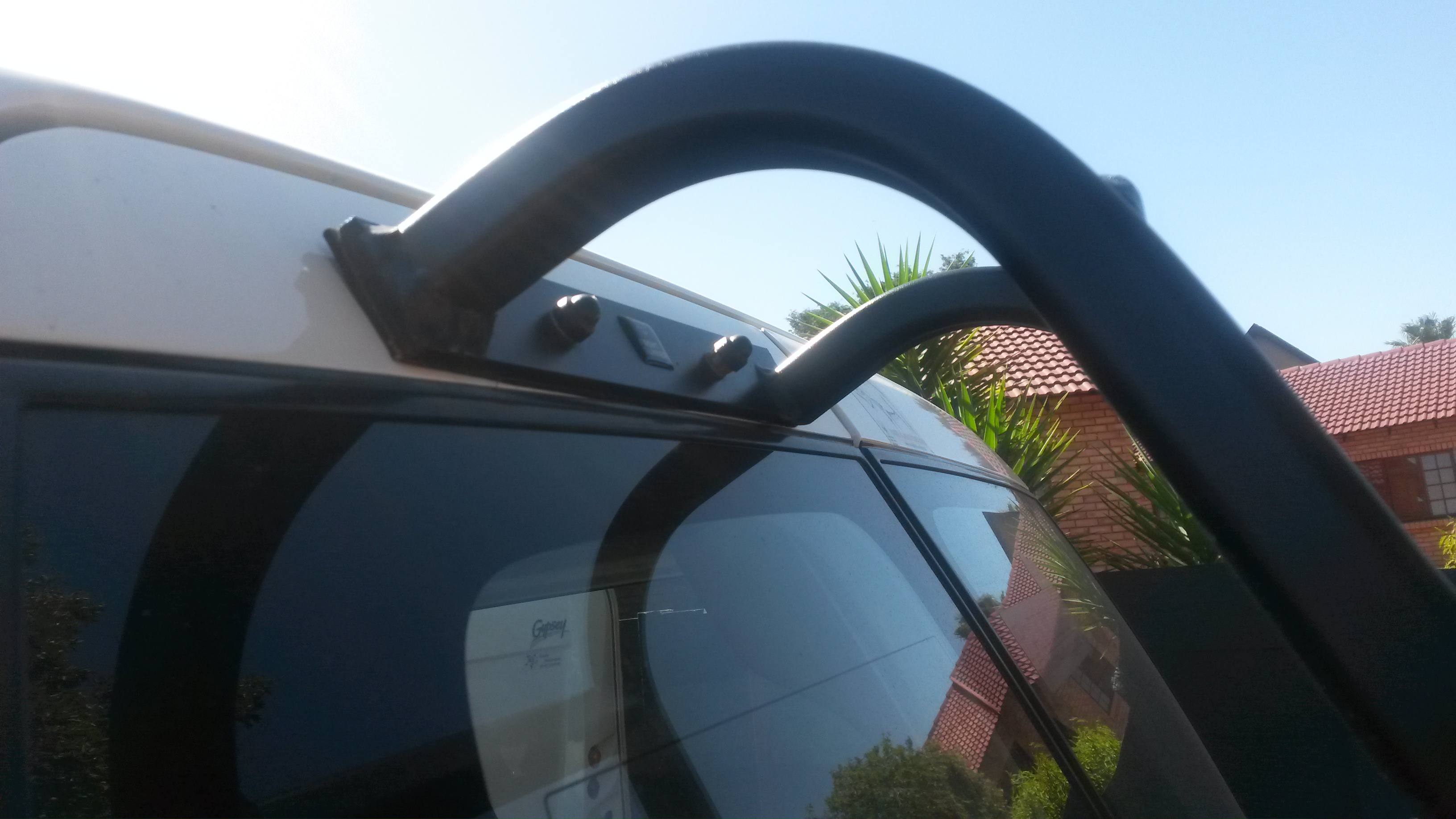

David, Peter's ladder looks great. I was not aware of it when I did mine. So I bought one from frontrunner for R1200. And I just fitted it myself. I did not have a grommet tool. But installed it using a bolt with a lock nut. You can google this. There is some great video's on how to install the ladder. It is aluminium powder coated.
