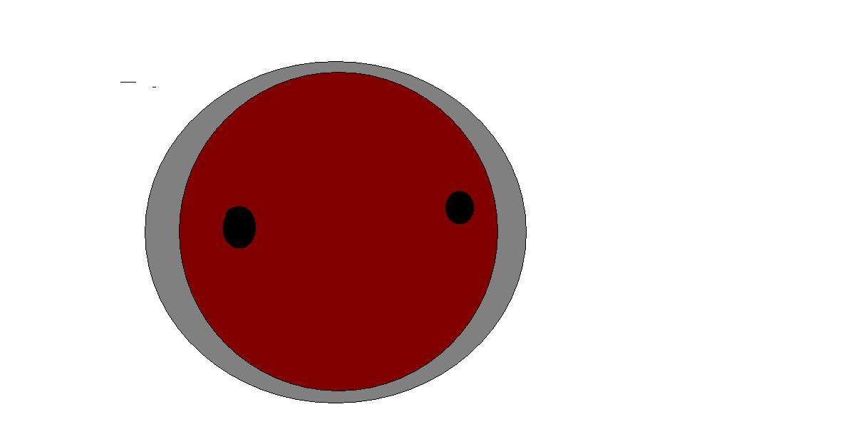

Oompie has thought short and soft [as apposed to long & hard] on this one - only remedy I ever saw work was Oom Albert drilled two tiny smallish holes in the remaining stud ... then he took long nose pliers [daai een met die dunnnn bekkie] and he sprayed the stud with coke [and some hour later more coke and again .. then some spook pippi - the he applied teh pliers and the stud came out [
So Peter - without drilling, oompie has no other solution to this dilemma...
BUT i like the idea if sweating e rod onto it and try that way ... just dont &^$# the thread ek sê.

Oom Mac, that might just work if I can get in there with a drilling mashine, will have to wait and see.
I will obviously work as carefully as possible, but if the thread does sustain some damage it can still be fixed with a heli-coil (which in my opinion should almost be factory-fitted in any thread tapped into aluminium).
Perhaps I can modify Kobus's idea by cutting a slot across the top with a small cutting disk on the Dremel?
