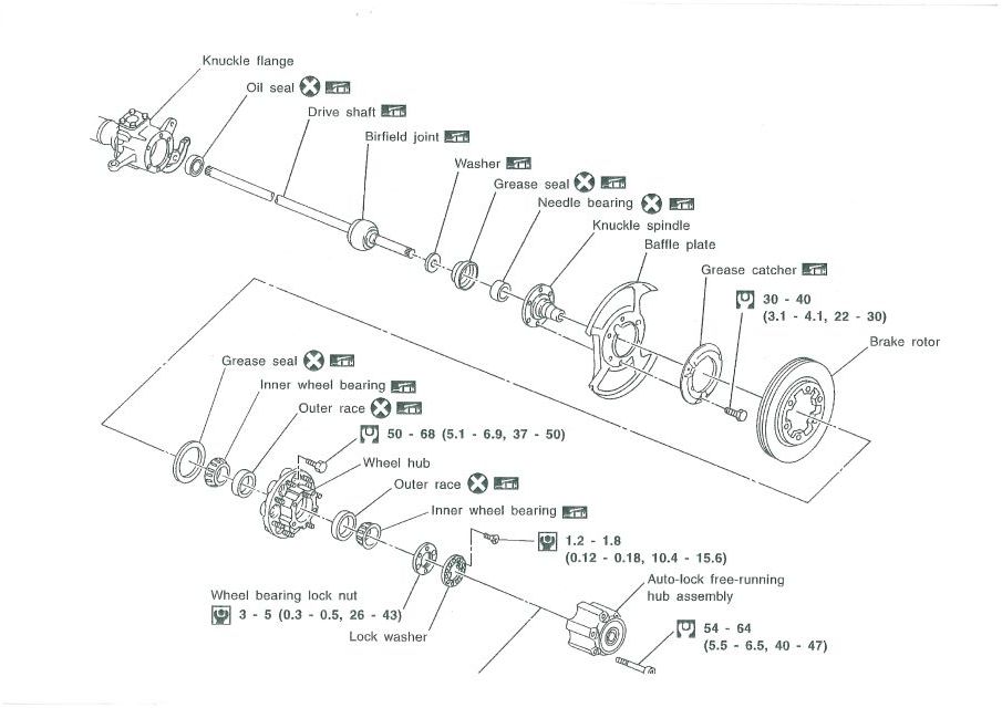

How do you adjust the camber of the front wheels? Both front wheels on my Patrol have positive camber which cause that the outside of the tyres wear faster than the inside.
Do you adjust it with the 8 bolts (4 at top and 4 at bottom) at the bearings of the knuckle flange or do you adjust it with shims between the knuckle flange and the knuckle spindle? If it is done with the 8 bolts I can do it myself but if it needs shims I will have to get somebody to do it.

- SKMBT_C25011040815020.jpg (61.68 KiB) Viewed 5640 times

Cannot adjust camber,but caster you can.

On cars with live axles, like the Patrol, this is generally not adjustable, but is a function of the position of the hub bearings in the axle casing, thus it is set by the designer. However wear or maladjustment of these bearings (preload) may cause a change in camber angle (coupled with play where there shouldn't be any play). Also, with a live axle or DeDion Tube, the camber will remain basically the same independent of body roll and cornering.
