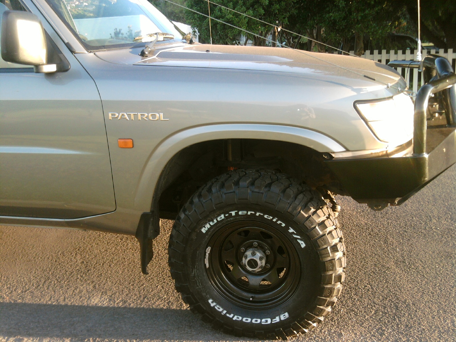

Sias, i have black rims.
I've had black rims on Both my Hilux's, my Isuzu and now my patrol. We recently had an entire discussion on the LC forum about this, as one of the members had the same idea you have right now. To cut a very long thread short, i'll tell you what to do...
1: Do not take Pro-White steel rims and have them Epoxy Coated or Powder Coated. I did this on my first two sets respectively.They will look great, but after a short time they will scratch, and water will enter at the seam, leaving you with another expensive round of sandblasting and professional coating, which you'll put off for as long as possible, but by that stage rust will have set in....not a good way to do it. To fix this you'll then need to take all four wheels to the booth,fir the first coat, and also to be redone months later, leaving you without a vehicle and a bunch of money....
This is What i do now. (And, hundreds of others have done likewise since), here's what to do.
1:Get yourself some Pro-Whites.
2:Get yourself some really mild sand paper, nothing hectic. Or, if you have a baby grinder and a wire brush attachment, that'll do just fine. R15
3:Get yourself 1x Rattle-can (ie:spray can) of Hammerite Plain Black / hammered Black , whichever you prefer. R100
4:Sand lightly, brush away paint dust with a paint brush and wipe clean with a damp cloth.
5:Spray thin layer of hammerite on each rim, going back to the first and repeat till you have 2-3 layers of nice coverage. (never too close or too heavy though)
6:By morning they will be rock hard and the finnish is just awesome!
Pros:
Wheel balance so easily
When they scratch you just touch up yourself right there
The finnish is great
Its Cheap as chips ... and most importantly
Hammerite is a rust inhibitor , so you not only getting the look you want but also protecting the steel from oxidisation and other nasties.
Note: I purchased 2 cans, and i thought that wasn't going to be enough. I did 5 rims, and my rear bumper top with 1 can. Other can still going strong and no touch ups yet, it hardened up really nicely!
also - do it in a dust/grit free area,no wind, as it remains tacky for a good few hours, unlike normal spray paint.
Hammerite does not require primer, so thats a bonus.
Dont sand right through the white paint, i retained mine as extra cover and protection, you really need only sand enough to give the hammerite purchase.
Good Luck.
Here's mine...
Pros:
Good Luck.
Here's mine...
