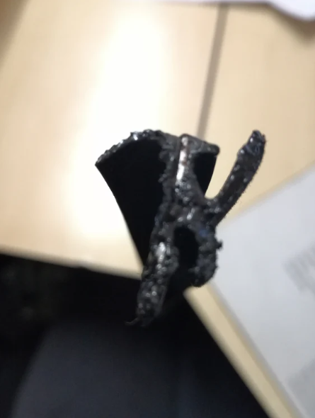

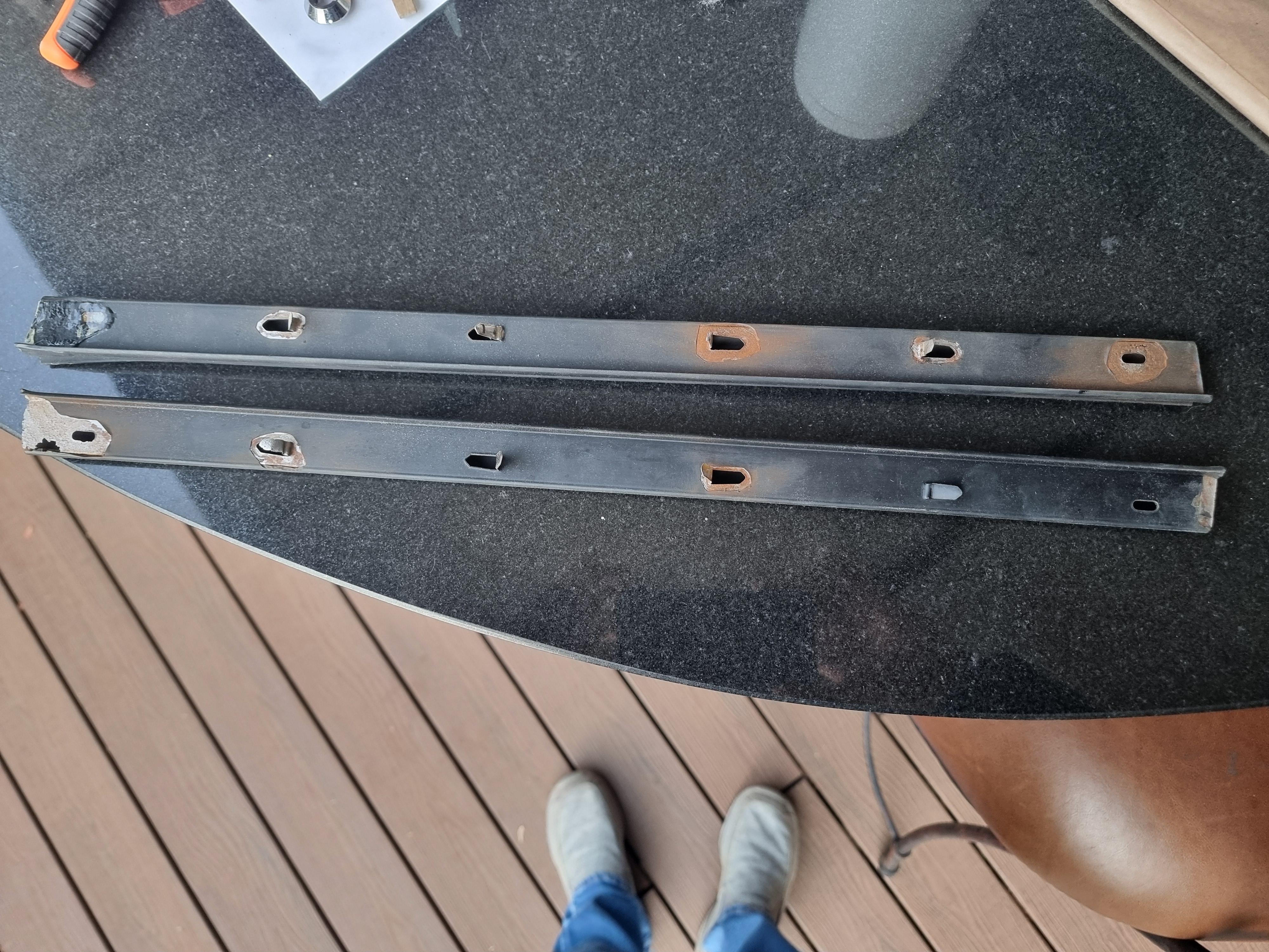

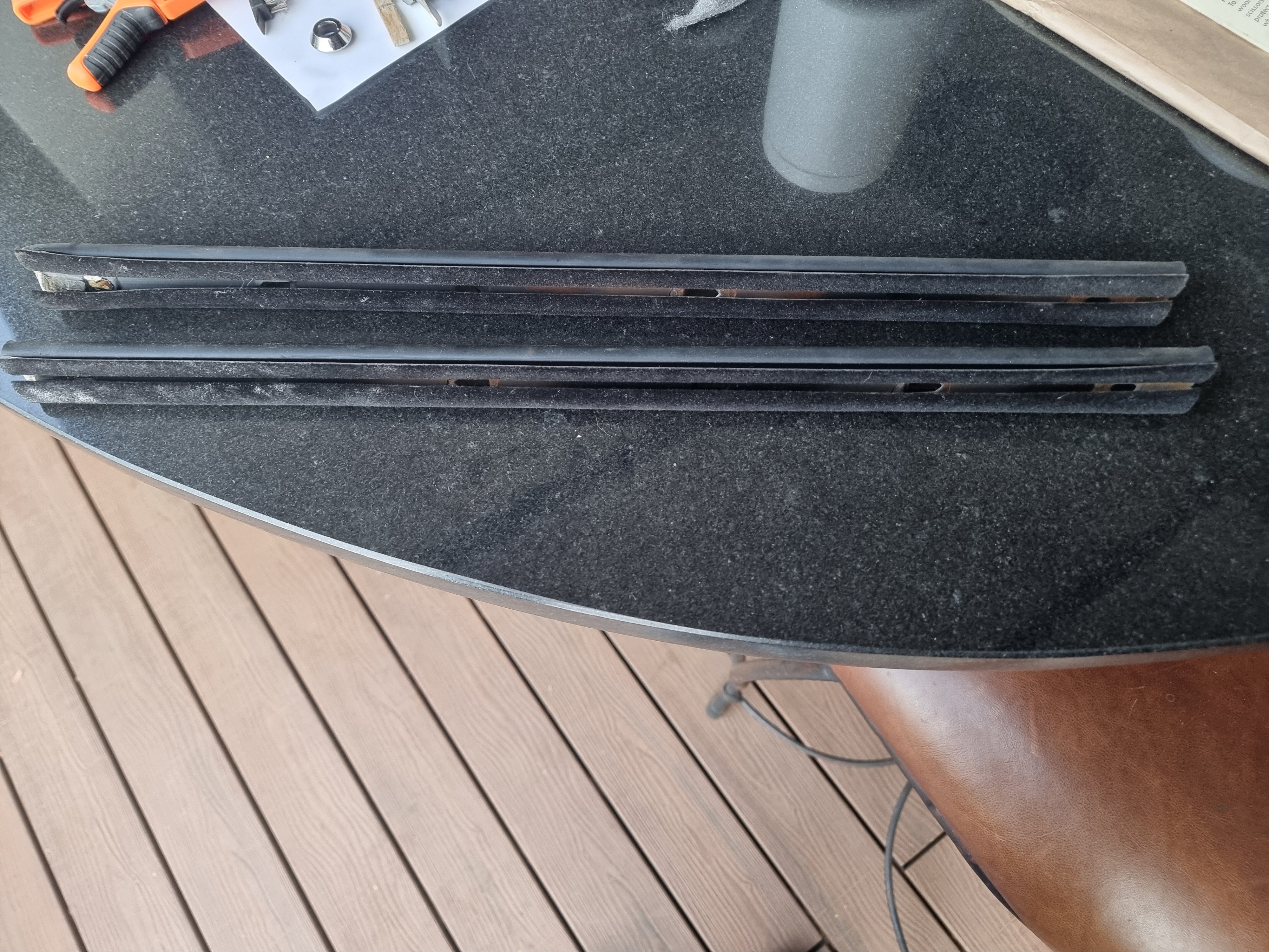

My weather strips have almost no “fluff” left on it (and yes, I am redoing the window tinting also) and the rear strips are badly rusted. I started rebuilding it using evapo-rust, plastic fillers, glues, epoxies, and a very bad attitude at some point, but I came to the conclusion that I am wasting my time for the new tint will just be scratched again.
These weather strips do not seem to have individual part numbers and only comes with the entire interior panel as a unit. I am not prepared to wonder down that cost trail, especially if everything but the weather strips are still in good condition.
Can the patrol gurus on the forum please shower me with your wisdom!
There might be a few beers in it for those that come and help me sand this beast down, LOL!
The attached pics are for the rear door strips, the front strips are not rusted but I want to replace them also.

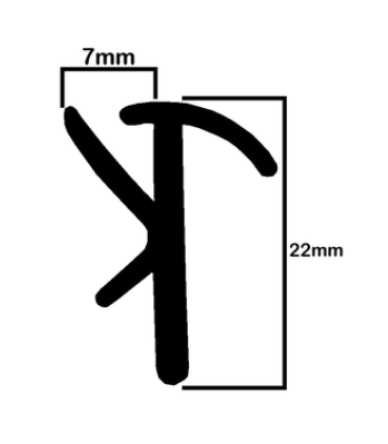

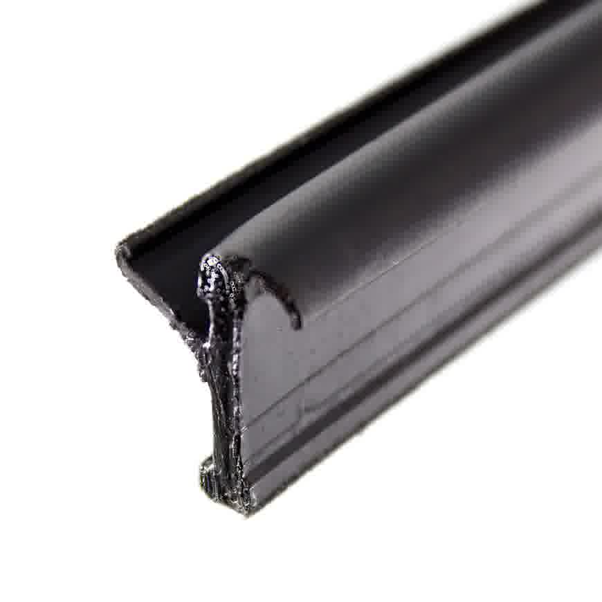

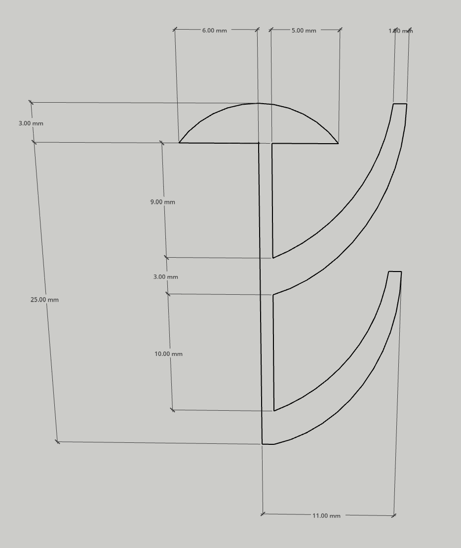

I had a chat to them on Whatsapp and they suggested this one, [url=https://parmegastore.com/products/inner ... 2516791389]INNER STEEL REINFORCED SCRAPER (k)[
For those who are interested, I attached a rough drawing for the OEM profile also
David does not have new OEM units, but he is looking if he can find some that is still in good condition.
The long and shot is, I have options, thanks for the advice!

OEM Profile
