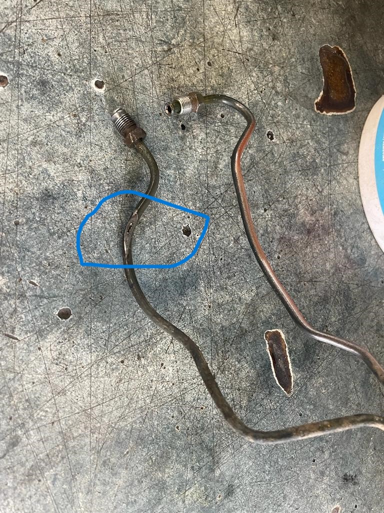

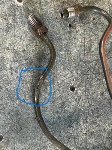

- The most recent (new learning for me) was on a trip we just finished through Khaudum reserve. Another arduous challenge for any overlanding vehicle. This is especially due to the 46km soft sand section when approaching the reserve from the North. It is hot, and result sin the car hopping, and the coils working extremely hard. Somehow my left front break-line (the steel part of if) was chafing against the coil spring. Again, this should not be the case in a standard vehicle, but closer inspection (post-mortem at home) suggests that the breakline on the Y60 / GQ models runs a lot closer to the coil spring than the Y61 / GU models. And a slight bent (e.g. from driving over a branch) may trigger the chafing. By the end of the journey into the reserve, I found myself without breaks. There is no fix really, as the pressure inside these lines are at around 100 psi. Welding does not work either. The only solution (if you do not have a spare) is to block off the breakline, which means you only have breaks to the right front wheel and the rear wheels. Slamming the breaks at 120km/h would roll the car immediately. Blocking off both front breaks would render the breaking ability inadequate. So it required slow and patient driving back home.
Inspecting for any potential form of chafing inside the engine bay, but also in the under carriage should in my view be essential every morning before startint the next stage of your journey.
See the pictures below

Joh good one Alex had to do to my bakkie a week ago left front also was not fun closed it off next to road with a Leatherman and wheel spanner ...not fun driving with 3 wheels working
