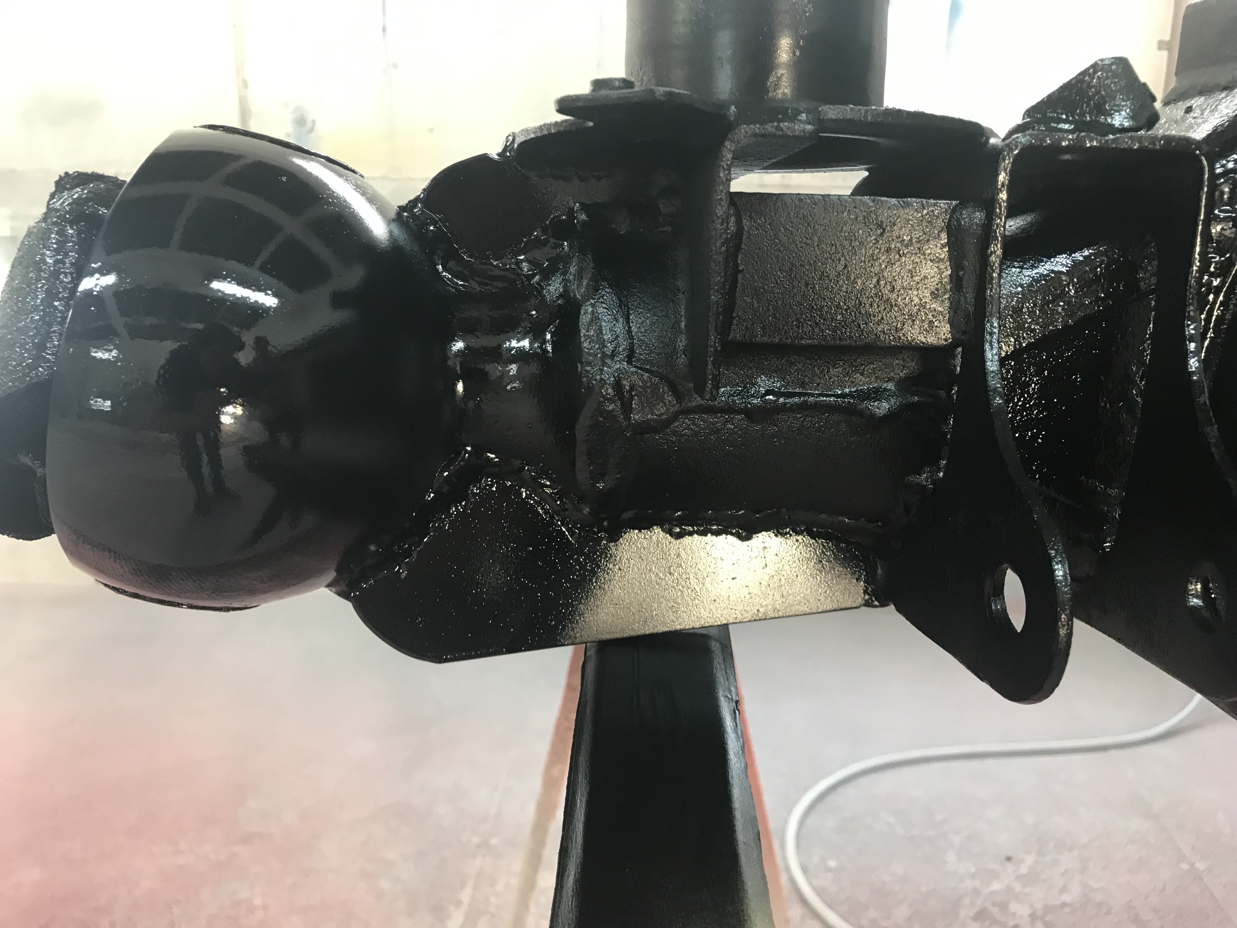

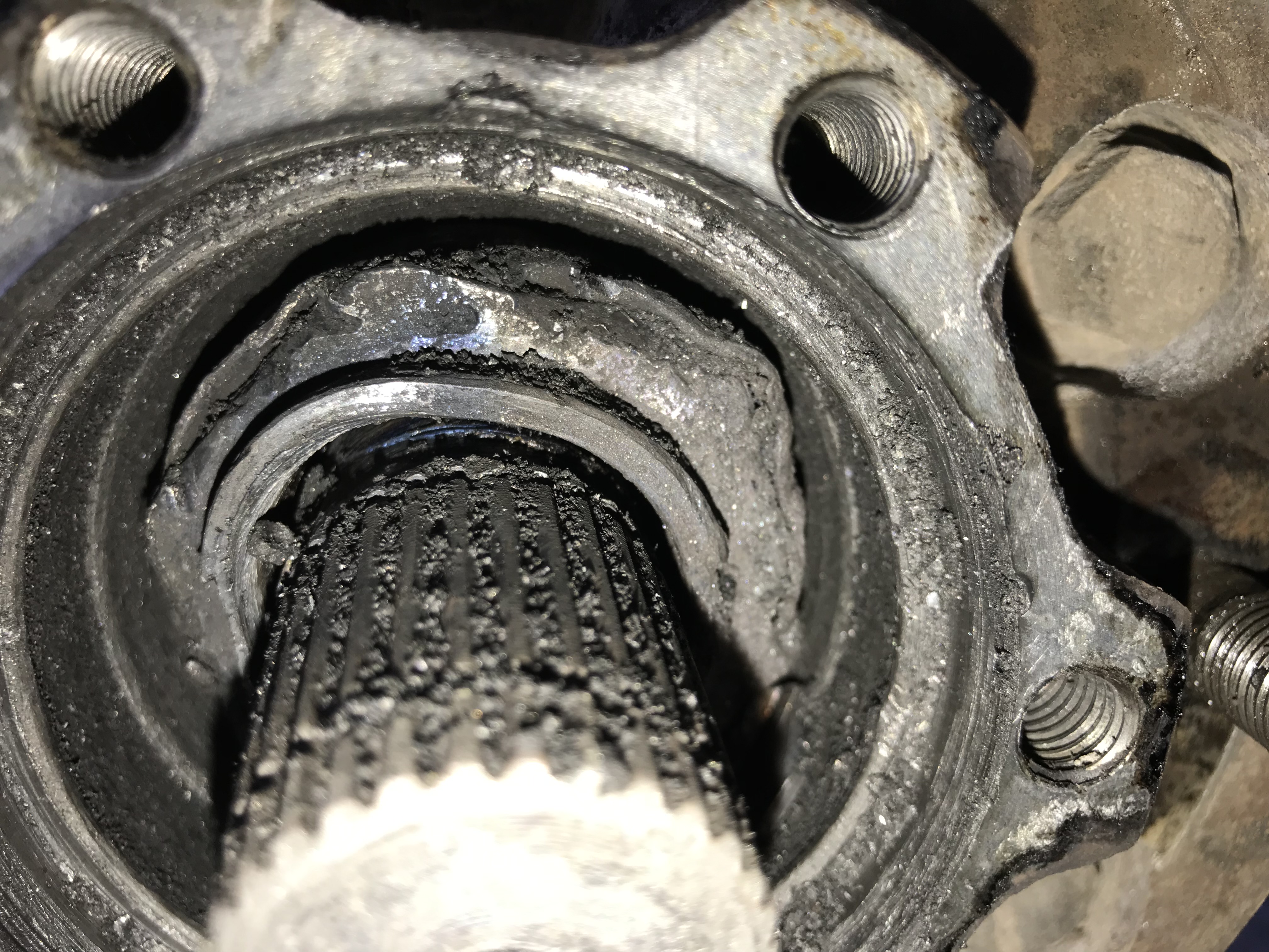

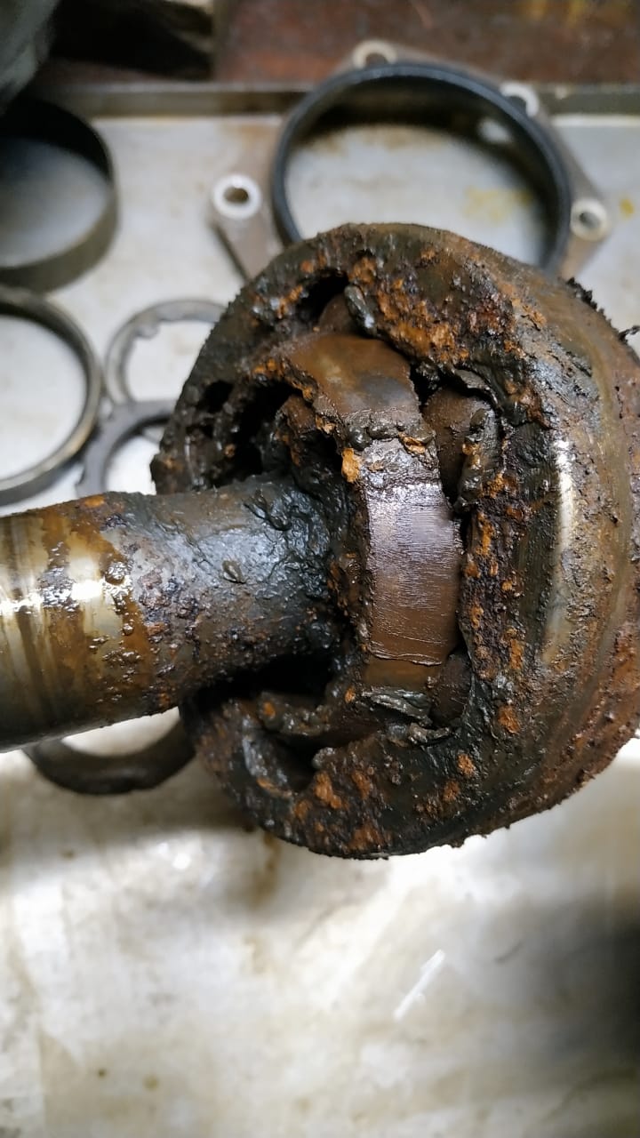

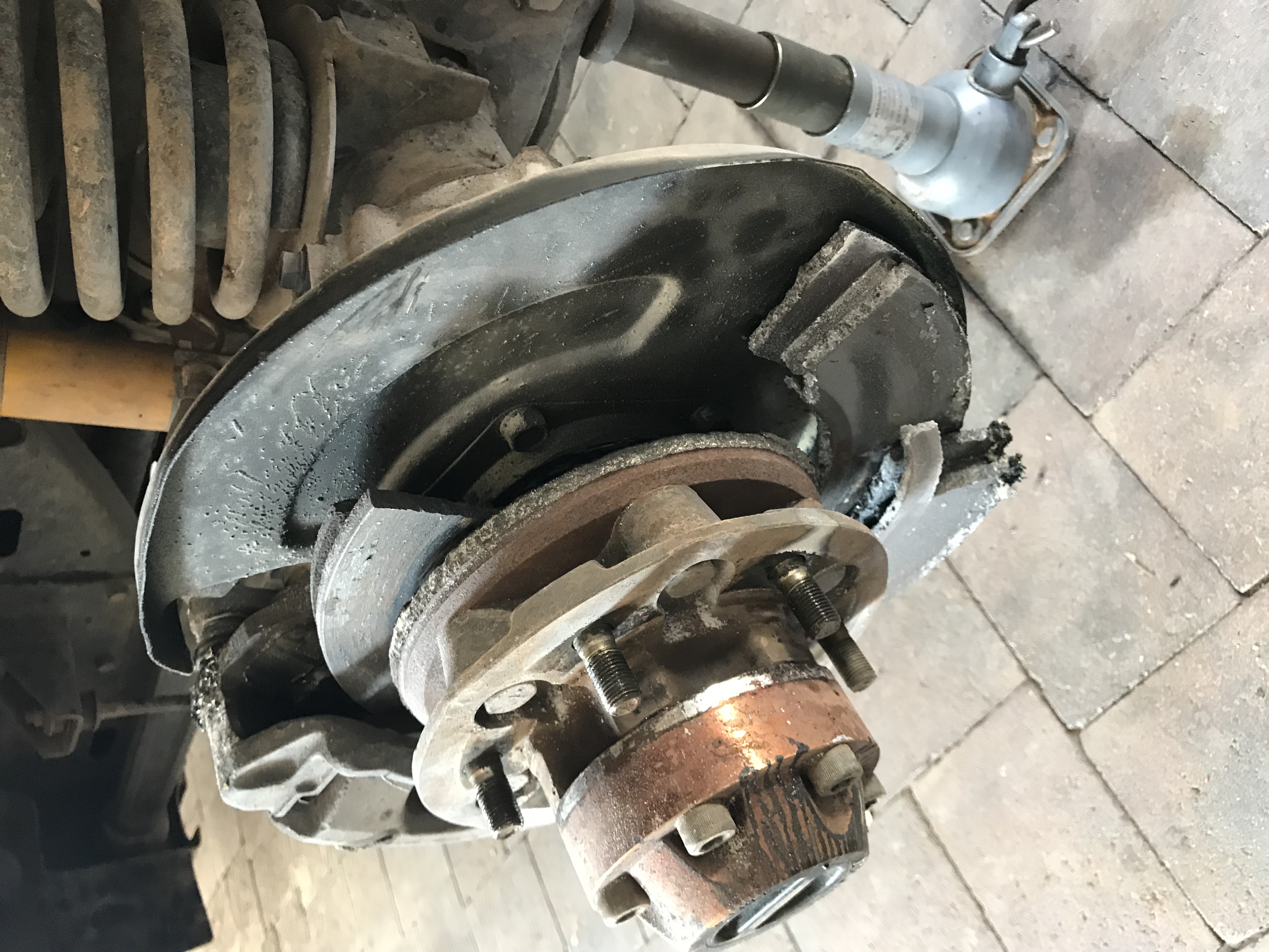

Did have some diff issues because of some over enthusiasm in the salt pans last December and some salt got in the diff. :redface:
Well some things got hot and caught fire.

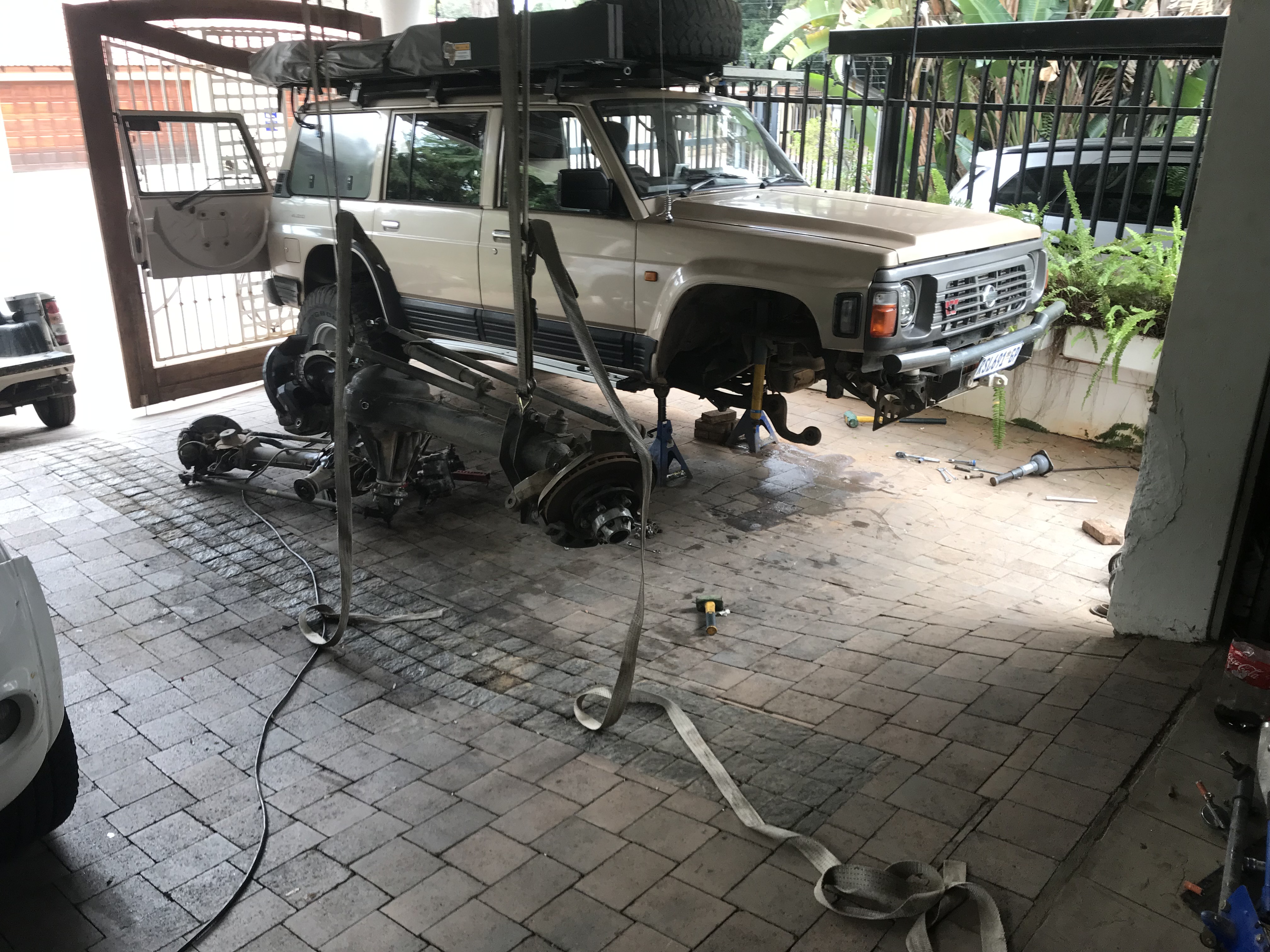

So after 3 attempts from repairs to a new diff that was bent all the way to getting a casing, strengthening it and putting all the non bent parts in I know have a GU diff that is strengthened in a GQ with all the steering components including the steering box from a GU.

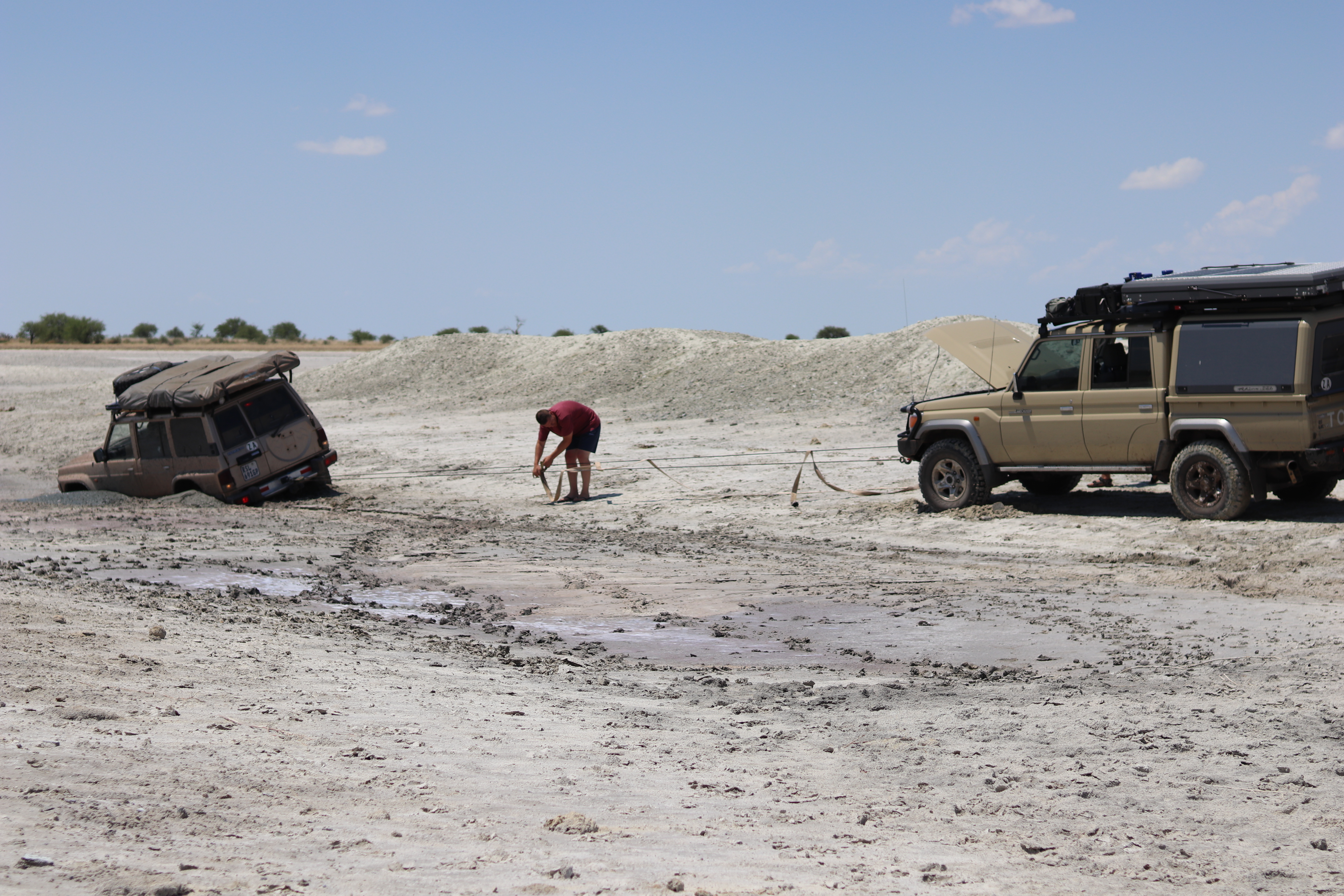

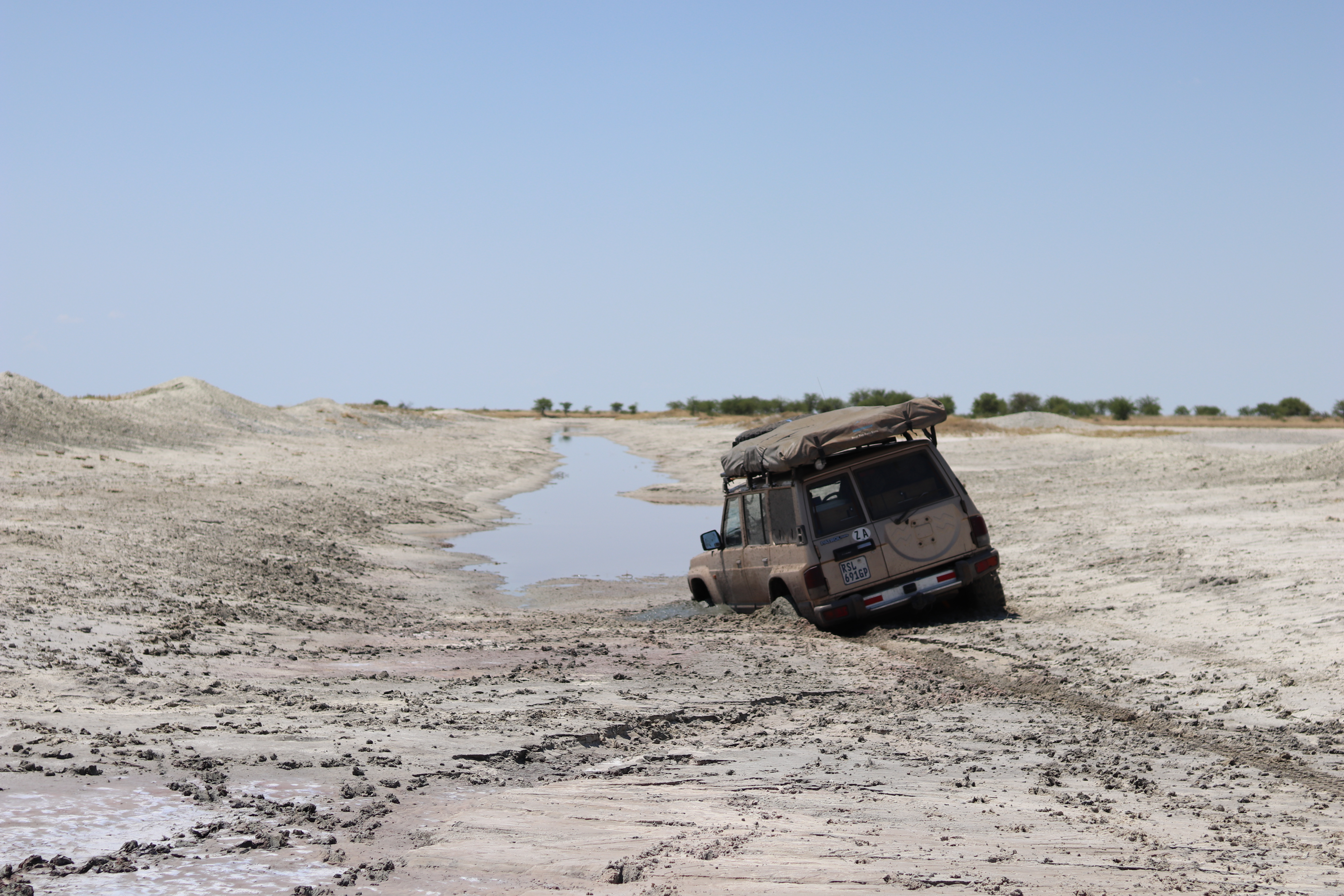

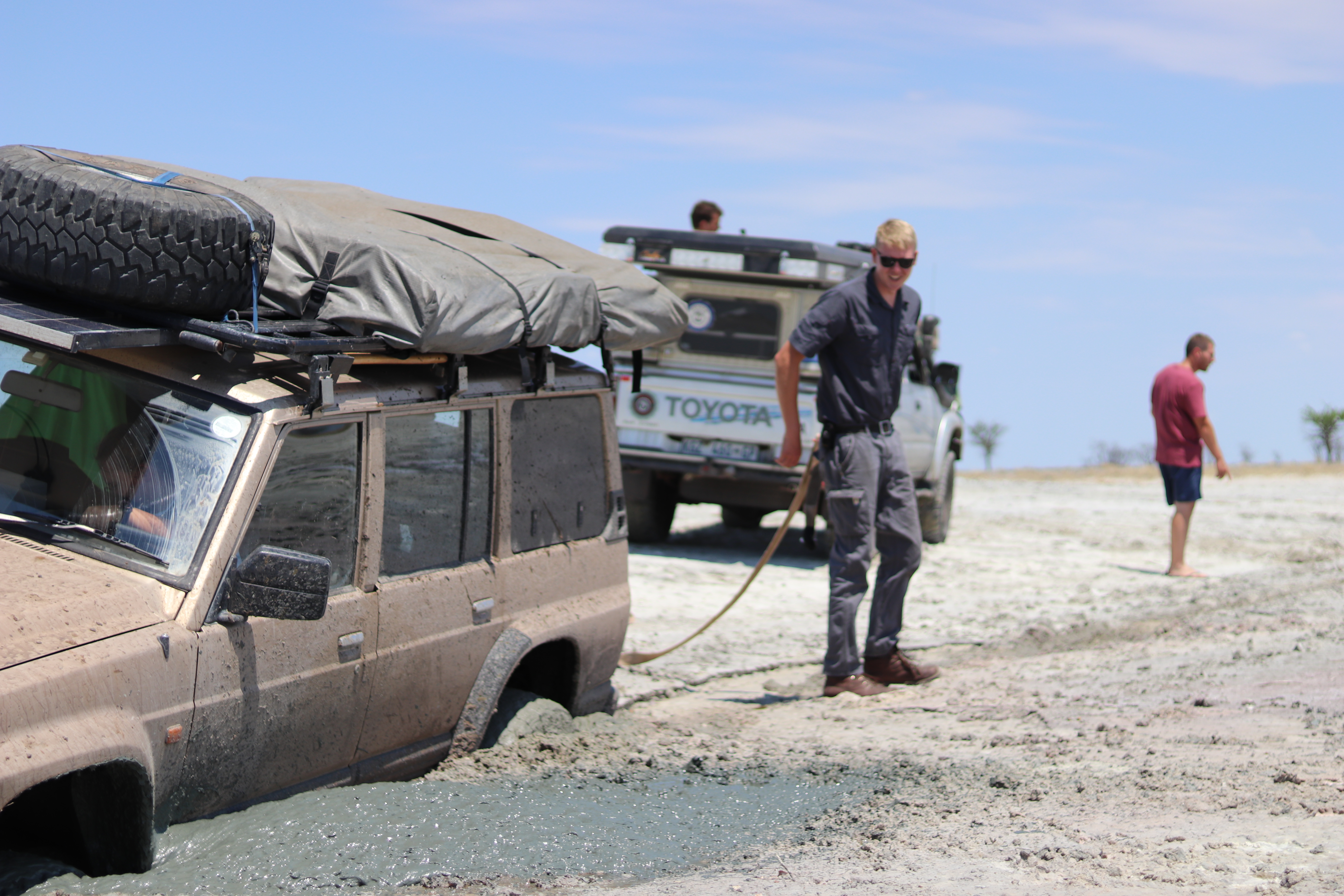

So I found some Quicksand in Bots :woo:
3 Toys and 1 Isuzu as anchors. 11 tons of winch was standing still. :think:
Eventually I got out.... 10 minutes later all 4 of them got stuck at once and the only vehicle left was PATROLLIE!!!!! :blonde: :blonde: :blonde:
35" defiantly was the advantage including weight distribution between my front and rear axles.

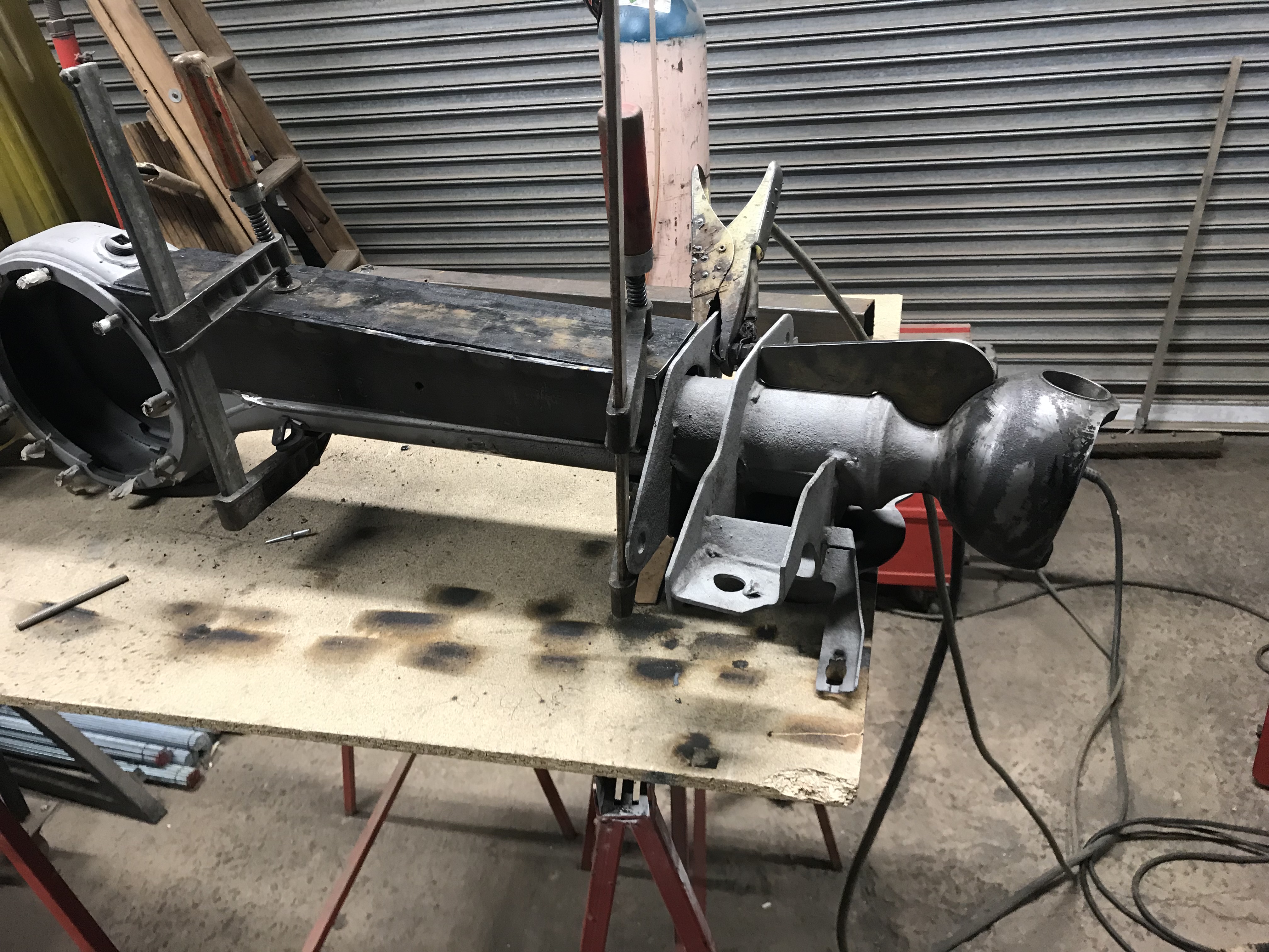

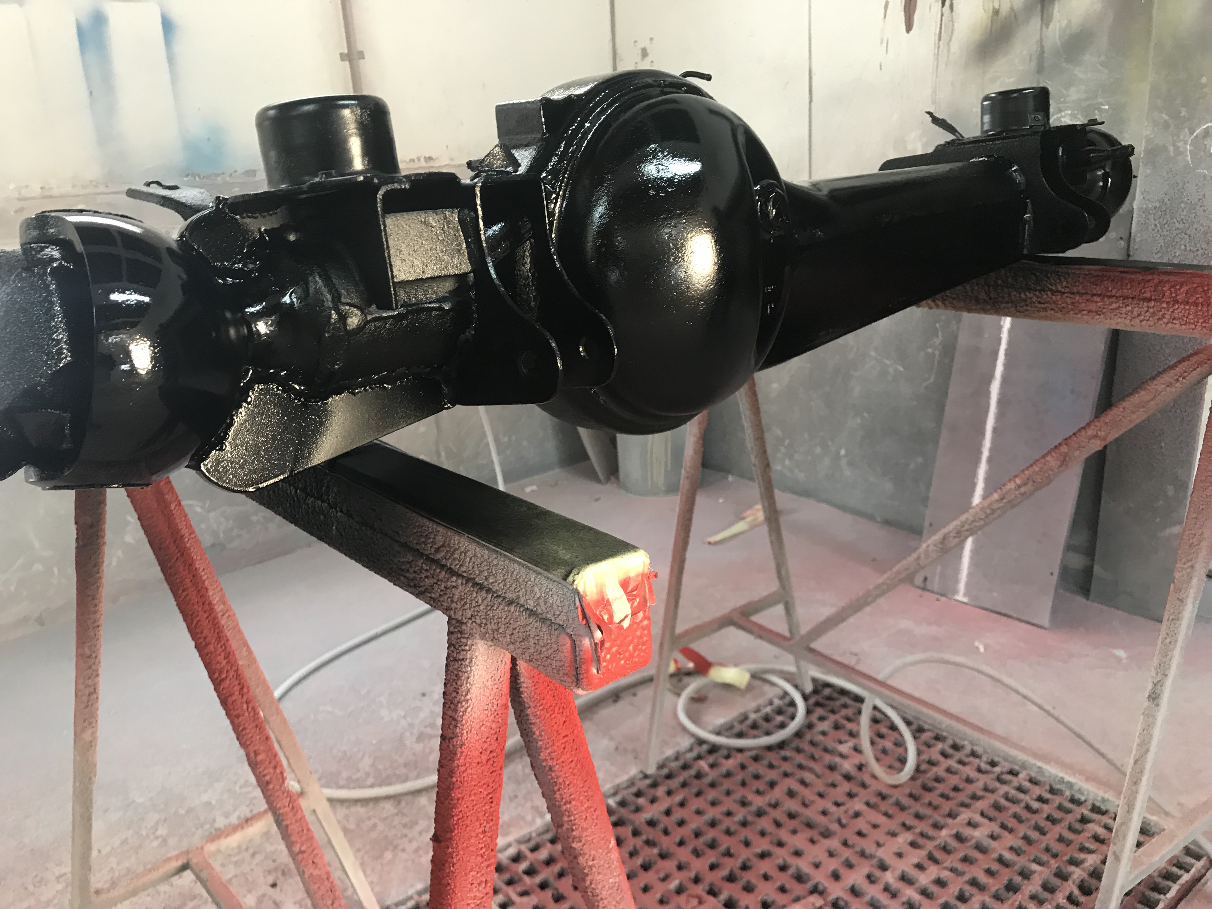

So I bought a GU diff. Single handedly shoved it underneath the GQ :doh:
Unfortunate someone rolled it off a mountain and it was a bit bent :doh: :doh: :doh: :doh: :doh:
So the bent diff's internals were fine, got a casing, strengthened it and rebuilt it with new internals.
But we are back pulling the TOYS!!!! :blonde: :blonde: :blonde: :blonde:

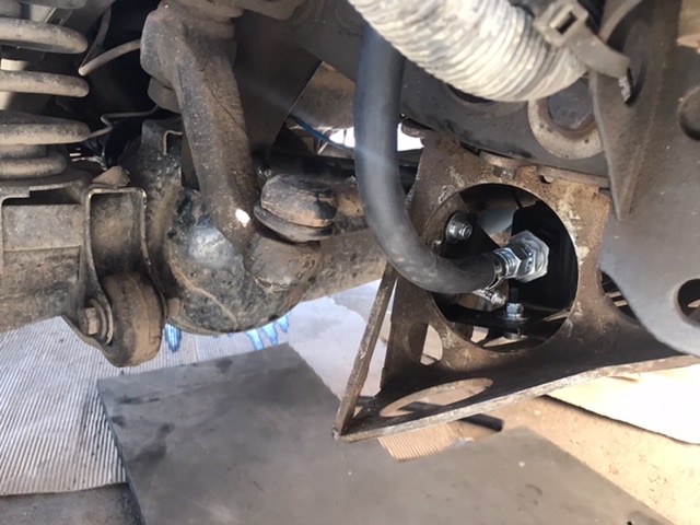

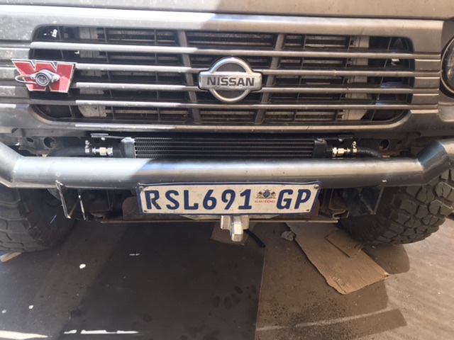

So the next thing I could do and probably the last major attempt left was Oil coolers. I picked up a pair from a contact of Tinus and some sandwich adapters and so it started.
Simultaneously it was more and less work than I imagined. Mounting the coolers was quite easy, they are rather large so one I put right in front to catch as much air as possible and the second inside Piet's bashplate. The hardest part was the pipework, just to make sure it doesn't get punctured. Now as some would know the TD42 has 2 oil filters, the only information I could find about the internal oil cooler system of the motor suggested that they worked in parallel and adding only one oil cooler would simply mean that the oil would take the path of least resistance and flow through the filter without the cooler.
Now some simple tips for installing oil coolers to a TD42:
-Pay someone else (then you have someone to blame when it goes wrong and it is not your hands that has lacerations and cuts as deep as your soul.)
-Use the minimal length fittings on the sandwich adapter side because the stater is very close.
-No matter how well you tried to cabletie the pipes out of the way, carry a few joiners, whole length of pipe and 10L of oil for when it goes wrong.
-Remember the wise words of Oom Boegman- "Fiddle, Fiddle, Fu...

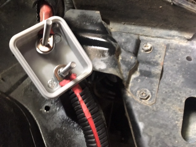

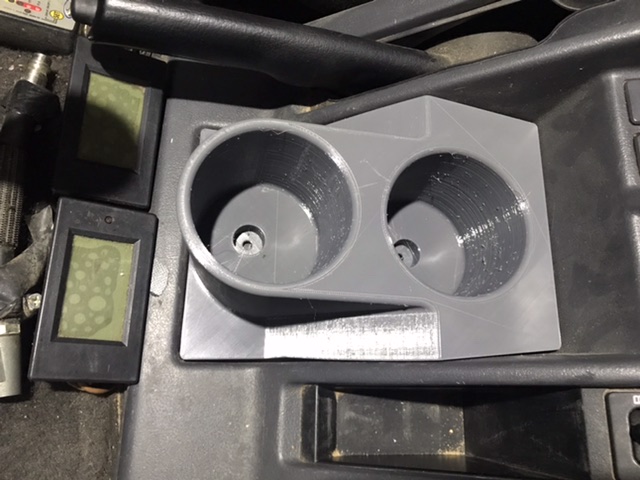

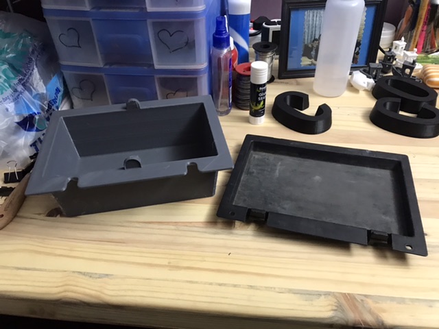

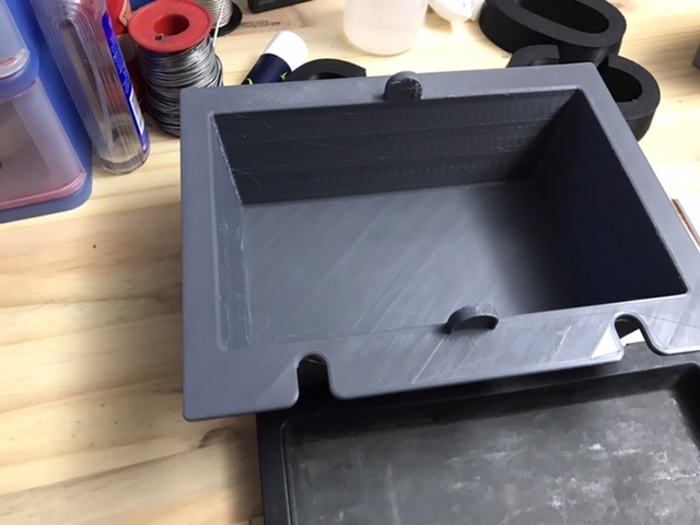

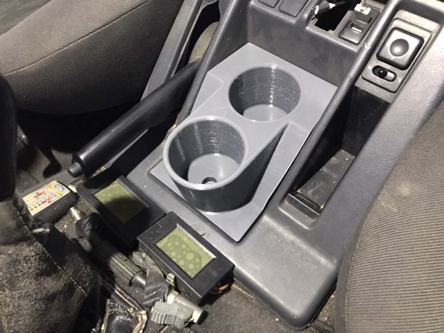

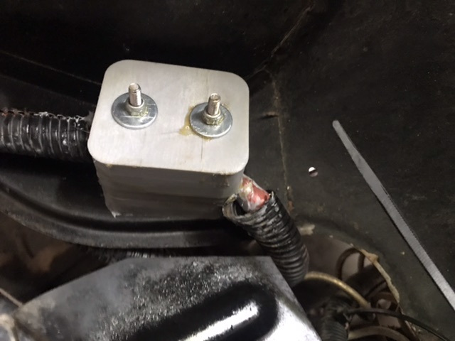

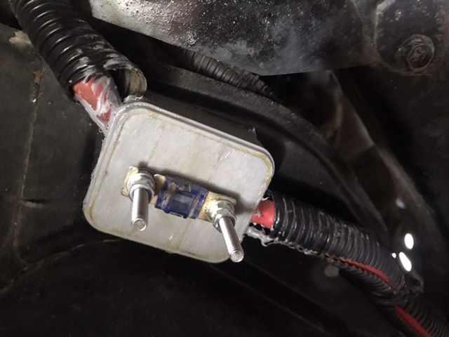

Cupholder was on top of the list and I kept getting voltage drop to the rear battery and figured out it was the exposed connection at the fuse. So I 3D printed some solutions.
I also printed a deeper tray for the center console.

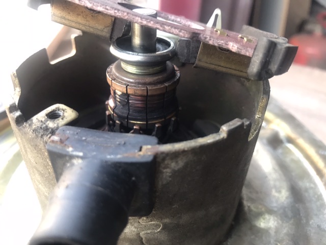

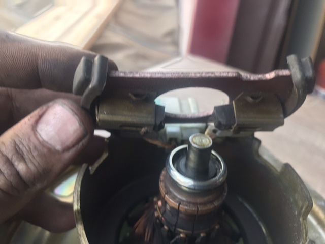

2 Days into Kgalaghadi...NO AIRCON :huge:

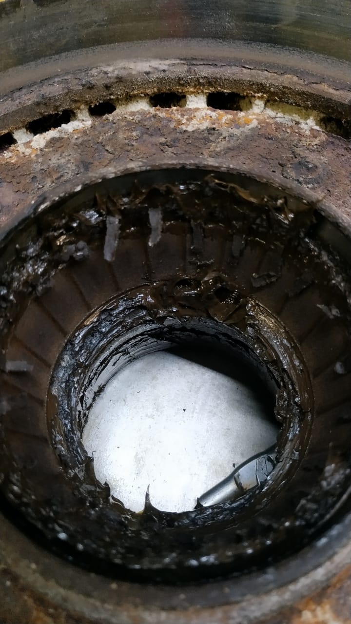

Turns out the motor turned so much in its life that the brushed completely wore out the commutator, I did a bush fix and turned the rubbers holding the brushes around so they would touch a different part of the commutator. Gave it about 2 more days of life but after that is was moeg. :doh:
The replacement I got from Oom David one can see has a lot of ware aswell, seems the compound the brushes are made of on the GQ's is to hard and thus wares out the commutator that is not reconditionable instead of the brushes that is easily replaceable. So if you cannot life without an aircon and your GQ mileage is getting up there, check them. :oldtimer:

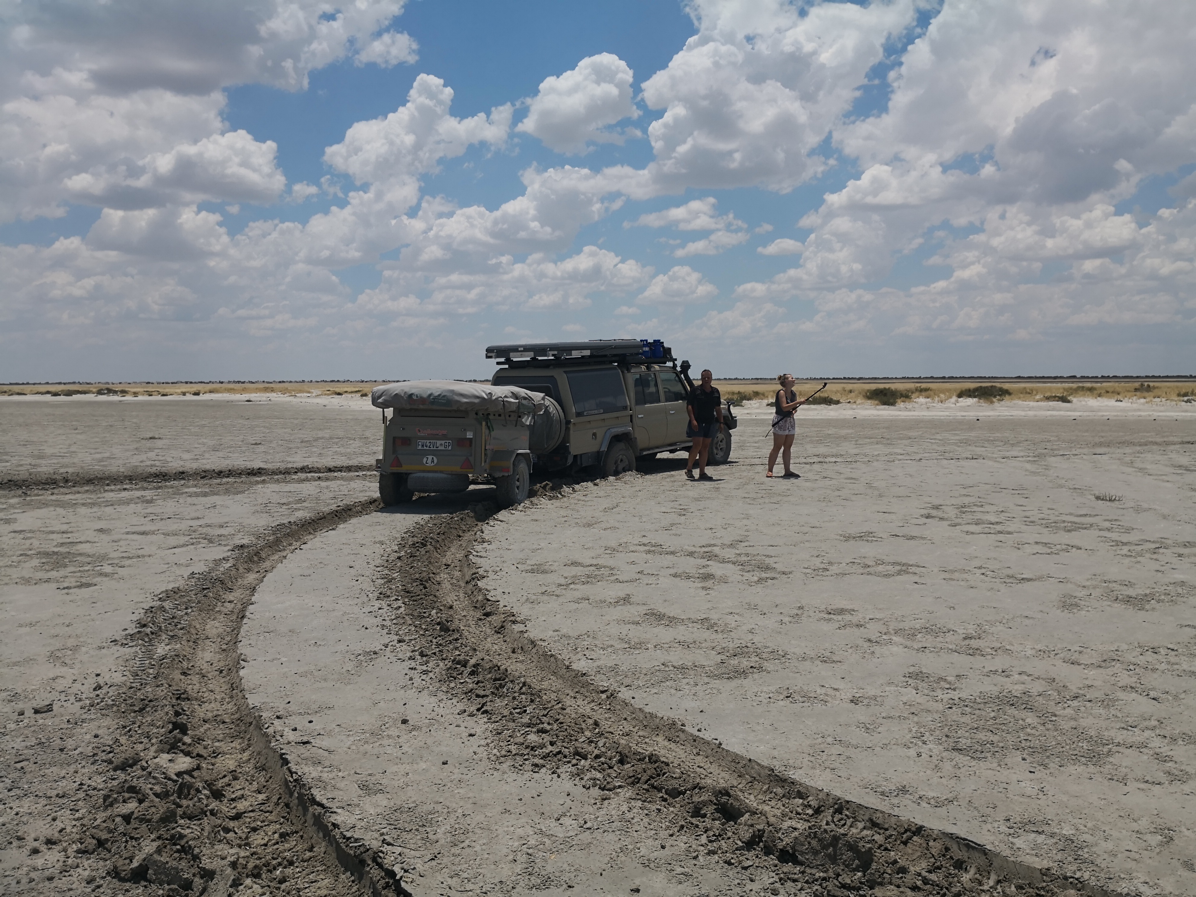

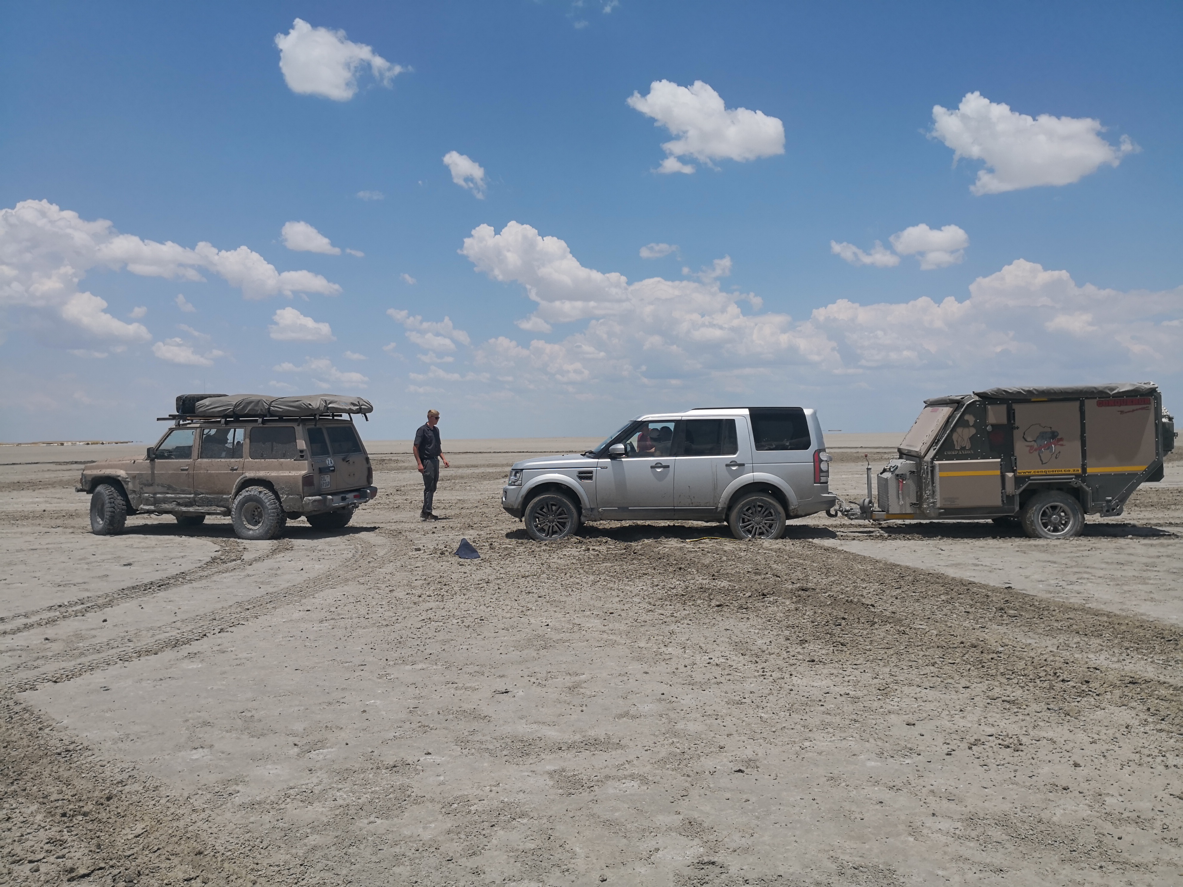

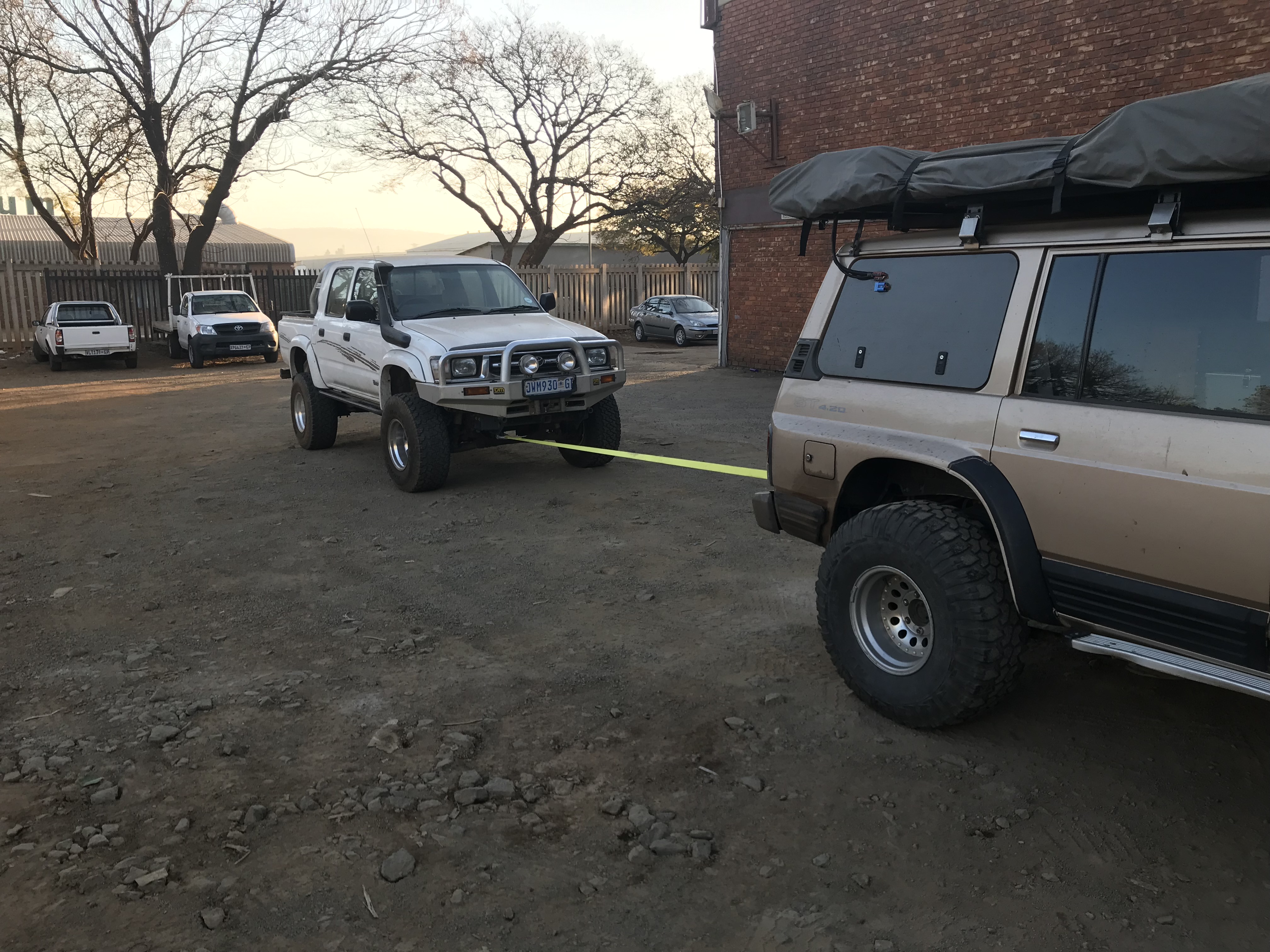

Then I pulled a Discovery and conqueror trailer around in some deep sand which was fun and Spotted a shorty.

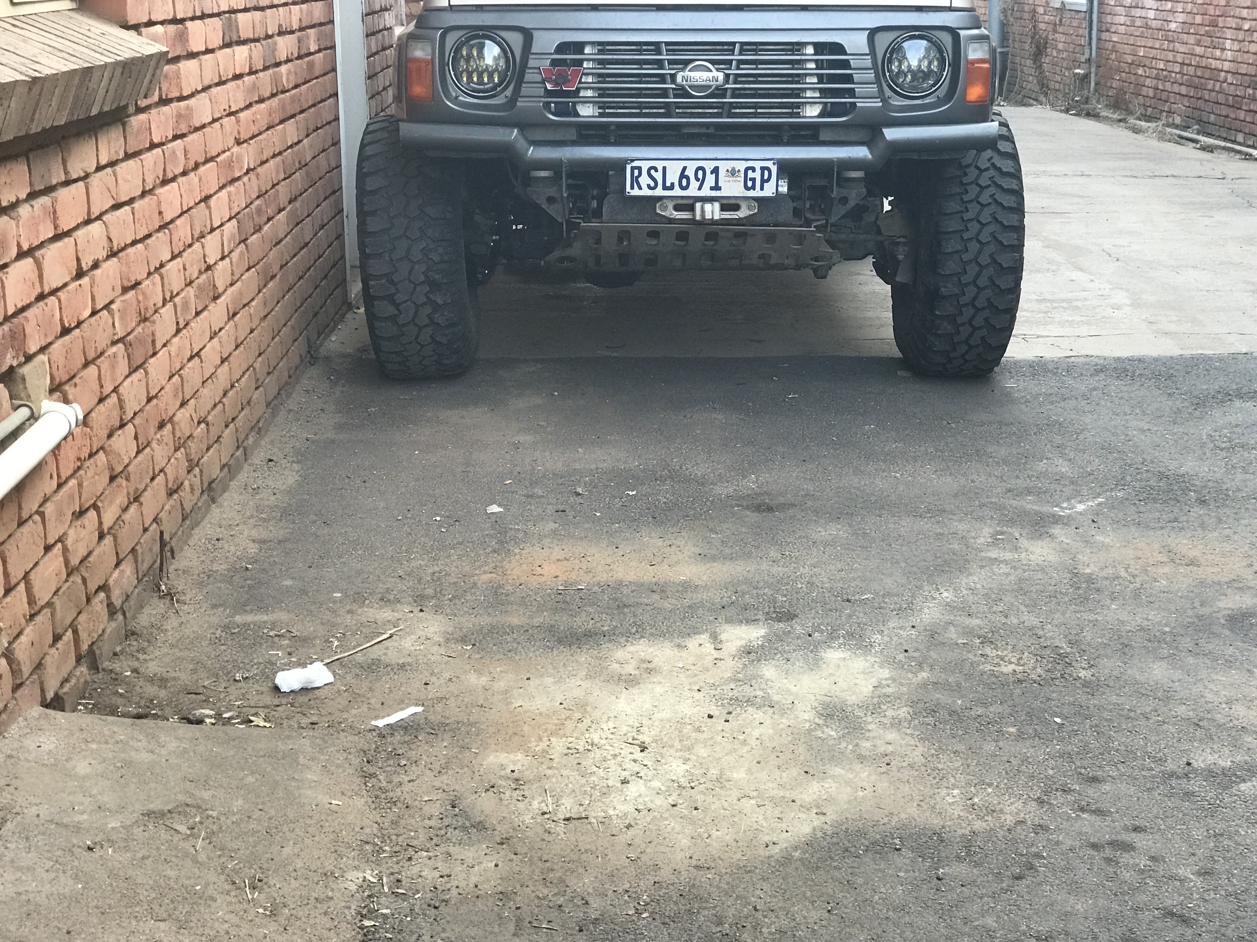

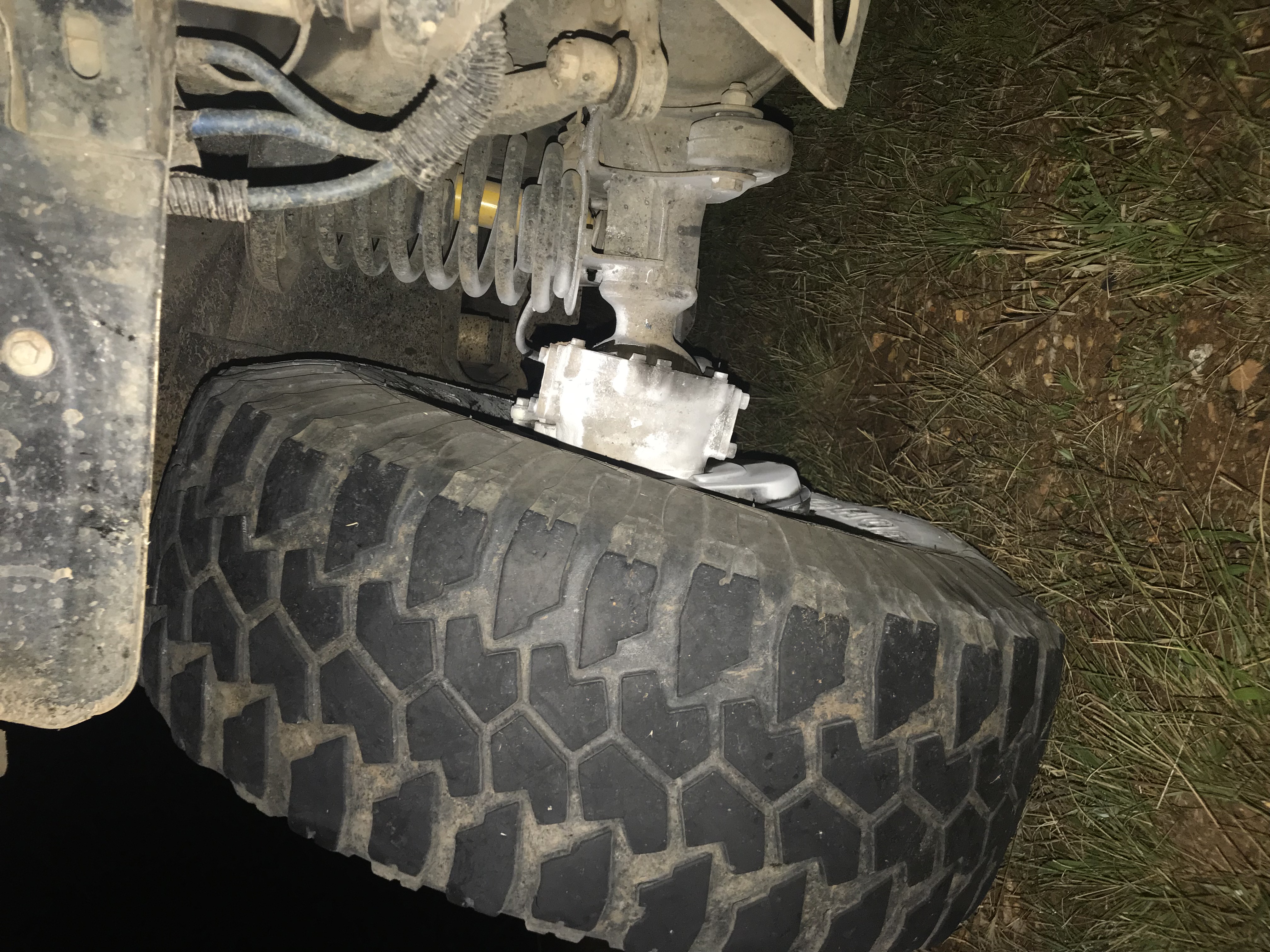

At Kang the fuel situation needed attention aswell as our stomachs. While filling, the attendant asked me what is going on underneath my car?
As I looked I realized the worst had happened. Because I fiddled :surprised:
One of my oil cooler pipes had shaved through somewhere. Luckily I did pack Oil, connectors and extra pipe but tension was to high, engine to hot and tummy to empty to address the situation right away. Luckily there was still oil at the tip of the dipstick so I was hoping for the best.
After lunch I gathered the courage to tackle the problem, first up was to determine where pipe had a puncture. So i was in the bonnet inspecting the pipes and asked my friend to briefly start it so that I can see where it is squirting from. Under normal circumstances one would first check if it was in gear and then start. :naughty: but no no, not today. Today we just give the key a flick and this patrollie is always eager to get on the road so it literally starts with just a flick of the key, problem number 2 is that it can start like that in gear aswell. Good thing I was mostly inside the bonnet than in front of it so things were mostly under control. :thumbup:
Well we got things leak free again and back on the road, unfortunately the garage's paving wont be the same again, poor Land Rovers, owner probably thinks it was one of them again. :flying:

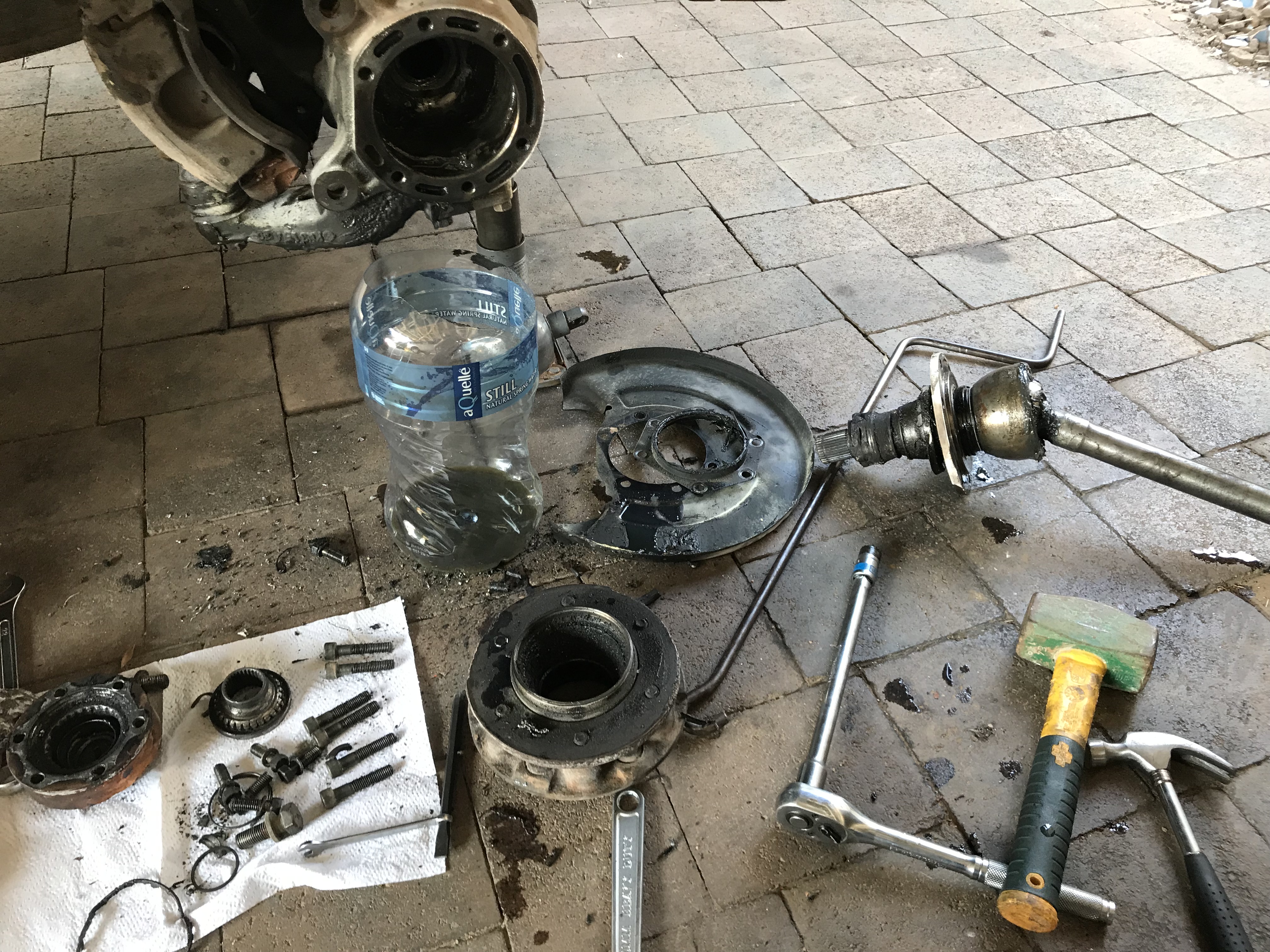

Sitting at De Hoop in Richtersveld I noticed a wet spot on the ground that didn't seem to dry up... so I was sitting one morning drinking coffee when I noticed something dripping underneath the car. :doh:
The diesel tank had a crack, so I took a bottle and roughly measured the rate at which we were losing fuel. I wasn't more than 5 liters per day so I sacrifised a water jerrycan and filled it with 20 Liters just for in case things got worse.
