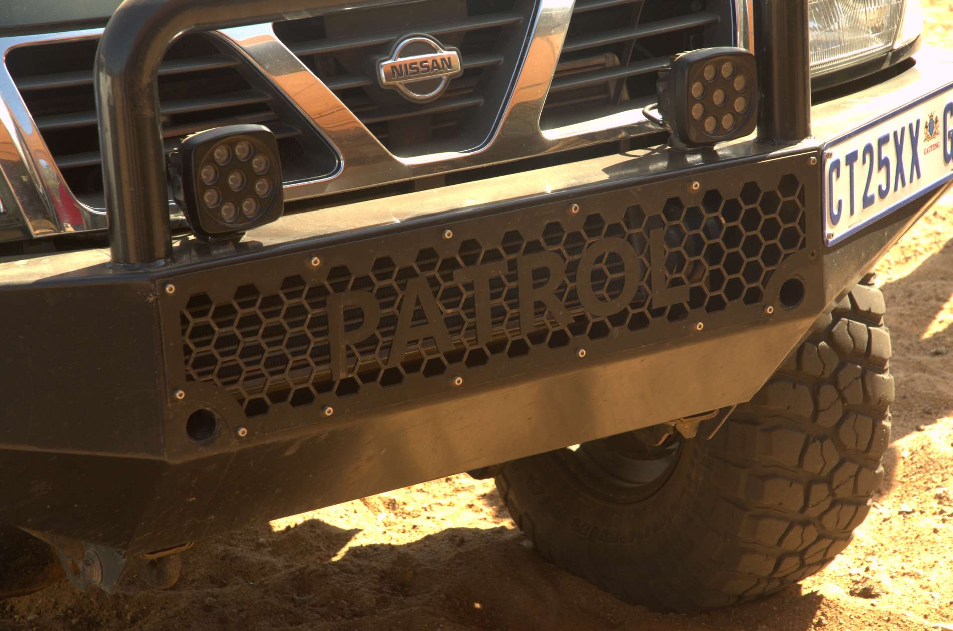

On the body side of things I have fitted my new "PATROL" plate for better air flow over my intercooler and also fitted a set of LED spots and I think they look very cool!

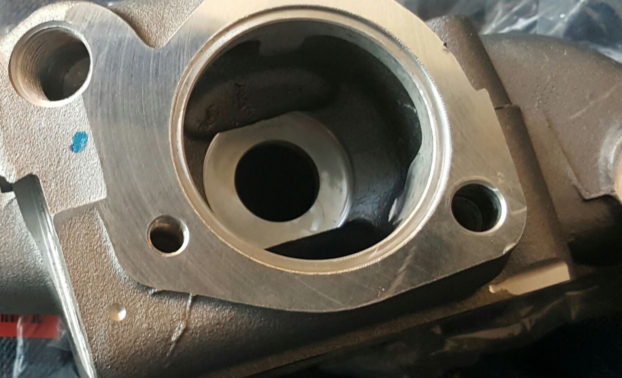

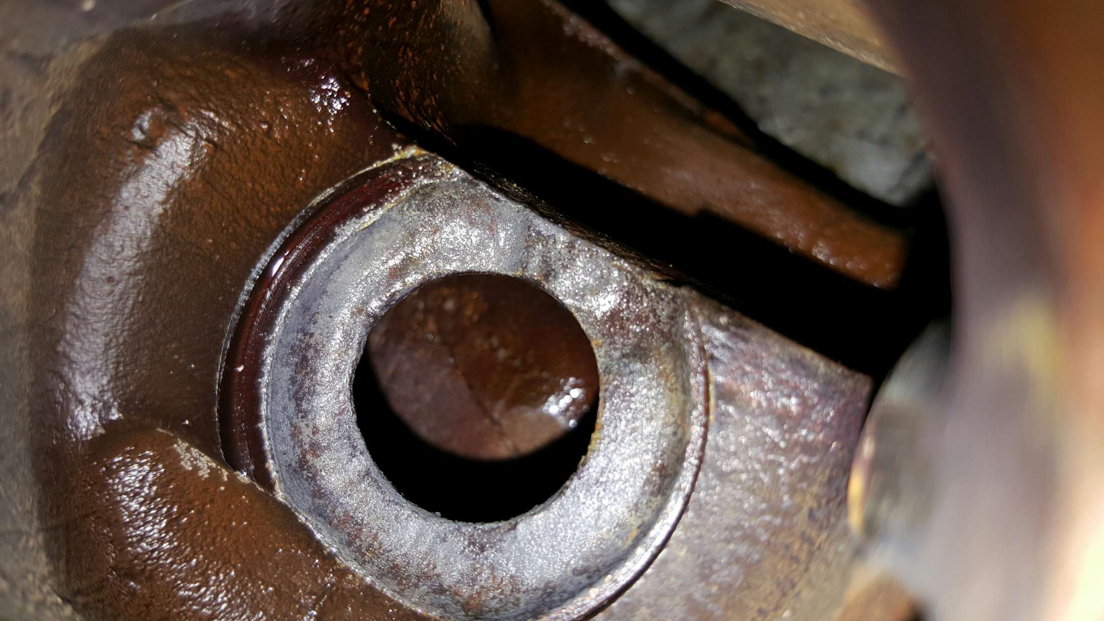

My second and biggest problem was the thermostat housing, I was shocked to see what the state was of the housing and this explain allot of my heat issues. The bypass hole was almost completely corroded away and because of this the thermostat could not close off that hole when fully opened. This meant that all the water was not passing through the Radiator.
So I got a new housing, new viscus, new/second hand fan blade, new water pump (thought I might as well get one as I used the old one when I rebuilt the engine), new proper anti freeze as my old ones were rubbish.

Here is pics of the old and new housing
- New Housing
- Thermostathousing_new2.jpg (122.93 KiB) Viewed 4088 times
- Old Housing
- Thermostathousing_old.jpg (224.21 KiB) Viewed 4090 times
