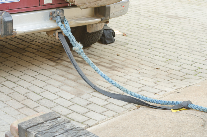

rvanrooyen wrote:Thanks, Peter.
Do we have any reference to a video or illustration of how to use the standard fittings at the back off the Patrol for recovery? I have a half circle type fitting just under the back door, but what and how to use it I don't have a clue.

Is it the standard 1/2 circle "recovery" loop? I would recover a BMX with that. Do yourself a favour and undo the bolts then have a look at the thickness of the metal and the welds holding it in place.rvanrooyen wrote:Thanks, Peter.
