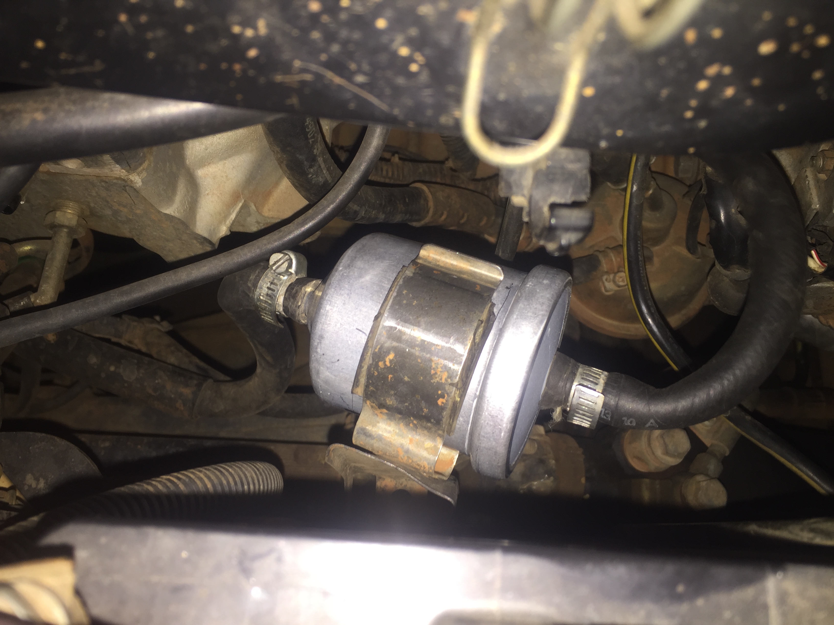

The GUD fuel filter with the straight piepie, not bent, is E13. I quite like the idea of the bent piepie though and must remember that for future reference. Pretty sure that would be easier to manoeuvre back into position

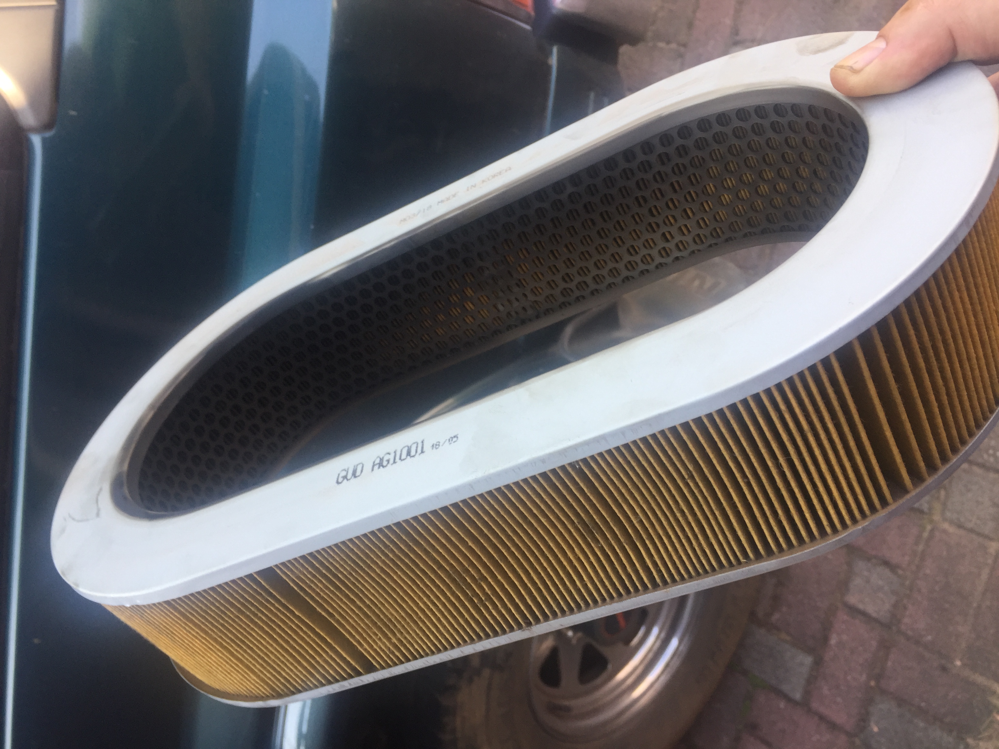

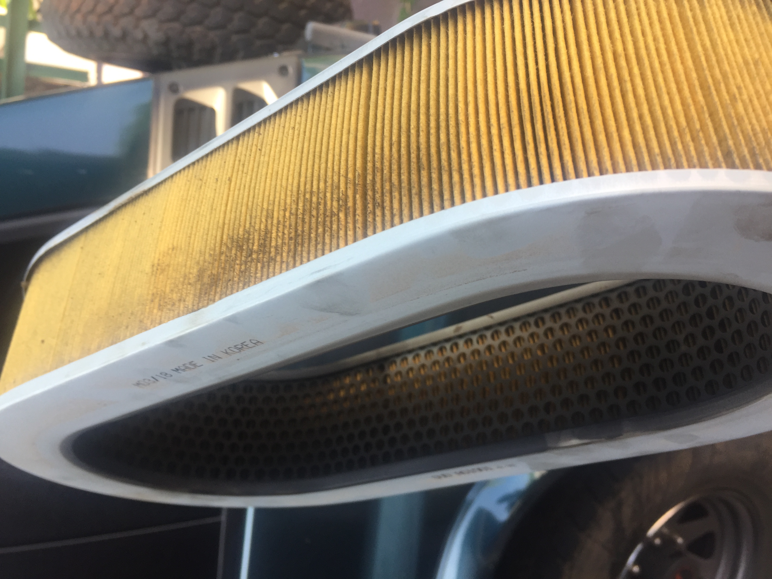

Peter Connan wrote: 28 May 2022 06:51 Fanus, the number I gave you is either FRAM or GUD. Just can't remember which.
It is gud ag1001 :salute:
Midas didnt have in stock, mine is quite dirty though.
Will have to look somewhere else....
Or can it be cleaned? :think:

My local Midas orders me the AG1001 when they are out of stock, they never take more than 3 days to get it

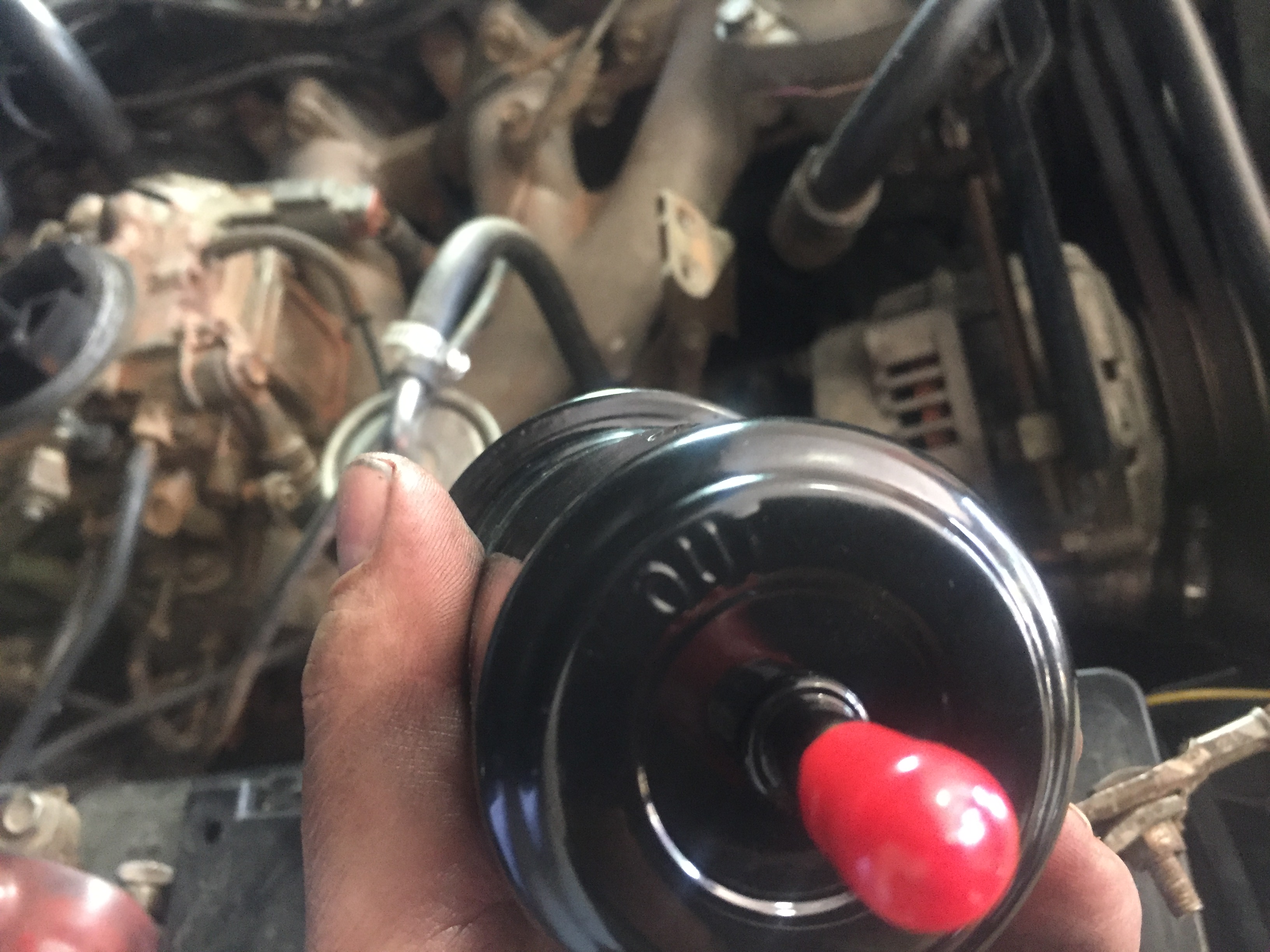

SJC wrote: 28 May 2022 11:03 Fuel filter currently in vehicle is a fram g5237.
Was no stock in this exact filter so got a Luma ff100.
This luma filter is not going to work. The direction is swapped.

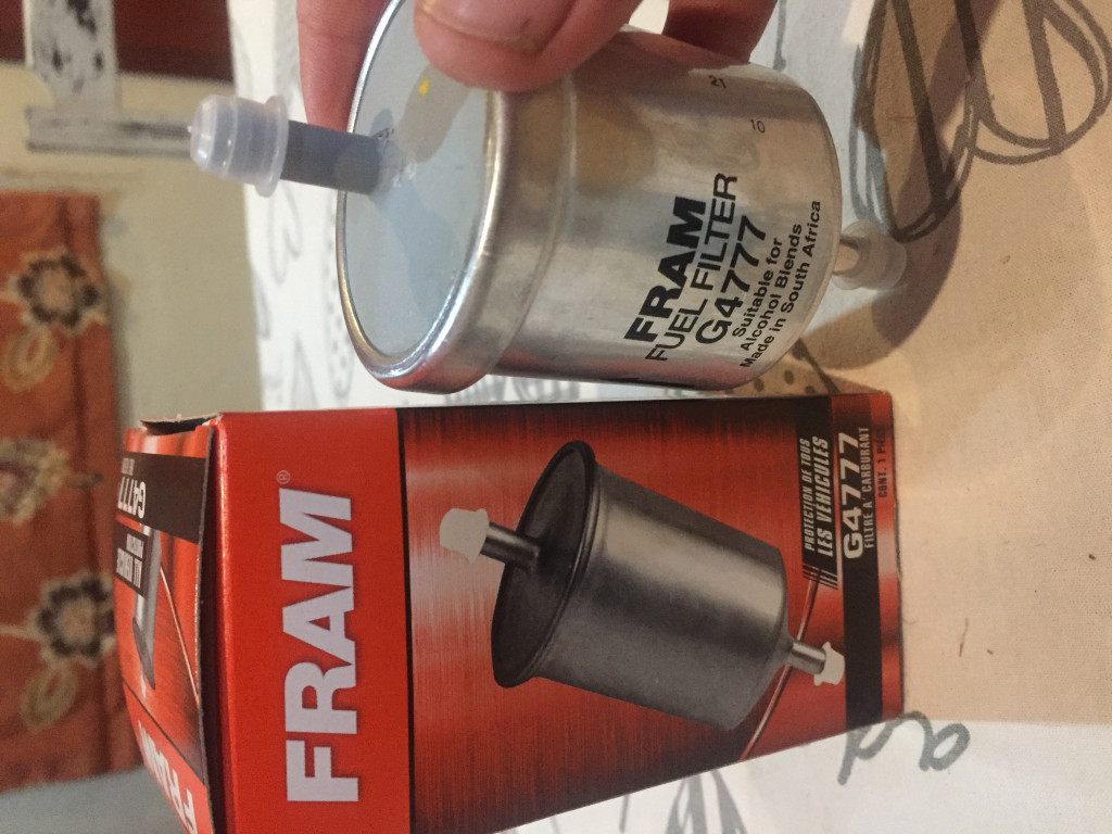

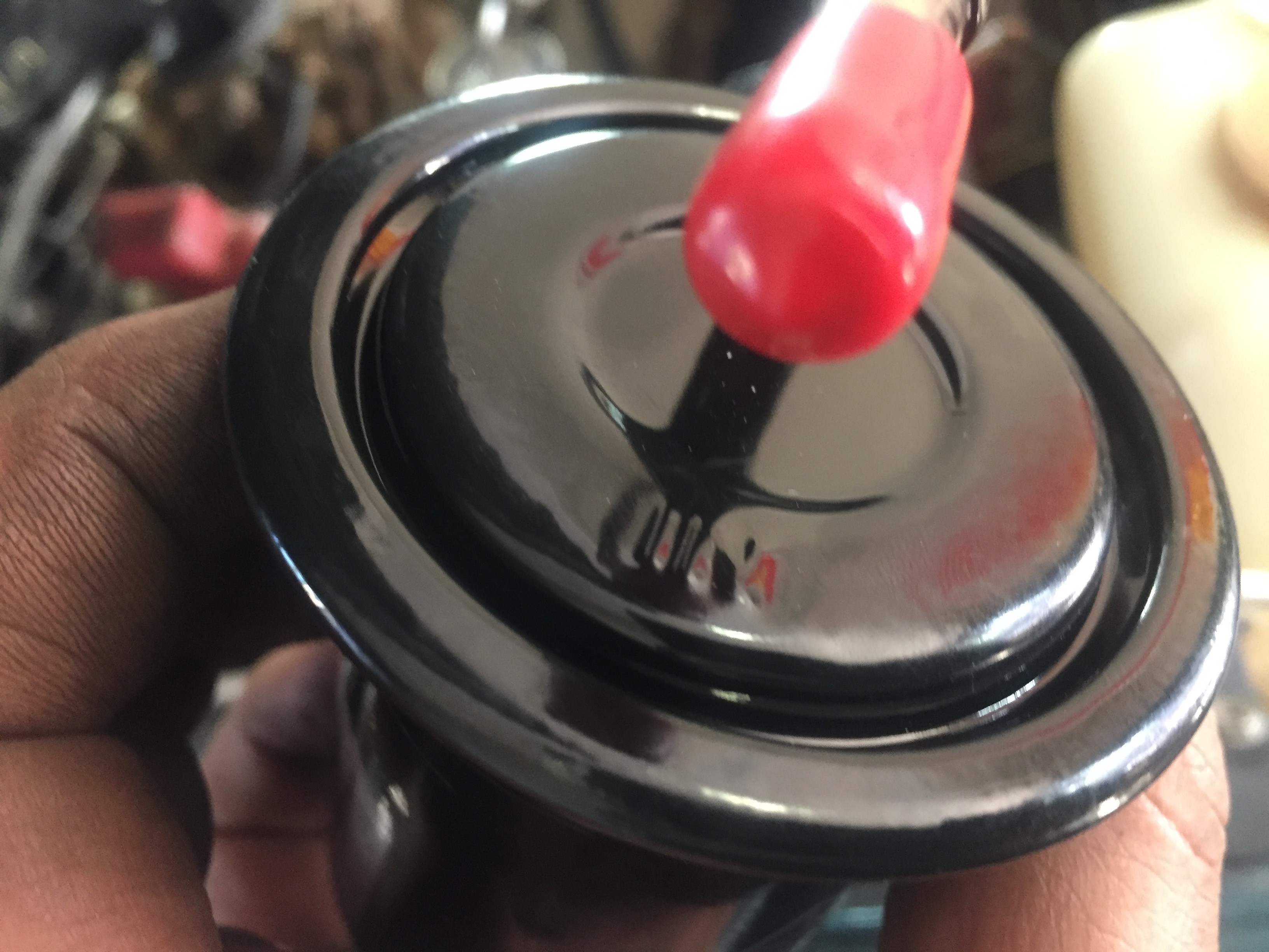

Spike wrote: 28 May 2022 12:01 The GUD fuel filter with the straight piepie, not bent, is E13. I quite like the idea of the bent piepie though and must remember that for future reference. Pretty sure that would be easier to manoeuvre back into position
Ended up getting the Fram g4777 (e13).
My old filter is metal all the way around, this one is plastic at the top.. :think:

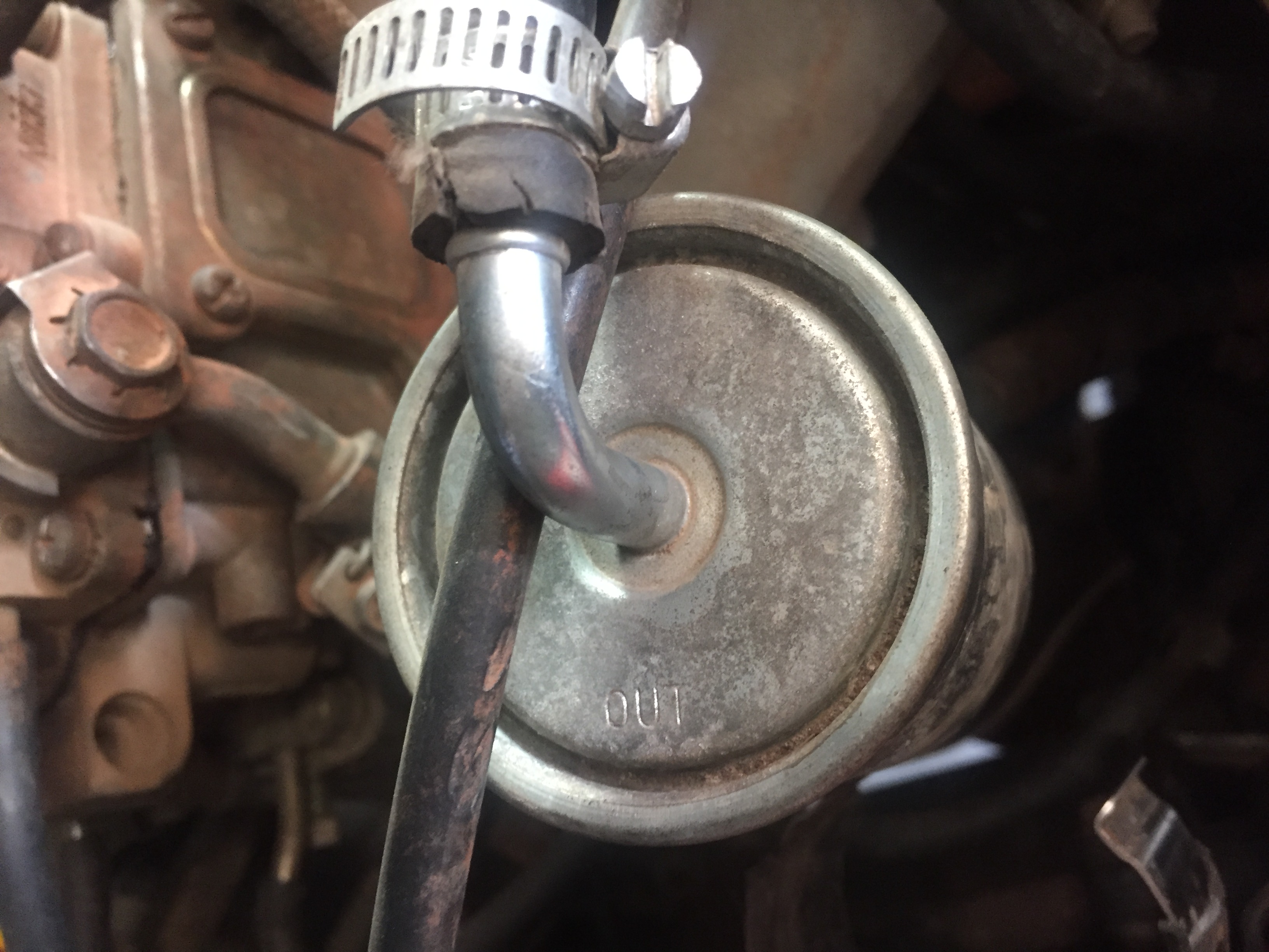

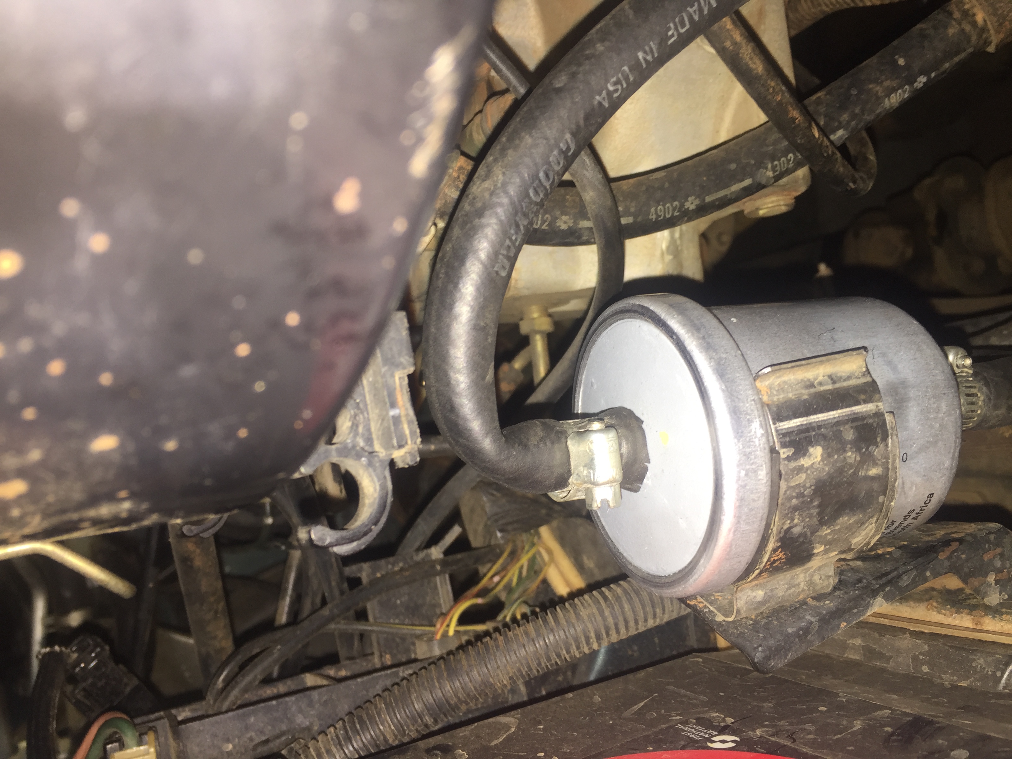

Eish this bend in the pipe...
Fixed. :wink:

Re: SERVICE ITEMS
Find a spring that fits fairly nicely around the pipe, that will stop it kinking.
Or fit a longer pipe
Or move the filter.
