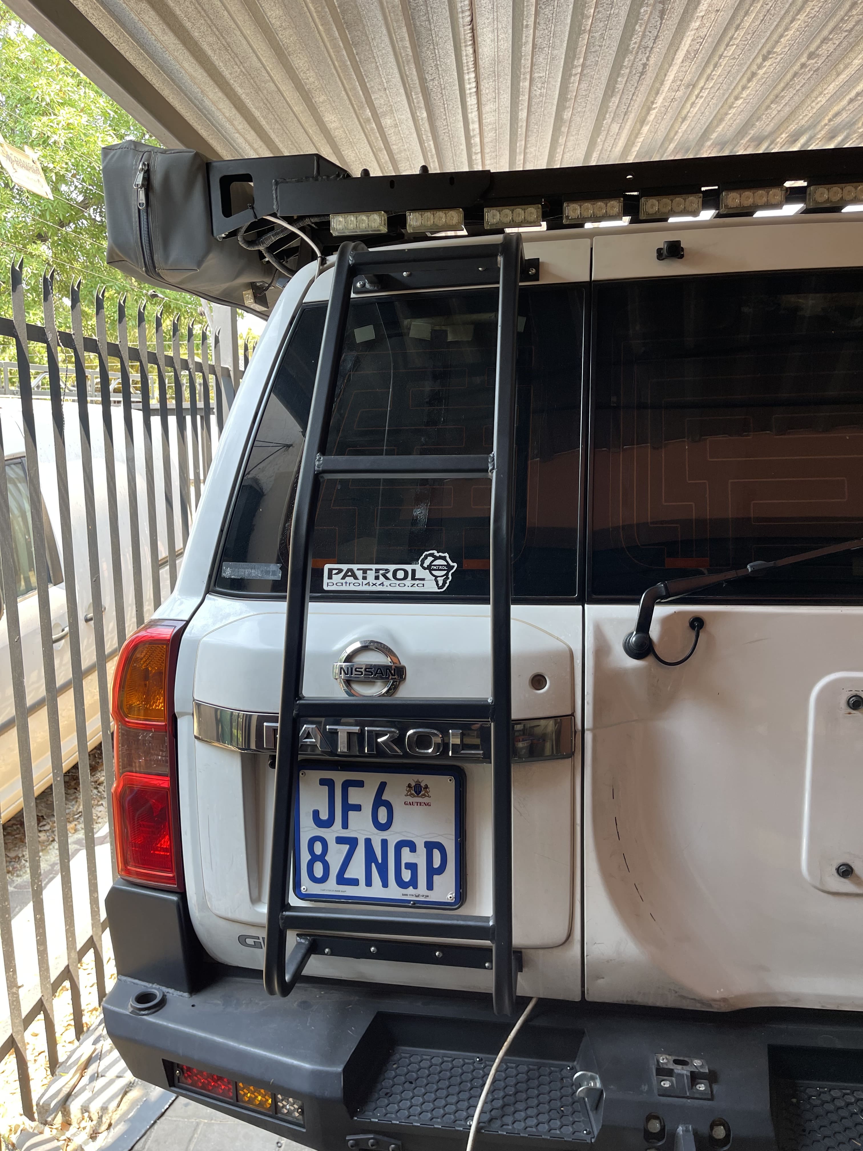

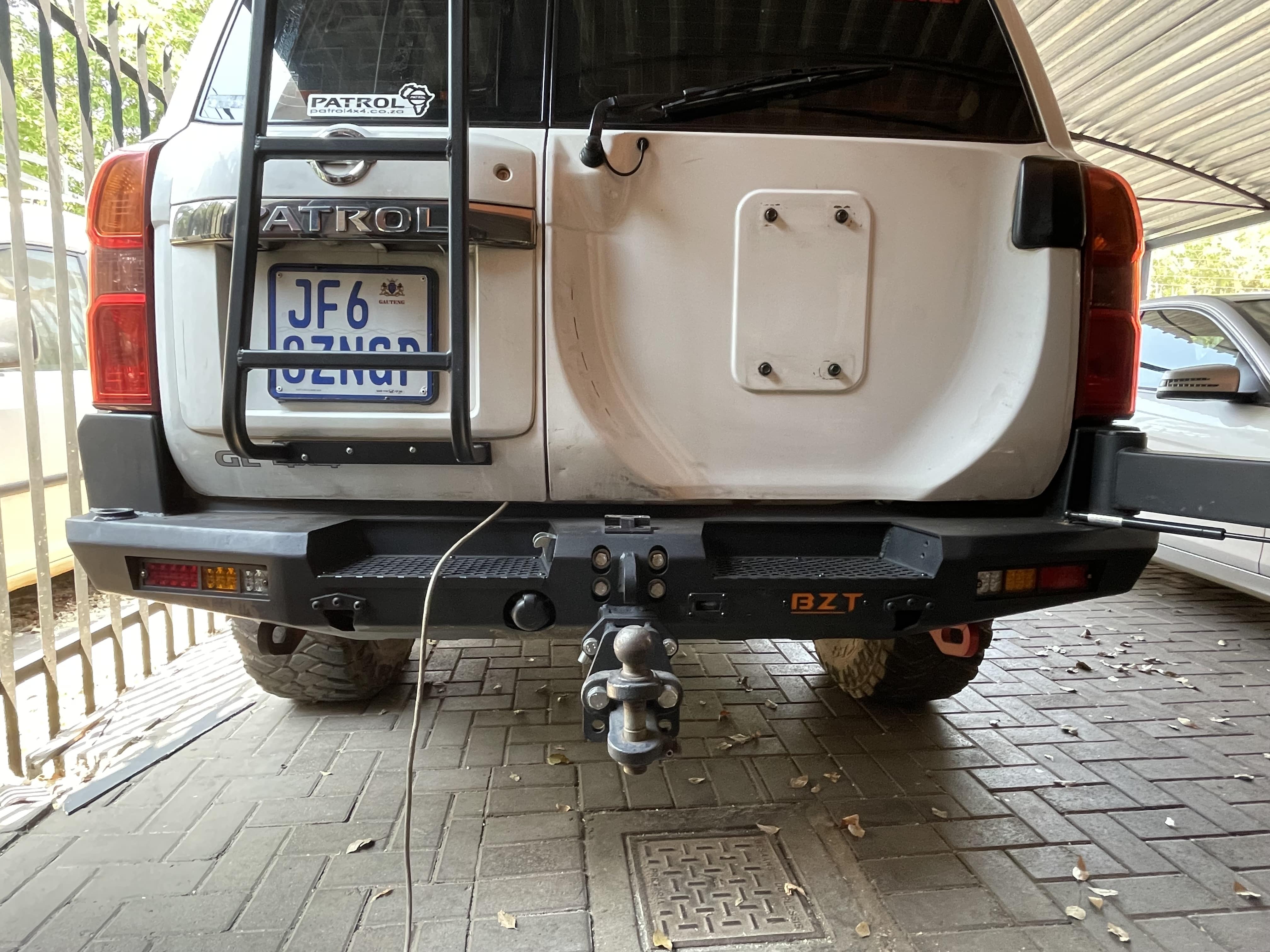

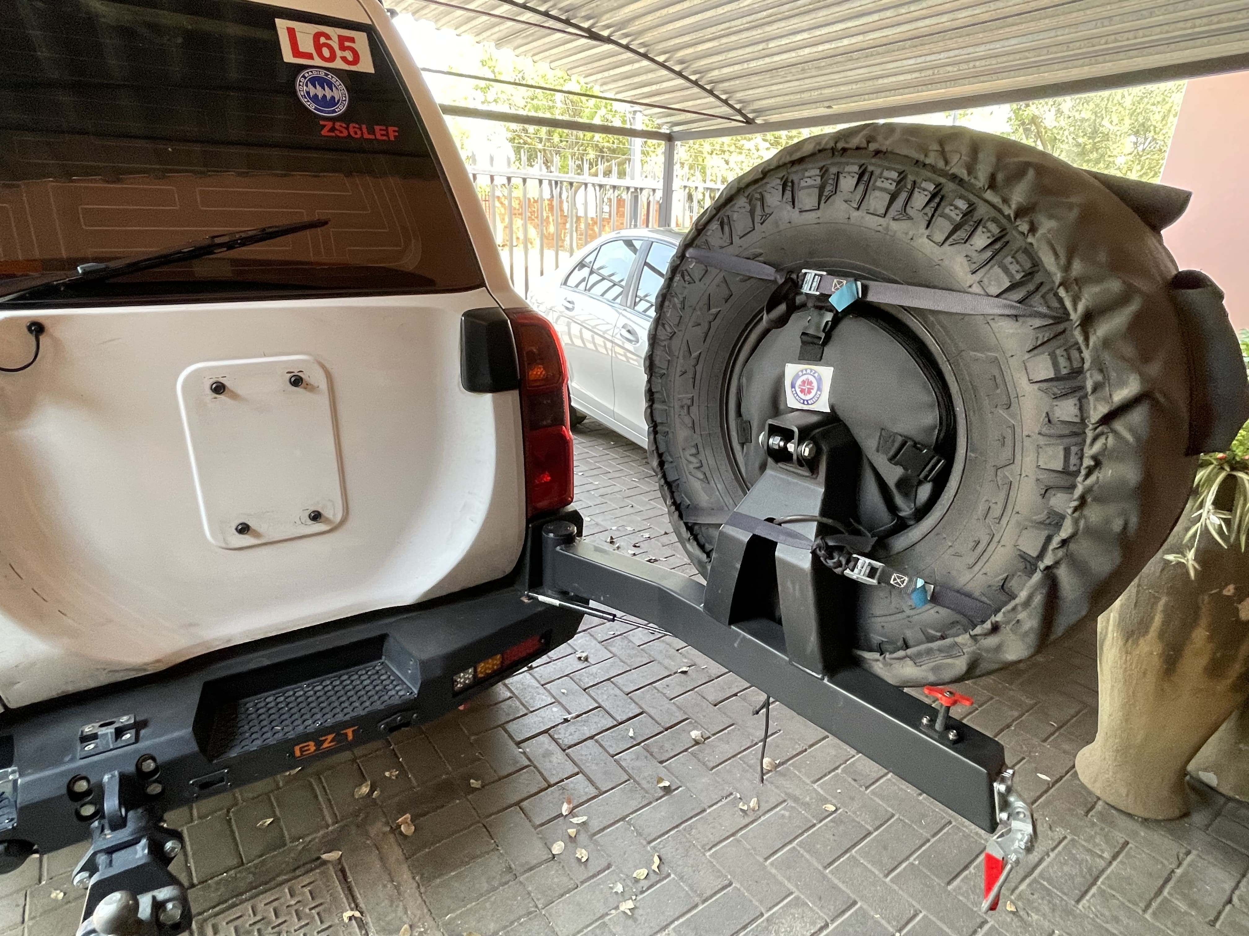

Let's start with the rear/tow bar. I managed to bent the refurbished Burnco rear bar at a SARZA event when I towed a Megabus off a gravel hump the engine in the rear was caught on. Tuffstuff approved an insurance claim and the refurbished towbar was replaced with a towbar and spare wheel swing arm from BZT:
At the same time I had the rear ladder added:

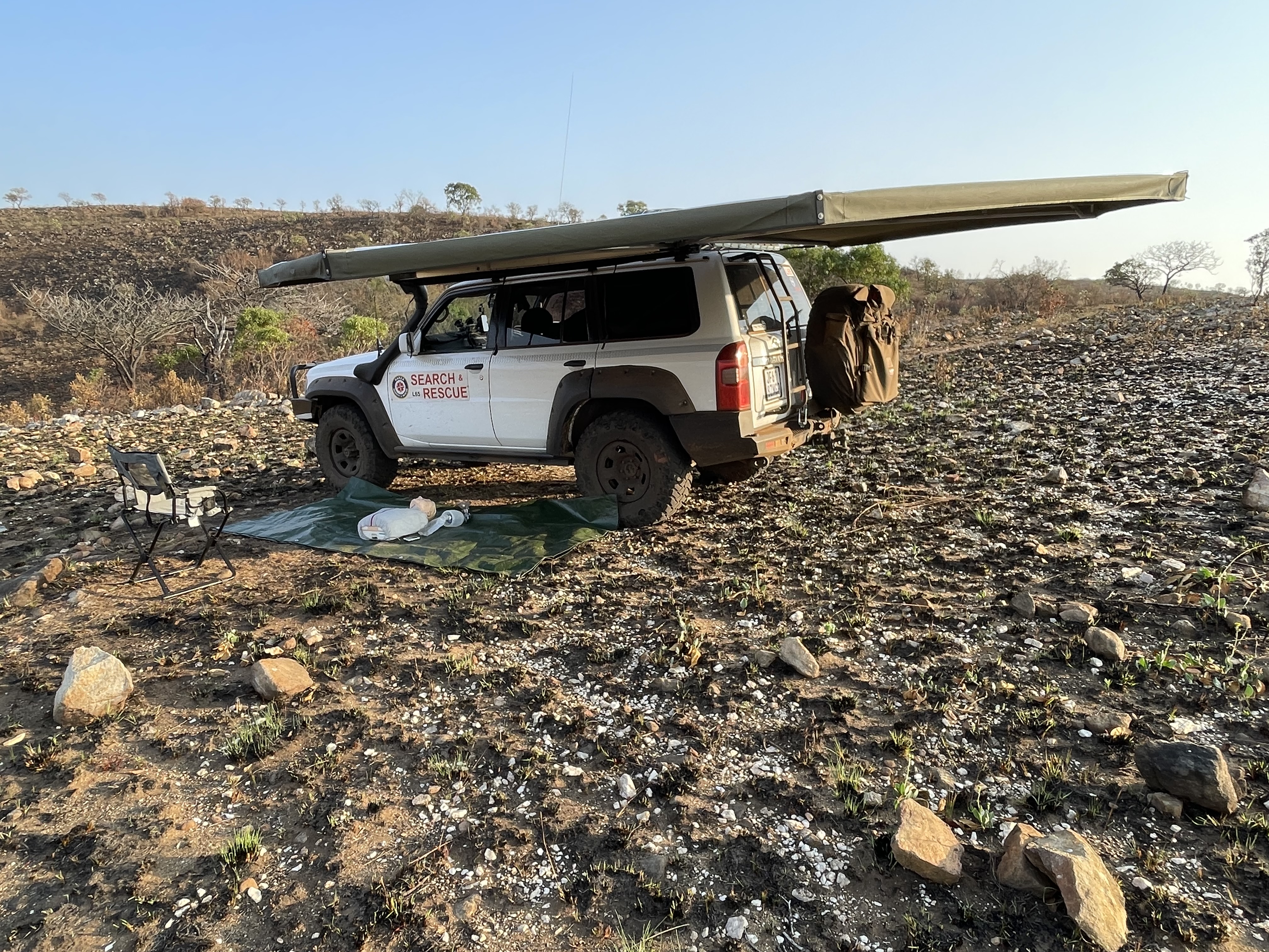

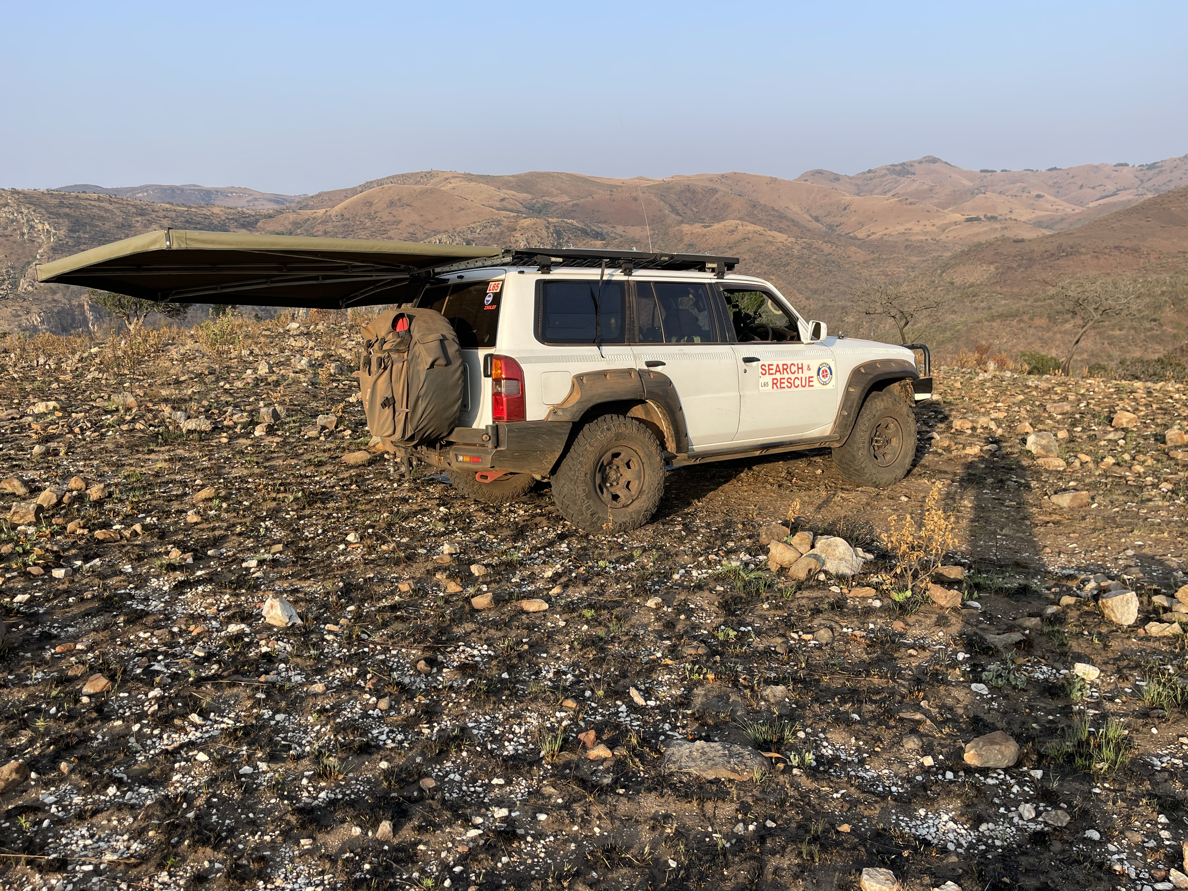

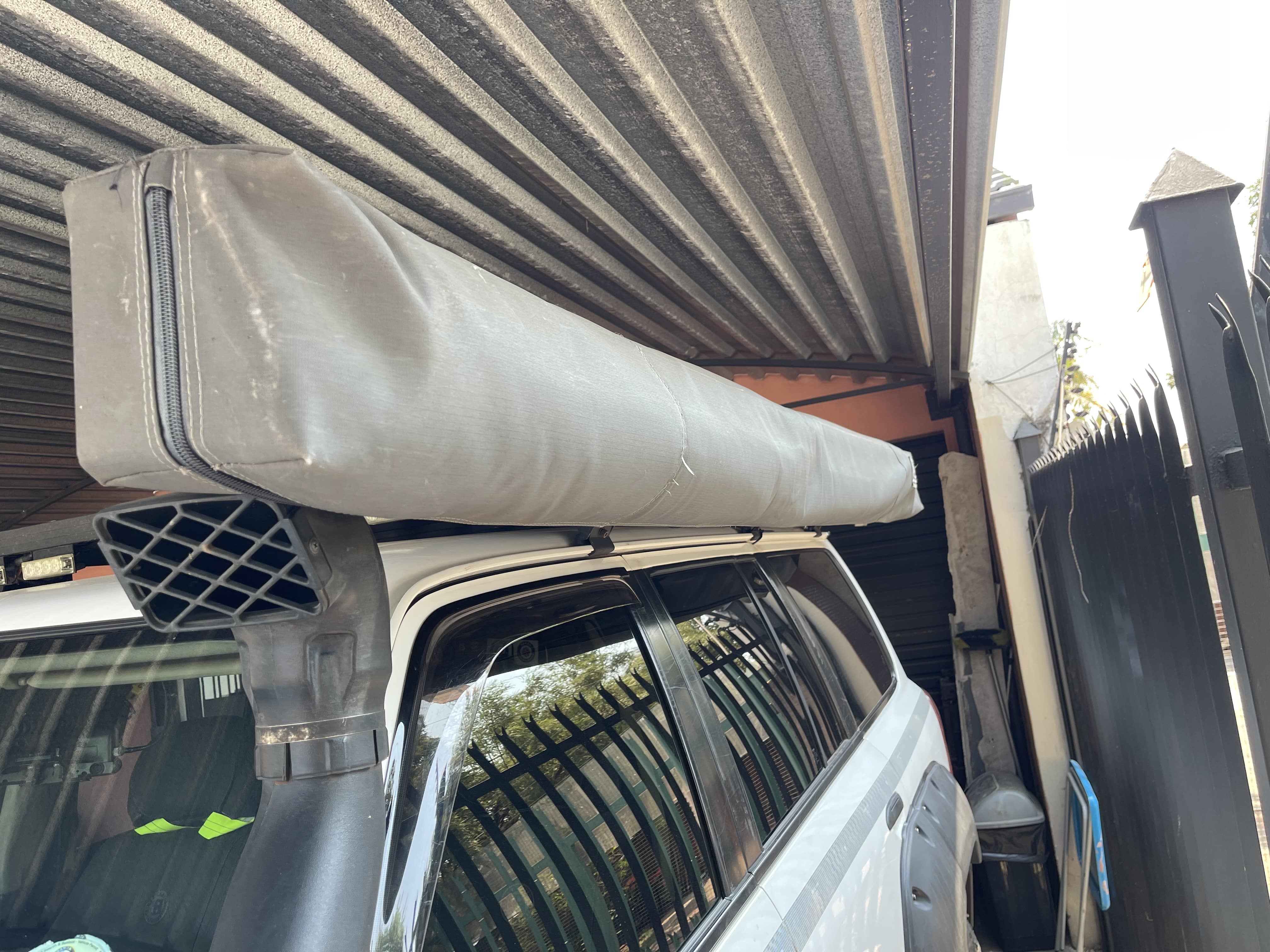

Some time ago (think it was in 2022 shortly after the Goerapan gathering, I added the BZT awning:

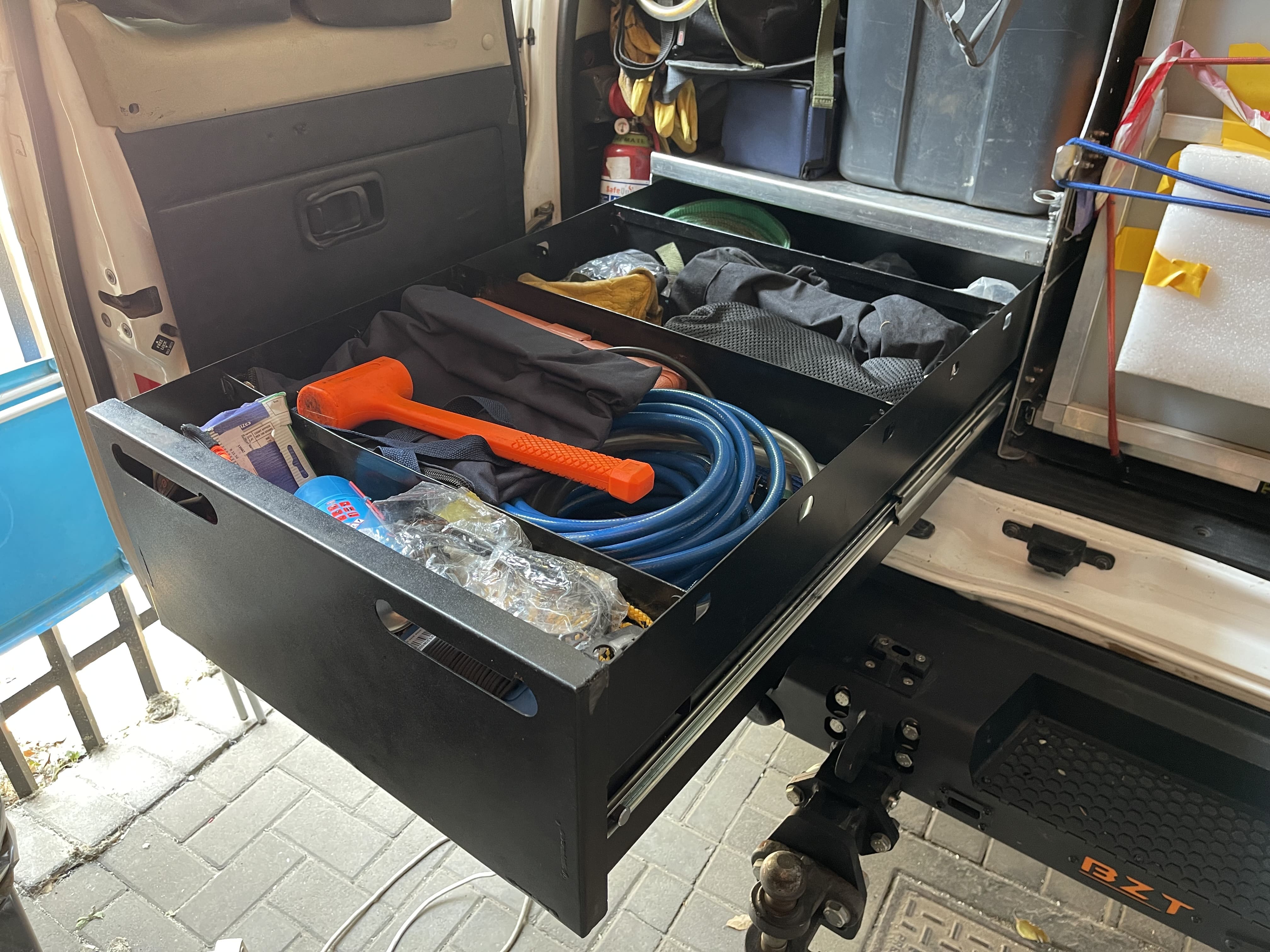

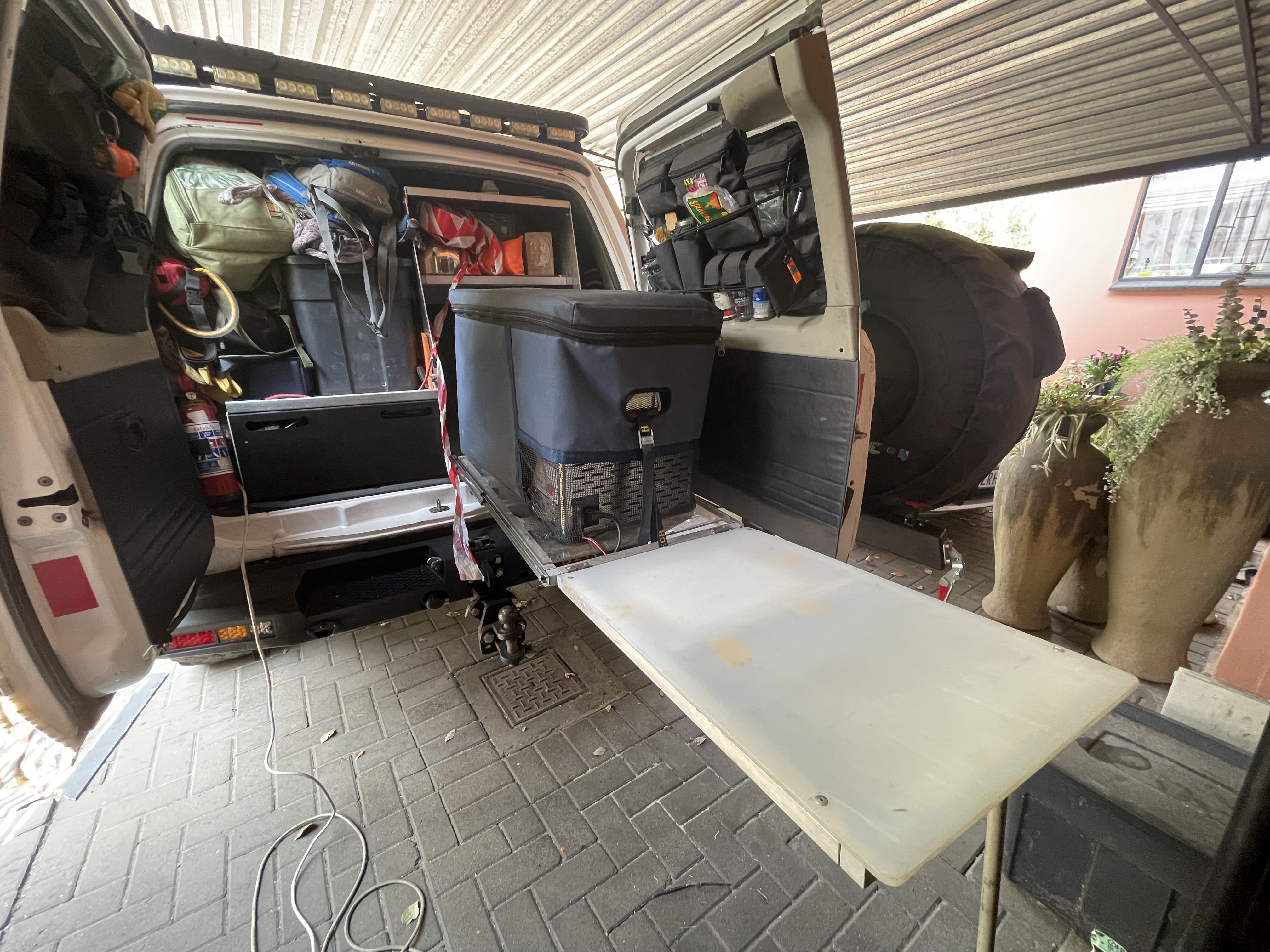

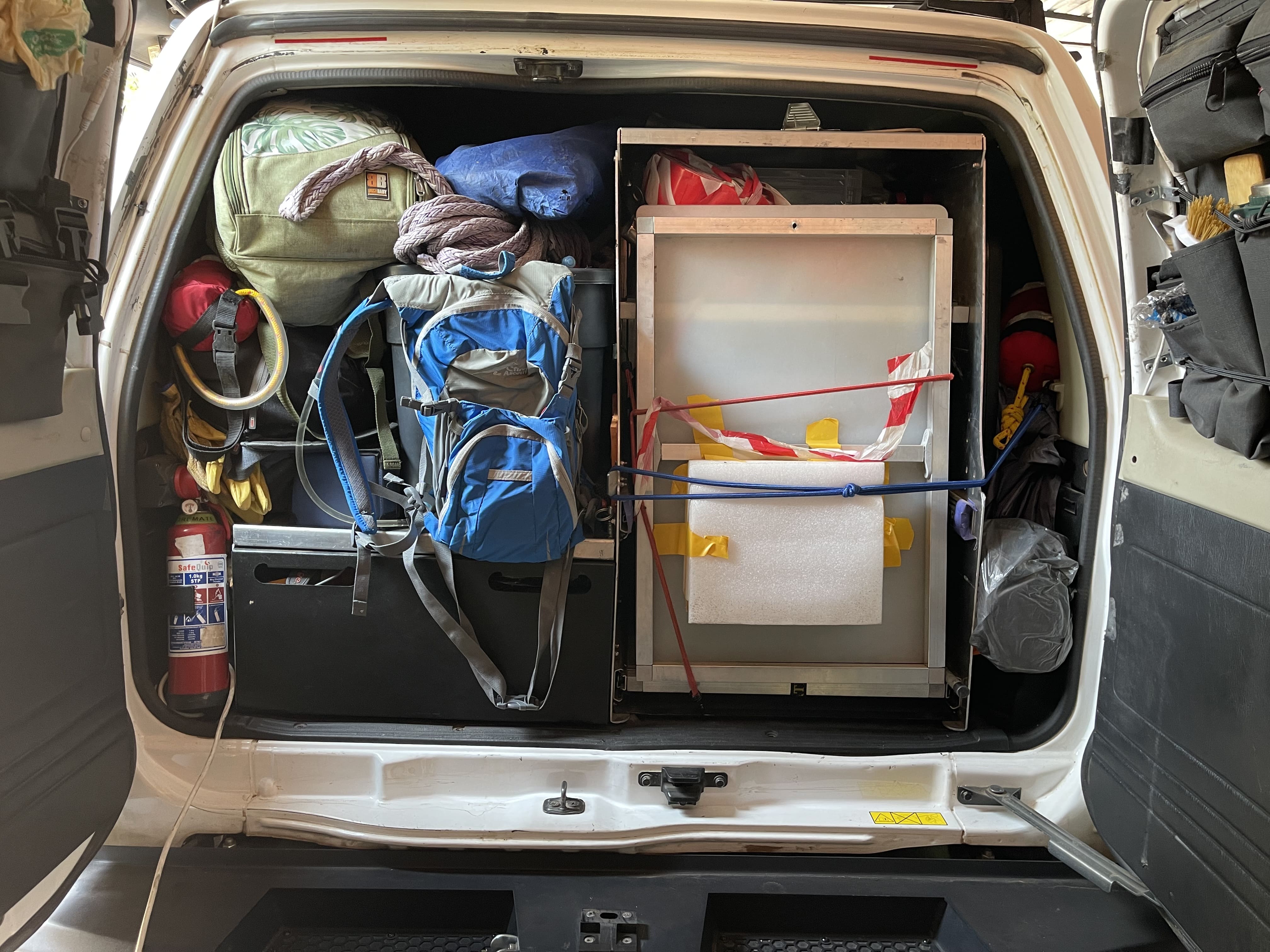

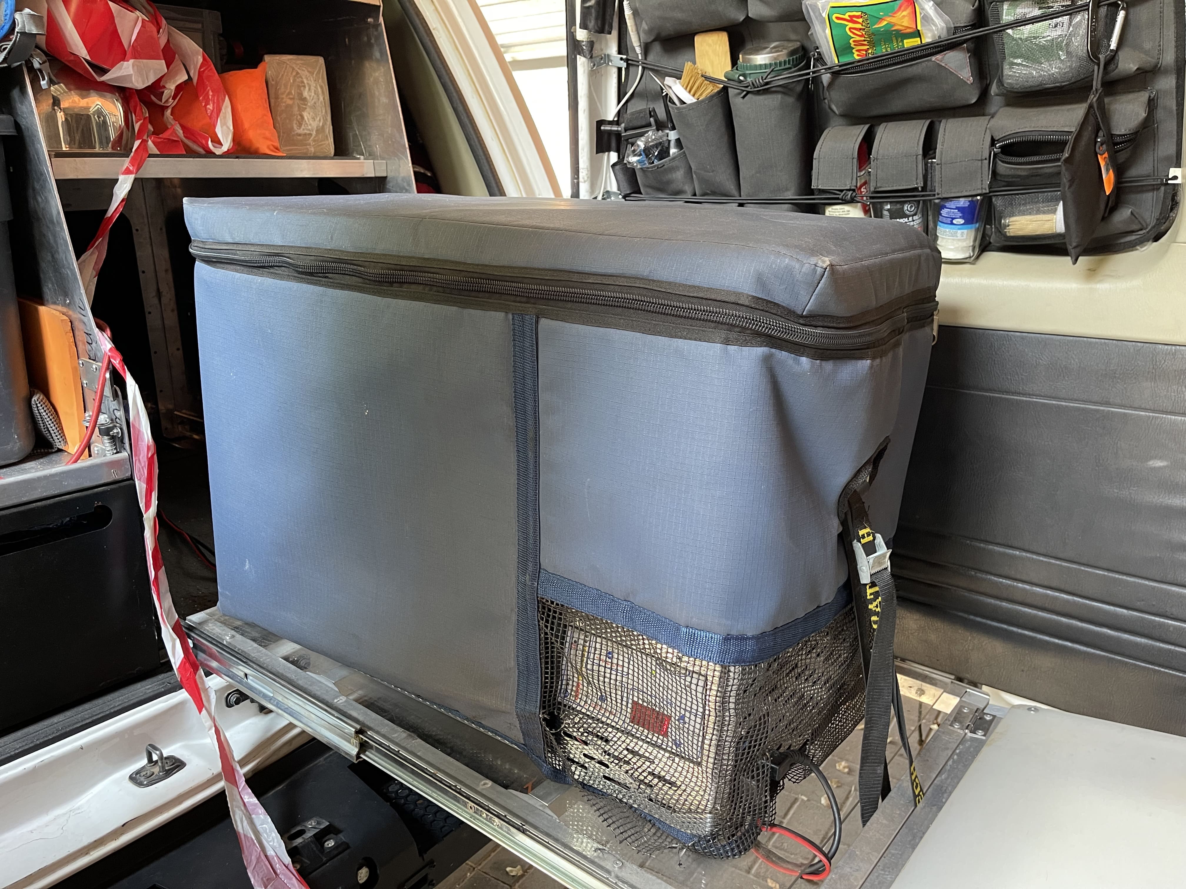

On the inside I added a drawer and fridge slide. The original design was a bit complicated where the fridge slides out and down with the kitchen drawer extended. Great idea, but as I said a bit complicated to execute. So I removed it and went for a straight slide in and out for the fridge build with 25mm connect-it all from Maizeys, also at the same time added a shelve on the top for kitchen appliance, food etc. The table just folds out secured by a single leg and so far so good:
The drawer on the left takes up all the recovery kit, tools, 12v pump, hose and indeflate:

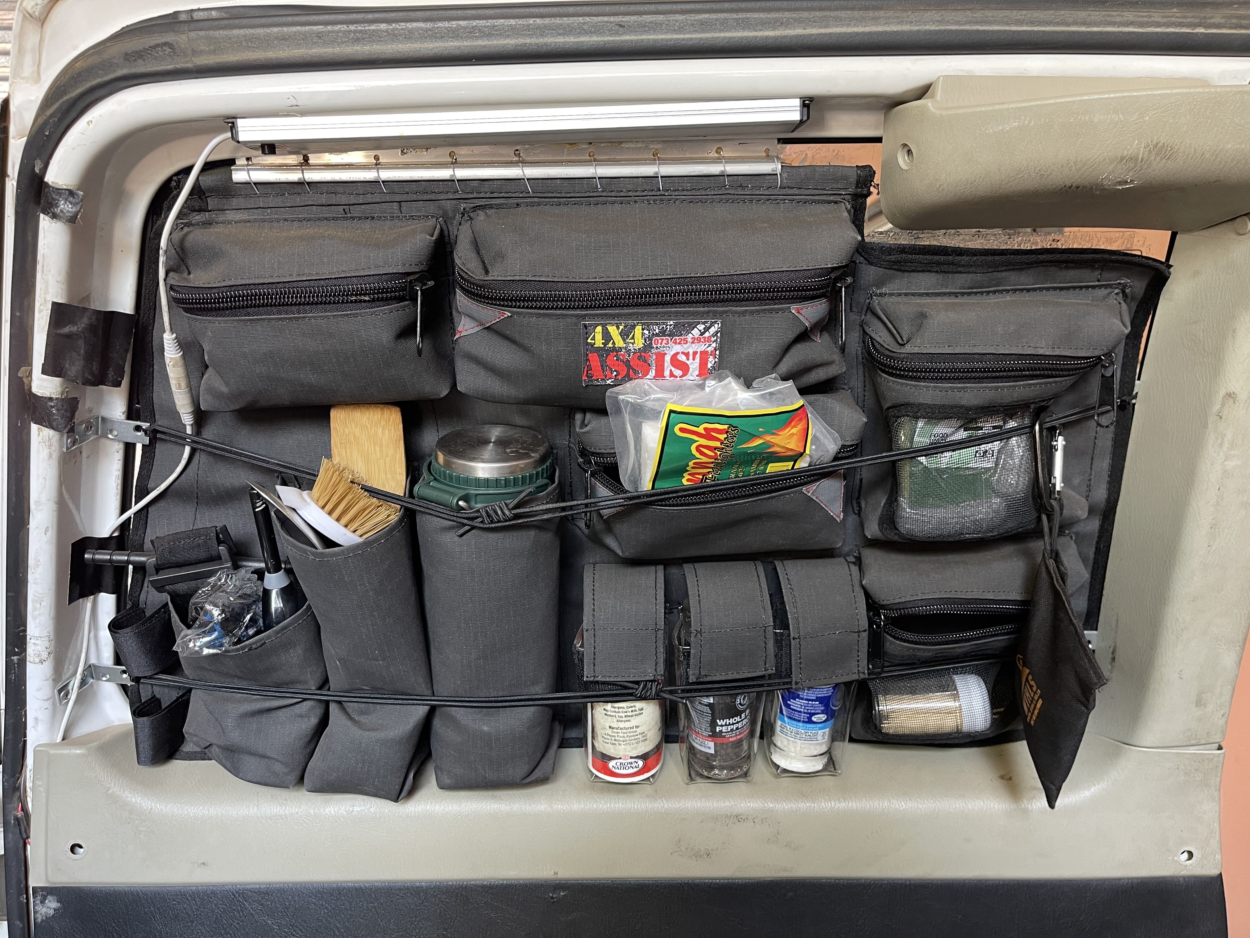

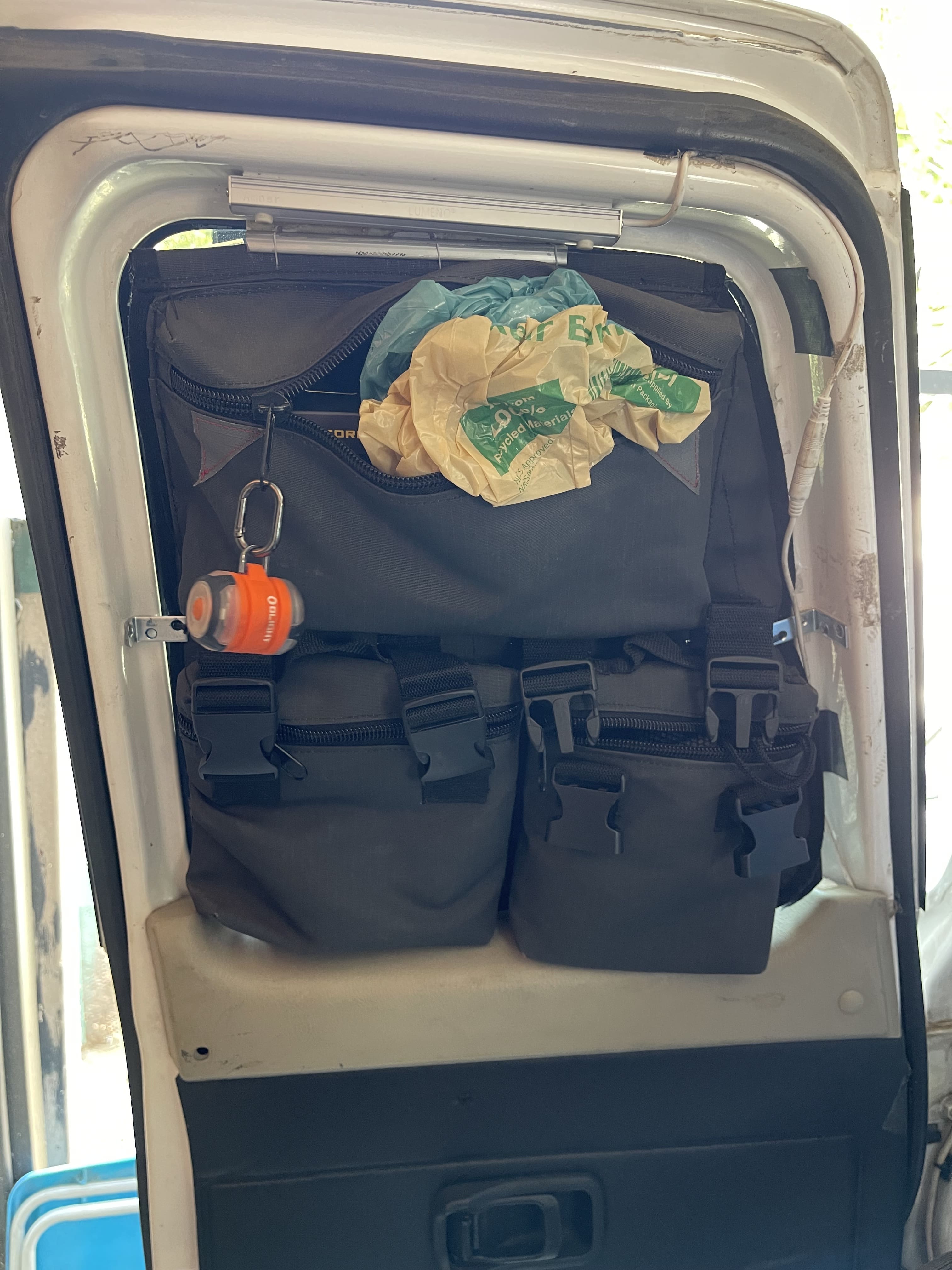

I no longer had view through the rear windows and opted to make use of the space:
