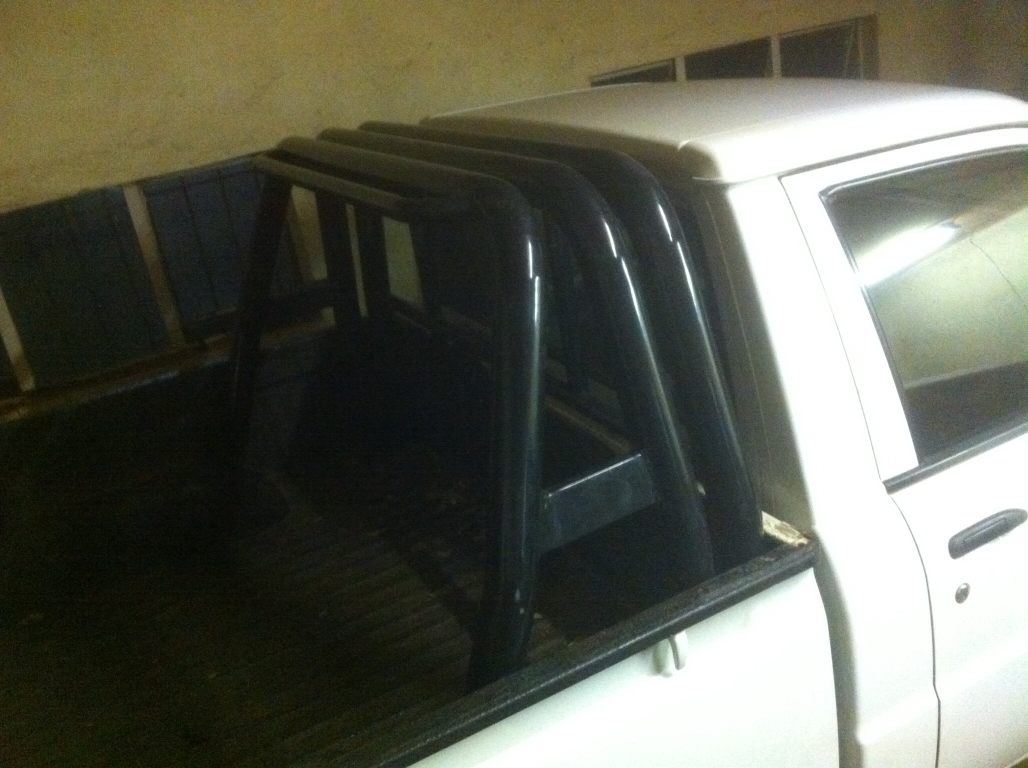

I also ended up getting the rollbar. Which I fitted this morning. Looks a lot better with it on and there is nice place for the kids to hold on when going on (slow) drives. Will post pic later.

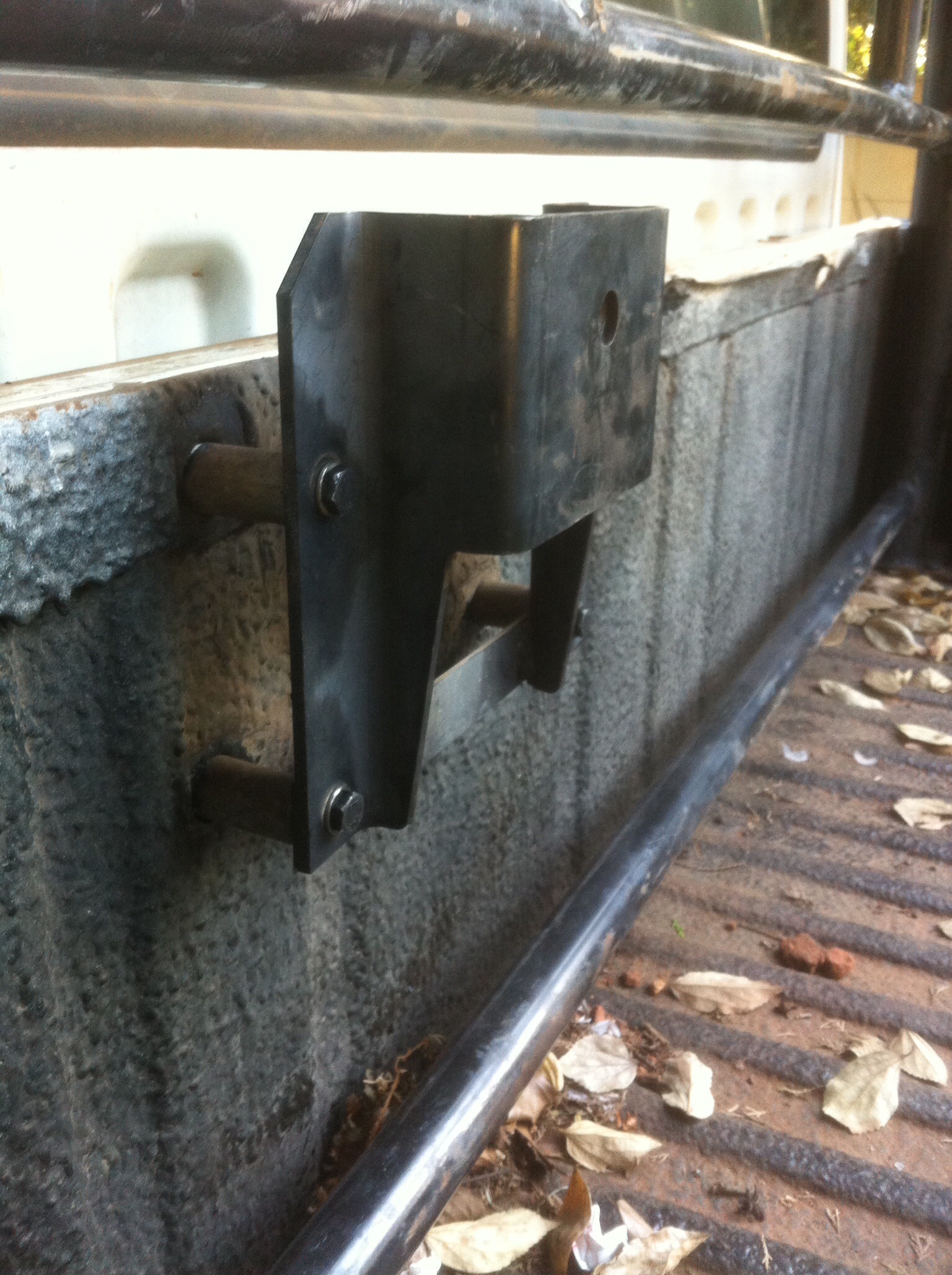

Only thing is that I will have to create some space between the spare wheel carrier and the bin, as there is now not enough space for the spare wheel. (I will take some pics of this later to explain it better.)
Will have to get longer bolts, and then fit some square/rect. tubing between the carrier and the bin, or use spacers. Will probably have to put about 5cm between the carrier and the bin, must still measure it..
Russ where is your spare situated? also behind the cabin like mine?

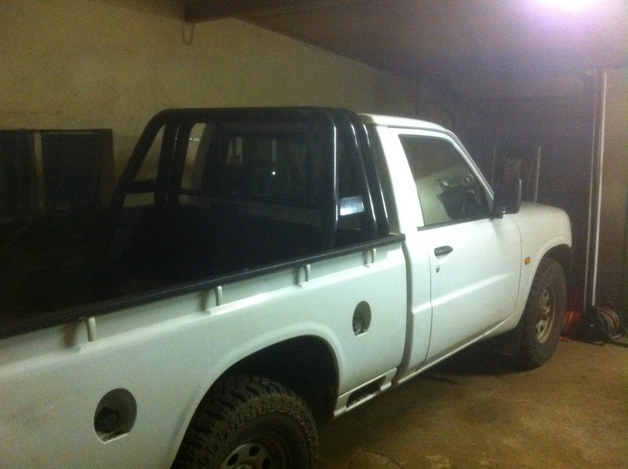

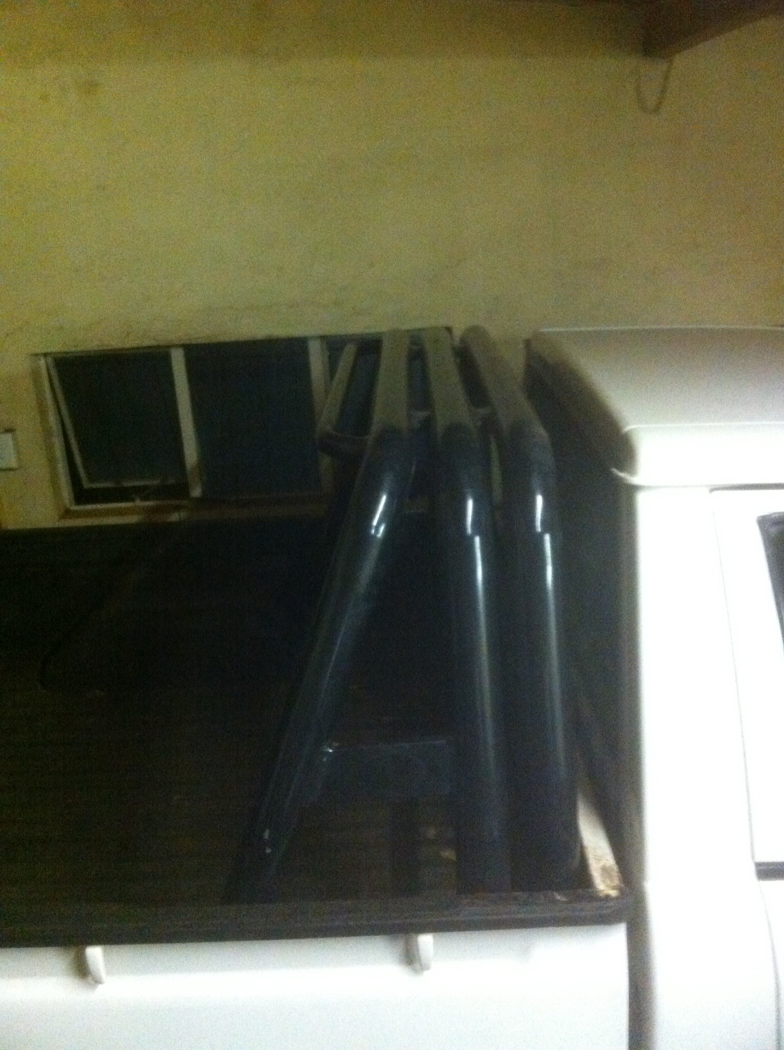

Pics of the rollbar.
(Sorry about the quality, bit dark for my phone).
- image.jpg (797.24 KiB) Viewed 2910 times
- image.jpg (892.13 KiB) Viewed 2910 times
- image.jpg (731.22 KiB) Viewed 2910 times

Pete: Thanks so much for the explanation in regard to the chassis and differences,... i pride myself on knowing much about the Pickup but i had never ever in my readings come across that,... and it seems 100% spot on as my chassis is different. I will post up some pics when i can to illustrate. I cant remember what year model SJC's patrol is?... mine is a Late 2007. I did notice the pressed steel rounded part on all models since the Turbo intercooled models were released (2008 onwards),but i had always assumed it was just protection/mounting for a larger oil cooler, hahaha... so that could be when they changed i guess. I have never had a close look at the TD42ti in person, not many where i live, not many patrol bakkies at all.
SJC: The Roll Bar looks great. Its the same one like i have. Should give you a more comfortable ride now with a bit of weight on the back too. The Spare wheel on mine also buts up against the back like yours. But remember,.. depending on what size tyres you have and type of rim offset, will depend on how mush back spacing you need. I have had to change my spacers behind the mounting bracket 3 different time. Mostly due to my canopy addition (obviously no roll bar then).. I also had to cut the threaded T-Rod as it was too long once i had my chosen tyre rim combo and the canopy setup.
Its easy,.. just get longer bolts. Buy yourself a meter of round tube with an Inside diameter just wide enough to slip over the bolts. Cut 4 small identical sections, and there you have your spacers. I had some aluminium tubing lying in my garage (cheap stuff you can get even at Builders Warehouse), so i just used that. mild steel will also work. It looks better that adding a million washers in there.

-Russ Kellermann wrote:Its easy,.. just get longer bolts. Buy yourself a meter of round tube with an Inside diameter just wide enough to slip over the bolts. Cut 4 small identical sections, and there you have your spacers. I had some aluminium tubing lying in my garage (cheap stuff you can get even at Builders Warehouse), so i just used that. mild steel will also work. It looks better that adding a million washers in there.
I will give this a try, i might have some tubing lying around.

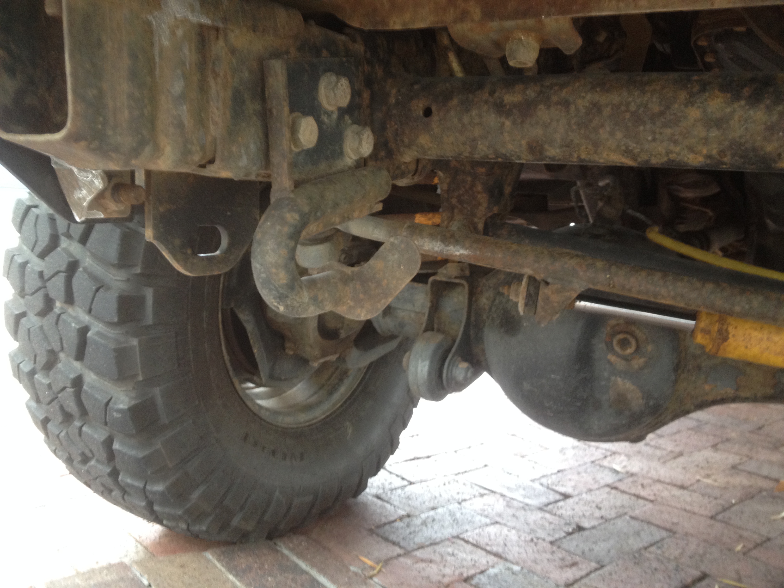

This is my hook. Pete, is the 4.8 similar or what?
- IMG_0466.JPG (1.91 MiB) Viewed 2896 times

Russ, that"s one of life's great mysteries: who Patrols don't sell in SA.
No, yours is the older style (in fact exactly the same as the factory fitment on my '96 Y60). The 4.8's is much stronger.

4cm exstra was enough to make the spare fit..
- image.jpg (919.76 KiB) Viewed 2874 times

Mine looks identical. The round tube worked well i see, did on mine too. Nice mate.
I have seriously good recovery points at the rear, as do you SJC, as you have the same rear bar as me. The front tho is a different story. I'm either going to go the 4.8 Route then, or perhaps aftermarket,..will have a look whats out there.
