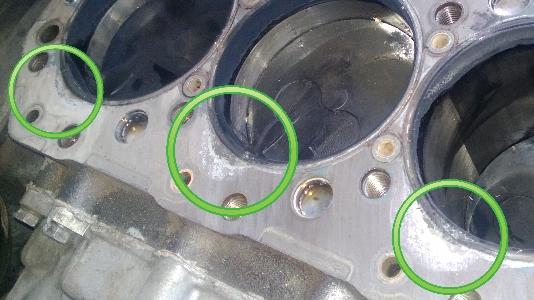

Re: head coming off again

What antifreeze did you use, cause looking at those water ports, it looks like HUGE buildup of lime or what ever they call that stuff, especially on both water ports between no 4 and no 5 cylinders. Between 3 & 4 looks much better, but the right ( exhaust side ) water port on no 6 cylinder also looks different to the left side....
Can't really see the others
Those marks could be from the head gasket failure where water sat in that tiny cavity between head - head gasket- block. The precom sits half in the cylinder void and half resting on the head gasket. The top of the sleeves are clean so contact was made between precom and head gasket and then sleeve top. I assume the torquing wasn't quite at the sweet spot, and a bit of water got there dried left that calcium or lime, then the process was repeated every time the motor was working and there was a gradual buildup over time. Probably just enough toque to prevent water squeezing into the oil ports.

I used ps23 premix antifreeze. I agree on the torque cos it was the old head bolts. The interesting thing is all the scoring marks are right down from where the white residue is built up, do you think they're connected? How can I get rid of all the scale buildup?

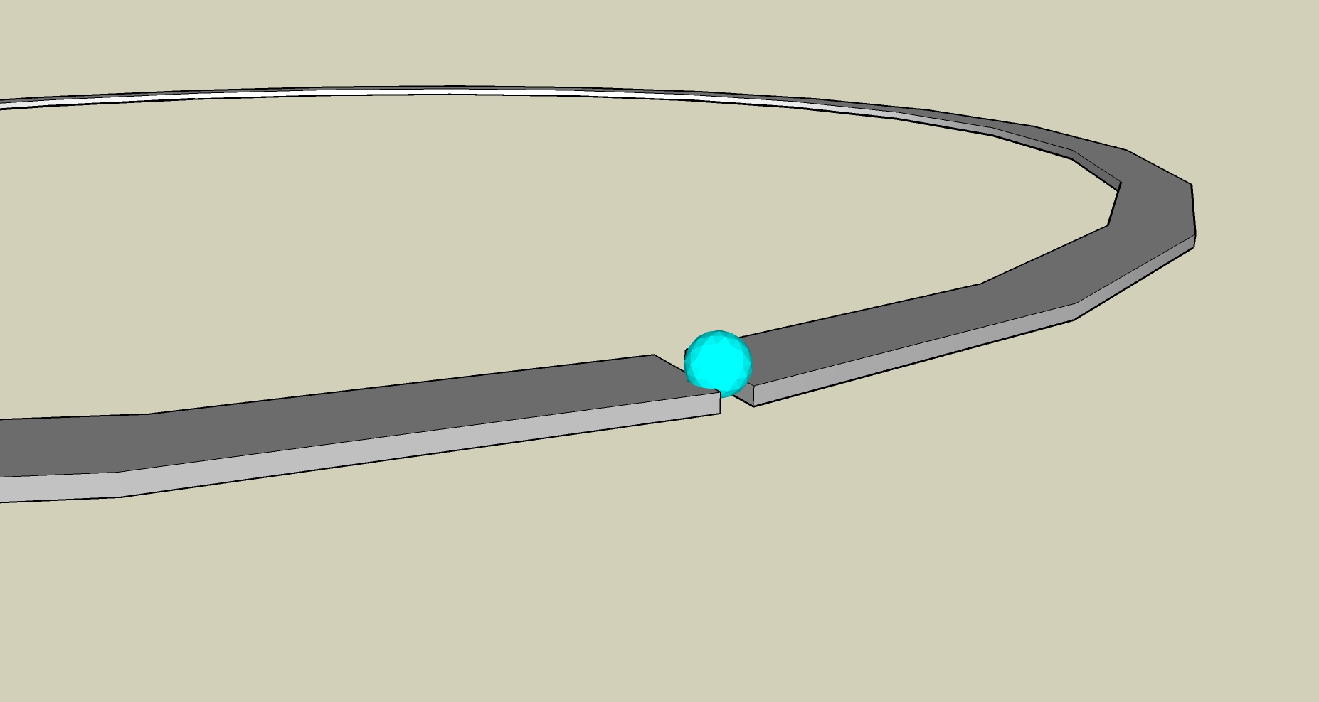

I was thinking exactly the same thing !!.... but how can it score the block. Using Barry Roux's analogy.... I put it to you..... that the evidence of water is not present on the sleeve tops. However it is possible I would think, and maybe as oil and water don't mix, that there was a tiny amount of water leaking into the cylinder and getting onto the ring. If the top ring "split" is at that point the tiny amount of water will probably be held there with the assistance of the thin oil film ( water "ball" will sit on top of the water)
Better demonstrated with this....
Maybe the same stuff thats in the water ports, was sitting on the rings, making a scouring paste ( like Vim kitchen cleaner ) and that with the lack of oil on the bores in that area due to there being water cleaning the oil film off the bores made the marks....... Holy smoke, it seems like I'm gaaning aan about things that are impossible.... but hey stranger thing have happened, and is it coincidence that it is right below the precoms.....
Cleaning that shhhhh...... rubbish out the cooling system??..... Not sure. You could acid wash the block I presume. I would think that that will clean it out. Must just wash the block 100% afterwards. Maybe someone can assist here or Google

Funny thing after reading Frans's reply: I remember looking at the carbon build-up at the tops of the bores in the first pics and thinking surely that was too much for such a short period?
