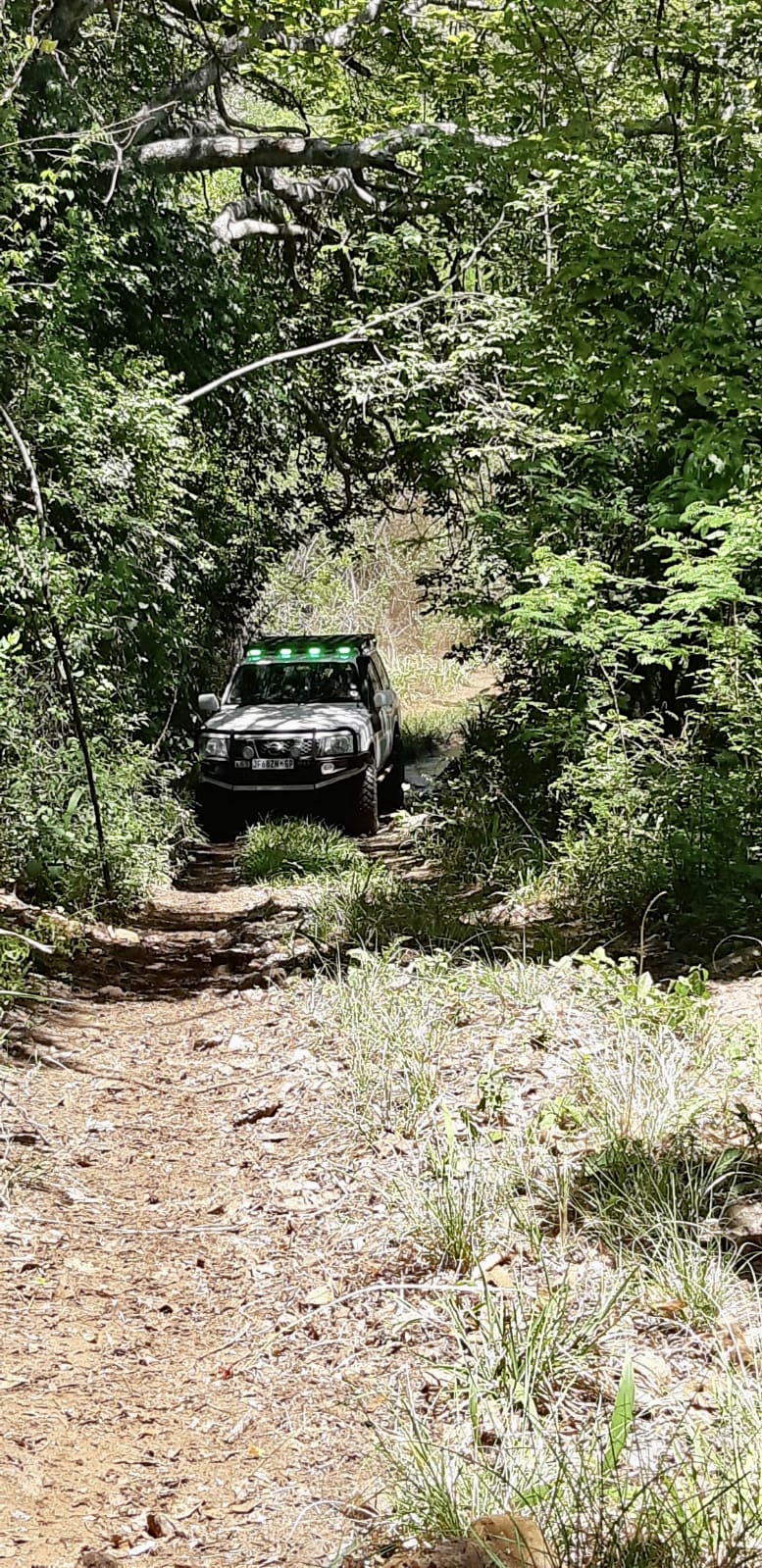

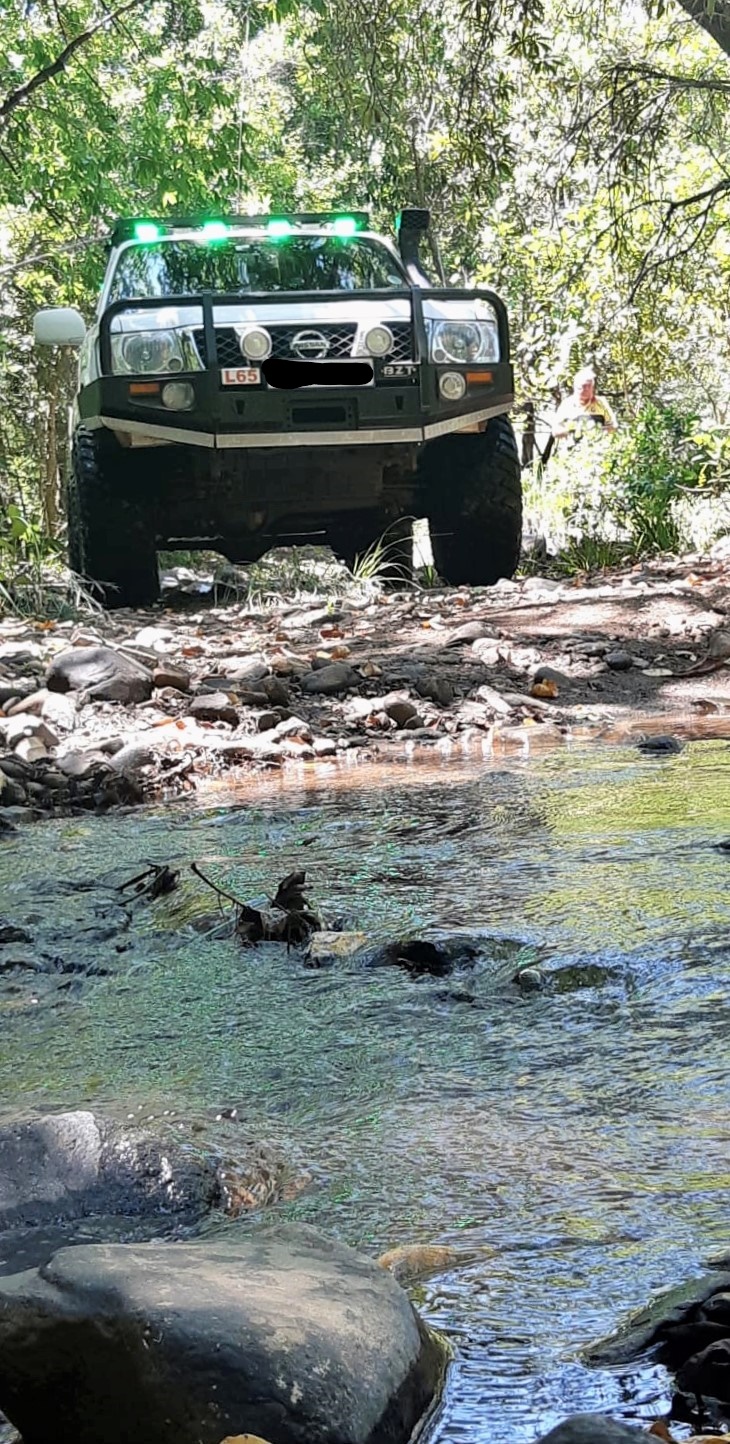

Last weekend I went to the Wolkberg Wilderness area between Polokwane and Tzaneen with ORRU for training with other agencies such as Mountain Search and Rescue, Ground Search and Rescue (K9's), SAPS Search and Rescue and Limpopo EMS. I towed the ORRU Mobile Command Post (MCP) there and back. MCP's GVM with water and equipment is a bit less than 2t.
Diesel consumption according to GPS mileage there and back was as follows:
  • Centurion to The Ranch stop - 5,9km/lt or 16,85lt/100kms
  • The Ranch stop to Wolkberg campsite, driving around at Wolkberg and tow back to The Ranch stop - 4,5kml/lt or 22lt/100kms
  • The Ranch stop back to Centurion - 5,7km/lt or 17,52lt/100kms
Back to my previous post about the Madman and "om te weet is om te meet". Just before The Ranch stop there is one hell of a steep climb that made me work hard... During this climb I have seen EGT temp of 670, engine oil temp of 103 and coolant temp of 105 with boost of 1bar. I learned quickly that to get the EGT down, gear down but then the engine oil temp and coolant temp rise... To know what was happening under the bonnet and to be able to adjust to the readings gave comfort as the last thing I wanted to do is break my car..

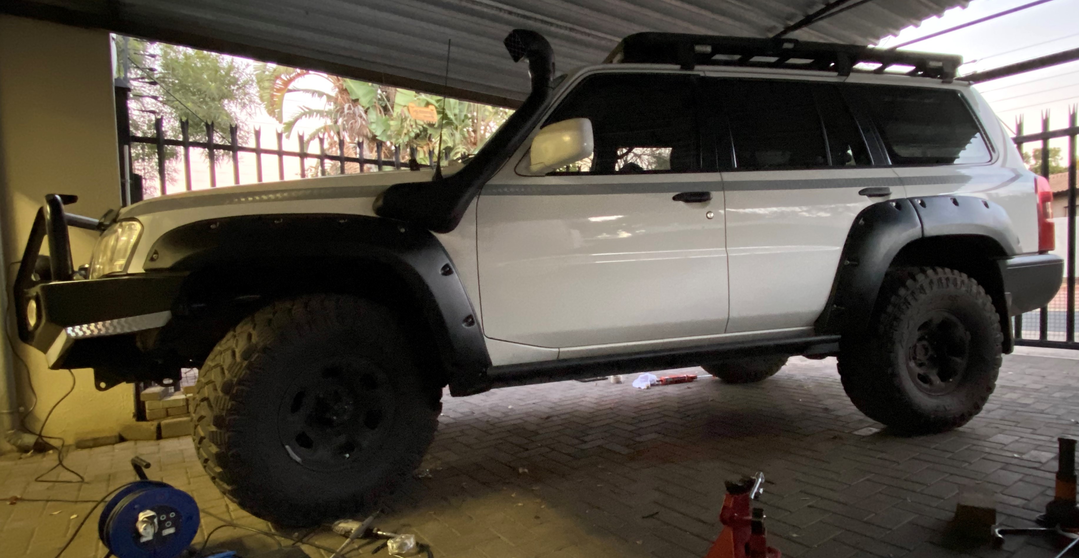

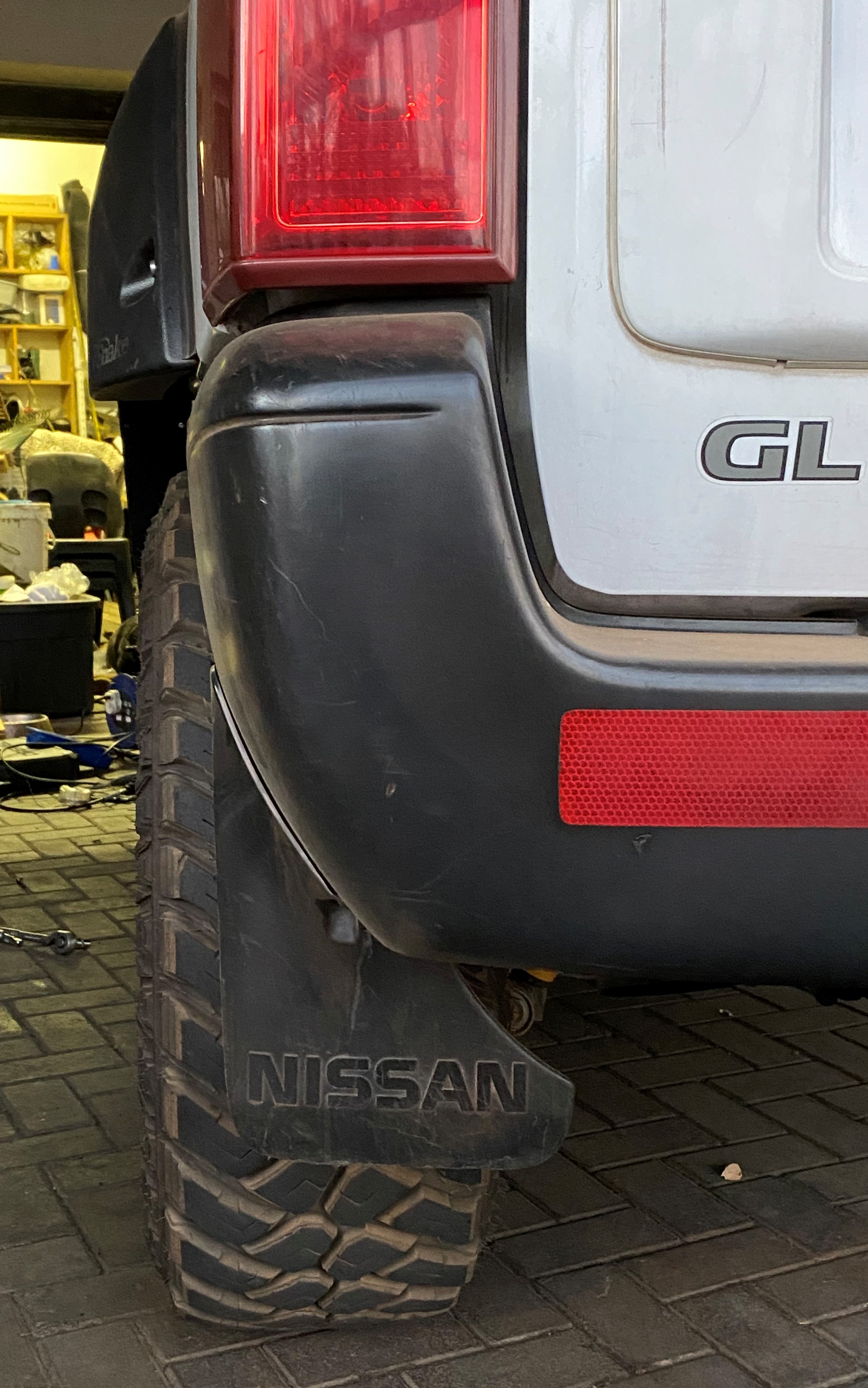

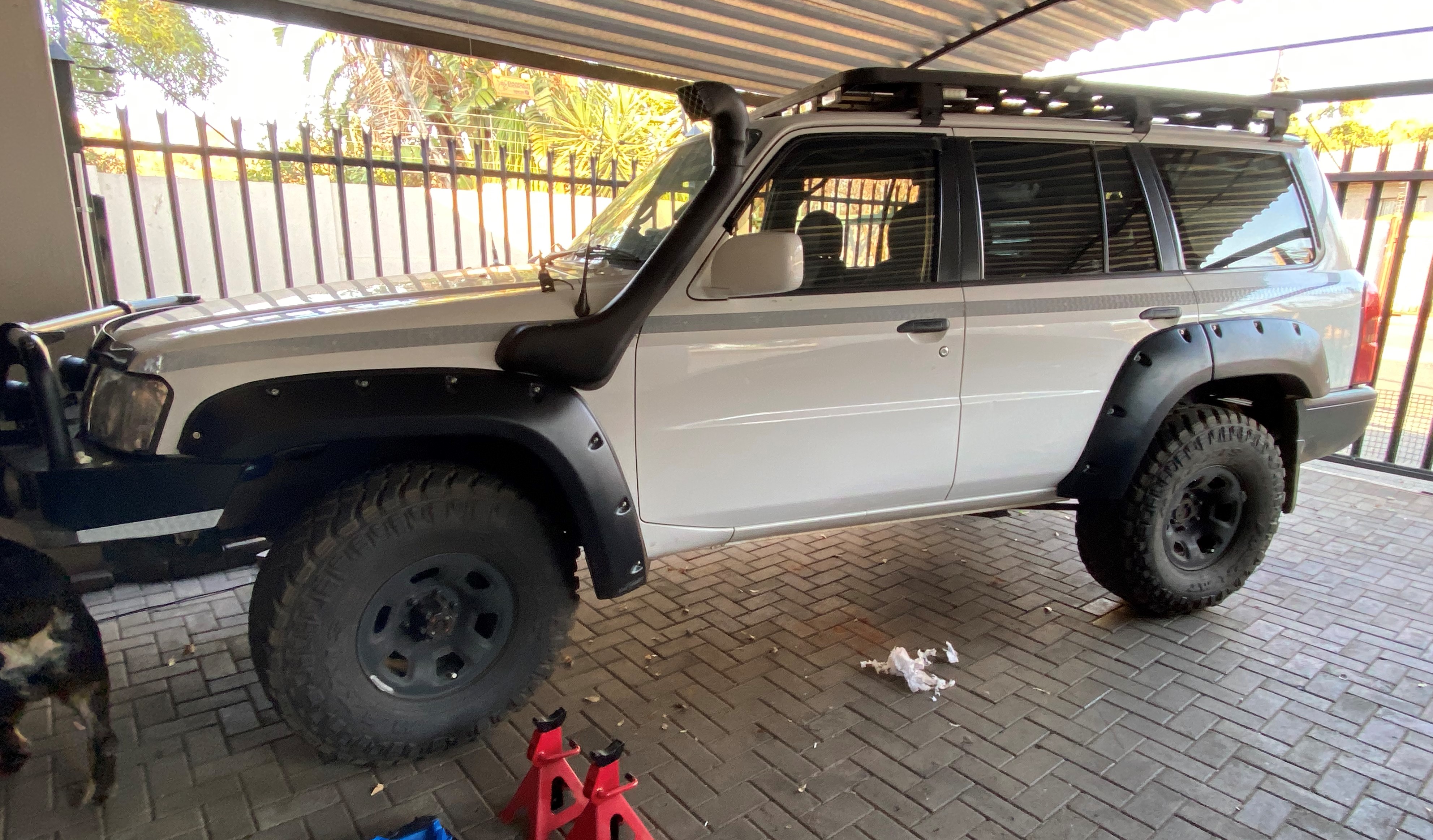

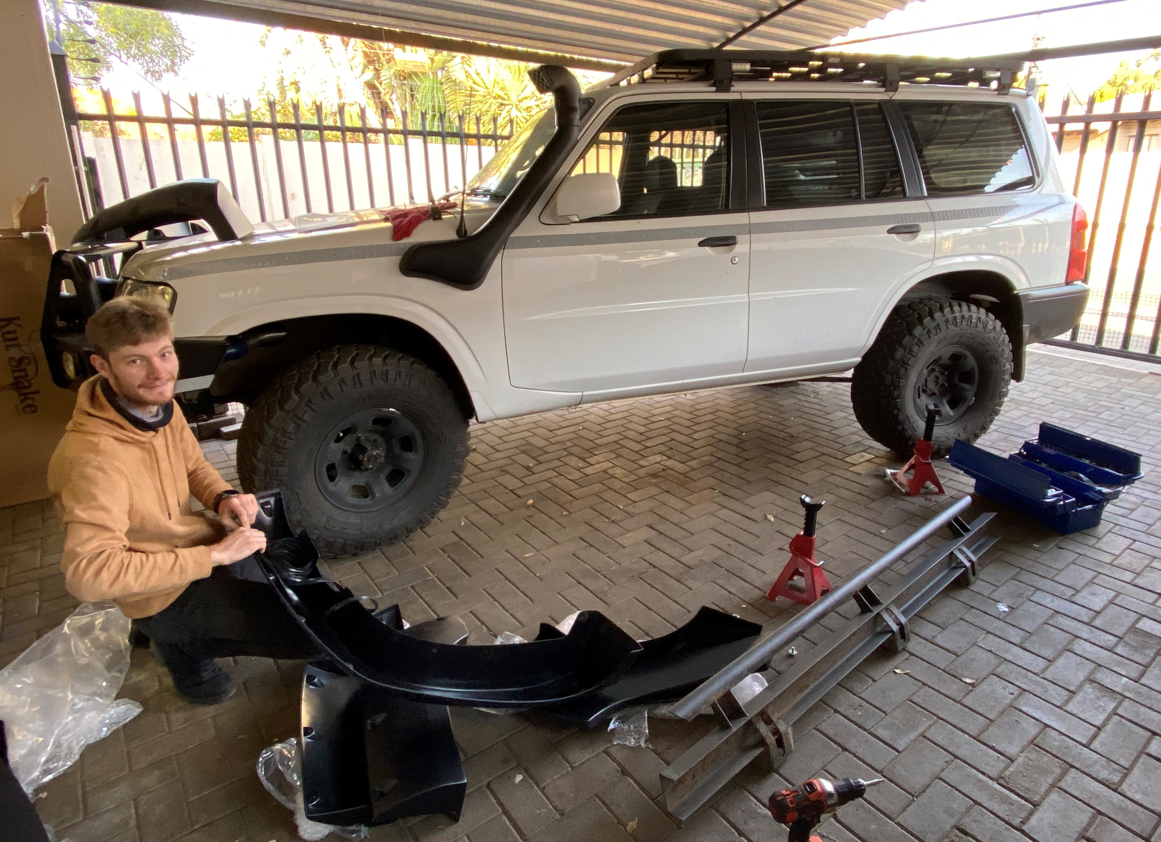

Now to what can be seen..... a while ago the interest for flares was discussed and I ordered it for the Patrol. Having recently received them between my son and I fitted them over the weekend. It was a bit of a mission as we had to drop the Connan rock sliders for the fitment and had to make some adjustments to the fenders and in the end the front part of the pipe of the rock sliders to enable fitment.
Fitment prep
Fitment prep
IMG_9633 (2).jpg (1.96 MiB) Viewed 8628 times
Fenders fitted with rock sliders still off
IMG_9654 (2).jpg (1.83 MiB) Viewed 8628 times
Rock sliders back on
IMG_9659 (2).jpg (965.33 KiB) Viewed 8628 times
Rear view to show line iro tyre
IMG_9660 (2).jpg (1.23 MiB) Viewed 8628 times

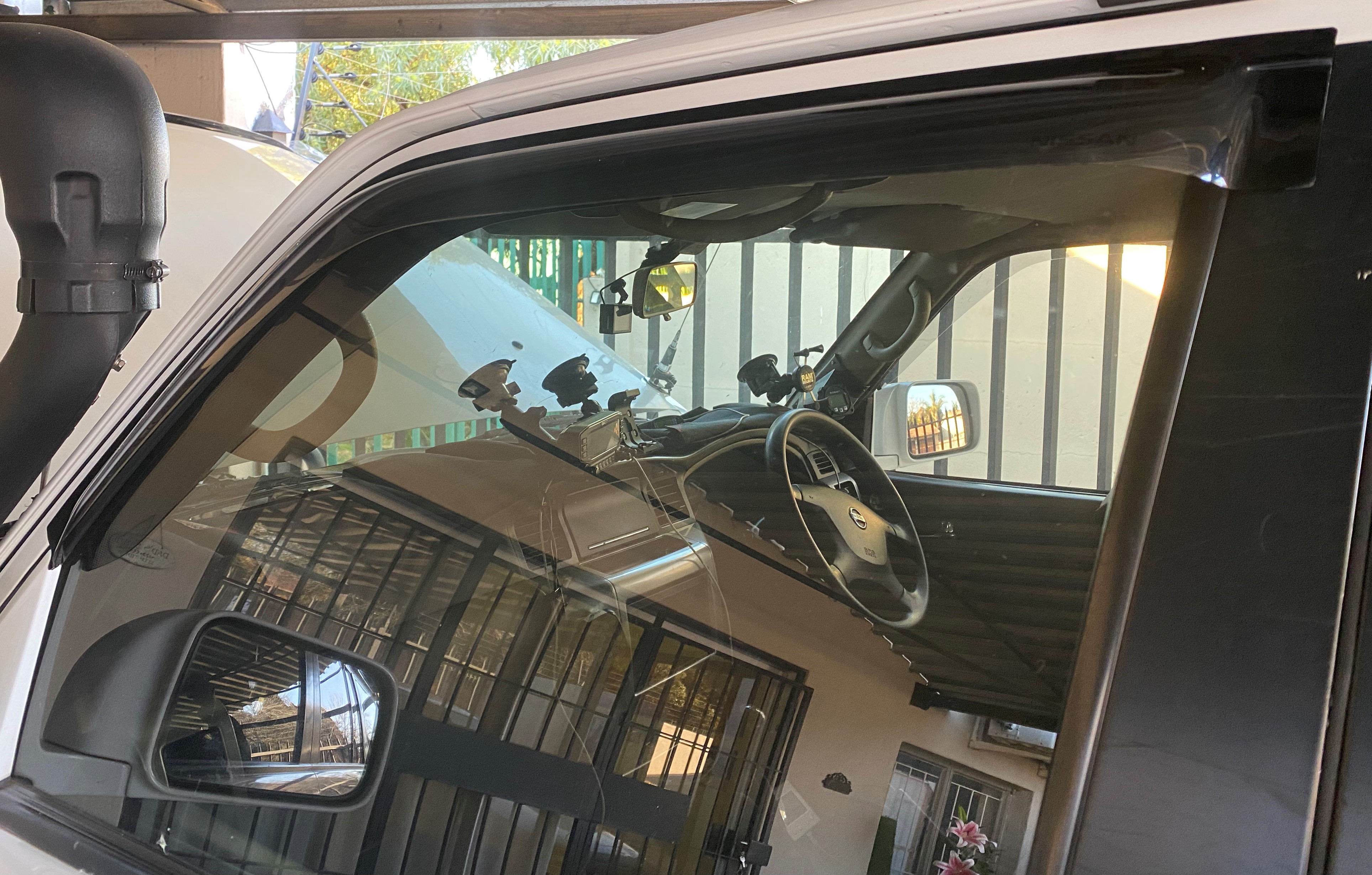

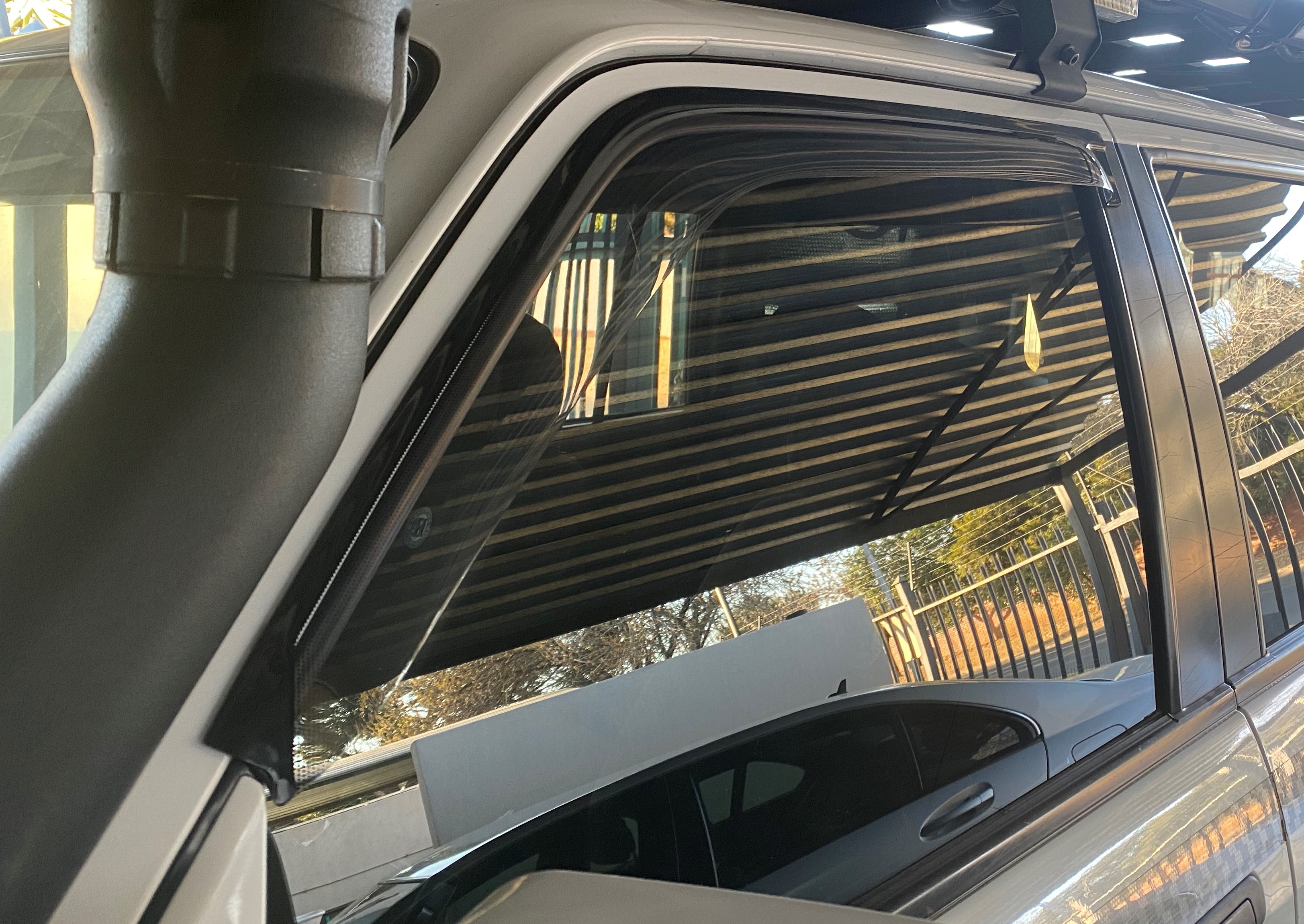

I also got bubbles and a stone chip protector from Tinus that we fitted while busy with the fenders.
Bubble on front window
IMG_9647 (2).jpg (1.91 MiB) Viewed 8628 times
IMG_9648 (2).jpg (1.6 MiB) Viewed 8628 times

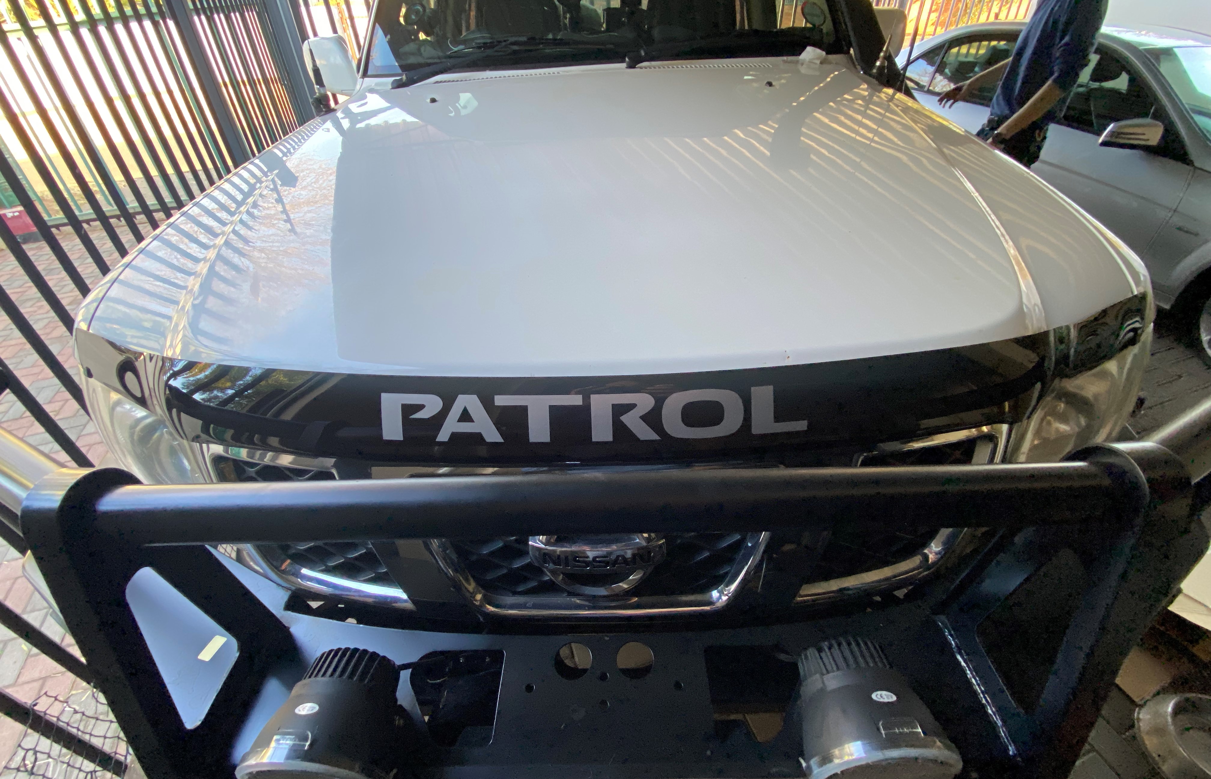

Stone chip protector
IMG_9656 (2).jpg (2.13 MiB) Viewed 8628 times
