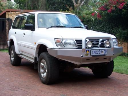

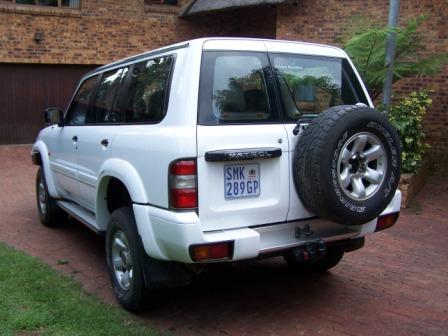

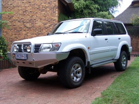

Lasarus is home and looks better than ever! The hail damage repair and re-paint was done very well. Koos Best's seat covers fits well and almost all the other outstanding minor things are done. New tyres and snorkel will follow soon. Lasarus is trip ready!!!!
Lasarus 3.JPG (41.02 KiB) Viewed 2464 times
Lasarus 2.JPG (37.42 KiB) Viewed 2464 times
Lasarus 1.JPG (38 KiB) Viewed 2464 times
