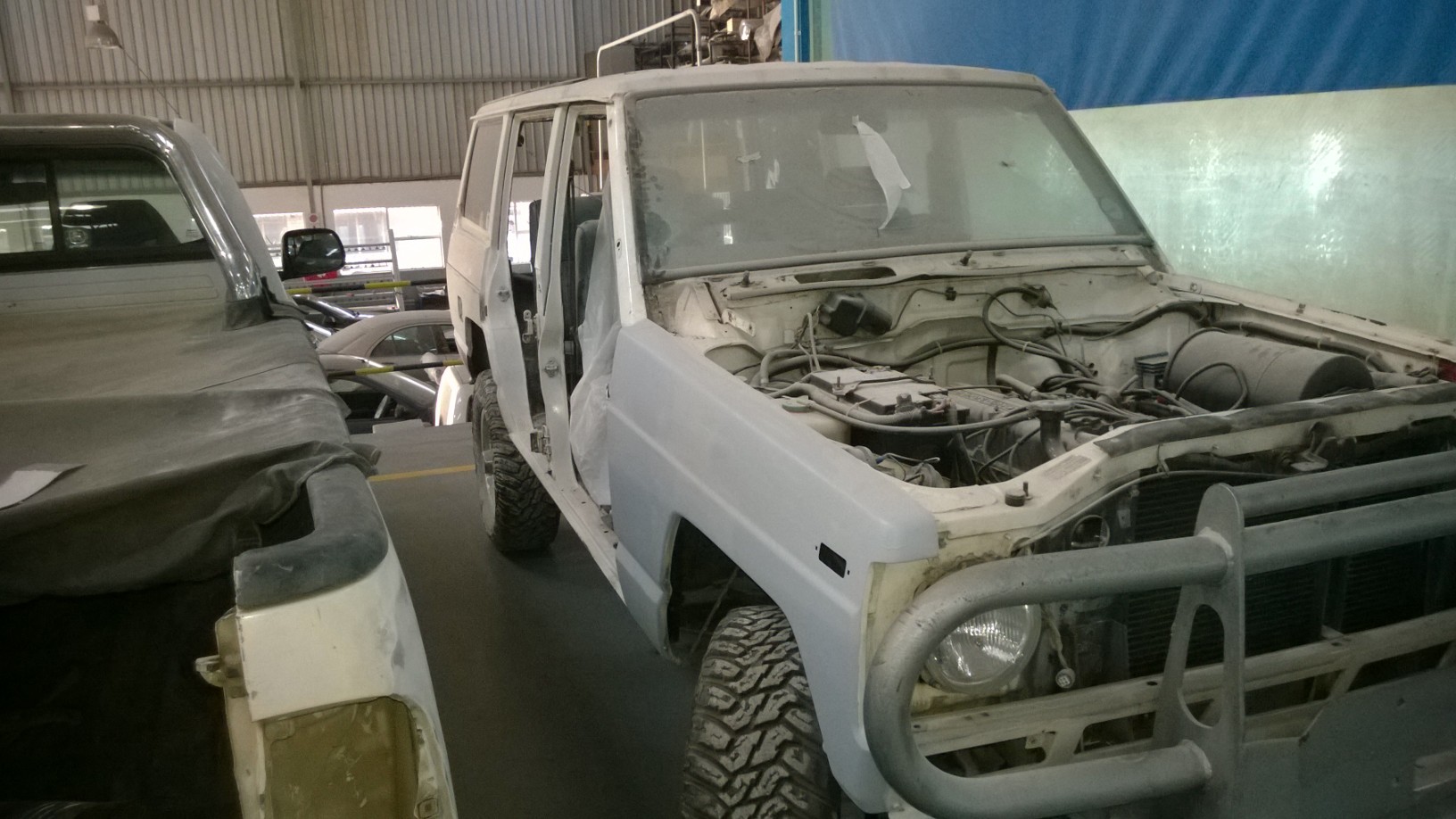

Postpone this till LOBO 's re-paint is finished / klaar / done / gedoen ..
ek kannie WAG nie
ek kannie WAG nie
- WP_20140901_005.jpg (318.1 KiB) Viewed 2310 times
