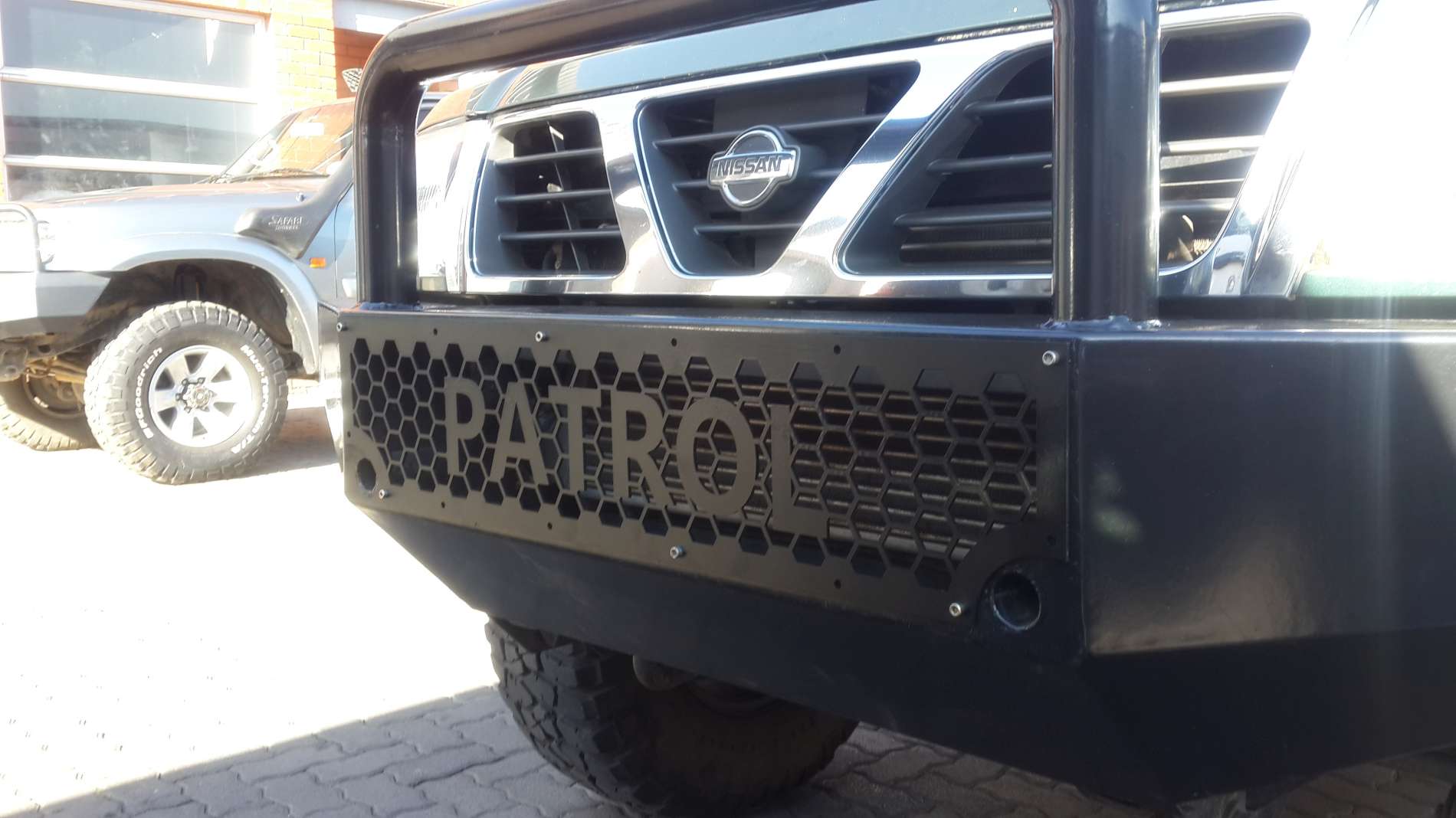

Ok so I have done another small change on my Patrol.
As everybody knows the 4.2D engine likes to get a bit hot when its warm outside and you are towing something heavy. I have notced mine do this one time when I was on my way back from Polokwane towing 1.8 ton, the Patrol did get that hot, but the needle on the gauge started to move past the middle mark and Madman recorded readings of 105deg water temp exiting the engine.
I have alwas knew that my steel bumper was one of the biggest problems as it restricts airflow quite a bit.

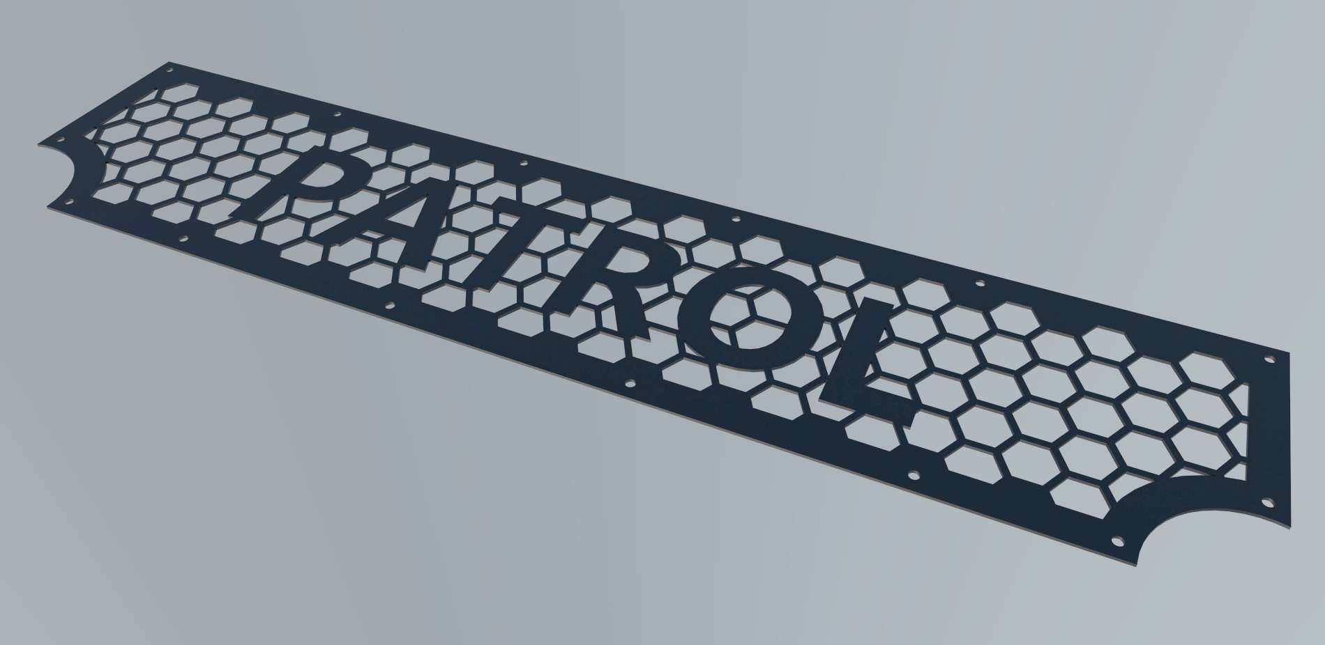

So I made a plan and thought I might as well make it look good while I do it.
Luckely I do know how to measure and have a friend in office that knows how to draw things in Autocad.
The plan was to cut the front section of my steel bumper open and replace it with the following
the plan
the plan
That was easy enough, luckely I also know Tinus that knows peaple with CNC maschines so that part was covered as well
action time
action time
And the morning after!!
the end result
the end result
Now my Radiator get allot more air as well as my intercooler. This is still the first part of my plan to get the cooling system working better and will still build some air guids behind the bumper to make sure the wind has to go through the radiator and not around it

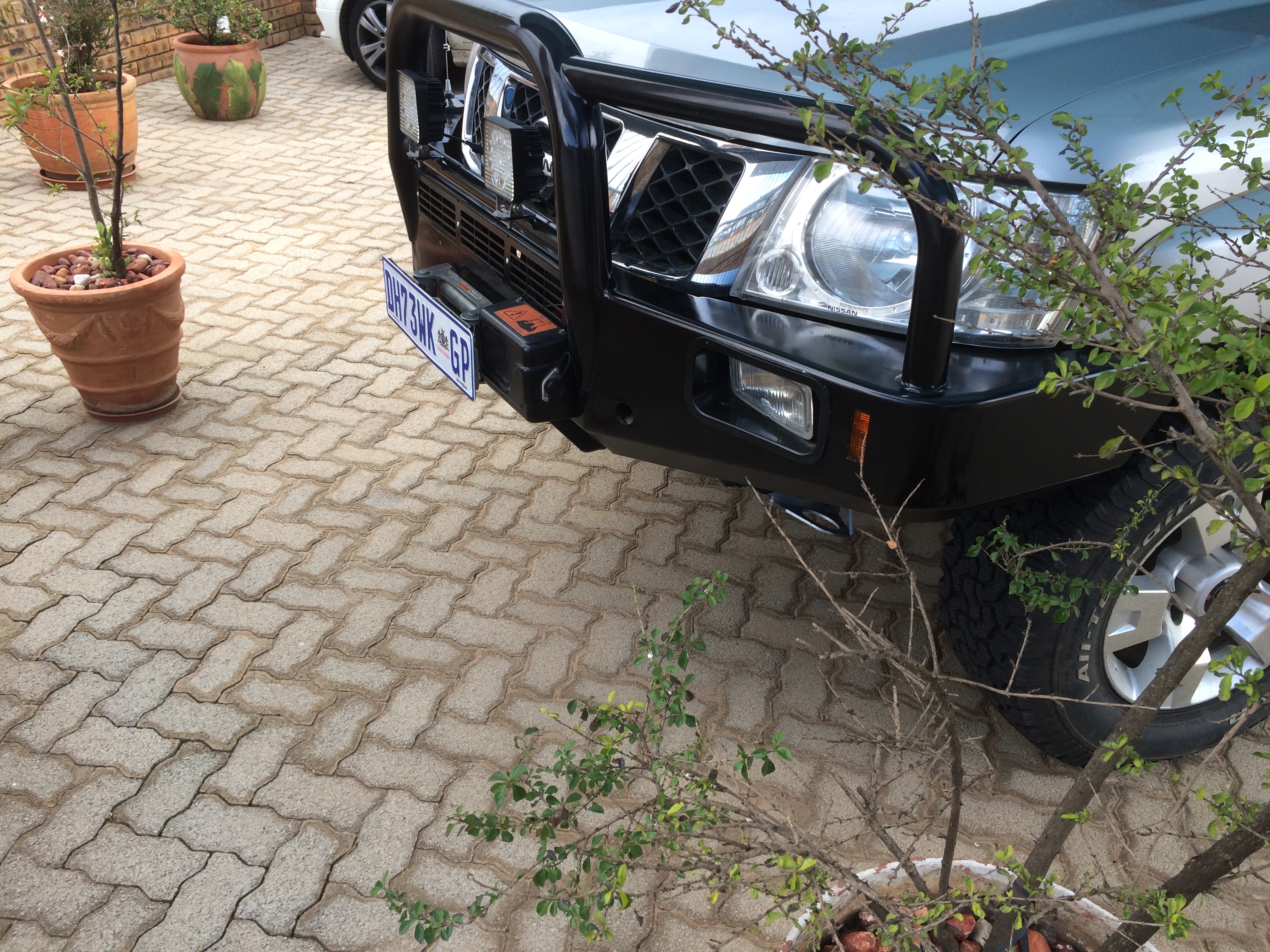

Very Nice! How about making a second drawing with a cut out for the winch? And I will be first on the list for one?
P.S where are you going to put your number plate now?

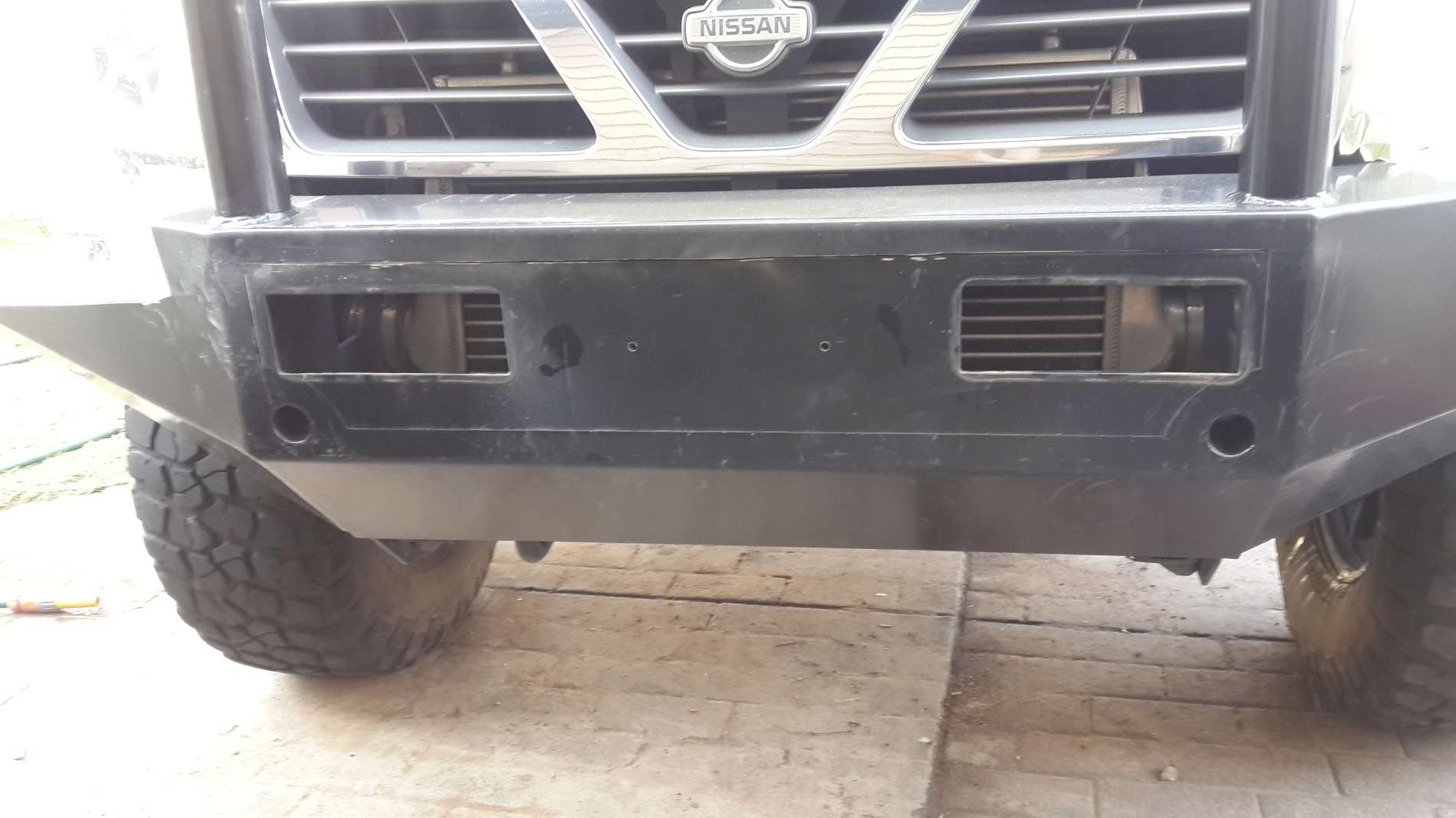

Yeah that is the problem with my bumper.... the number plate covers almost all the vents

Ian, what bumper do you have? I can send you the autocad file and you can have a look at it. if you can draw one on a paper with mesurements Im sure my friend will draw it no problem.
The number plate will move to the LH side of the bumper. I will put the number plate on tonight, screw in the rest of the stainless bolts and take some more pics

My one is Nudge-M will see if I have a photo and will post it :thumbup:

Just had a look not going to work on my one :thumbdown:

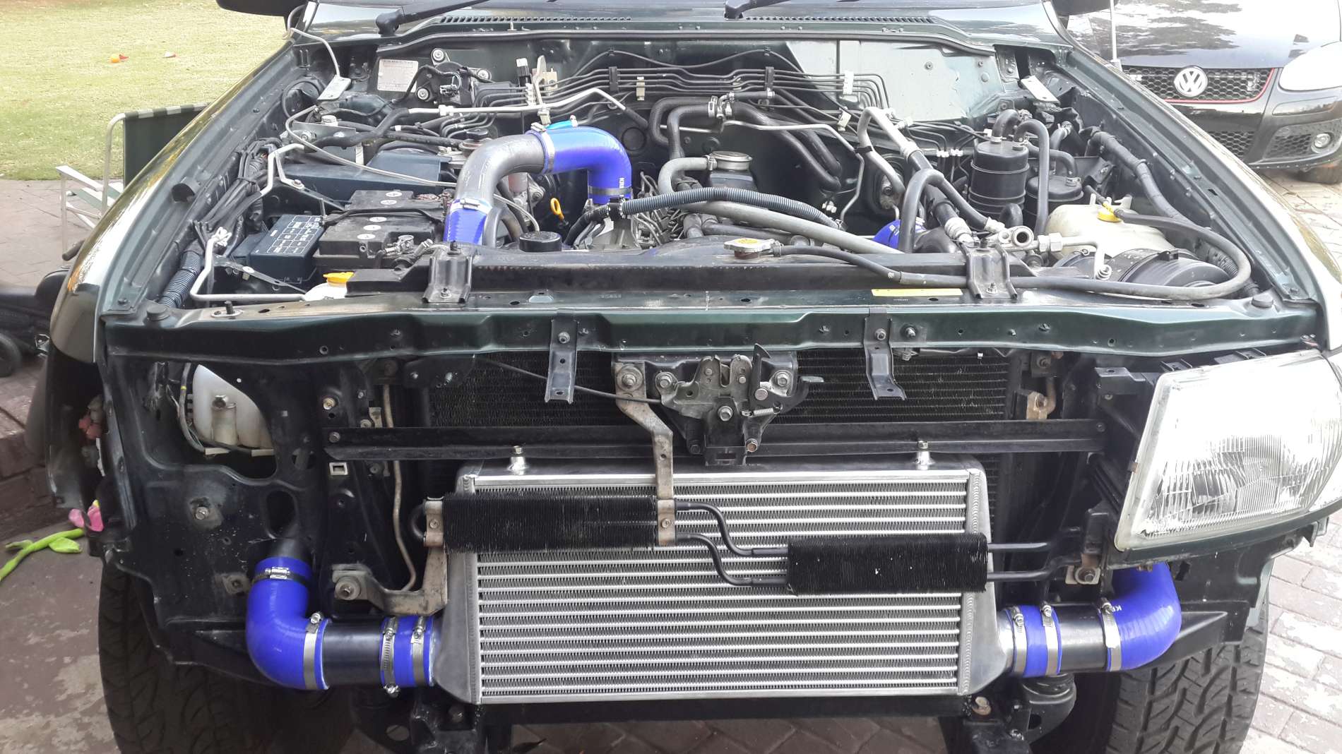

Look's like a very mean intercooler hiding behind that bumper. What size is it?
Been thanked: 430 times
Re: My GU 4.2 Turbo Diesel
Pieter, this was the biggest intercooler I could find on the net and still is the biggest off the shelf as far as I know. It is 600mm x 300mm x 76mm.
The best part is they are very very chaep and sell for R1,600 at MrTurbo.
Here is a picture when the Patrol front end was stripped..... its really big and does a very good job in cooling my intake air
