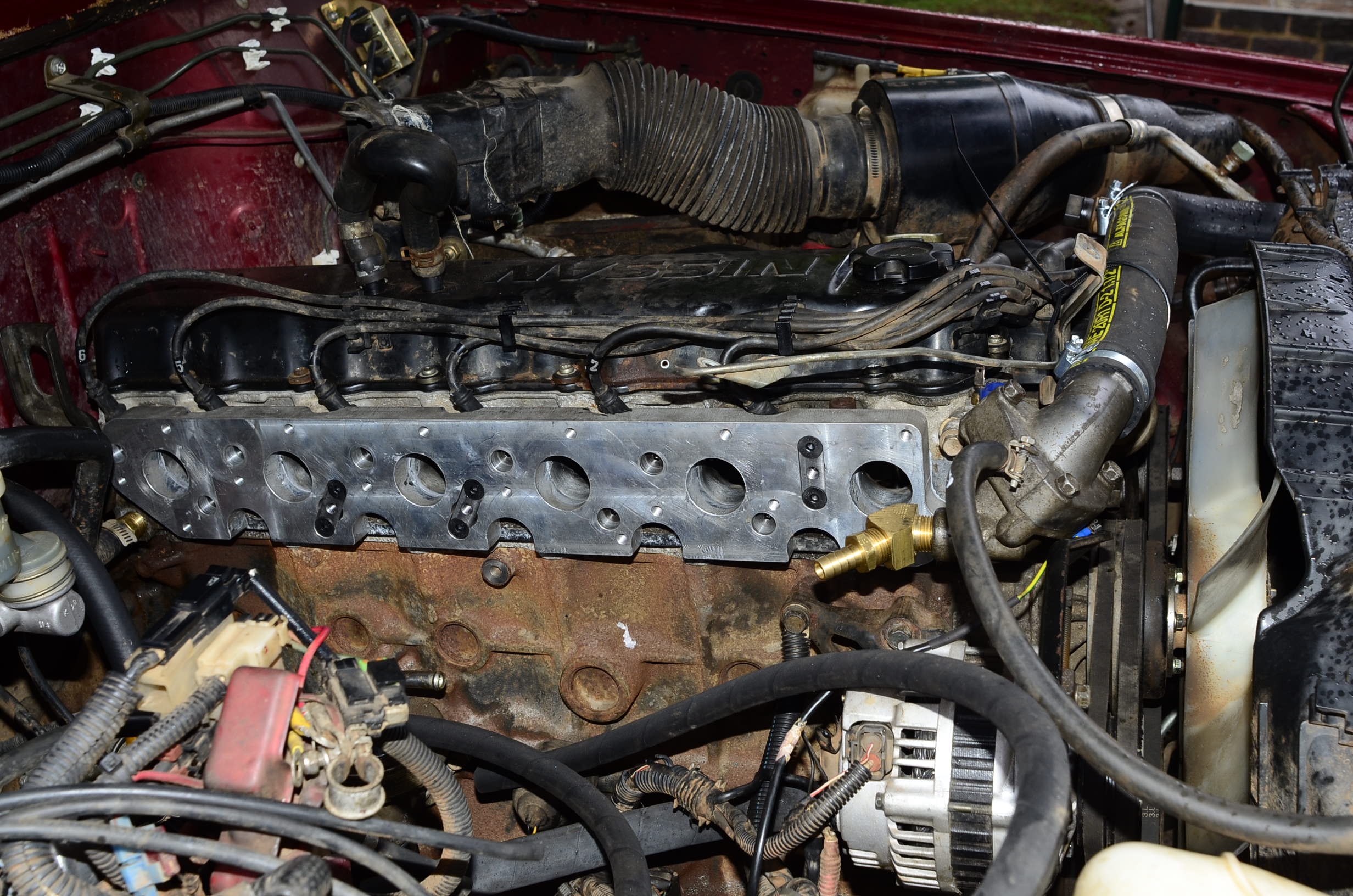

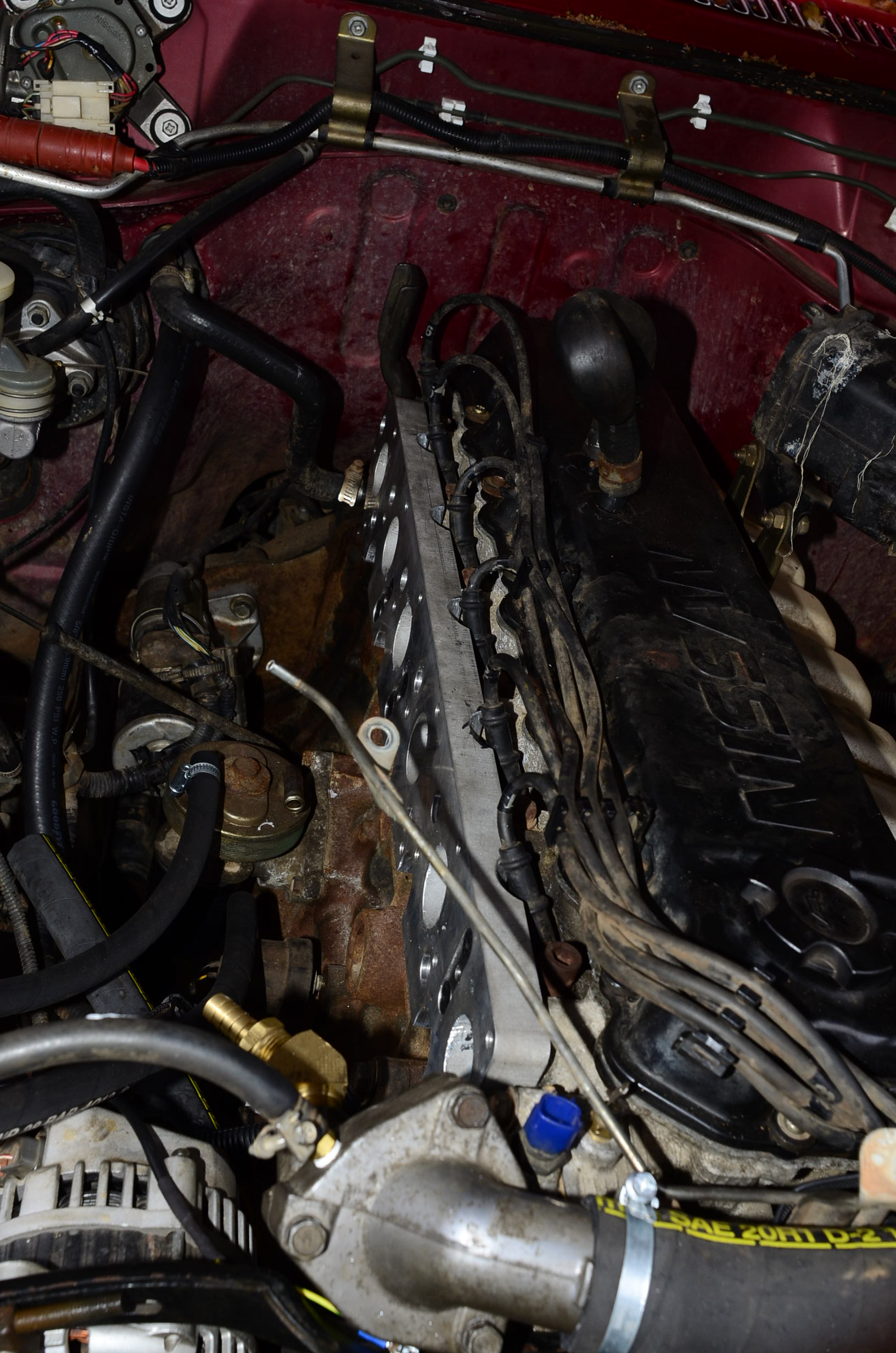

Re: GQ options
OK, I have been driving it for just more than a month now, and I think I have all the issues sorted.
the only major modifications were this adaptor plate to fit the 4.2's inlet manifold to the 4.5 head: The thermostat housing section was cut off the 4.2's manifold so that the 4.5's thermostat housing could be used, as the 4.2's thermostat would have interfered with the alternator mounting. However, I drilled a hole in the top of the thermostat cap to add the bleed hose which is part of the 4.2's cooling system.
The other major mod was to go from mechanical to electric pump. This required a total rethink of my vehicle's (non standard) fuel supply system, and to be honest I am still not 100% happy with the system as it is now. Under long periods of full-throttle use, I still experience some fuel starvation.
One very noticeable change is how much cooler the new engine runs. The old one used to go to 90 degrees even under normal light duty, while the new one tends to sit just at or above the point where the thermostat opens, untill you hit a really long uphill or you run the aircon. I don't think I have had the new engine over 90 degrees.
I suspect this points to a problem in the old engine, as the cooling system is basically unchanged, and the radiator was replaced several months before the old head blew.
