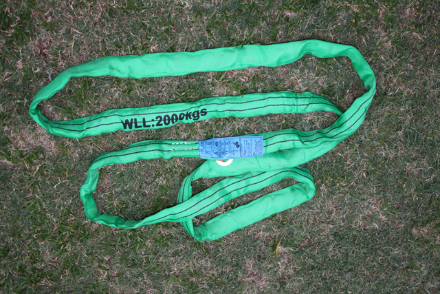

I received my Safety Lanyard from RopeWorld today. Will post a photo tomorrow.
RopeWorld undertook to courier the ropes and the price list to me before our recovery training day.

Herewith a pic of the safety lanyard form RopeWorld.
Safeworking load 2000kg
Safety factor is 7:1
Length 2m
Conforms to EN 1492-2:2000+A1:2008
TUV More to follow next week.
Length 2m

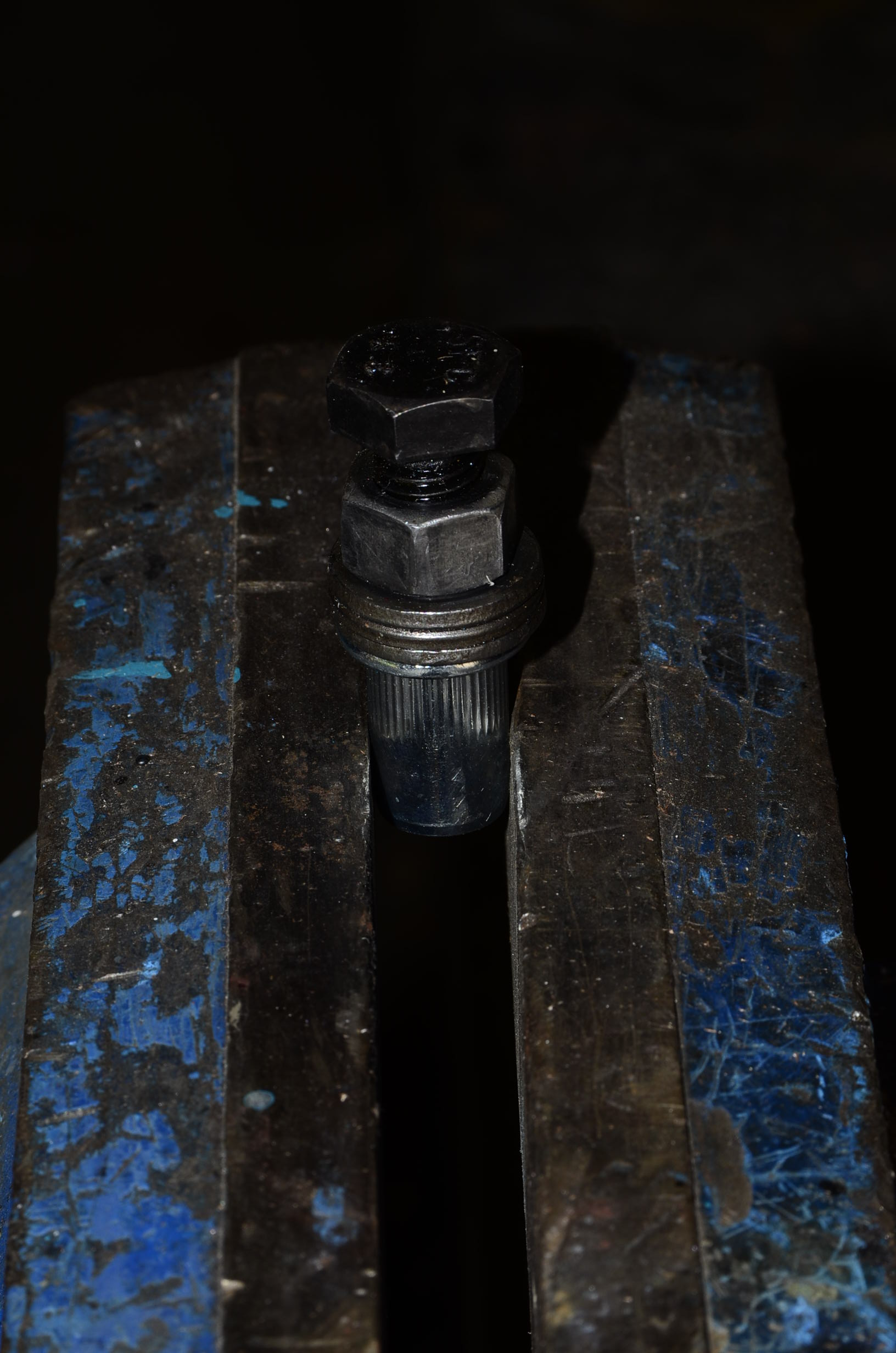

Rivnuts are usually installed using a special tool, but I have found it quite simple to install them using a spanner and socket, together with a nut, a few flat washers and some ghrease.
Here's how:
Step 1:
Assemble a nut and some greased washers onto the bolt, then screw the bolt into the rivnut antil it fully engages the thread (IE until it's level with the back end). It helps to grip the rivnut in a vice and just start it expanding by turning the nut with a spanner while holding the bolt with a second spanner or socket.
Stop as soon as a bulge starts forming on the knurled section.

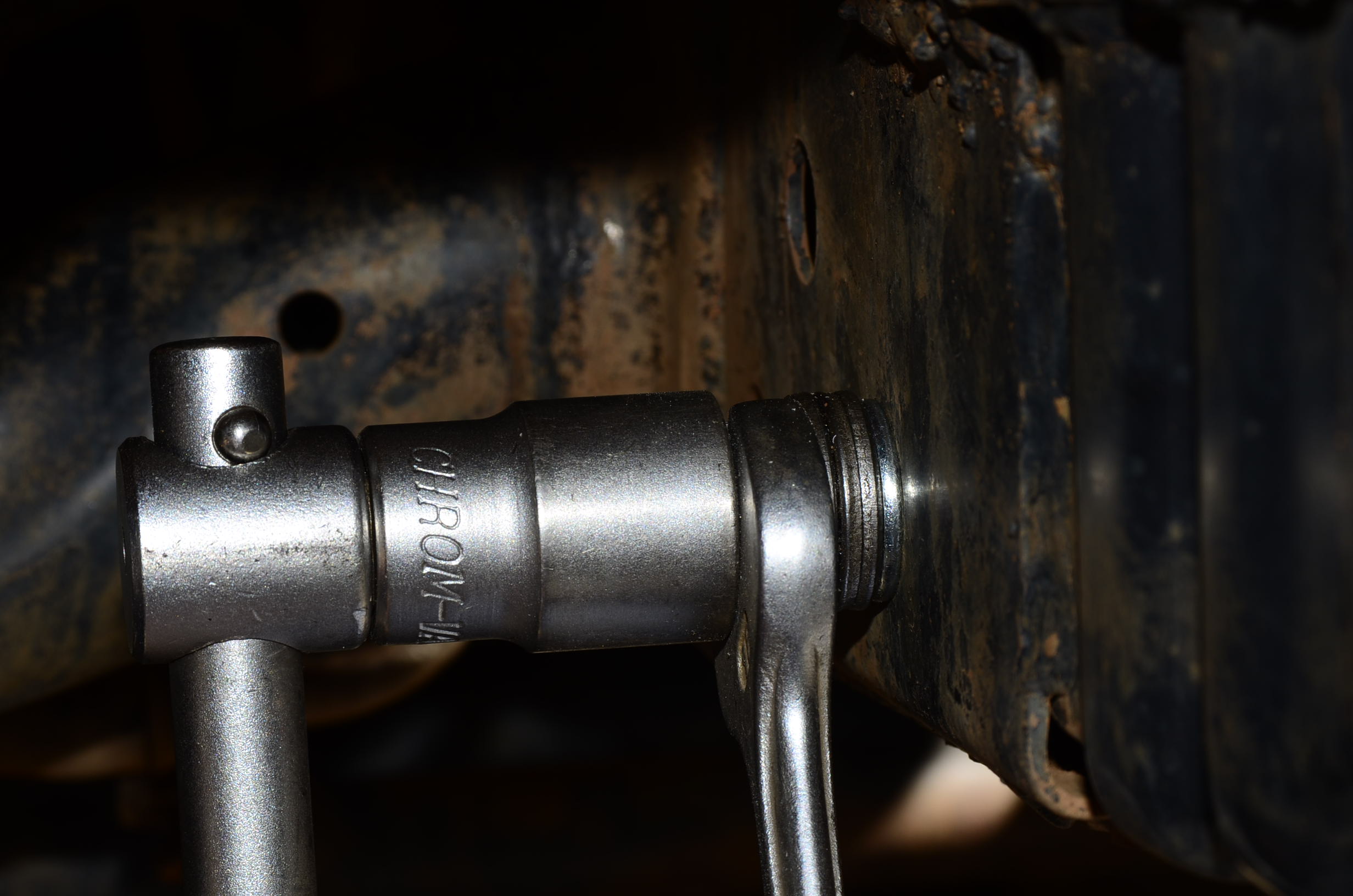

Step 2:

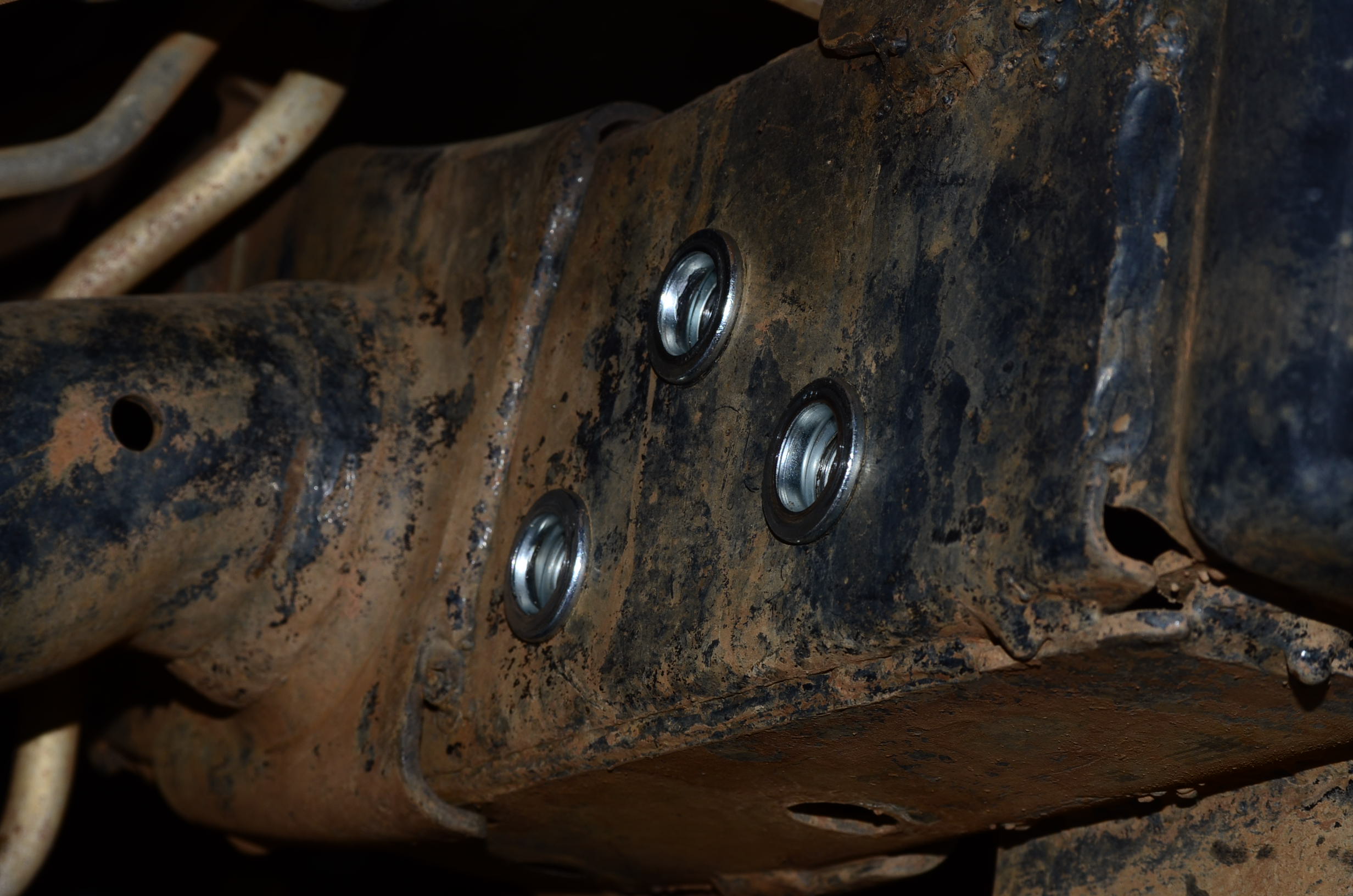

Place the rivnut into one of the holes in the chassis and continue tightening the nut while holding the bolt still. Make sure the rivnut doesn't turn. If it does, pull it to one side, tighten one flat, straighten it, angle again and tighten another flat, repeating the process untill the rivnut is straight and gripping. Continue tightening untill you can feel the resistance suddenly increase. The rivnut is fitted.
Step 3: Using the same process, fit the other two rivnuts.

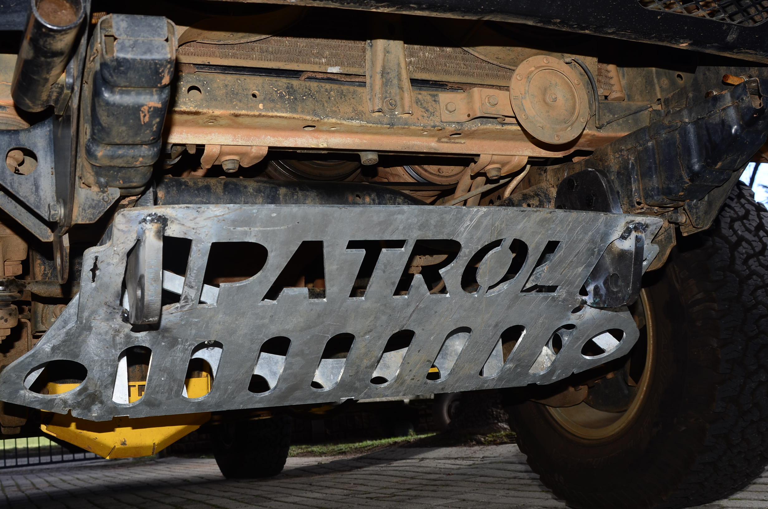

Now, bolt on the recovery points, either as a welded assembly with the bash plate as seen below, or by sliding them through the slots in the bashplate.
