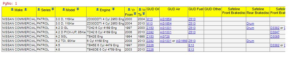

For 4.8 GLX TB48 engines, (not sure how much GL model differs):
Patrol Model______4.8_GRX________ Engine___TB48___________
Oil Type and quantity__15W40 RECOMMENDED_/ 6.8L WITH FILTER CHANGE_______
Gearbox Oil_ ____Nissan Matic - J for Automatic__________________
Transfer Case Oil___ Castrol Transmax Z- synthetic_OR_ Nissan Matic - D__________
Differential Oil_______75 or 80w90 diff oil _______________________
Oil filter GUD_Z226_____ FRAM___P87317_±R87__
Fuel Filter GUD__E13_____ FRAM _G4777_±R165___ CHAMPION__CFF100215_±R77_
Air Filter From Midas(brand unknown)__U1608????__K&N __ E-9266__ NISSAN ___ 16546VB700W
Spark Plugs Brand name ___NGK PLATINUM PLFR5a-11_____ Gap______1.1mm__________
OR Spark Plugs Brand name____NGK IRIDIUM ILFR6T-11__ Gap______1.1mm_____________
OR Spark Plugs Brand name____NGK CHEAPY LFR5A-11__ Gap______1.1mm_____________
Manifold gasket (Upper collector) _Nissan - 14033-VC200 (needed when changing plugs)__±R 87 from Nissan_
Fan Belts Main_ RAM P473____ A/C_____ 6301__________ Aux_____________________
Front Brake pads___FERODO FDB1577____________________________________
Rear Brake Pads________ BD1247_________________________
Windscreen Wiper Blade Length_HELLA WP20 (20", 500mm) 9XW 178 878-201 ____
O2 Sensor ____Bosch 0258986507___
Mass Air Flow Meter ___Nissan 22680-VC201___
Starter____Nissan 23300 VB000____Hitachi S114-870____
I will update on the air filter, I can't remember make or model of my current one. Hope this helps someone!

NEW UPDATE - Got correct codes from NGK on the various plugs. Note, they say any plugs with a '5' in the code will run too hot for the 4.8 engines, so look below at correct codes when getting plugs. The LFR6AIX-11 is recommended by NGK.
Spark Plugs Brand name ___NGK PLATINUM PLFR6A-11_____ Gap______1.1mm__________
OR Spark Plugs Brand name____NGK LFR6AIX-11__ Gap______1.1mm_____________
Battery____Deltec 656 - 90AH - 690CCA or similar tapered terminal - RH Positive______
Please note also, these part numbers are all correct to my knowledge, but please double-check if unsure.
