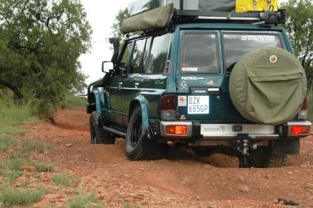

Defender vs Patrol at Hennops
Patrol
Patrol

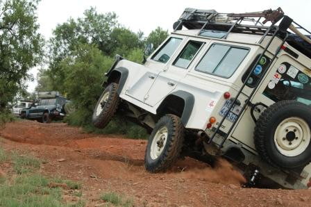

Nice pics Grant
The only vehicle I have seen to lift a wheel that high on that obstacle is my Dad's Hilux. This is fitted with air helper springs at the rear, and in the Hilux if you fit air helpers you sacrifice the bump-stops, which means you have to keep some pressure in the airbags, which reduces the Hilux's already poor articulation even further.
Dieselfan I don't know if you know Hennops, my Patrol will traverse this obstacle (the first axle twister as you head up the hill after entering) in 2nd gear low range at an idle, without the diff lock engaged and with just a hint of slippage. If I try it in 1st Low, however, I need diff-lock or revs.
The scariest vehicle I have seen on axle twisters like this is the Defender 90, and while I always thought that was exactly what a 4x4 should look like (particularly with the top off and the windscreen folded flat) I would not again consider owning one after having seen one just about roll over while traversing a small gully on almost level ground. On the same obstacle my Patrol lifted one wheel about 100mm.

I have been looking at that picture Grant posted of the defender, and I think I have just sussed it:
On the live-axle coil-sprung Landies (Defender, disco 1 and 2, and older Range rovers), the axle is located transversely (side to side) by a triangular member connected to the top of the axle casing by a balljoint. Therefore the roll centre of the rear axle is at this ball joint. This results in a vertical seperation between the torque centre and the roll centre. The effect of this is that when torque is applied through the rear axle, it tries to overturn the vehicle to the right when going forward or to the left when in reverse.
The steeper the hill, therefore the more torque needed, therefore the worse the effect.
On the Patrol, the axle is located by a panhard rod connected on the axle centreline vertically. :thumbup:

Peter I've done hennops many times, my terrano used to idle through with correct timing of the pedal without drama. the pathfinder goes through just maintaining 1000 rpm. the only real challenge there is the axle twister in the playground area, going up it. the terrano had good rear articulation and lsd. the pic of the defender is most freaky I've never seen any car do that there!

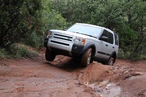

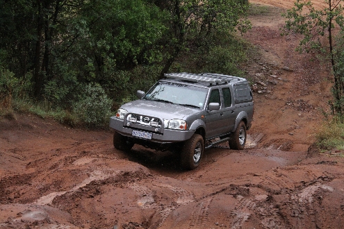

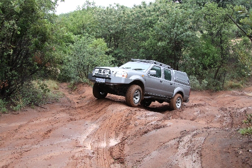

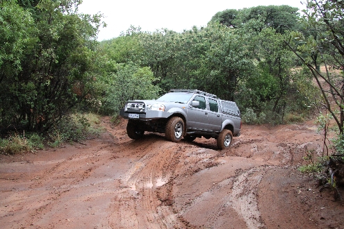

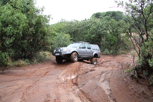

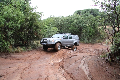

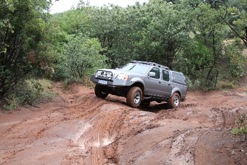

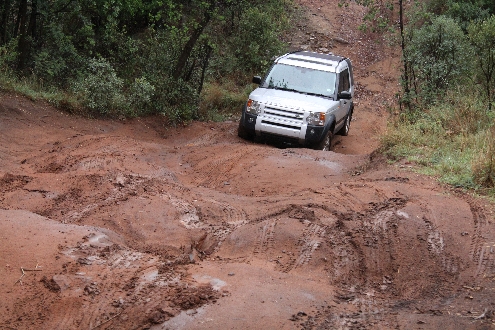

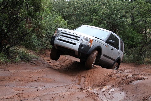

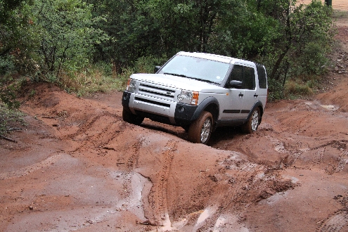

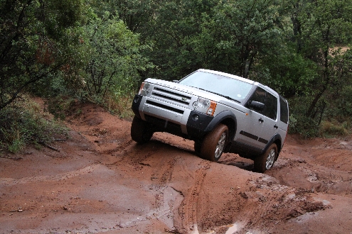

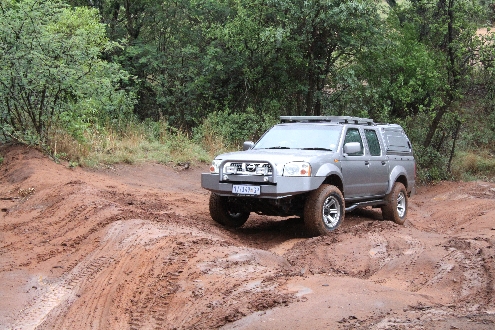

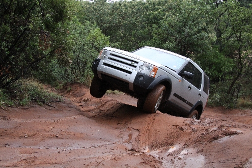

Disco3 & Hard Body @ De Wildt:
HB vs Disco01.jpg (188.38 KiB) Viewed 1964 times
HB vs Disco02.jpg (204.27 KiB) Viewed 1953 times
HB vs Disco03.jpg (202.78 KiB) Viewed 1953 times
HB vs Disco04.jpg (203.3 KiB) Viewed 1953 times
HB vs Disco05.jpg (195.07 KiB) Viewed 1953 times
HB vs Disco06.jpg (192.13 KiB) Viewed 1953 times
HB vs Disco07.jpg (192.17 KiB) Viewed 1964 times
hb vs Disco.jpg (209.61 KiB) Viewed 1953 times
HB vs Disco3.jpg (192.55 KiB) Viewed 1964 times

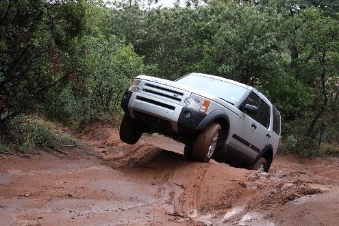

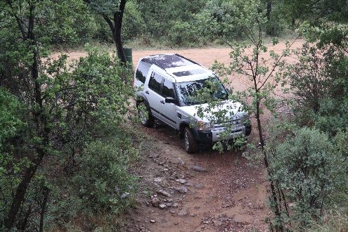

HB vs Disco - saga continued:
HB vs Disco3.jpg (192.55 KiB) Viewed 1953 times
HB vs Disco4.jpg (194.58 KiB) Viewed 1953 times
HB vs Disco5.jpg (190.92 KiB) Viewed 1953 times
HB vs Disco6.jpg (196.29 KiB) Viewed 1953 times
HB vs Disco7.jpg (195.26 KiB) Viewed 1953 times
HB vs Disco8.jpg (194.12 KiB) Viewed 1953 times
HB vs Disco9.jpg (193.33 KiB) Viewed 1953 times
Now you may want to argue that the "line" taken was different - look again - the wheels are almost in the same tracks - That is a R100 000 vehicle and a R500 000 vehicle. (i can replace many engines for that difference ? - but do pray that the one I have lasts and lasts and lasts...]
AND Boezman's front suspension is stock standard - and the Rewolwer shackles in the rear was R900.oo -
And what's more - Agarob can doe better the Boezman

That does not look right. A standard Defender flexes at least as well as a standard coil sprung Patrol. What suspension does that Defender have? Was he going through there at speed?
