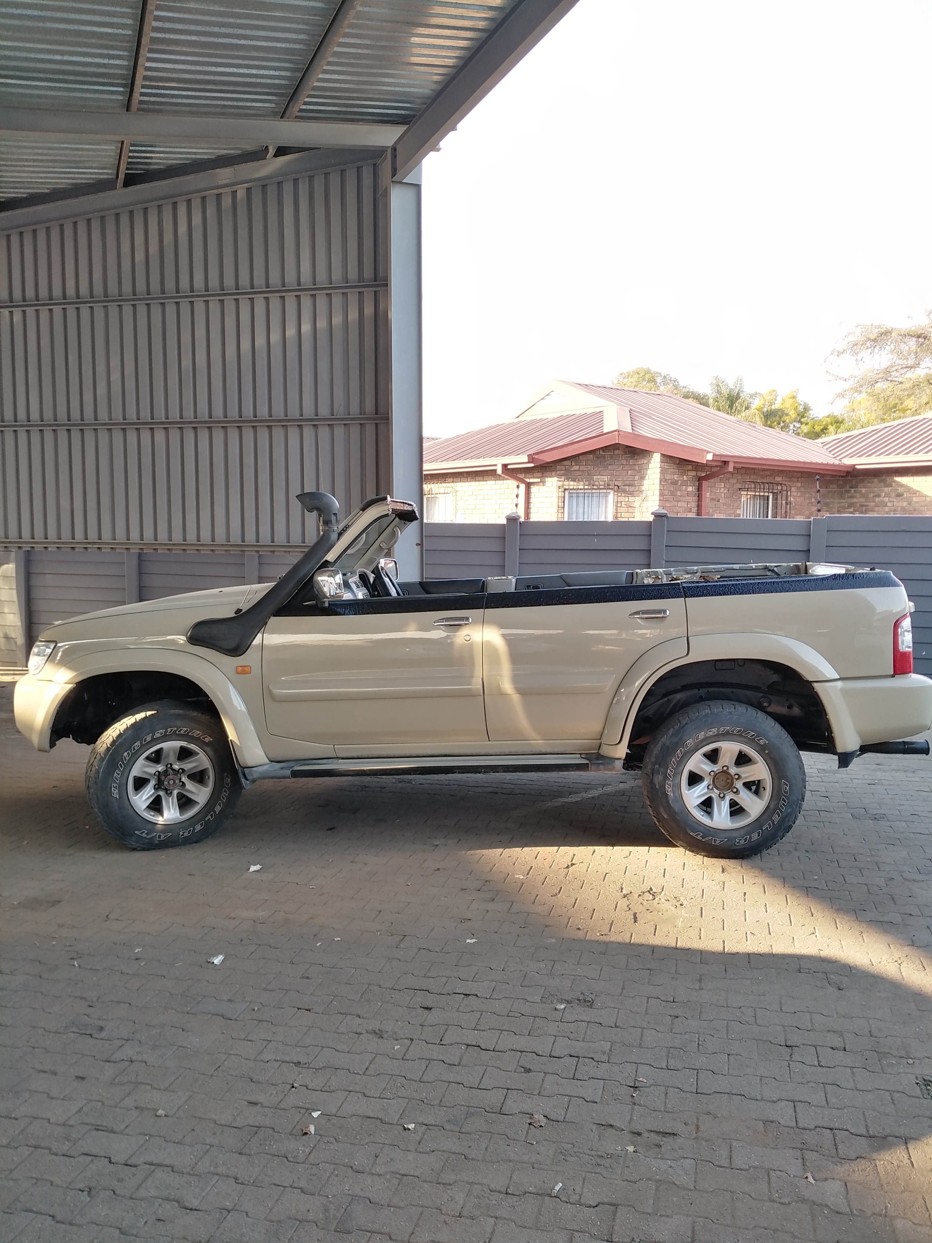

georgeb
Posts: 850
Joined: 07 Apr 2009 16:56
Full Name: George Brittnell
Nickname: georgeb
Home Town: Hartbeespoort
Has thanked: 98 times
Re: Who is doing what to their patrols ?
Post by georgeb »
Top less....
