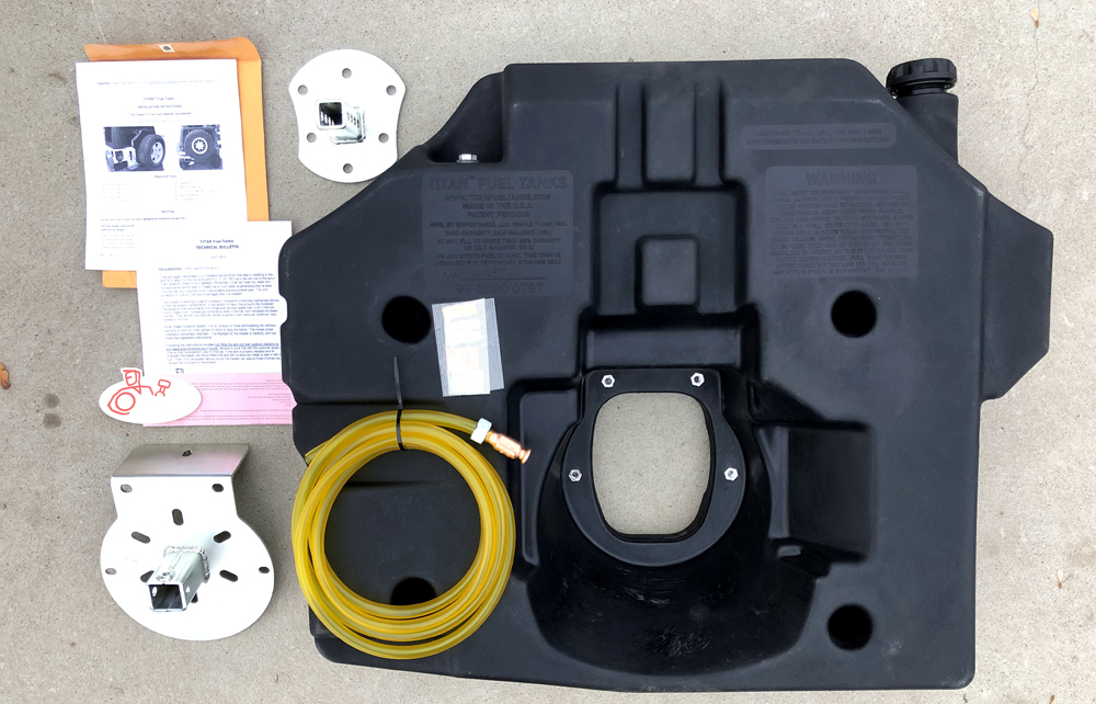

Any of you looked into the Titan Trail Trekker - HDPE build, mounted on the spare wheel carrier?
I guess this is more a product to vers the Jerry cans and is for that once or twice a year long trip.
https://www.off-road.com/blog/products/ ... nk-review/
