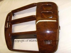

Hallo
I am rehashing a very old thread.
I went from the first to the last page but just could not get the answer I am looking for.
I have got a 2001 Patrol GRX with the center dash trim containing two single din slots separated by a plastic bar in the middle.
I know you also get this trim unit which has got one big hole to accommodate a double din radio unit.
I would like to fit such a double din Radio/GPS unit, meaning that I will have to cut out the center bar.
Has anyone done this and will a double din unit fit nicely without having gaps etc. ?
Pictures ?
I just don't want to cut/ ruin the trim piece just to find out that the double Din Radio unit does not fit properly.
Henning

Re: GPS/RADIO REPLACEMENT
Hi Picasso
Rather than taking the risk of cutting the double din Radio/GPS unit, you could also contact Dawid Volschenk, who is likely to have the right spare for you.
Next time he is doing the rounds in Pretoria he coudl bring it aong and you can first see if it fits.
Dawid: oh, eight, three, 499, one 5 double 8.
Thanks Alex
I will give Dawid a call.
However, I must also say that I fetched my car about an hour ago from Graham (service at G tech) and I had a look at his double din GPS unit. He faced the same issue. He made the unit fit by carefully cutting of the piece in the middle. Effectively the hole was now slightly bigger in height than the required double din size. He then used the cut off and glued it at the bottom which eliminated the gap. Fit and finish looked quite good. So…. I will give Dawid a call and see if he has the right spare available. If not then I will consider going the route which Graham took.
(Thanks to Graham too :idea:
Best Regards
Henning
Best Regards
Henning
