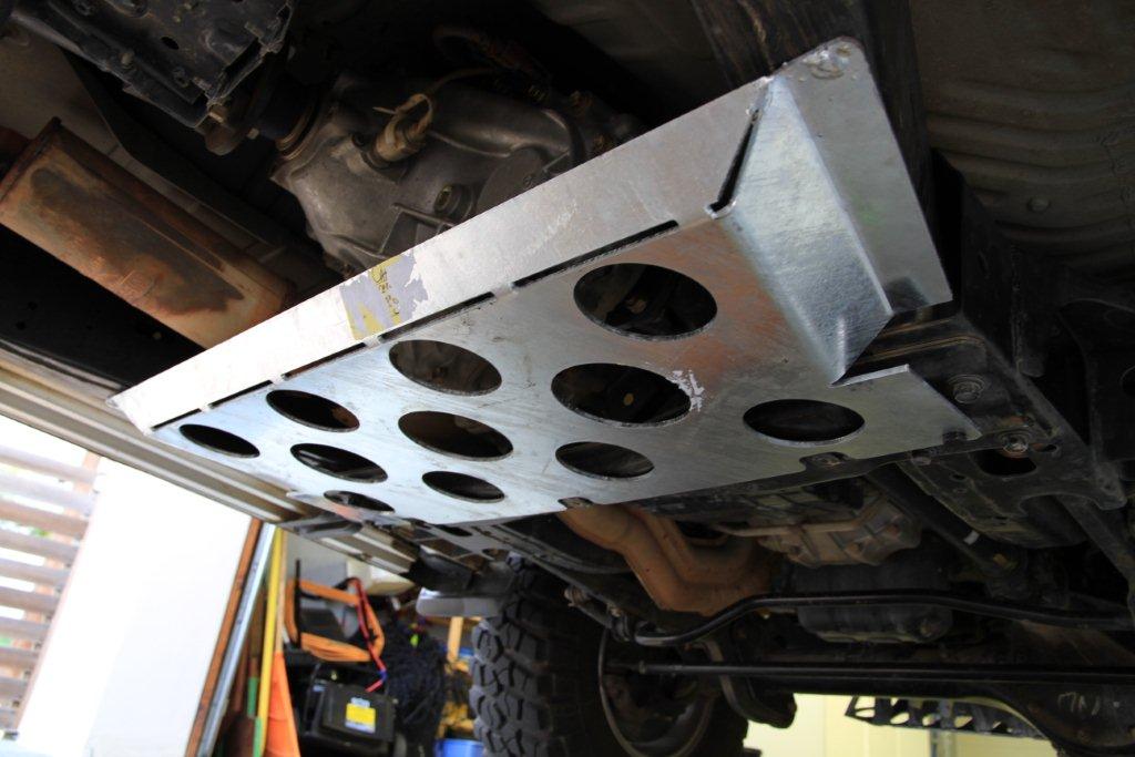

Installed skidplate today and just wanted to say a big thanks to Peter for the excellent job with both plates, the skidplate fitted better than an OEM part!
Needed to shorten the two bolts 15mm to stop them from pushing up into the chassis but once this was done it was a breeze even without a handlanger...photo of skidplate fitted.
skidplate
skidplate

That skidplate looks mean! Peter: I'm no engineer so maybe this a stupid question. Why have big holes cut into the plate instead of a flat surface? Cant rocks 'snag' on the big holes?

Save weight.

Hi Carlo
You have a point, but:
Wilhelm is 40% right. Remember that a lot of us are already worried about what will happen the day we are on our way to the bush and we get pulled of at the weighbridge.
The other 60% is made up as follows:
40%: If it is flat and solid, mud and stuff will collect there. This can start interfering with the operation of the car, cause stuff to rust and also poses a significant fire hazard because oil from a leaking gearbox or transfer case will collect there and so will grass and grass seeds.
20%: The holes allow you to service the vehicle (replace gearbox and transfer case oil and grease the front propshaft) without having to remove the plate.

Thanks Guys. if weight is an issue why not make it in 6mm aluminium? The holes for allowing "self cleaning" sounds like a good idea thought :thumbup:
On the weigh bridge. can you explain why thats potentially an issue?

Post by AndriesS »
Your vehicle is limited to a max weight by design and license , the license authority can remove your vehicle from the road or fine you if you are over weight, adding big heavy protection adds to it and also reduce your payload. Thus weight saving allows you to add that extra beers without your vehicle being remove from the road.
