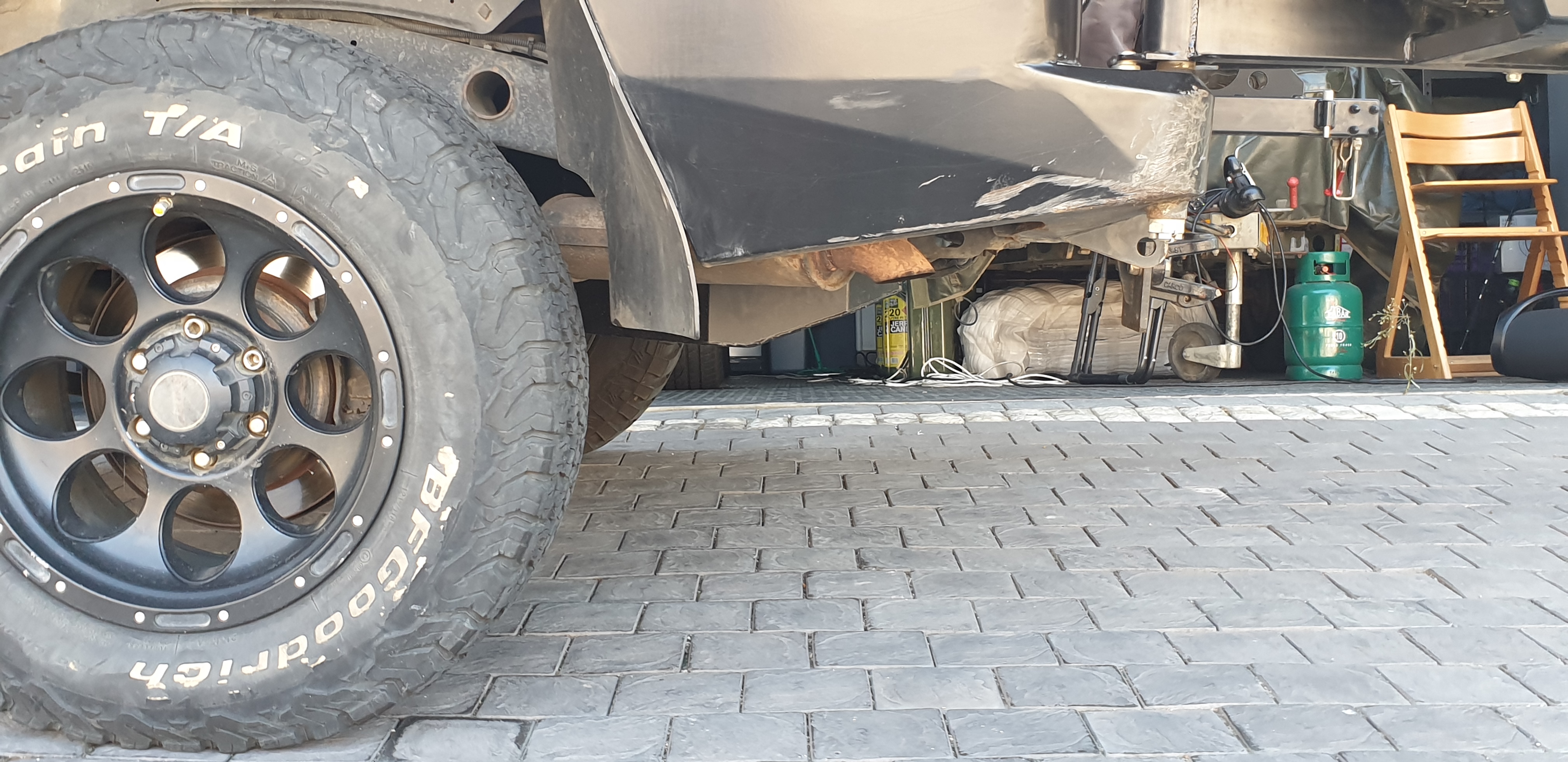

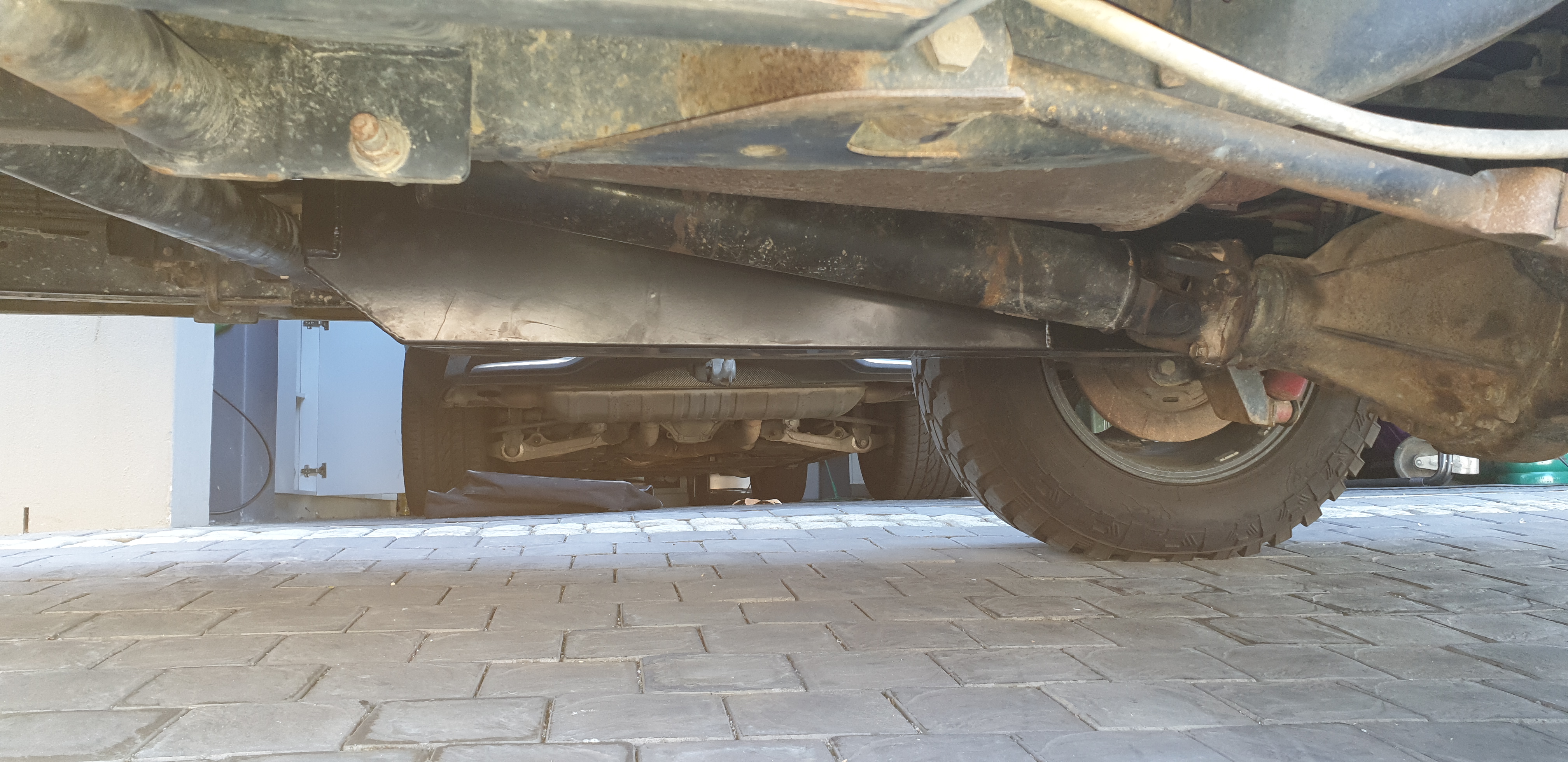

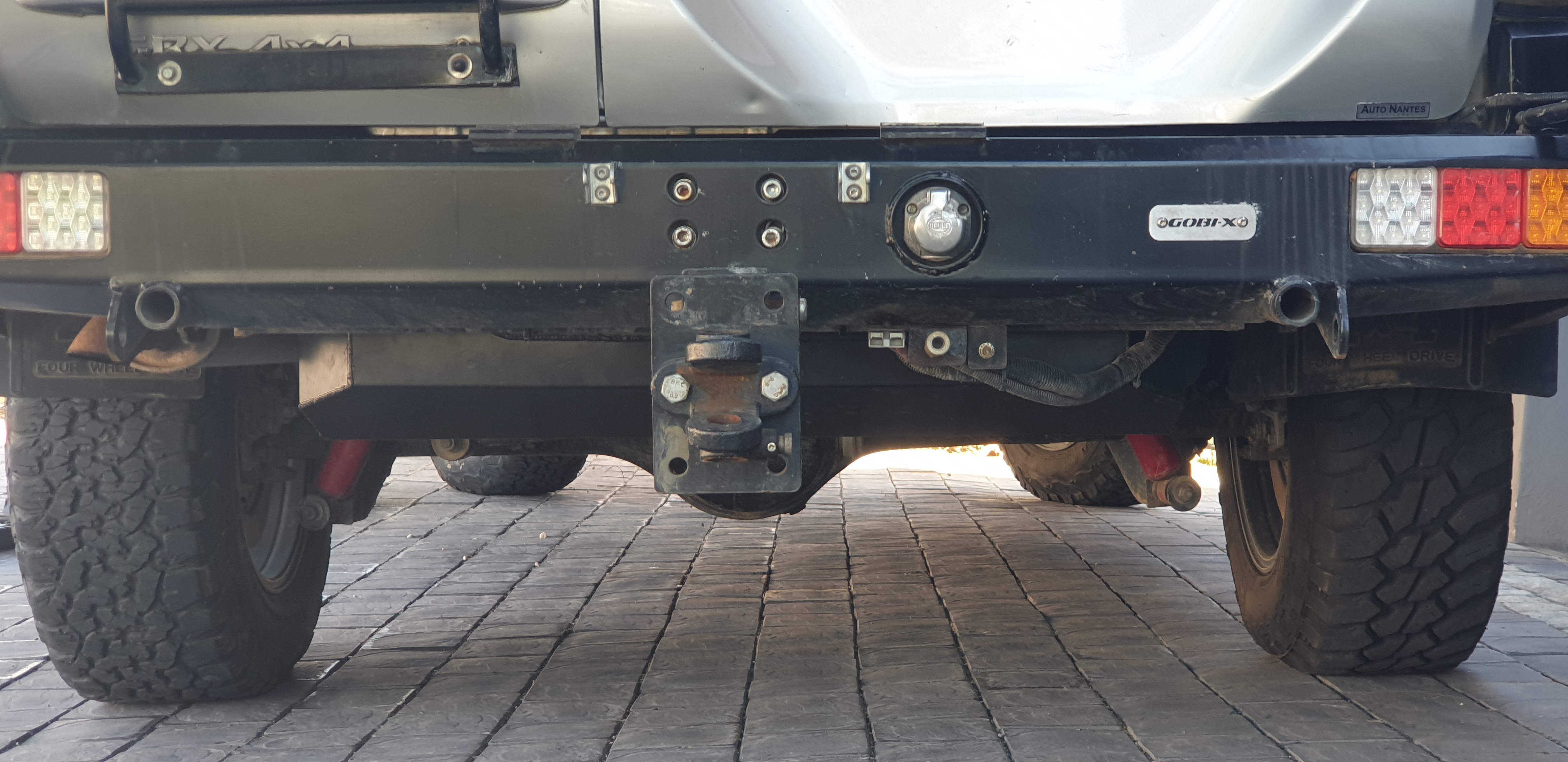

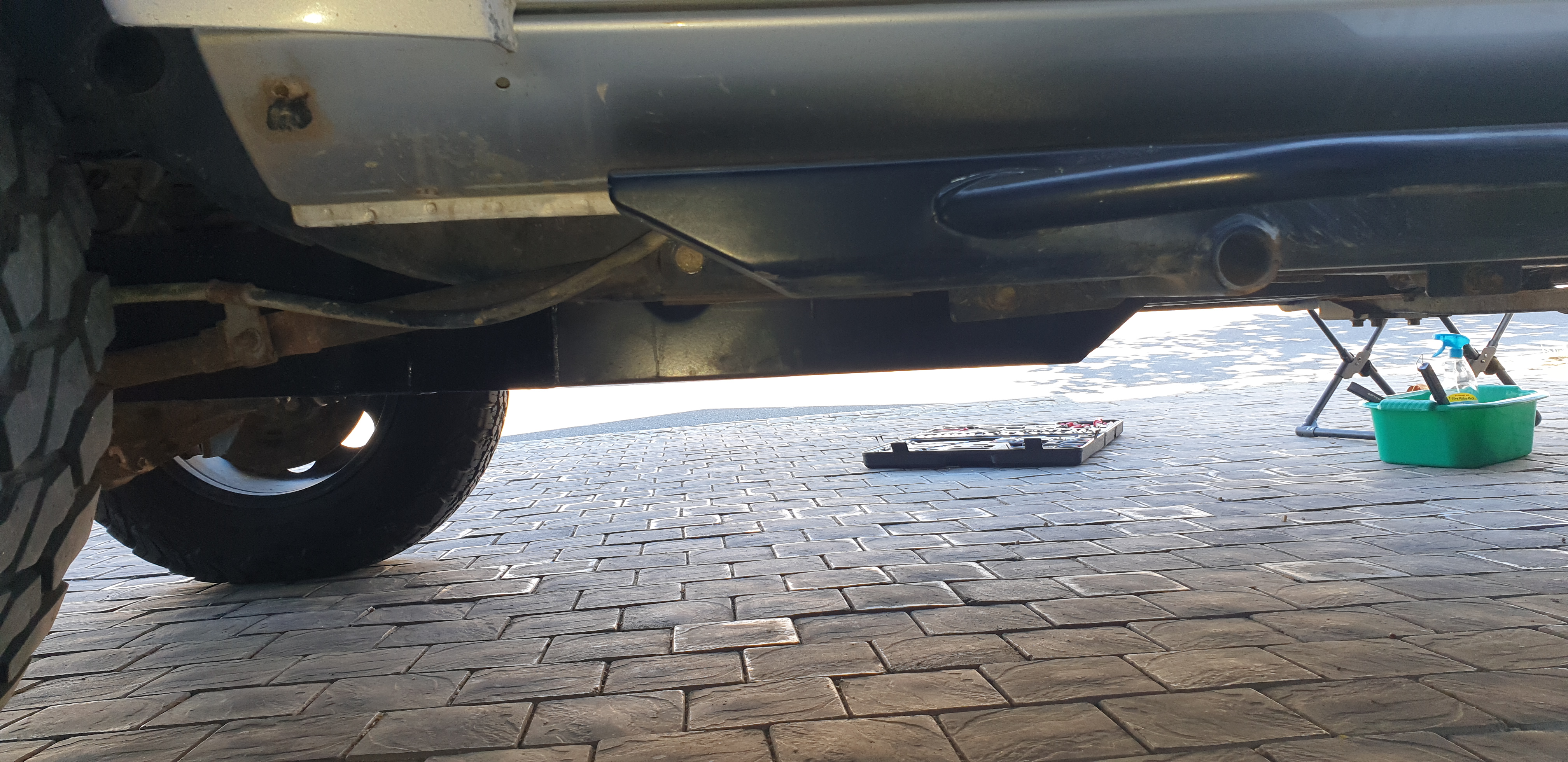

Re: Browne Davis Long Range Fuel Tanks
Hi Guys
I've attached some more pictures I took today to show the profile of the tanks to show where they stand proud of the chassis under the Troll.
You'll see that they dont hang too low below the vehicle when you consider their associated storage capacity which goes to show much space they utilise up into the cavity within the chassis as opposed to hanging too far down, which is a concern that I had when I bought them.
You may just notice that I've swopped the tail shaft around so that the smaller diameter part of the shaft is now connected to the transfer case as opposed to the differential. I did this because I noticed that after I had lifted the car even higher with a new coil kit that the tail shaft had clear abrasions from knocking the cross member of the chassis. Swopping the shaft around has nothing to do with fitting the tanks.
What I have noticed is that the fuel gauge for the auxiliary tank only goes half way up when the tank is full. We didnt have enough time to fix this due to the Covid-19 shut down, but will take another shot at seeing Iif we can fix it when R&D opens again.
I've not yet had a chance to drive sufficient distance to quantify my additional range, because after fitting the tanks it went back into R&D about 2 weeks later to have some more modifications done to it and now of course we can't drive much due to the lock down.
I think the rear tank is fine. Probably no lower than mine.
The sub-tank though... That's probably going to take a knock or two if you do serious trails. Mine is exactly level with the bottom of the chassis rails and that has a nice gouge in it.
My tail-shaft is also reversed. Was like that when I got the car. I actually wonder why that's not the standard orientation...
