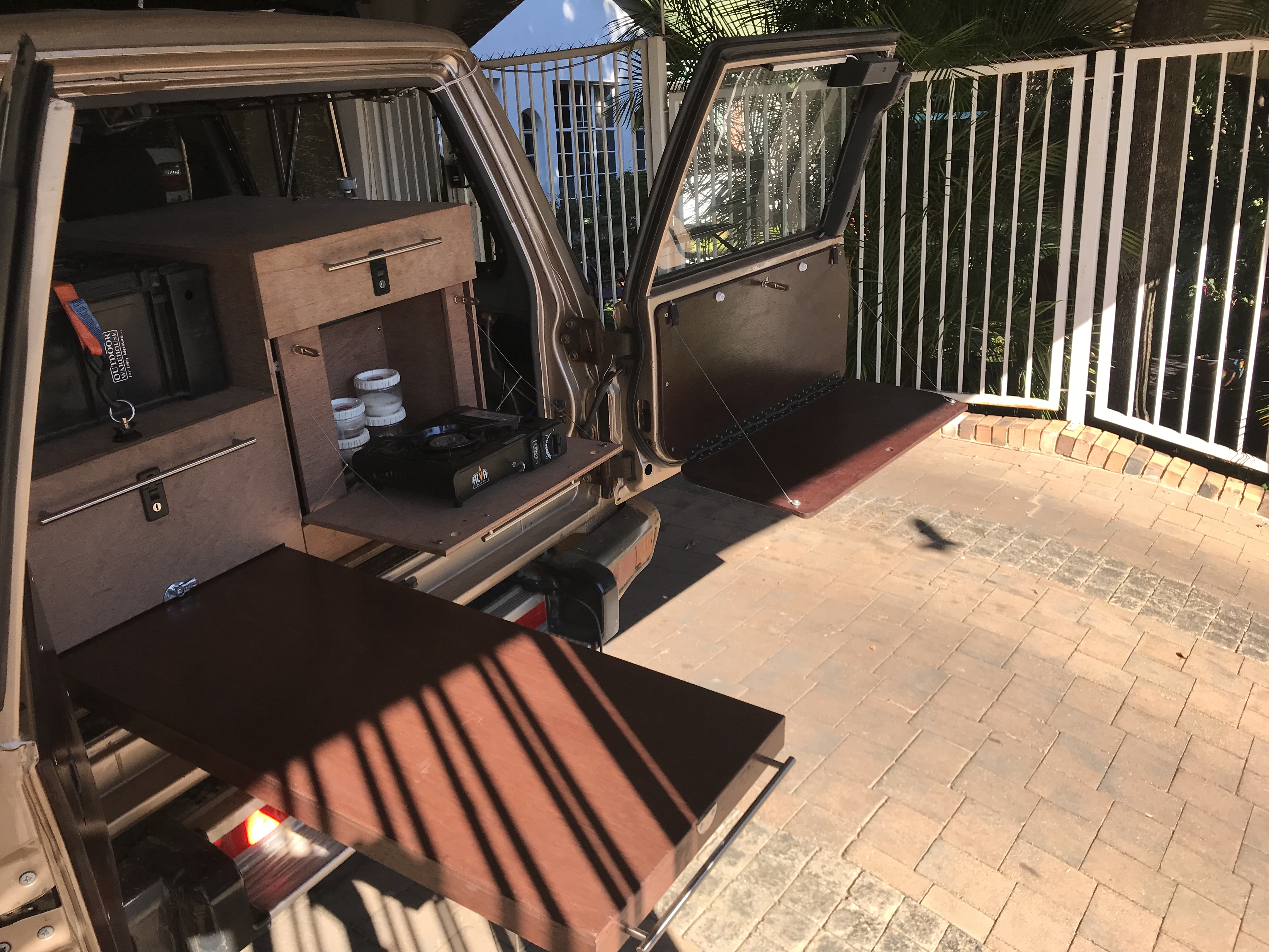

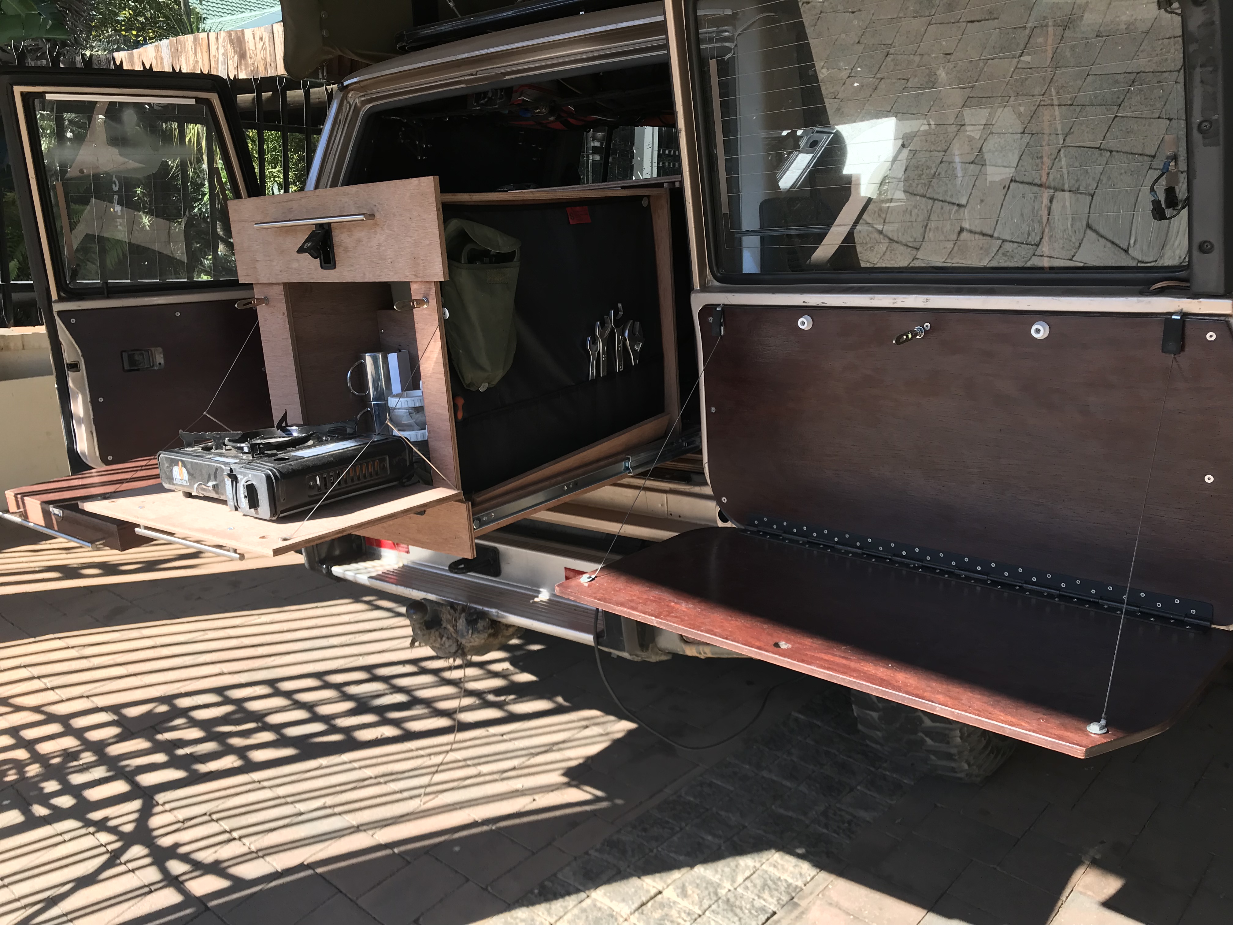

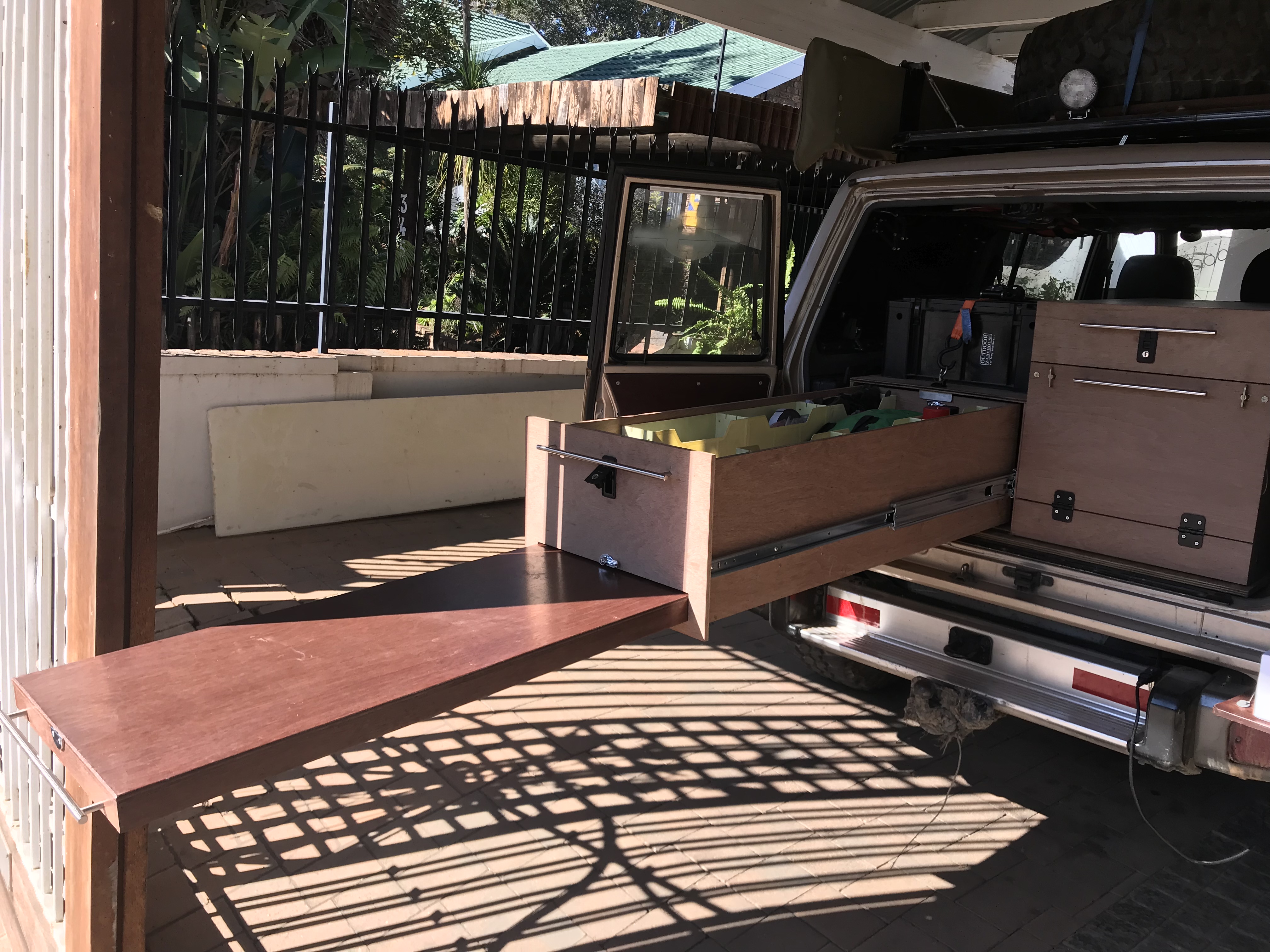

So I will first post on it’s position at the moment
Re: My KoolStoof, so oud soos Ek (TD42-Ti GQ 1997)
Netjies makker
Anthony Forgey
Posts: 488
Joined: 07 Apr 2016 09:46
Full Name: Anthony Forgey
Nickname: Anthony
Home Town: Randburg
Has thanked: 182 times
Been thanked: 206 times
Post by Anthony Forgey »

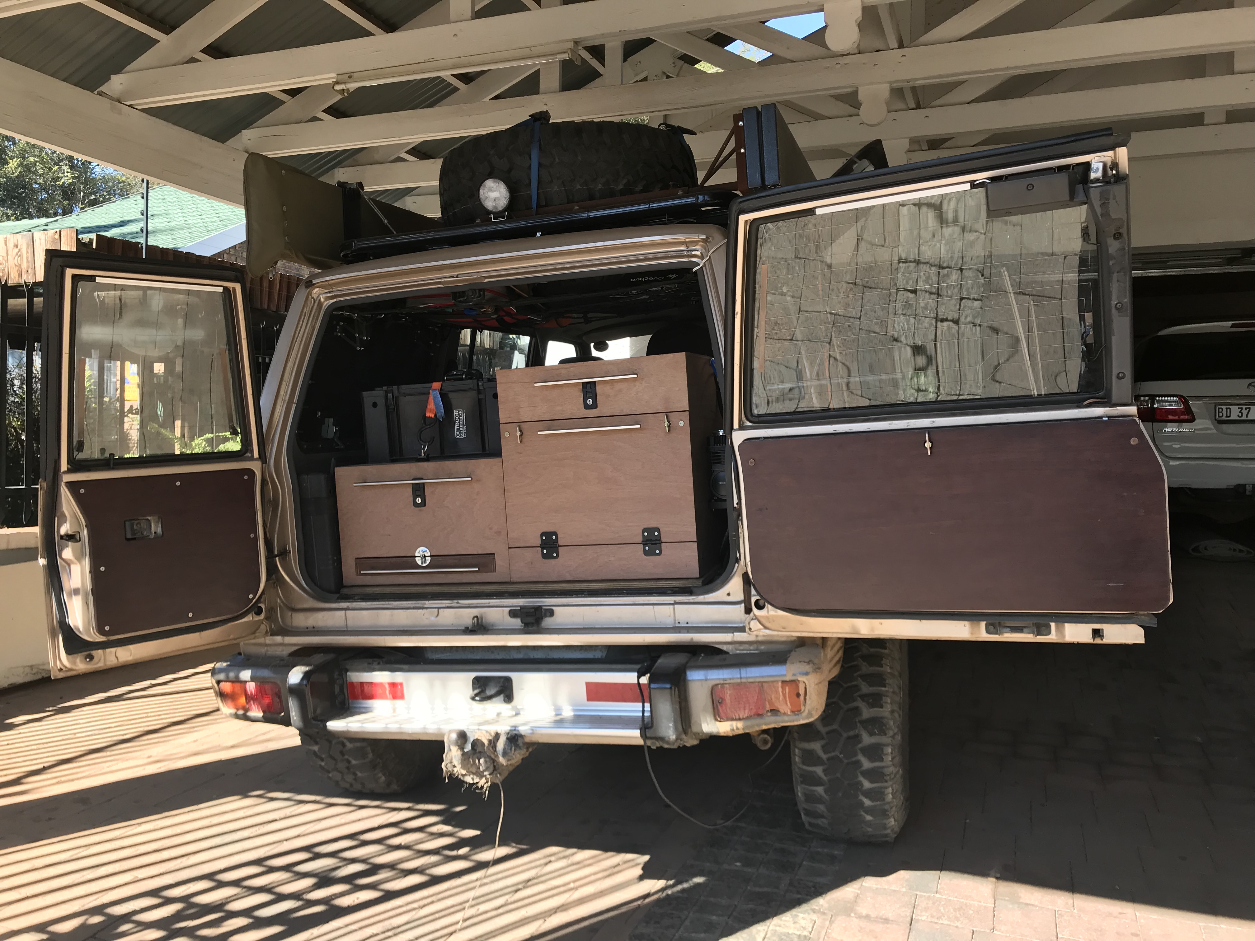

That is really very good Tijmen. I think fridge access would be a challenge for anyone an average height or less :rolling: maar jy's lank so dis nie n issue nie :lol:
how did you get the barn door to open so wide?

Thank you.
I cut the hinge pivot point off and only moved them 10mm outward. When it is open it doubles that distance and clears the lights.

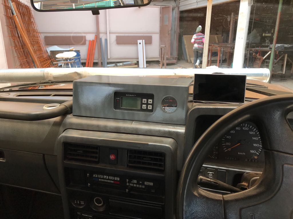

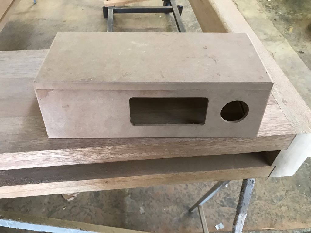

So first I will rewind to before Desember. I was trying to prepare for our West Coast trip but time was running out.

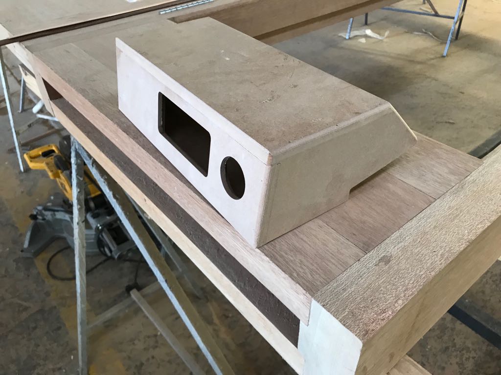

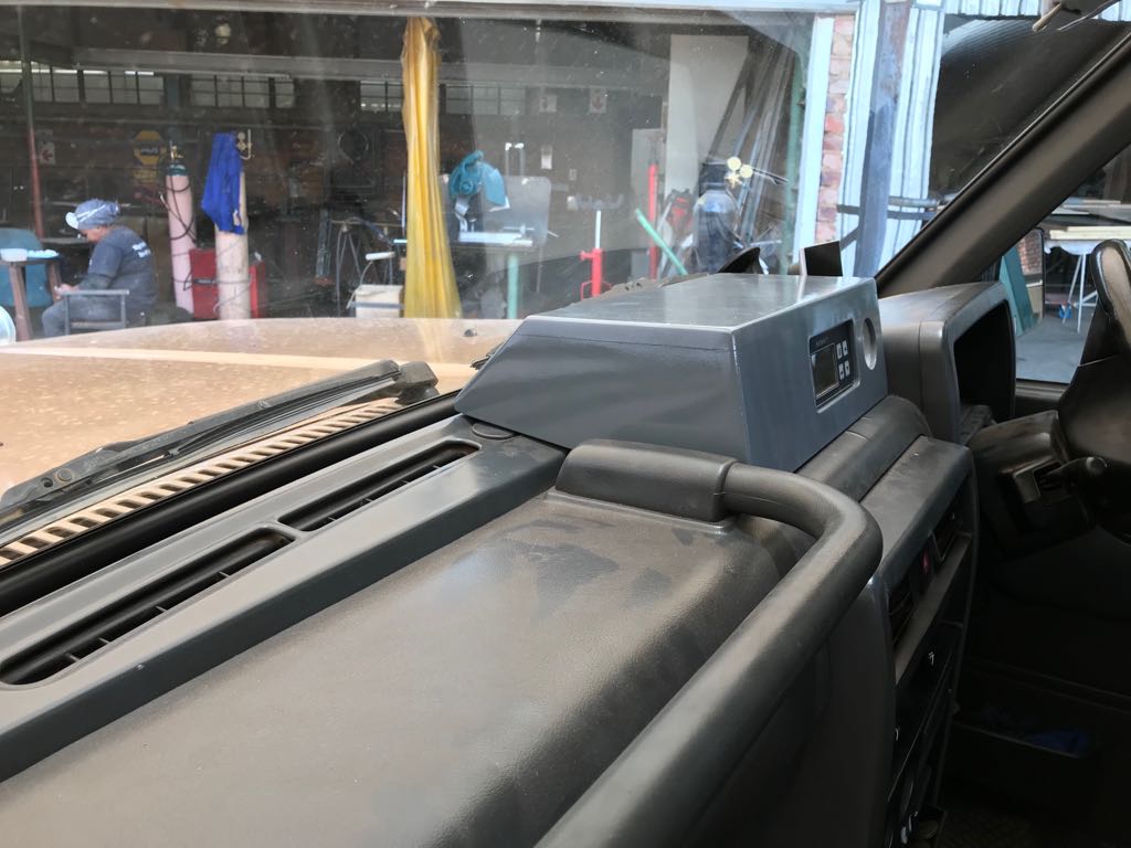

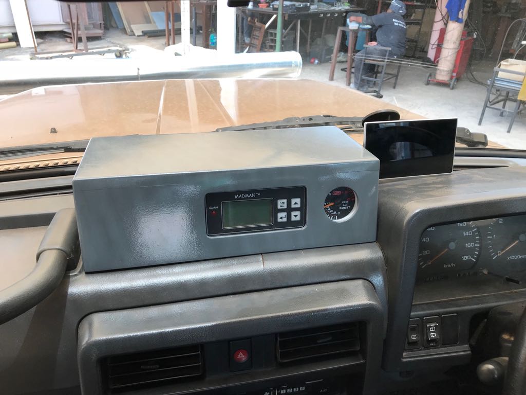

Firstly I made a Dash Pod for the Madman and Boost guage.
Now after December I found that a painted box is not a good idea because the heat that it receives from being directly in the sun the Madman’s LCD screen darkens completely. At times I had to switch the aircon to the windscreen vent to cool it down. Will probably cover it in acoustic carpet soon. But other than that the doublesided tape held and it worked quite well.

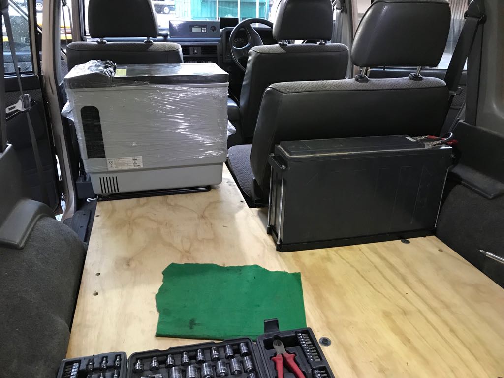

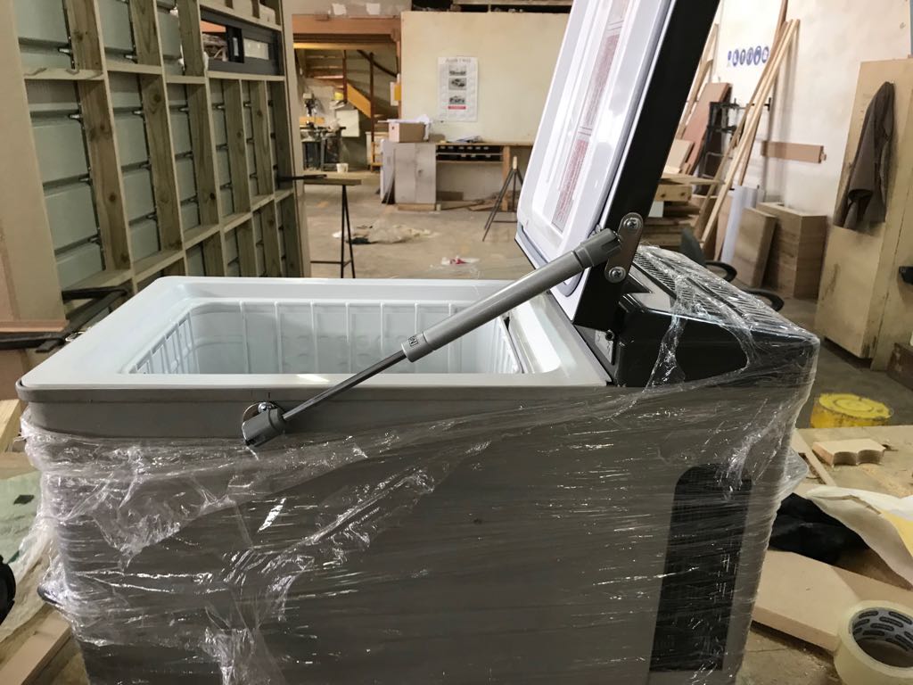

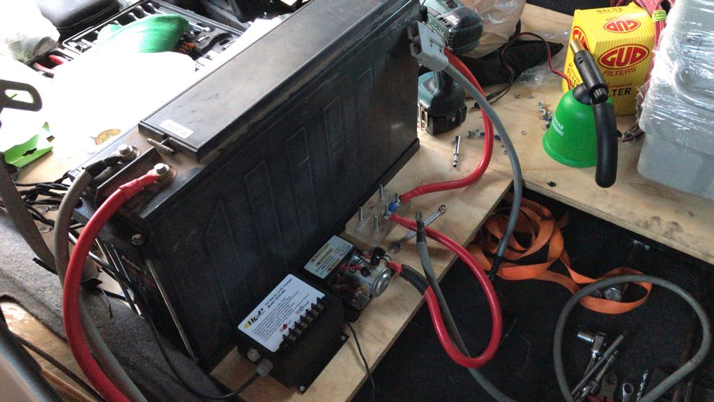

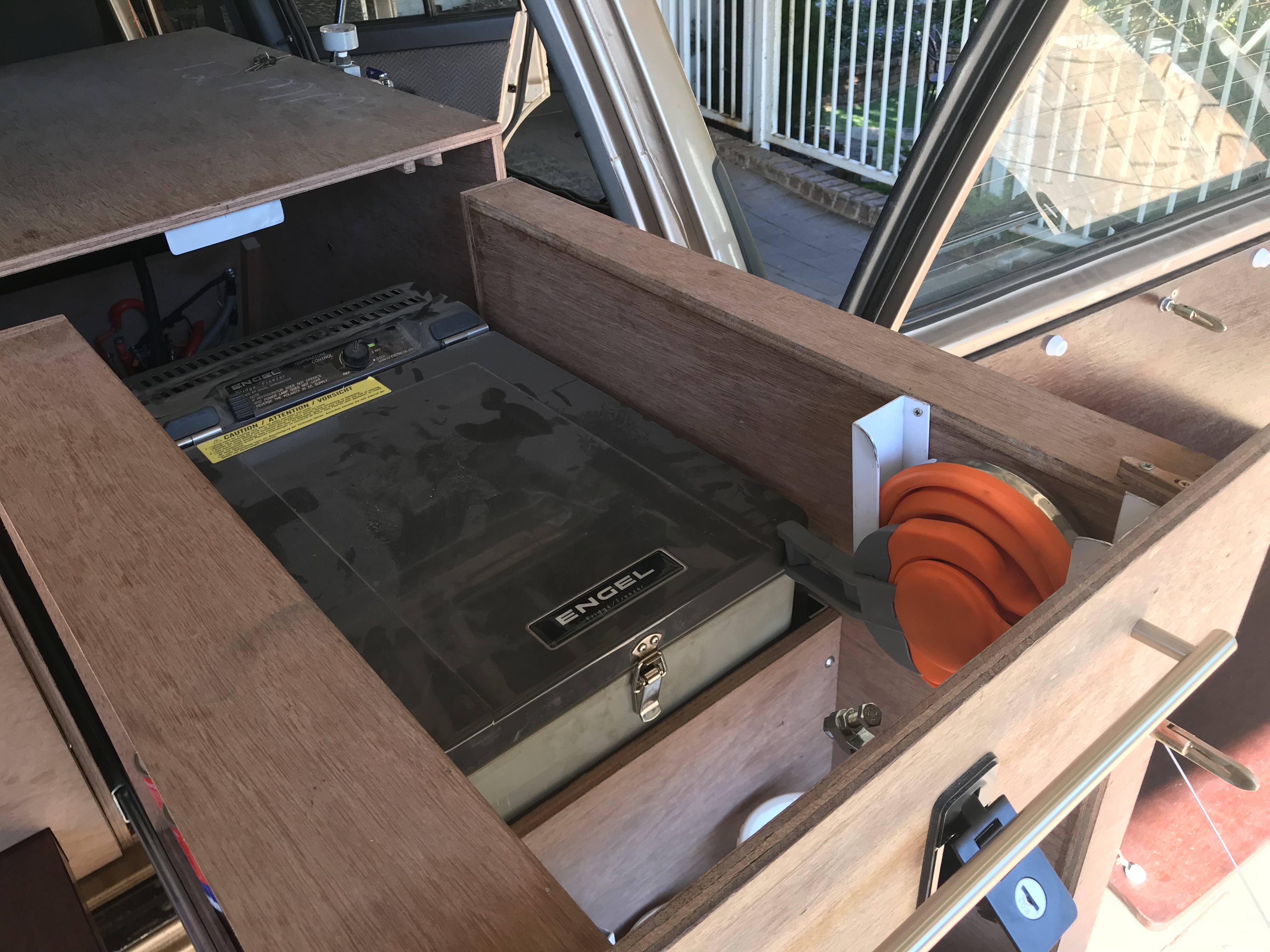

So I took one of my seats out to put my fridge in a position that I can reach from the front seat.
And so the next problem was the lid, so I put a Gemar cabinet gas strut on for R15
I also built a base, mounted the fridge and battery and did some last minute messy wiring to get everything working for the Rust de Winter trip.

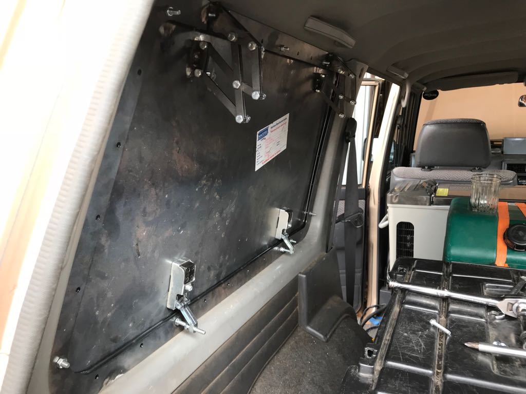

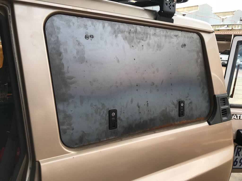

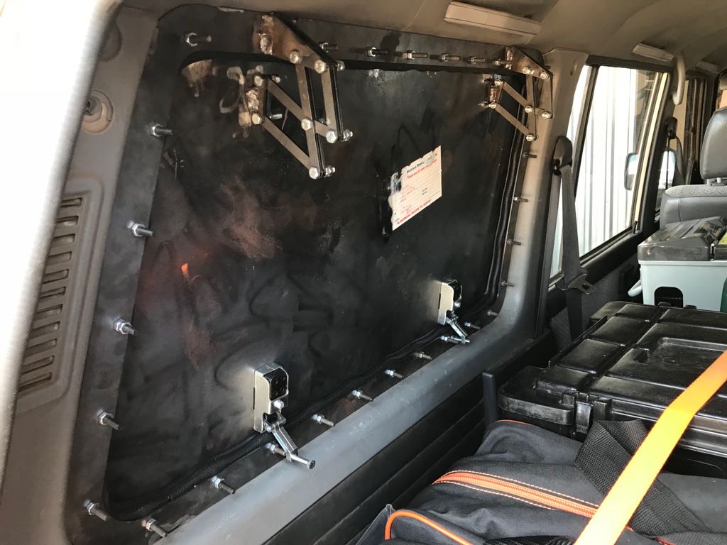

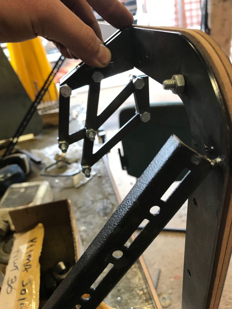

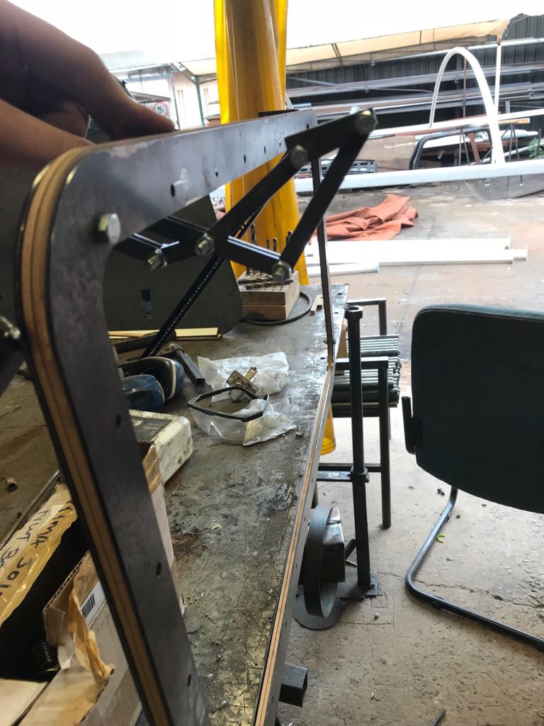

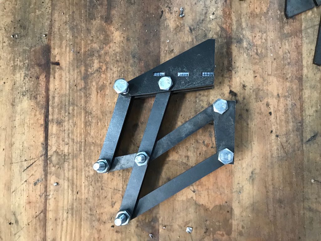

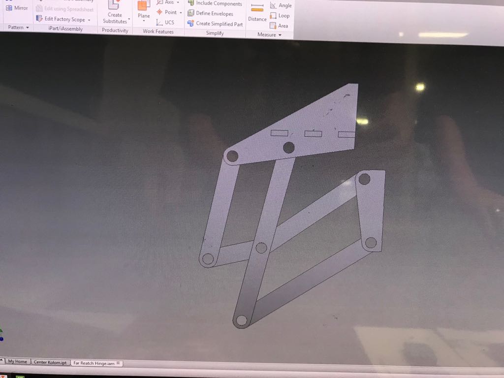

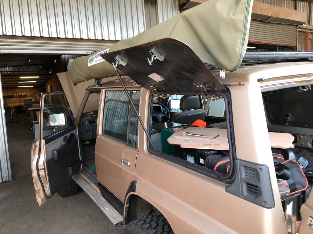

On last years river trip I somehow managed to break one of my rear windows. So that forced me to start the gullwing build. Had a lot of trouble to figure uout how to make one that does not require welding or drilling on the body. The biggest issue was the hinges kept binding in the corners and I couldn’t find a suitable hinge so I found a 7 point hinge design on the internet and changed it to suit my needs and had it lazercut, It works but still have to minimize some play on the joints and add gas struts.

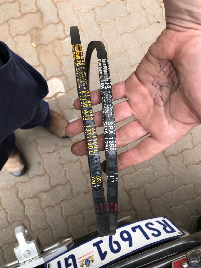

I also found some fan belts at BMG that fits the TD42 and was just over R100.
OEM over R900 :surprised:
