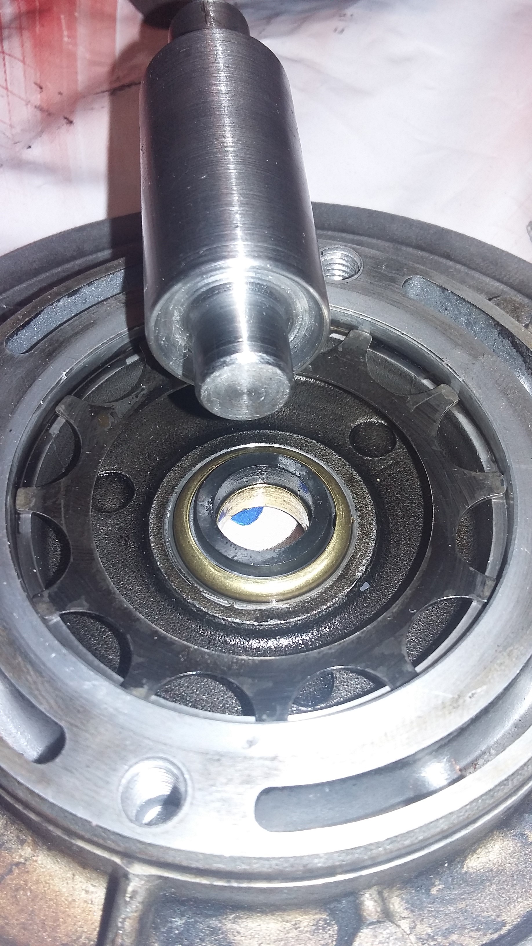

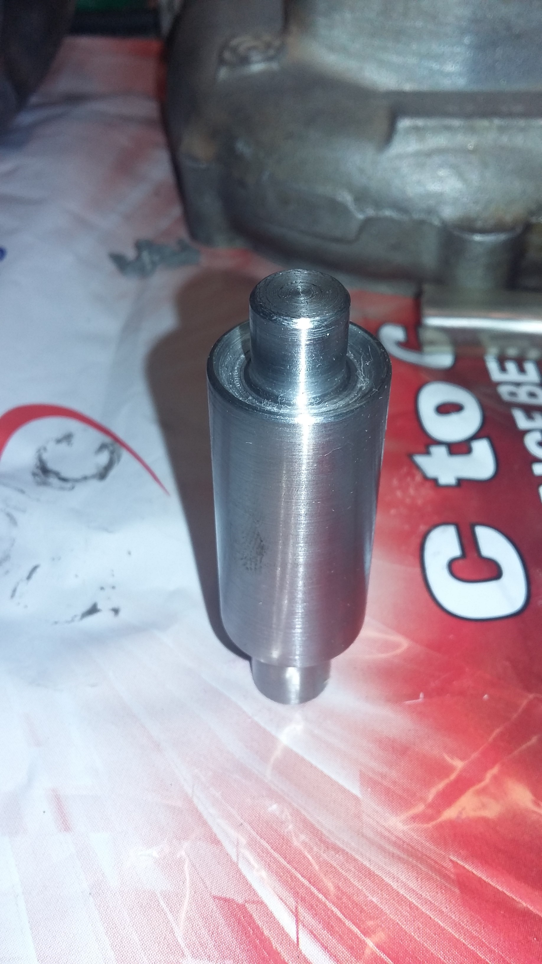

More of the tool I made up
- 15.jpg (922.42 KiB) Viewed 2867 times
- 16.jpg (1.23 MiB) Viewed 2867 times
- 17.jpg (1.11 MiB) Viewed 2867 times

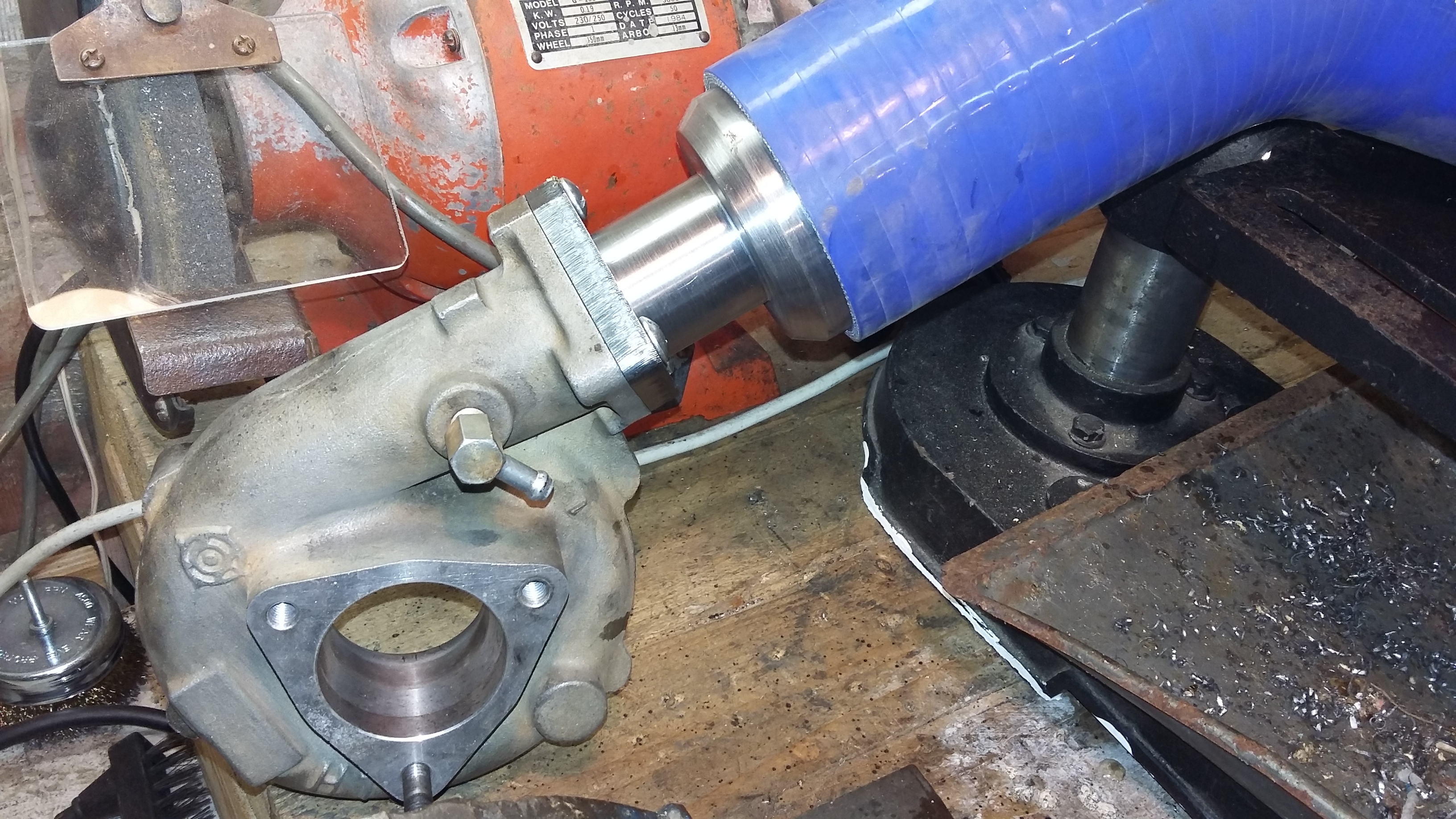

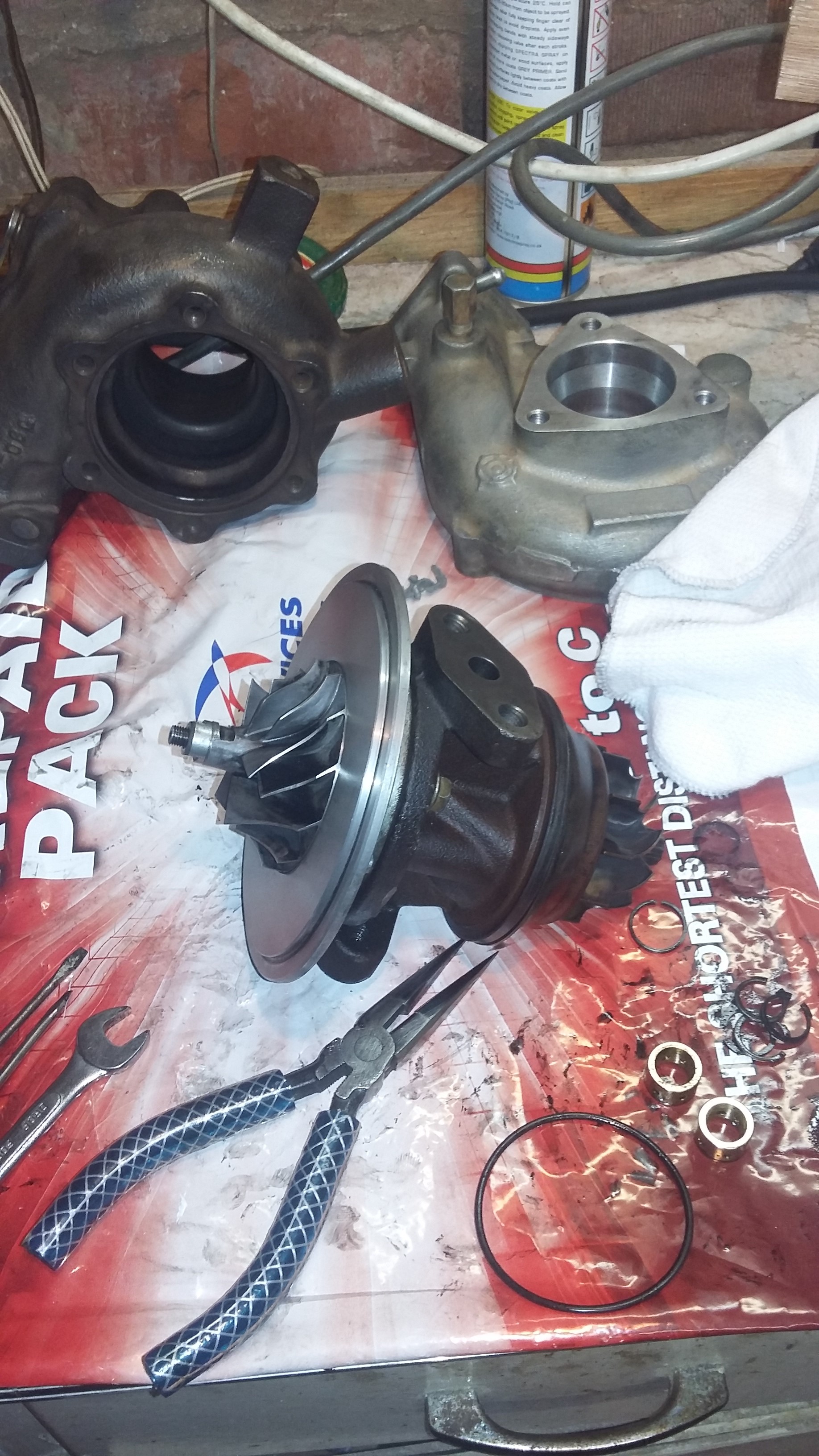

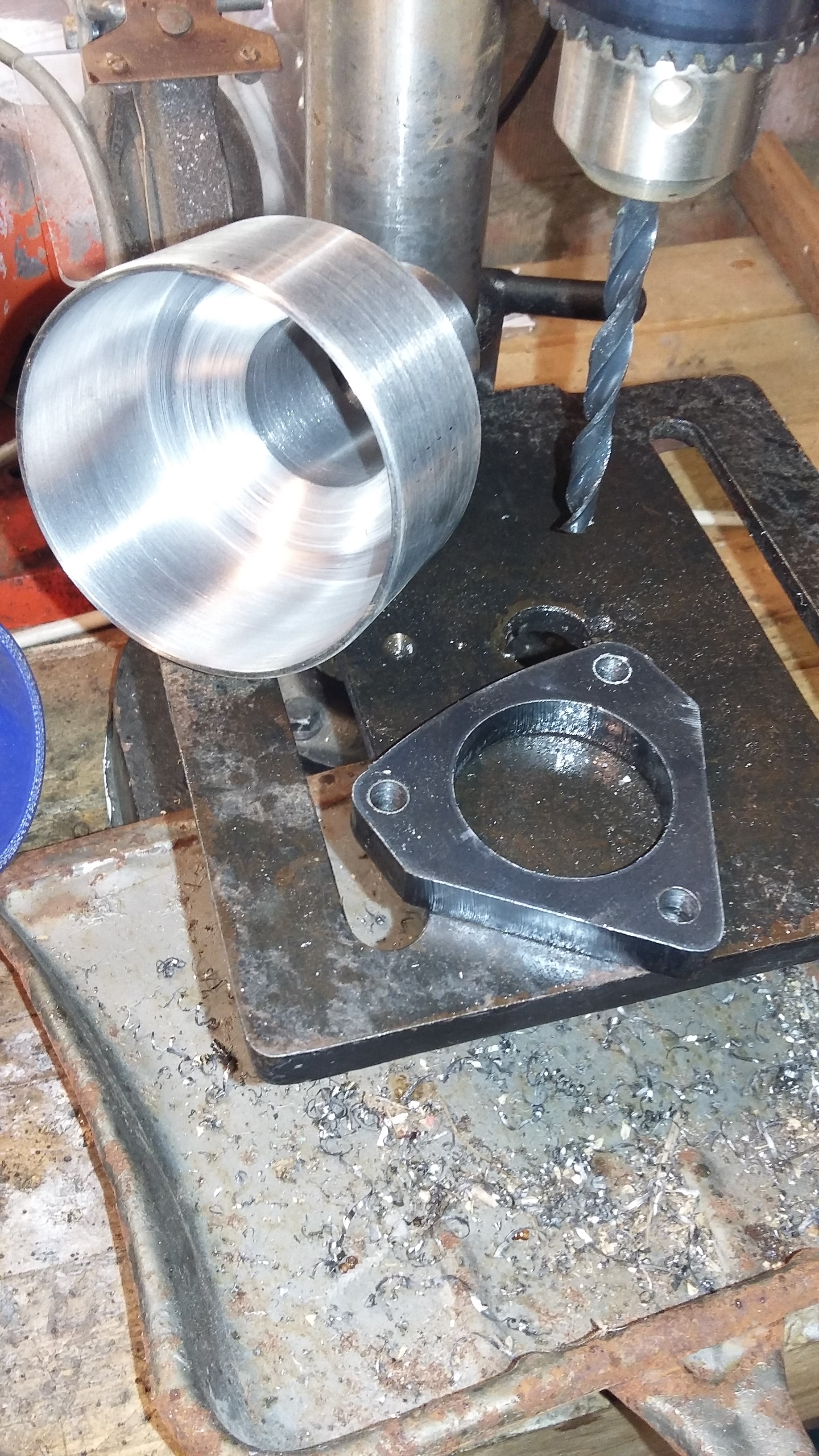

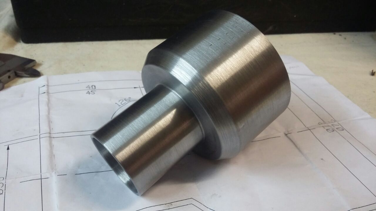

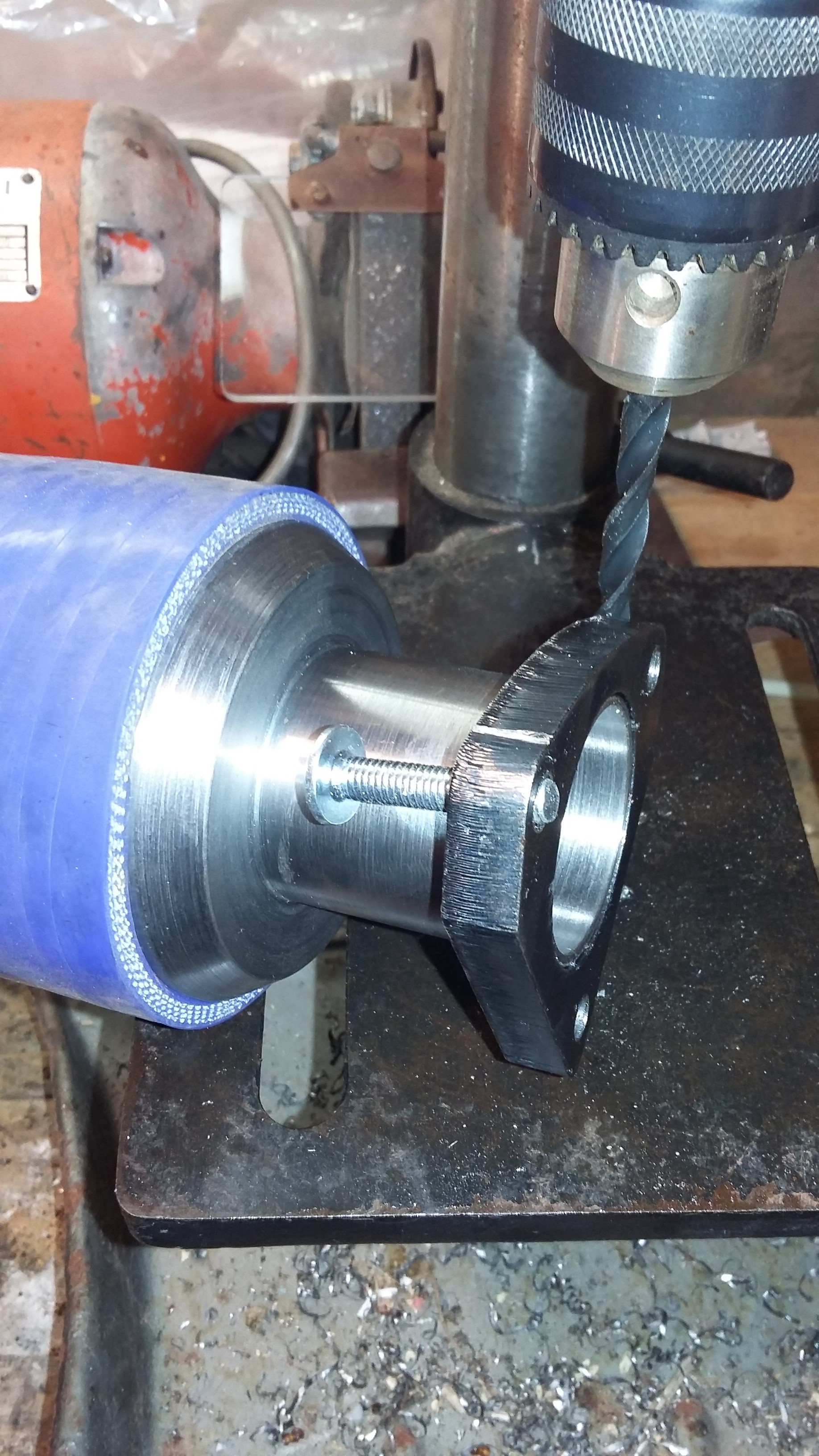

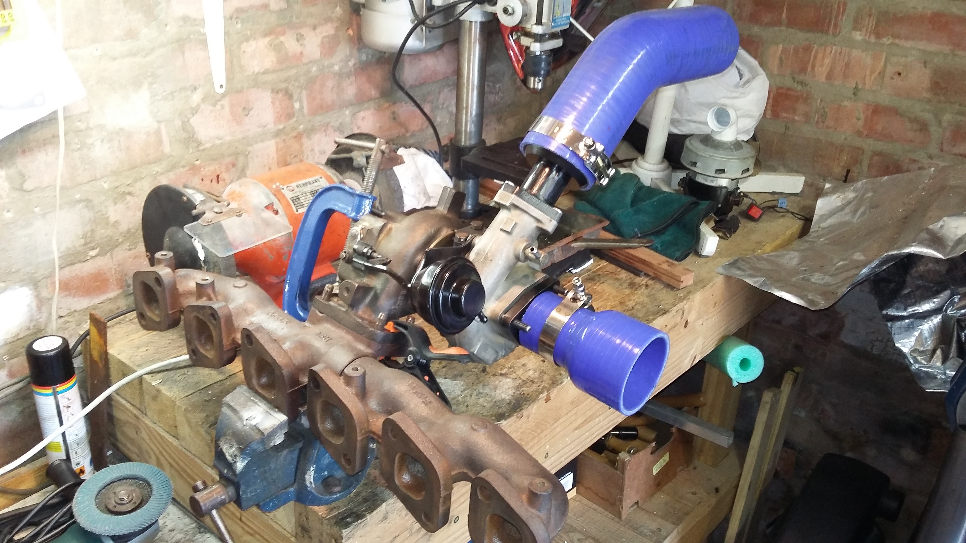

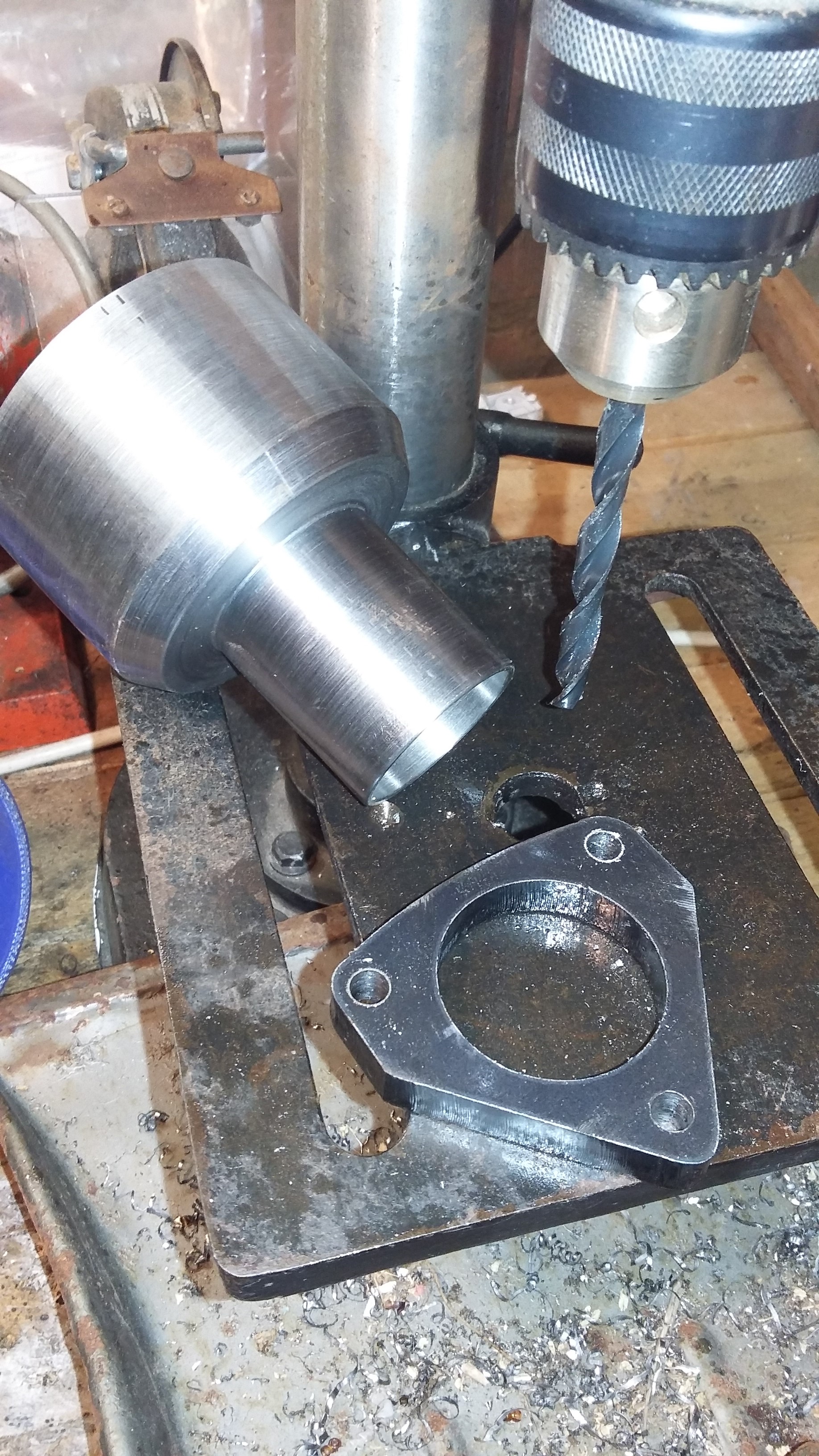

I had to machine up some custom fittings for the turbo inlet and outlets to fir the silicone piping.
The inlet runs 76mm from the air box and then reduces down to 50mm on the inlet.
The outlet runs 47mm on the housing through a custom tapered fitting straight to 76mm...ok, yes, I know the sudden size difference might cause a bit of lag because of the pressure difference, but I don't have enough space to step it up two size increments before going 76mm

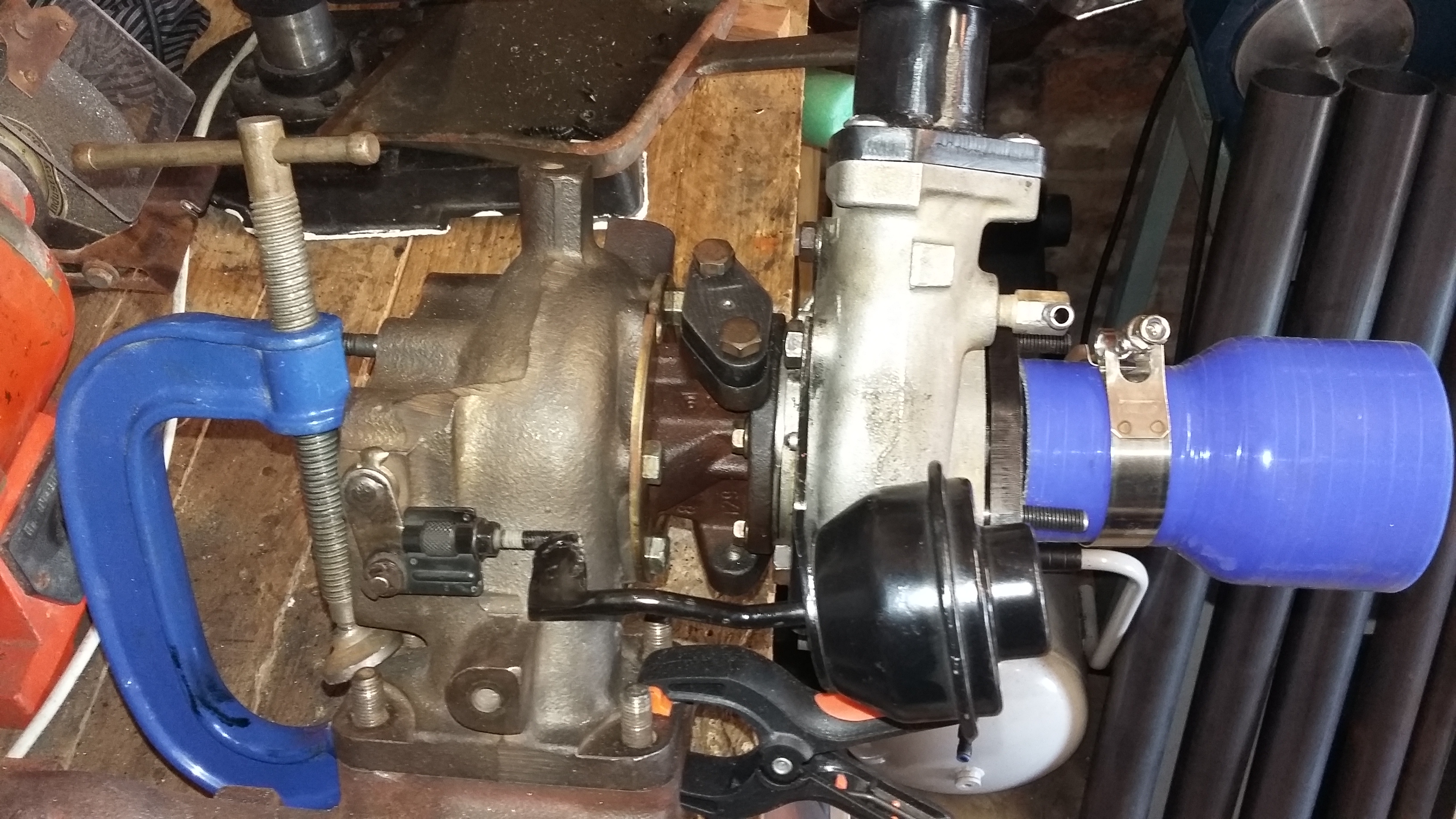

I clocked the turbo while mock mounted on the manifold and I had to put a fair bit of offset in the wastegate actuator arm, but it works

Re: My '98 GU 4.2D
Nicely done !!!
Suggestion... if still possible. If there is enough meat on the wall thickness of the reducer fitting, try machine a small lip on both ends to allow the silicone hose to still slide over but once there is a clamp on, it will seat better to prevent the hose from blowing off under high boost. I had it once and though I got shot..... hahaha.... made a big bang as the pipe popped off
