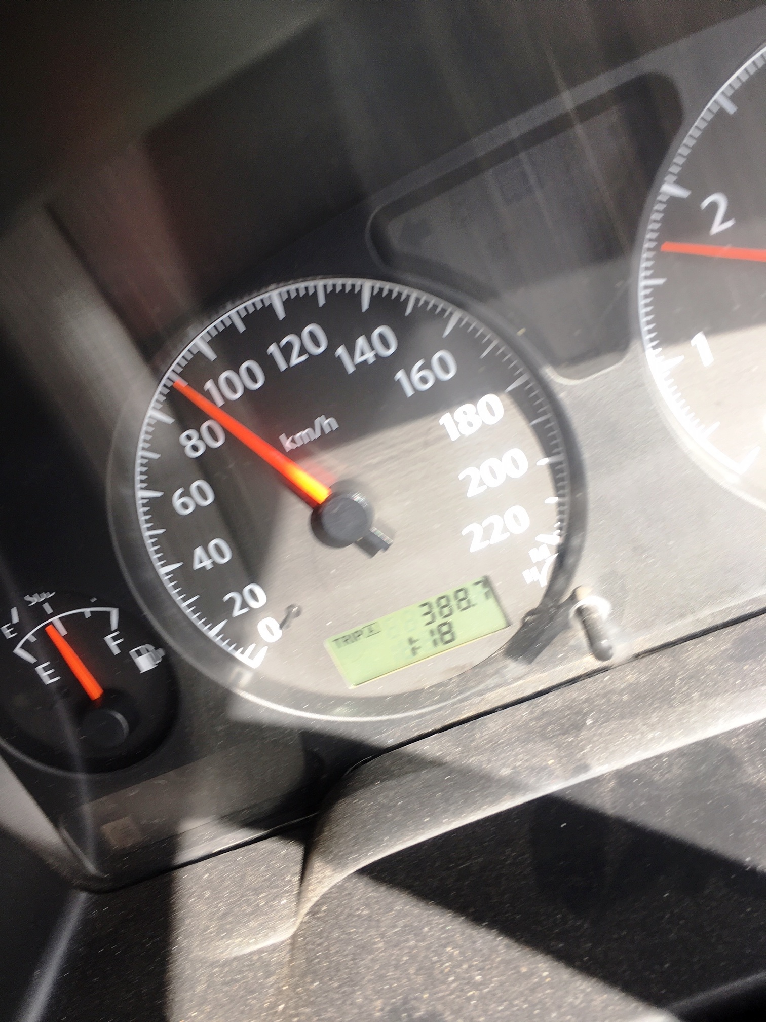

I got the best economy this weekend since owning my Patrol 4.8 GRX.
I joined a 4x4 club this past weekend for an economy trip from CapeTown to Lainsburg then down to R62 and back to Cape Town. overnight camped at porcupine rest camp - very nice spot)
Drove 506 Km between fill ups and only used 65 liters of fuel so averaged 7.8km per liter :
. Average speed was 90KM/H.
All other vehicles where diesel Isuzu and they got around 11- 13 km/l
was actually nice travelling at that speed, nice and relaxing.
Pic is off travelling 388 KM with almost half a tank of fuel left.
- IMG_2138.JPG (960.11 KiB) Viewed 10430 times

Thanks for the feedback Noel, and that goes to prove a point! The best consumption I got was also around 7,8km/l, at also 90 - 100km/h (230km's)

Did you have a roof rack on? And what tyre pressure were you at for the most part?
