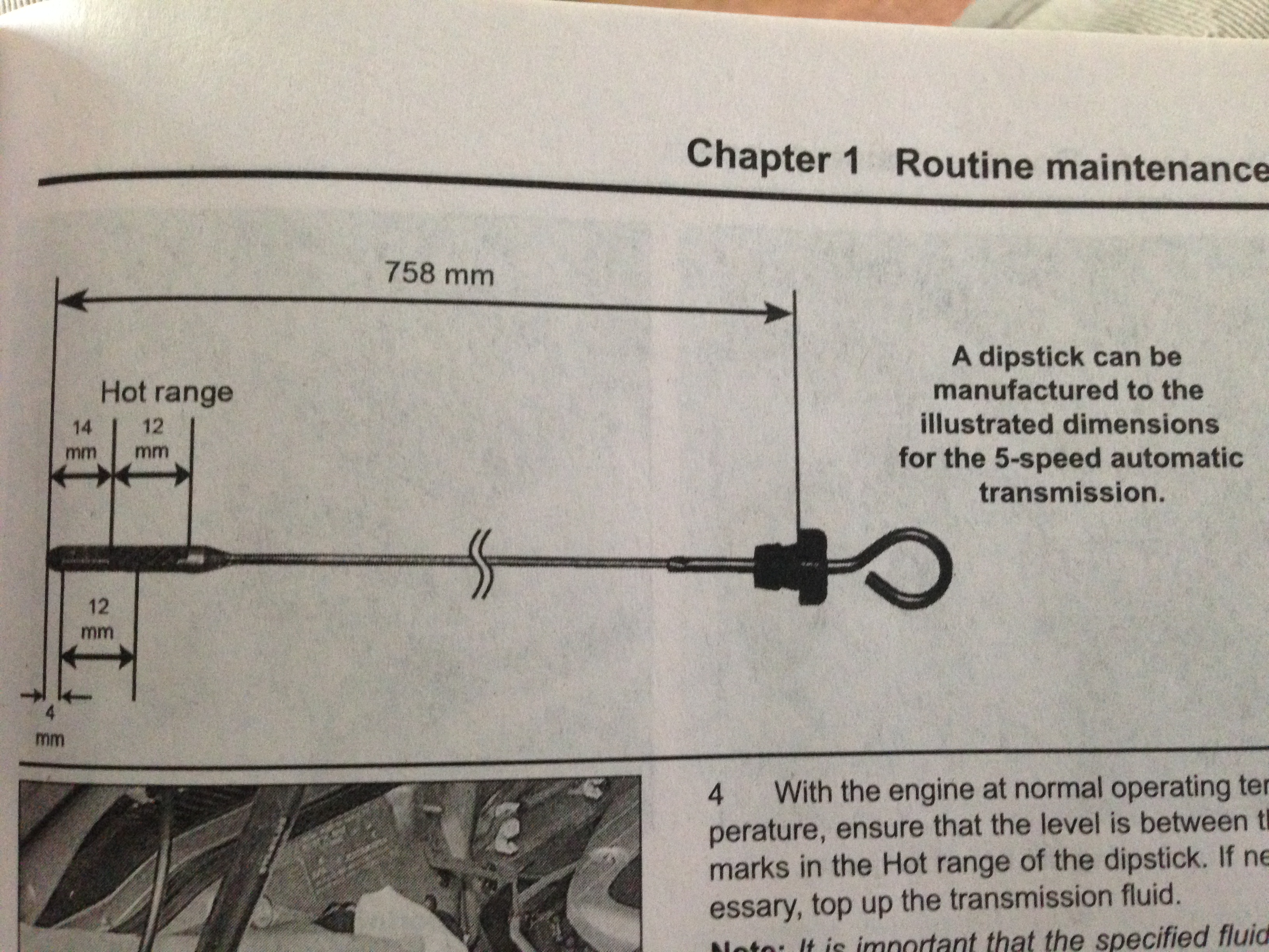

Here is the dimensions, I used a plastic rigid tube and marked it with permanent marker in the cold hot sections.

Thank you - that is very useful!

Where do you insert it, if I may ask the silly question! :biggrin:
Re: No reverse gear A/T
Unscrew the cap on the pipe :thumbup:

The pipe sits behind the engine oil dipstick on the driver's side of the motor, as Tinus says you just unscrew the nut securing top pipe to the oil filler charge pipe.
There is a silver sticker attached to the top charge pipe which states to only use Nissan Matic J so you should find it easily.
You are only supposed to remove this top pipe to insert the dipstick and once you have checked/topped up the autobox oil you must remove the dipstick and replace the top pipe and secure it with the nut. IE don't leave the dipstick in permanently.
