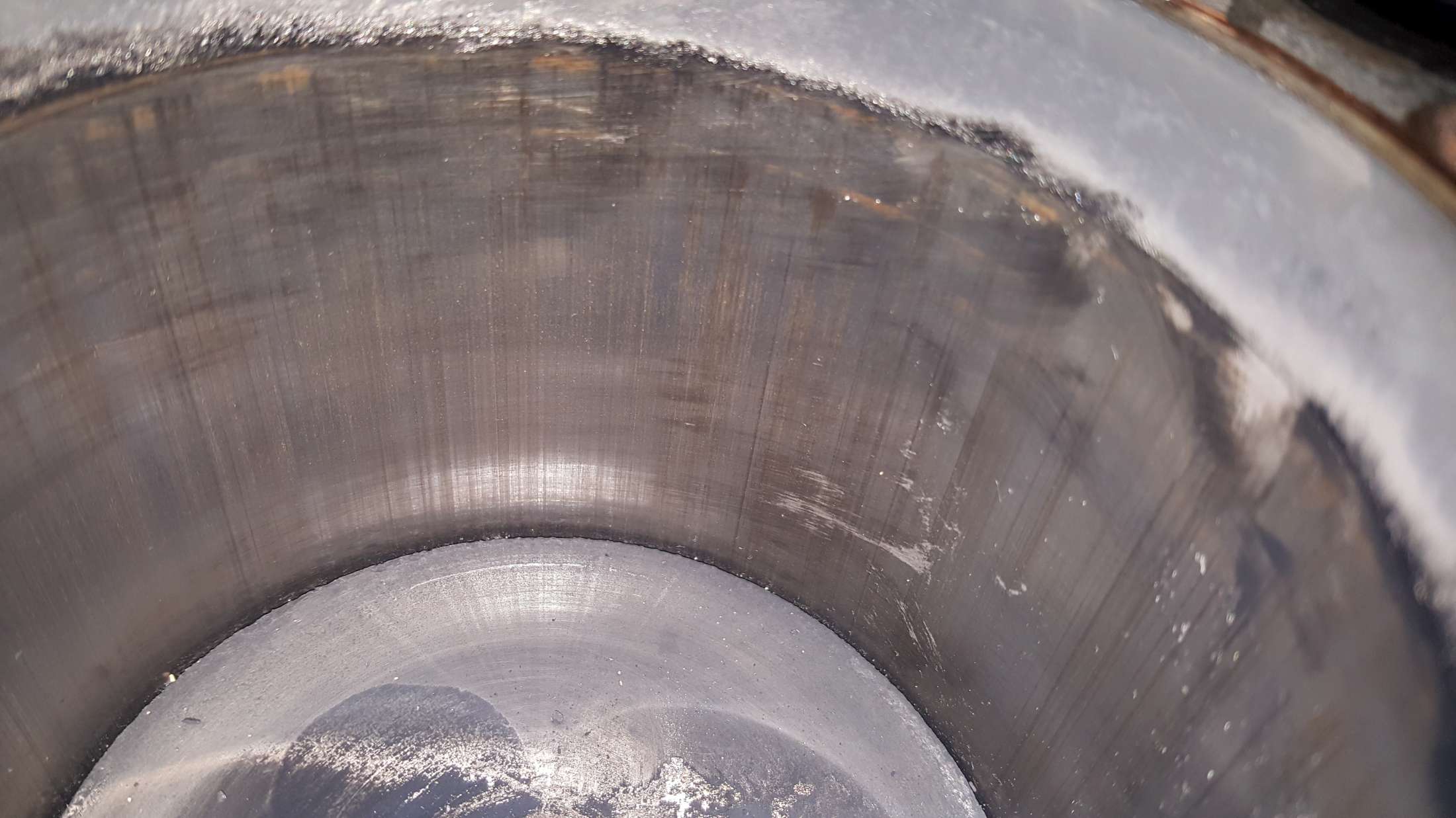

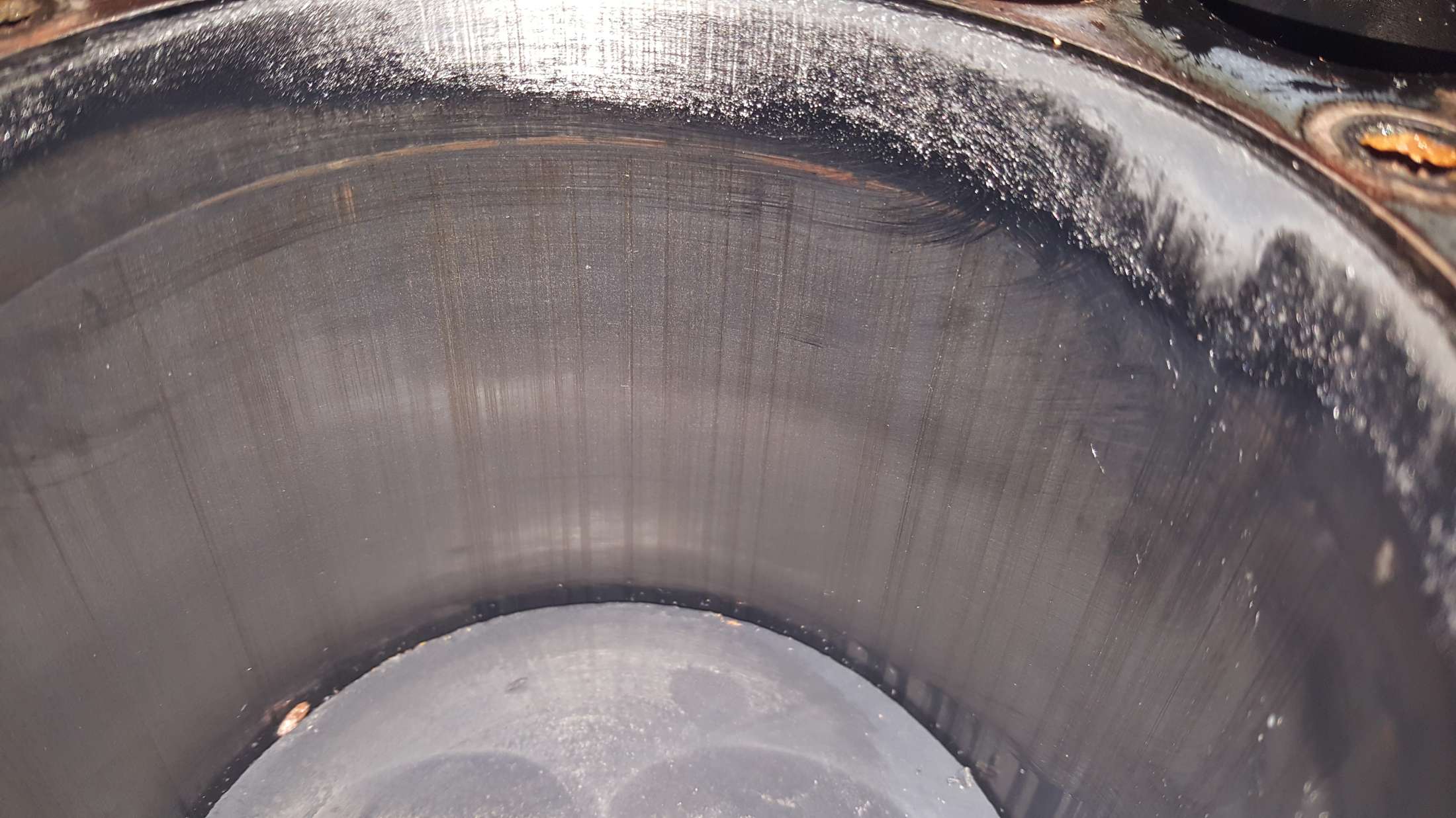

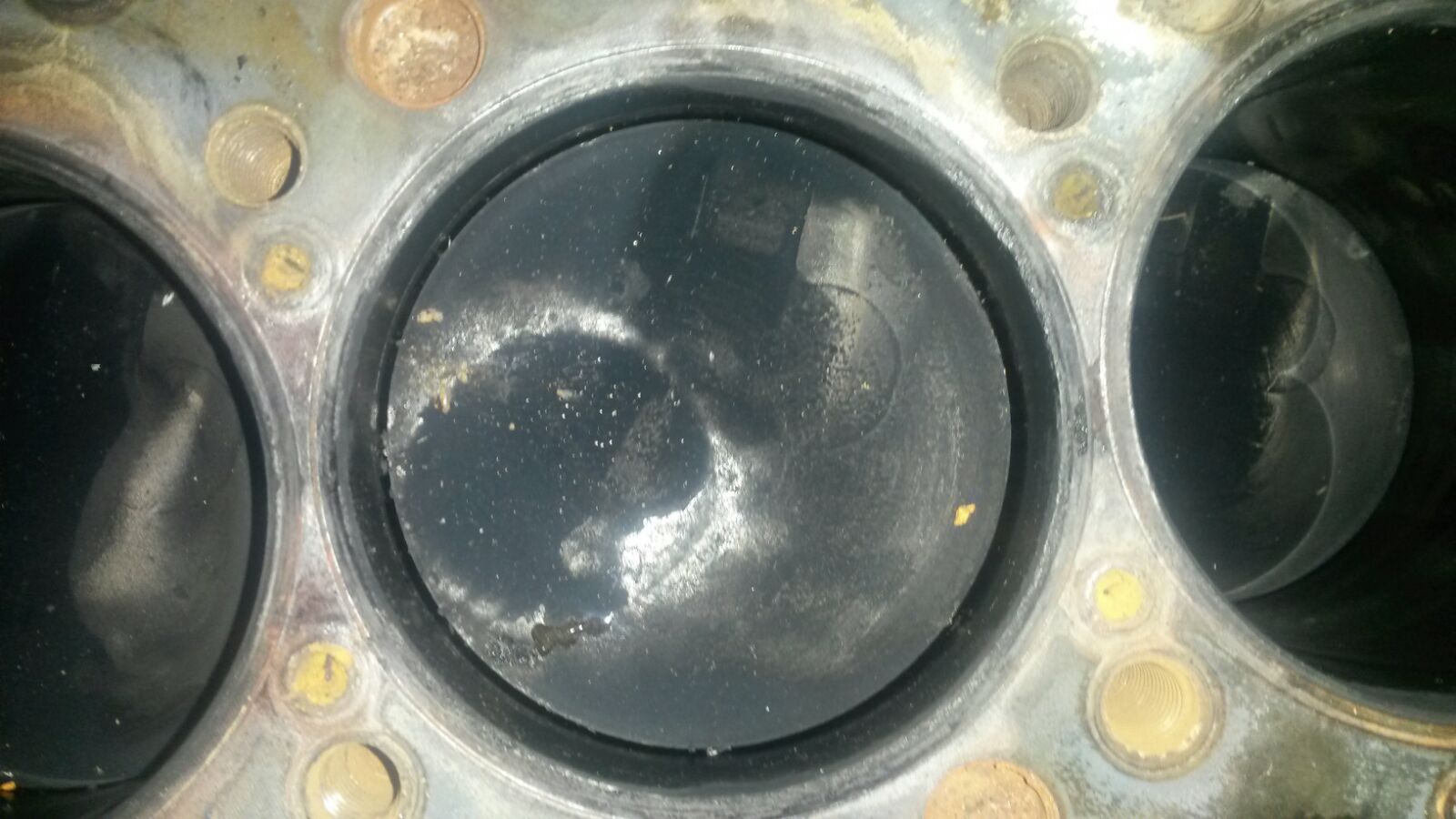

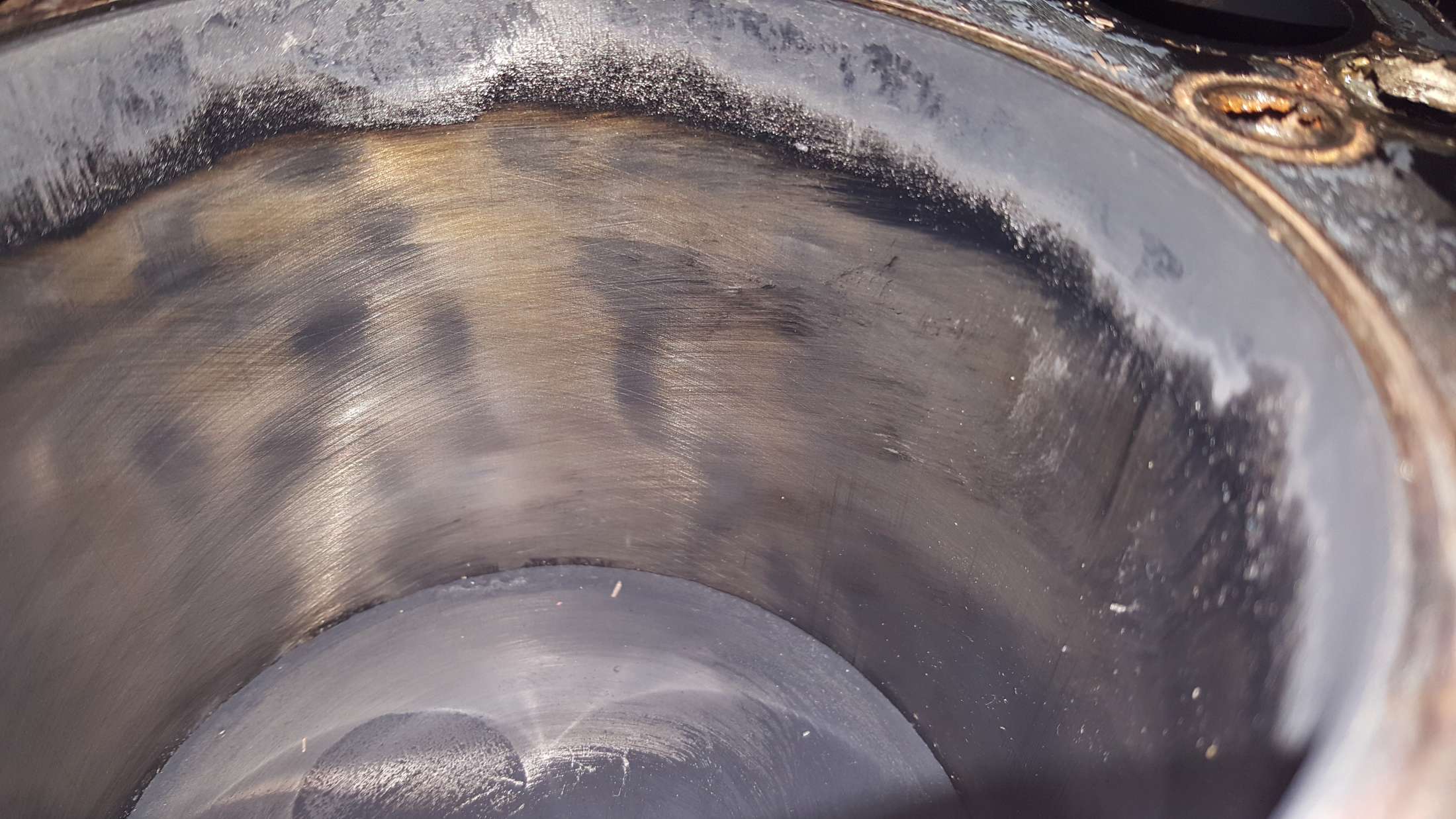

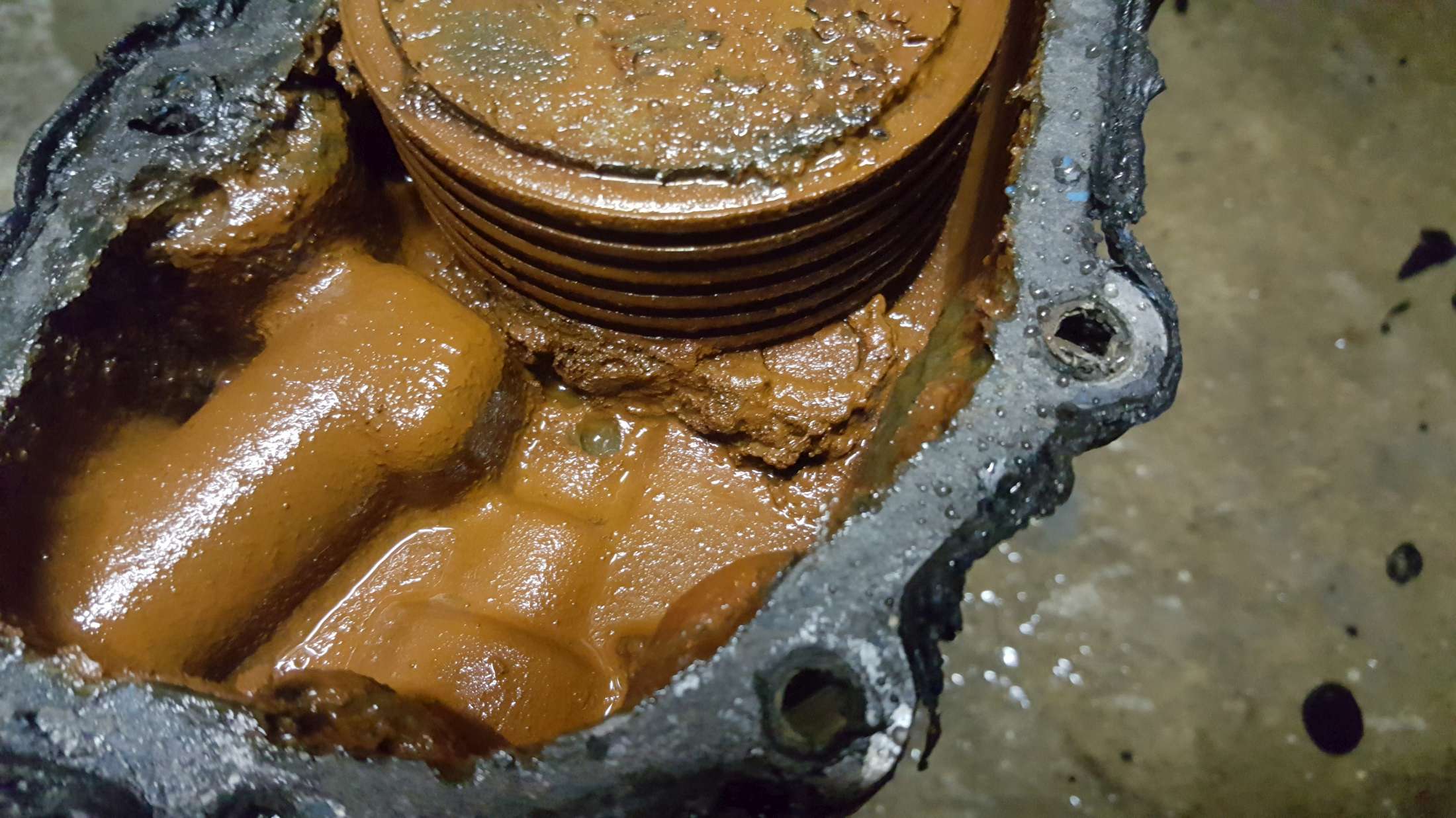

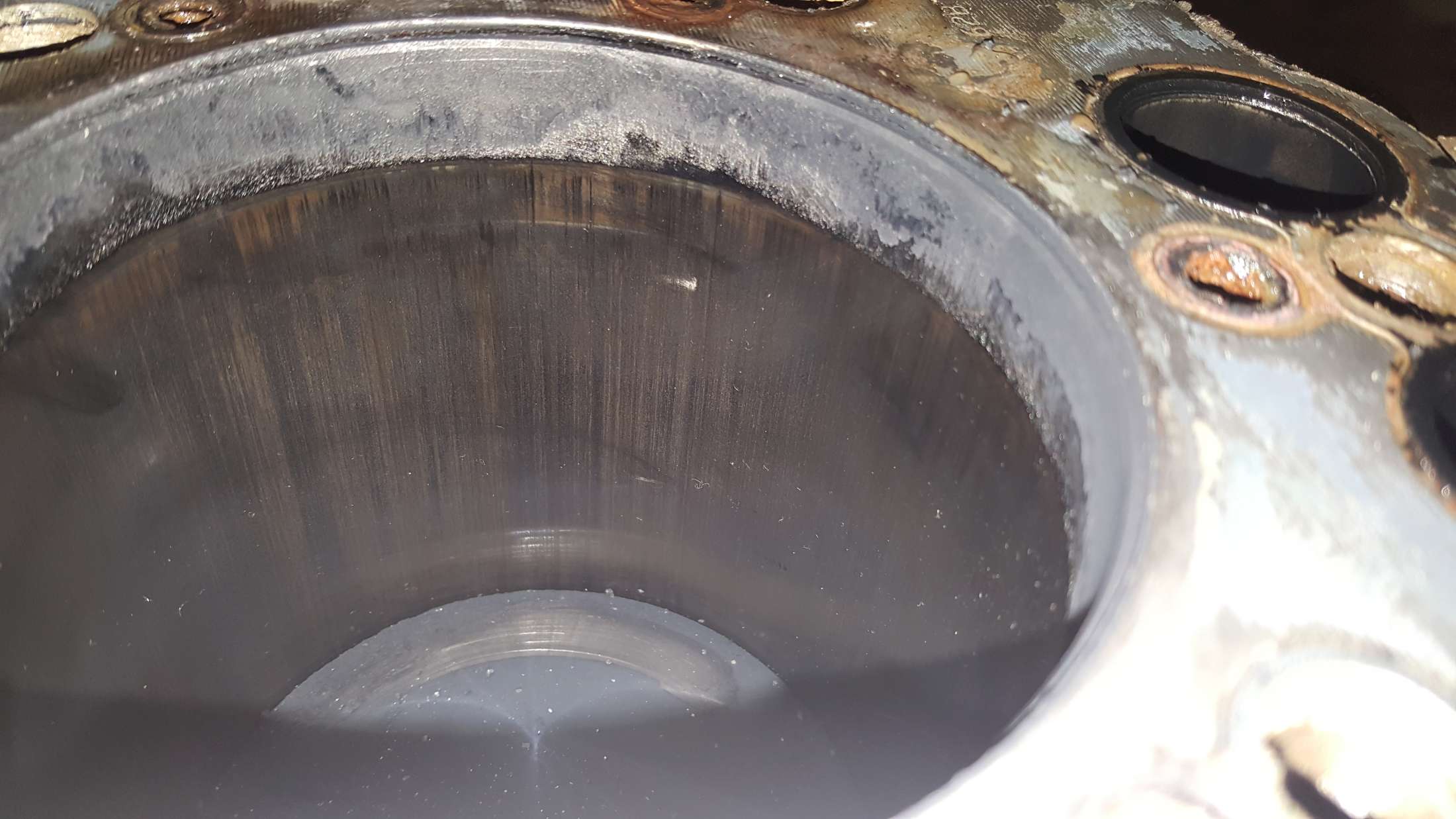

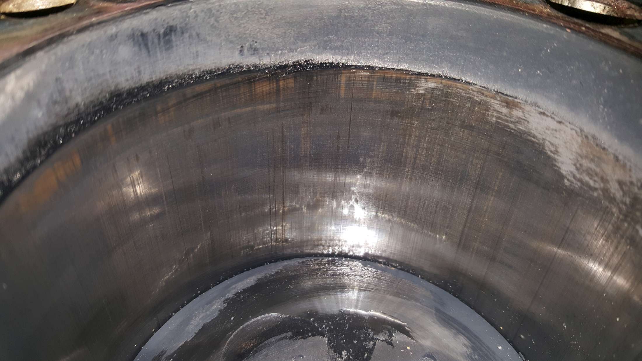

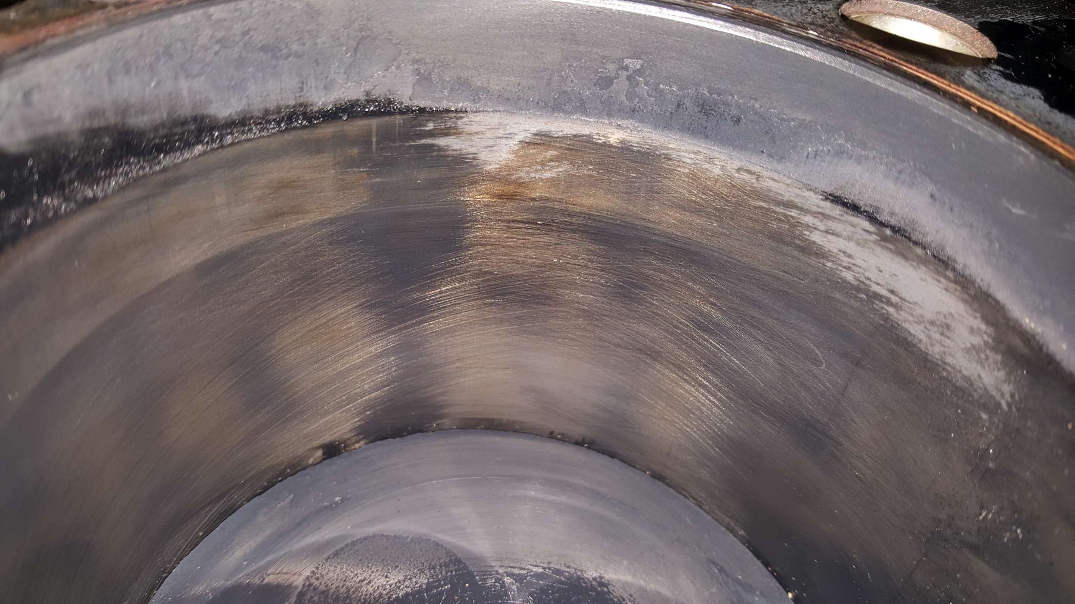

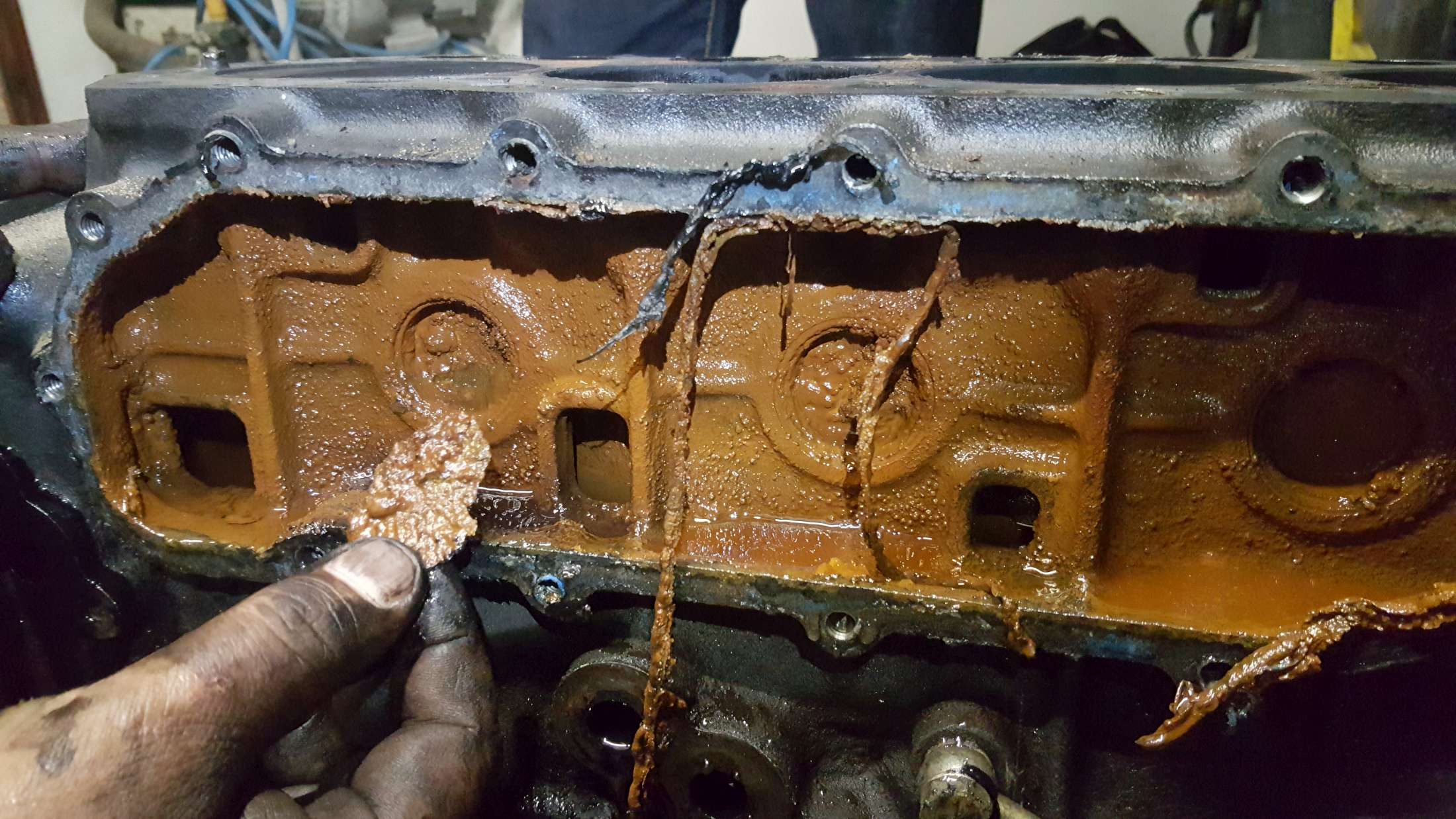

Ok so last night we managed to strip Tinus's 4.2D engine and the results were shocking.
Upon stripping we already found some major issues
1. Injectors were very loos, I loosened two with only my fingers.....didn't even use a socket or spanner.
2. Cylinder head bolts were also not torqued to spec, came loose very easy.
3. Pump timing was very very slow. I measured it 0.25mm @ TDC where it should be 0.76mm
4. The water channels on the head was very clogged and the water ports on the engine is in terrible condition.....some of the worst I have seen.
5. The sleeves has deep scores in them and this is due to heat seizure, the lead seal on the back of the cylinder head confirms overheating as it is completely melted away.
6. One strange thing I found was that the no.5 sleeve looks like it is a larger bore as the rest. It is so big that you could see the rings past the piston/bore clearance. All the pistons measure the same so it has to be the sleeve.
7. Pistons are also badly scored
Some photos to follow

Some photos of the engine
- Hard at work
- 20160121_191615-2200.jpg (215.21 KiB) Viewed 2828 times
- Piston_sleeve clearance.jpg (156.82 KiB) Viewed 2828 times
- Water2.jpg (249.88 KiB) Viewed 2828 times
- Water1.jpg (301.81 KiB) Viewed 2828 times
- Piston1.jpg (184.69 KiB) Viewed 2828 times
- Piston2.jpg (185.62 KiB) Viewed 2828 times
- Piston3.jpg (241.59 KiB) Viewed 2828 times
- Piston4.jpg (214.72 KiB) Viewed 2828 times
- Piston5.jpg (229.59 KiB) Viewed 2828 times
- Piston6.jpg (254.29 KiB) Viewed 2828 times
