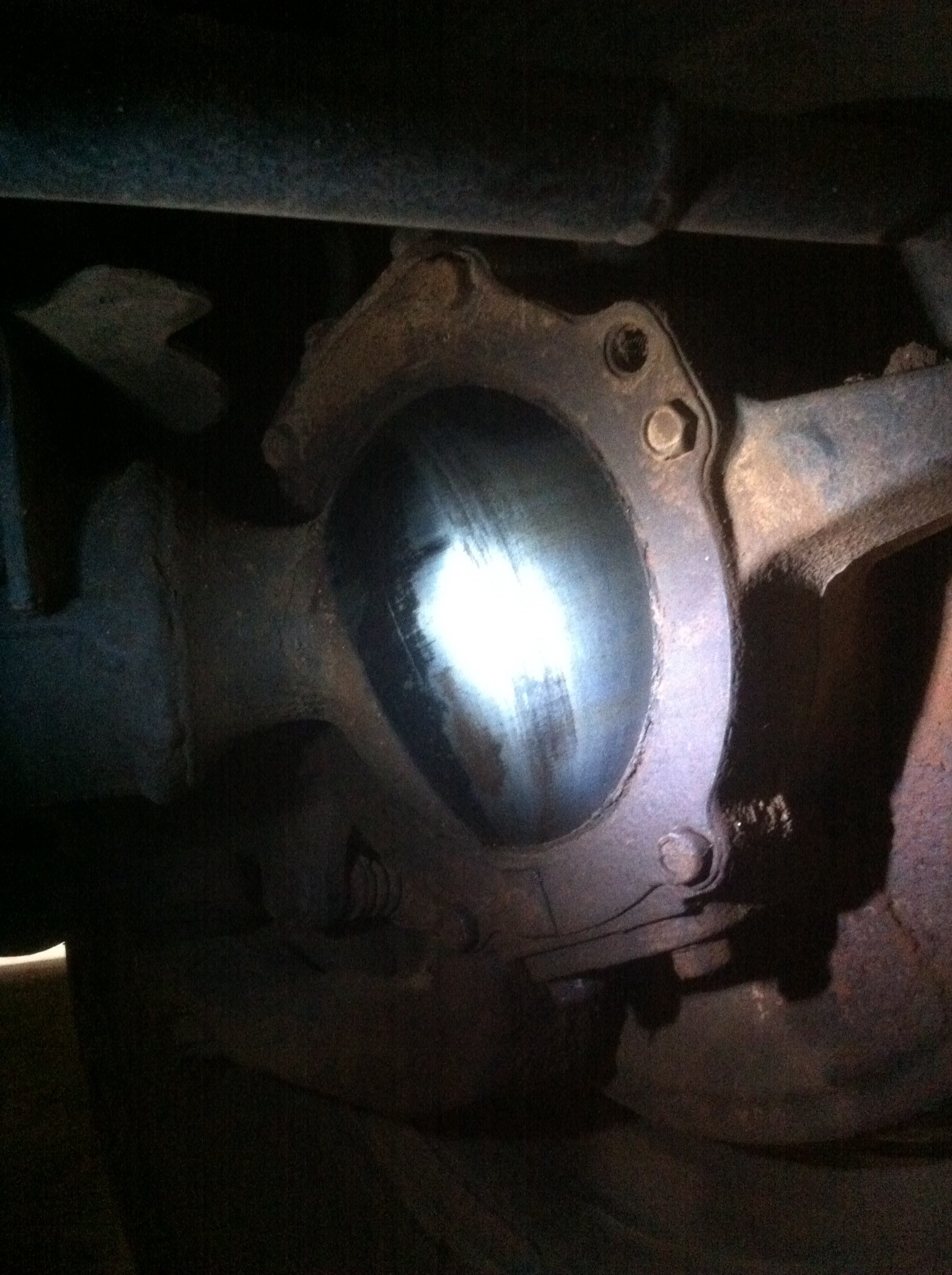

Found them, well one of them. The one side's nut assembly is m.i.a.Peter Connan wrote:While Russ waits for daylight to take pictures:
On the inside of each swivel hub, there is a circle of bolts holding the swivel hub wiper seals in place. One on each is a longer bolt with a rounded head and a jam nut. This is what you need to adjust. Unscrew a turn, hold with spanner while locking the nut, and try again.

- image.jpg (739.56 KiB) Viewed 3245 times

hahaha. Ja,.. i have heard of many that fall out over time. Take the one you have to a Fastener Shop (nut and bolt) , and get them to match you one, if they cheap by two and then you have two new ones. easy. Set it up how you like it and maybe put a tiny spot of locktight on them.
