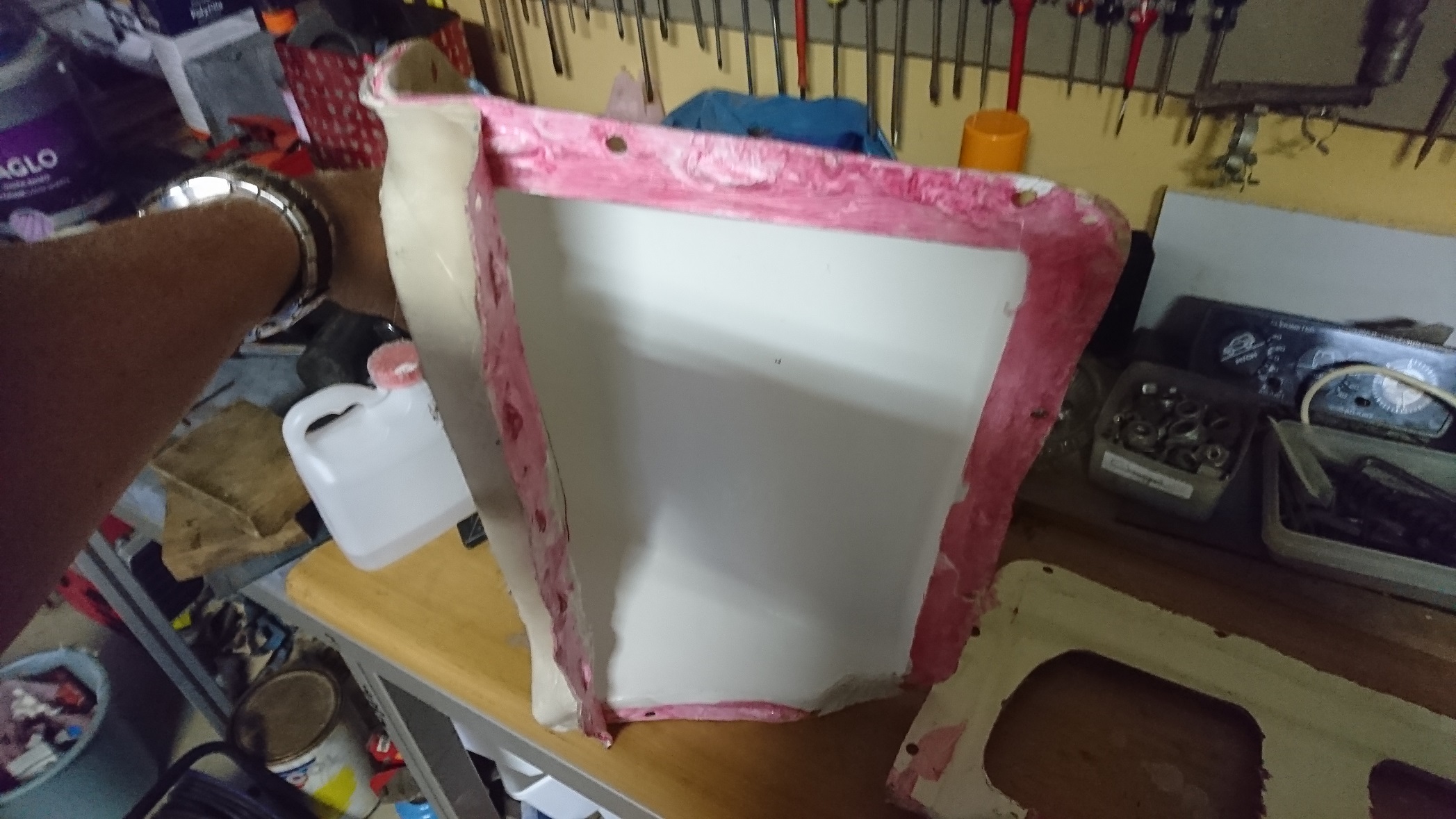

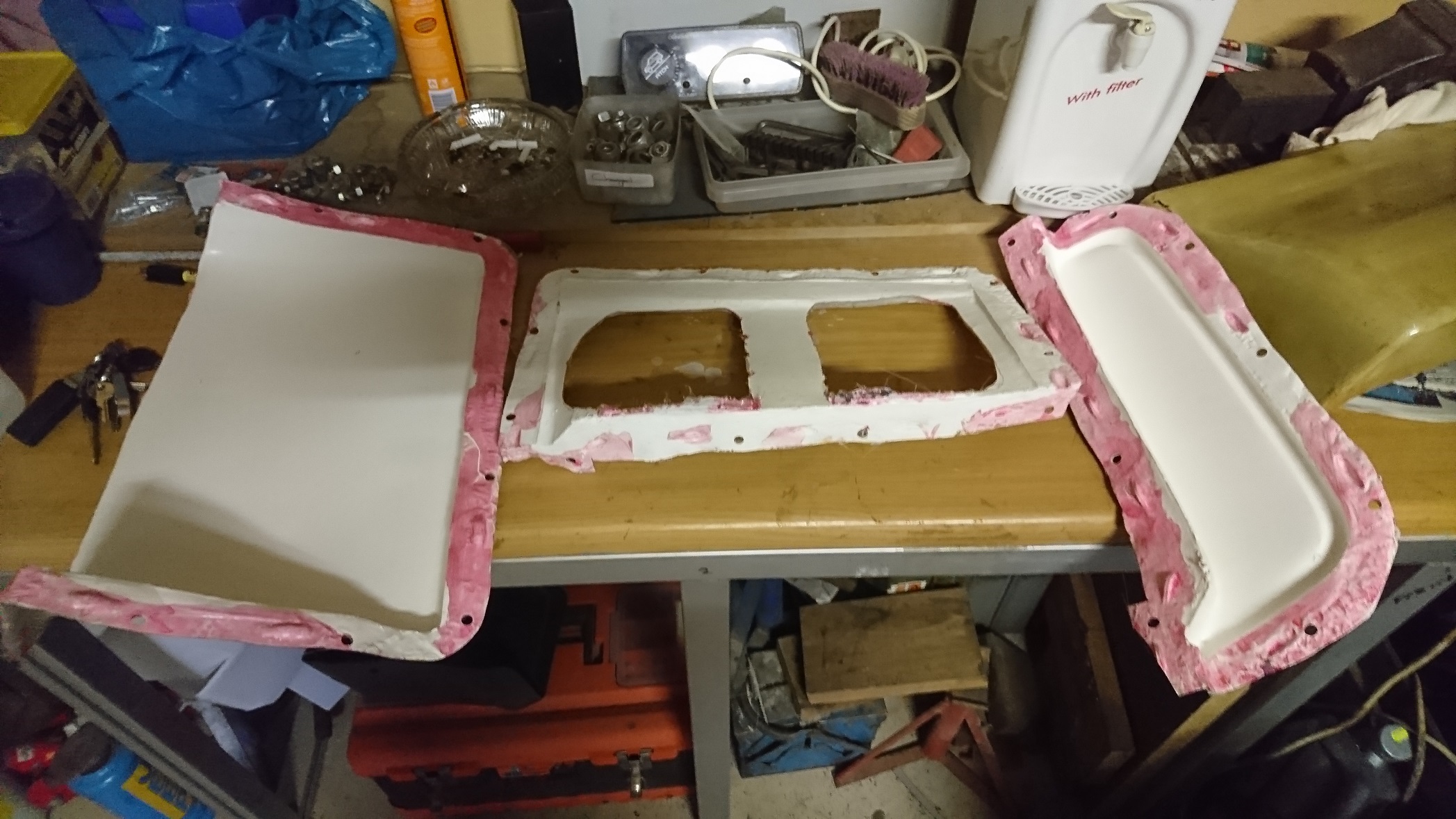

Well, well, well..... I believe after many many months.... ok ok, yes years .... I have completed my project !!!
I have built up a 3 part mold to make a dash console that can take either 5 round gauges, or EGT and 4 round gauges, or for that matter any configuration you wish to have. One can even fix your GPS up against it to keep it out of the direct sun, which will definitively help preserve the battery lifespan of the unit.
I am really chuffed at the way it came out. I have had it upholstered with thin sponge in between, but in a light grey to match the door and centre console grey. This was due to me telling the upholsterer that even though I have taken 2 years to do this, he only has one day.....haha ( I'm a kind sole )..... I will hopefully get a colour as near as dammit is to swearing to the colour of the dash.

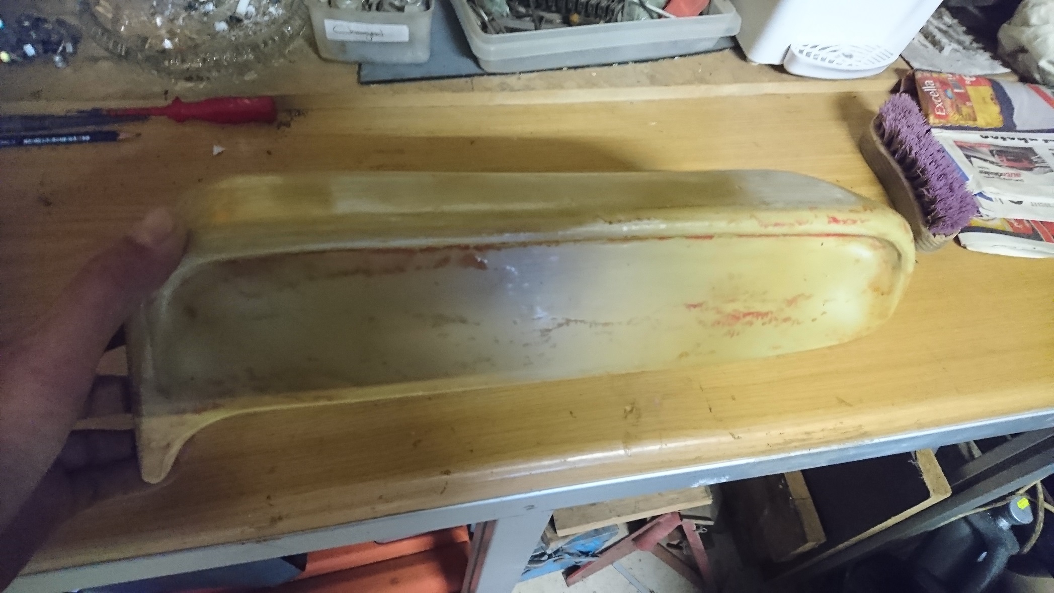

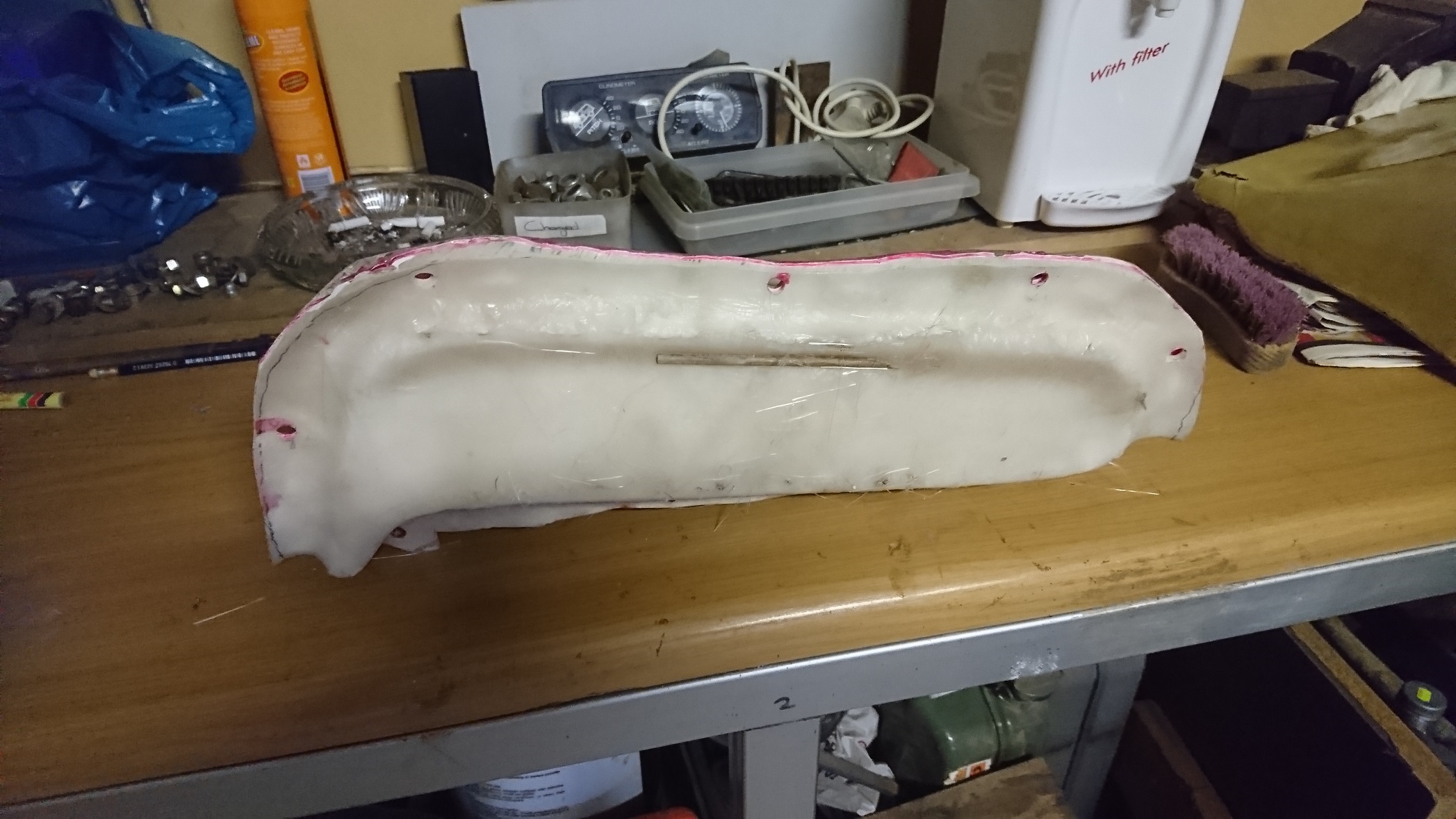

Ok.... so here is a little background on how this project evolved...

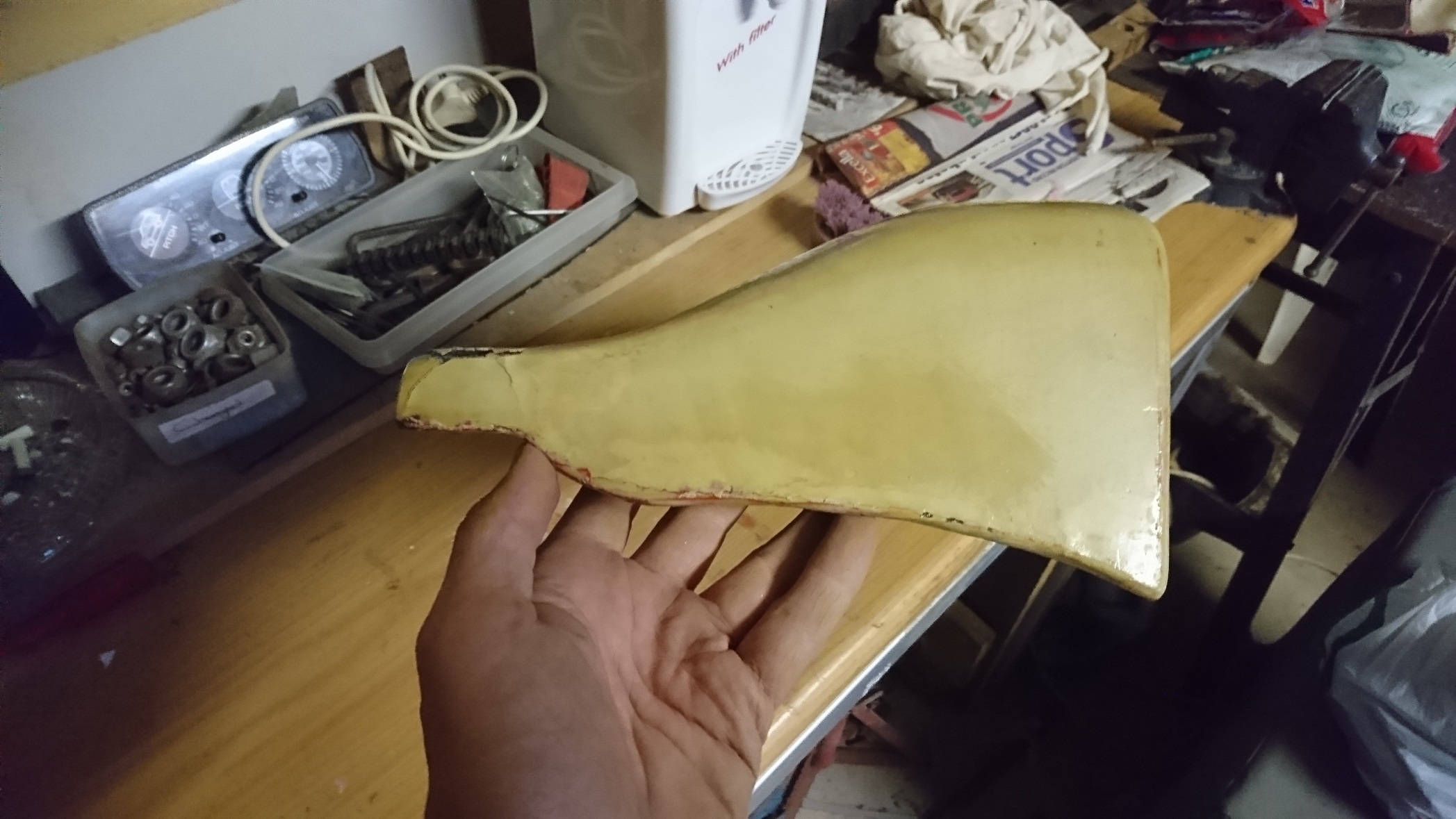

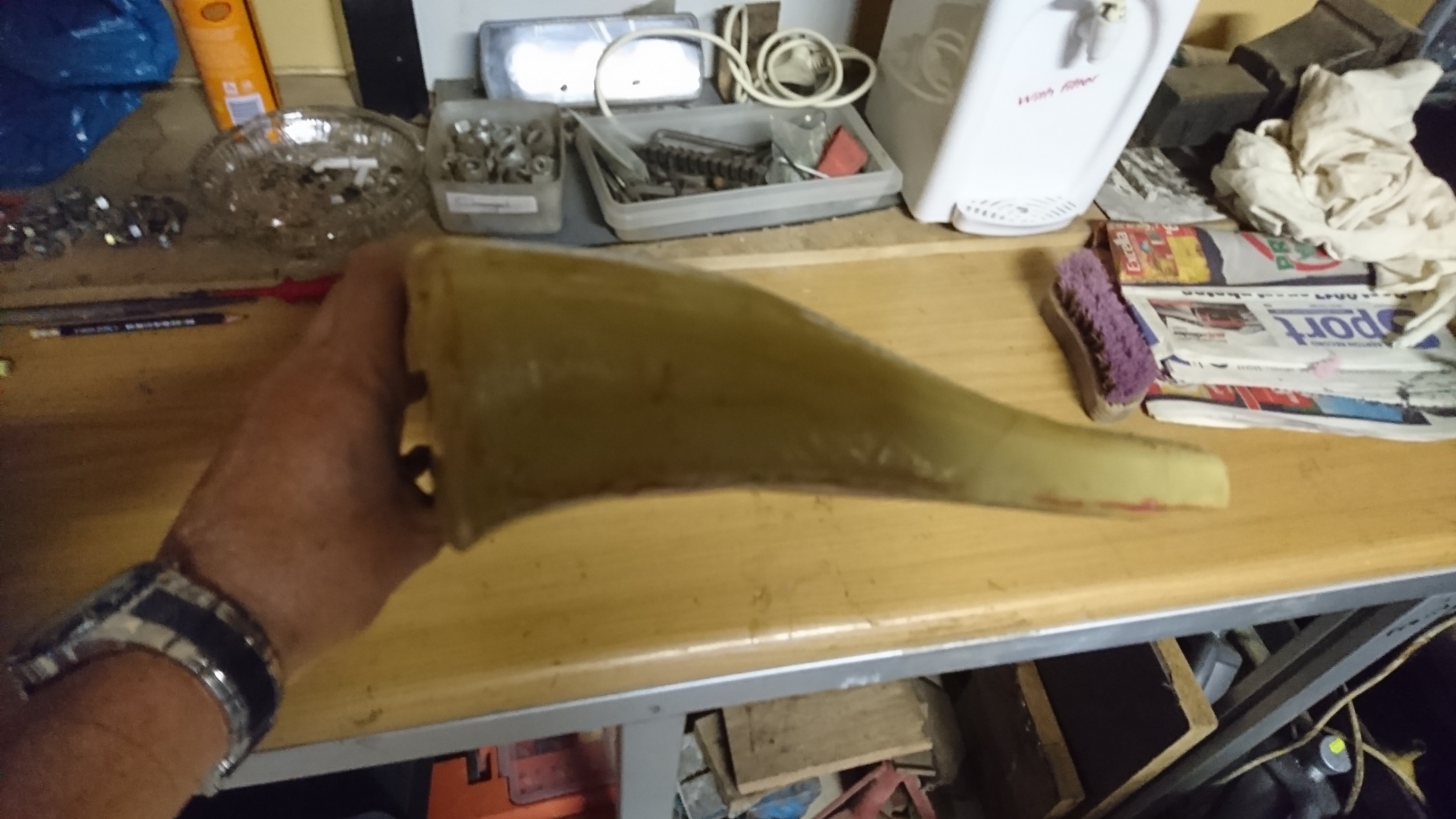

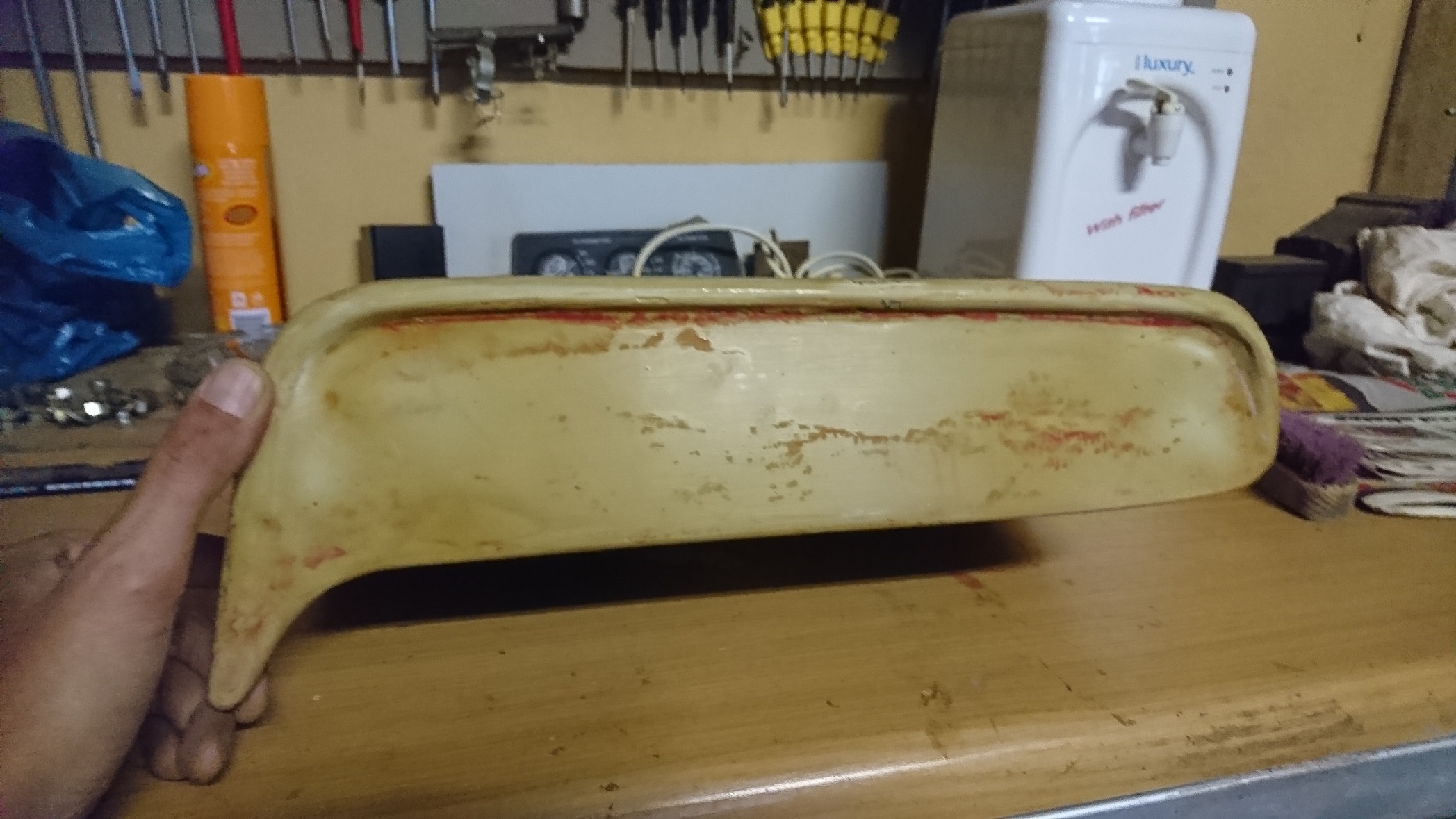

Now the plug I finally landed up with. I used body filler and loads of sand paper and loads of elbow grease to get the contours of this piece to where I was happy. there is not one single flat surface on the GU dash so I wanted to keep with the theme and flow of the GU dash with this pod. The Aussies have a dash pod for $ 330.00 ( R3200.00 ), that is very square looking and just doesn't do it for me.....
http://www.consoles.com.au/Nissan_PatrolGU_pods.htm Here is a few pics of the plug ( this was taken after I had already made the 3 part mold, so it was looking a little rough where I had to tug it out of the fibreglass parts. ( its not an easy job by any means ) From this plug I had a good few attempts at making a proper mold to make the final product.... this process took many many swear words, and a few Klippies Premiums to calm down again before I landed up with this .... The 3 part mold. Bear in mind you have to, in ones brain work inside out, because one must ensure that one can get inside the 3 part mold to lay the fibreglass properly without any bubbles and blemishes, and I don't exactly have small hands, and anyone who has ever worked with resin before will know.... Its a sticky goooooooey PITA medium to work with. But anyway there are the pics. ( the pink stuff you can see is the PVA release agent still to be cleaned off )
