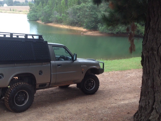

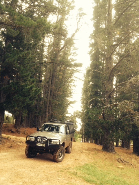

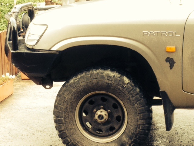

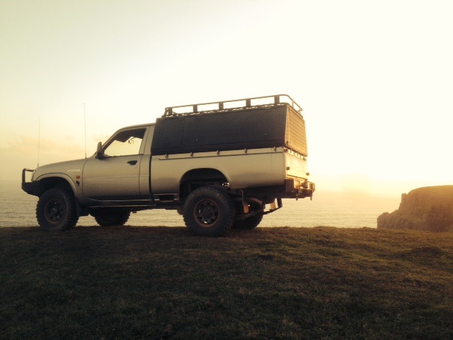

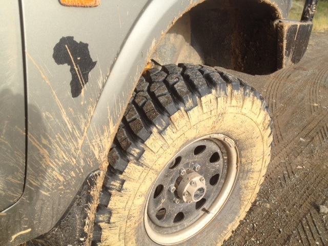

285's on my pickup running stock Patrol Pickup Heavy duty steel rims (they are very strong/heavy rims) 16" and 6.5j with (0) Offset.

I would never have thought, looking at these pics, that those are 285/75's, they dont look that wide at all... Suppose the 255's would look even thinner then. That size does look good on the patrol. Where can i get the best prices on bfg's?Russ Kellermann wrote:285's on my pickup running stock Patrol Pickup Heavy duty steel rims (they are very strong/heavy rims) 16" and 6.5j with (0) Offset.
I thought that the standard patrol rims had a negative offset.
