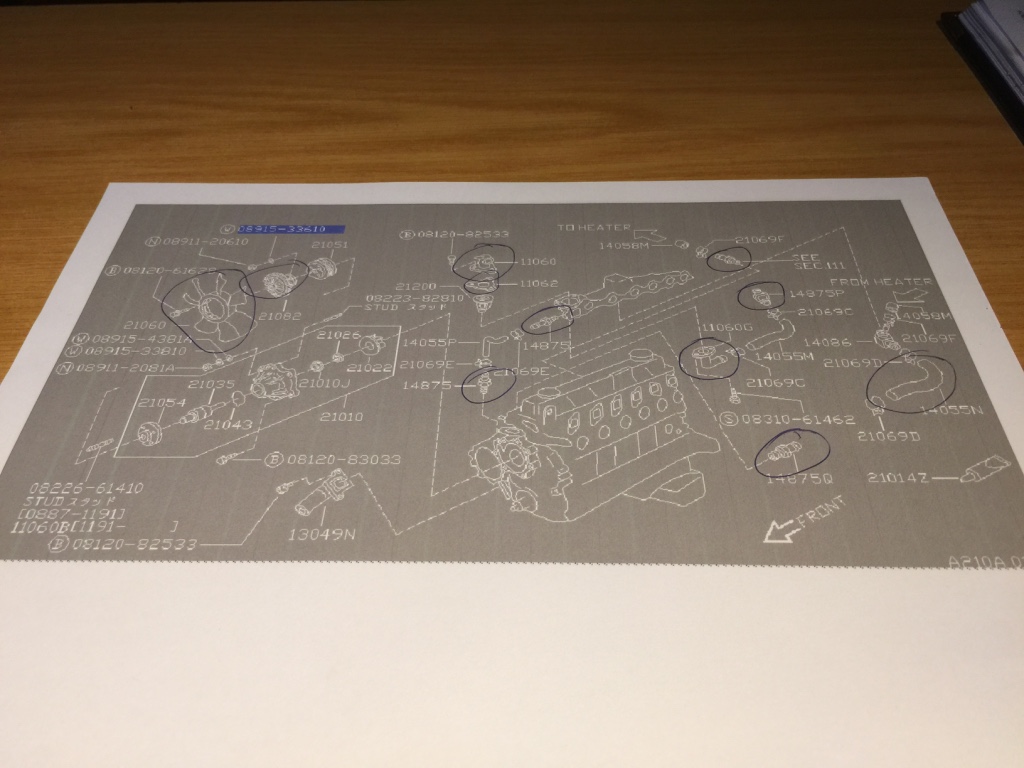

Below is a schematic summary of most items replaced, besides the head gasket and the work on the head itself.
As well as many pipes and fittings (which were leaking), and not shown on this picture.

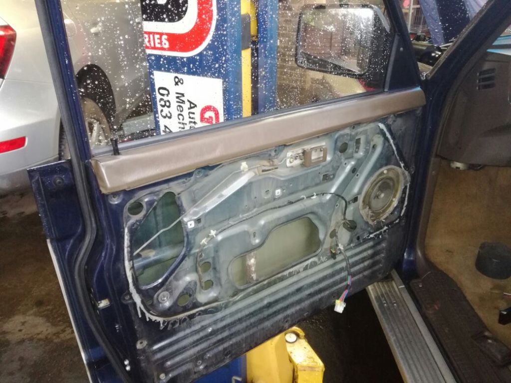

2) The passenger door electric window did not work anymore. I checked the fuses before and all seemed okay. Only when Graham opened up the door panel did we realise there was no electric motor anymore!! See picture below. Got one fro Dawid.

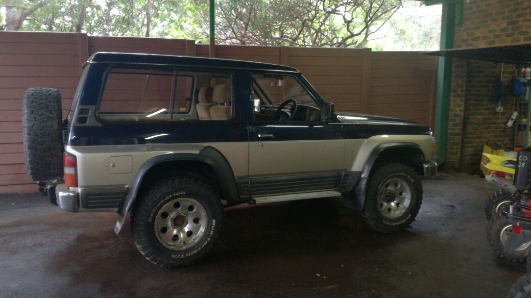

Suspension was next:
The original coils and shocks from 1993 were still in, and they were beyond kaput.
See below.
Since the plan with this car is not to go extreme off road, but rather to have a fun "Kerk & Werk" car, I am not too ambitious with the suspension. Also after all invested in the car, going overboard on suspension is really not a priority.
I had a pair of TJMs for the rear already.
Graham fitted some second hand 20mm lifting shocks in the rear, and 4.8 coils in front (with 20mm spacers to get it in line with the rear.), and decent (newish) shocks for the front.
Before: After:
