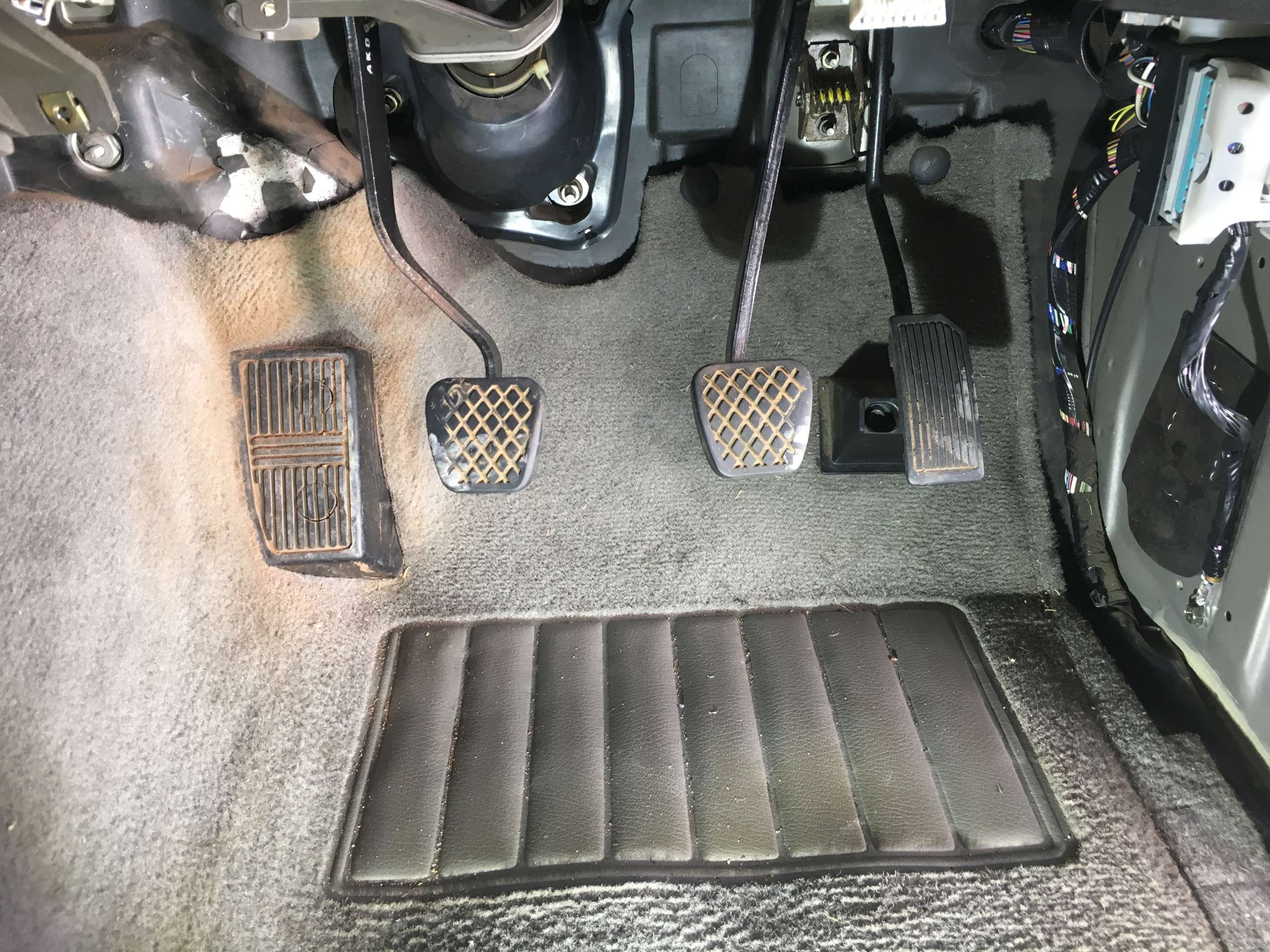

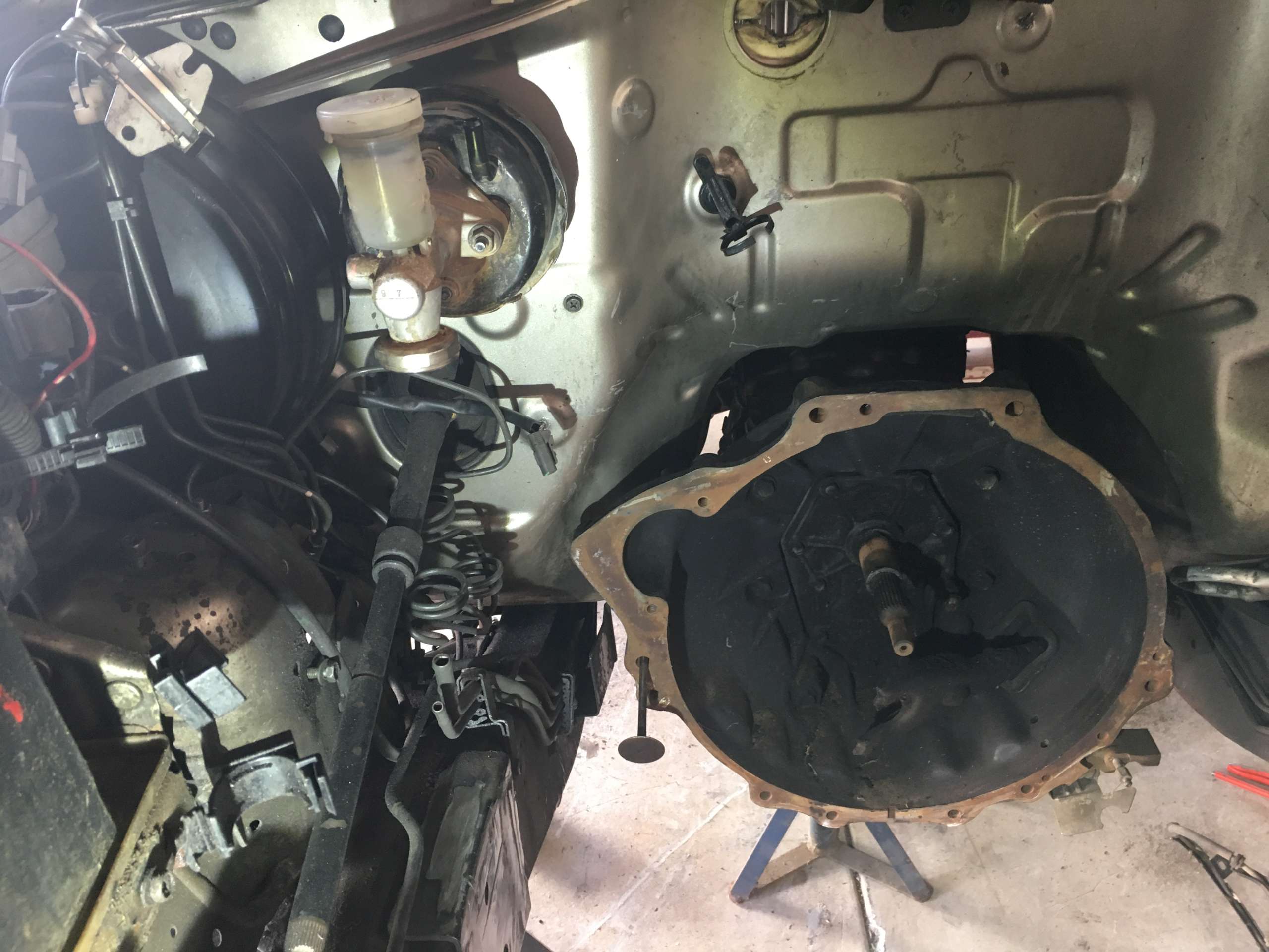

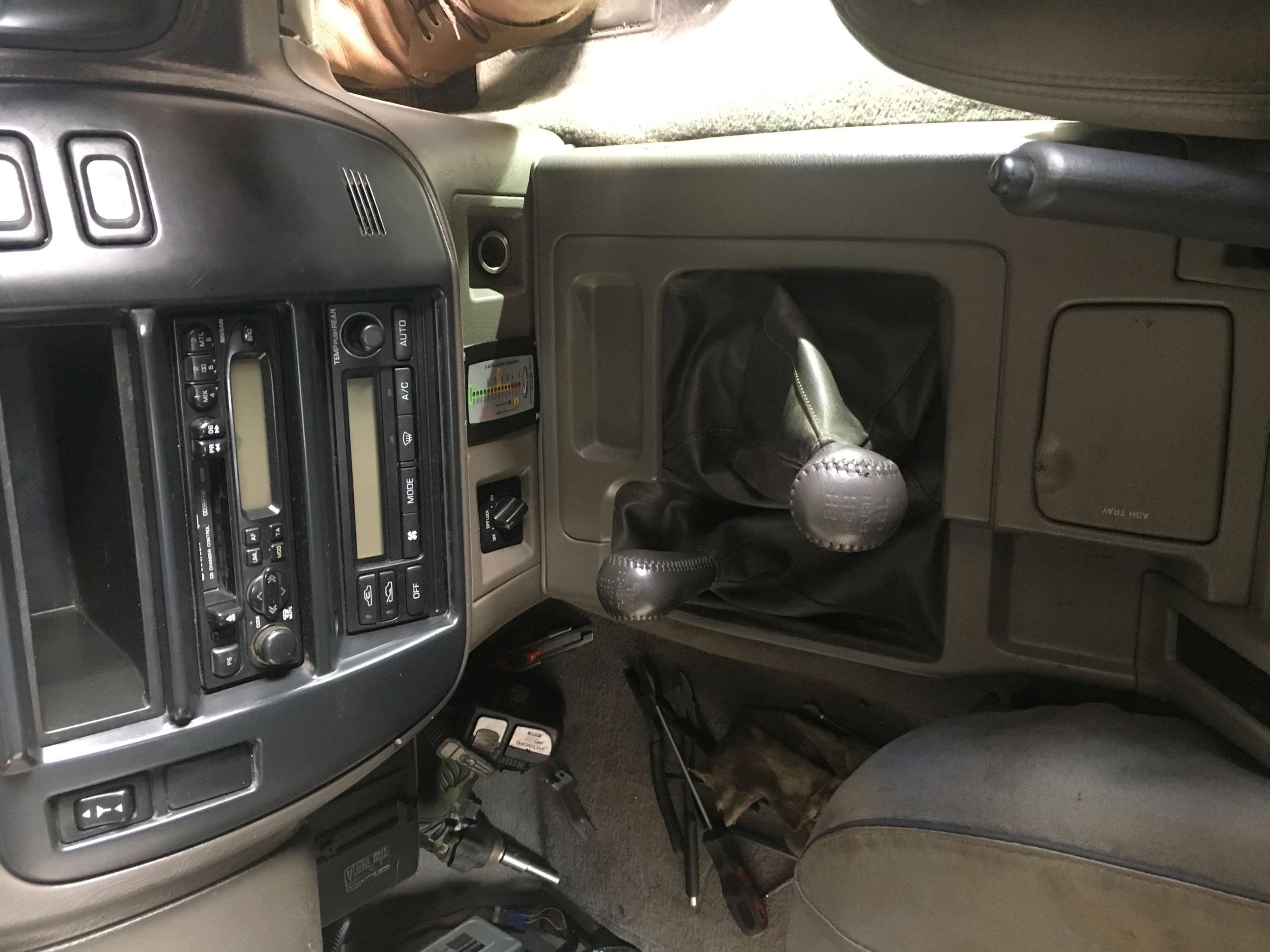

Nog so paar stappe vorentoe vandag
Ratkas met al sy rat hefbome en binne covers opgesit
Ook die koppelaar petrol en rem pedale godoen
Gaan lekker slaap vanaand en alles is dood standard ombouing van aotumaties na handrat

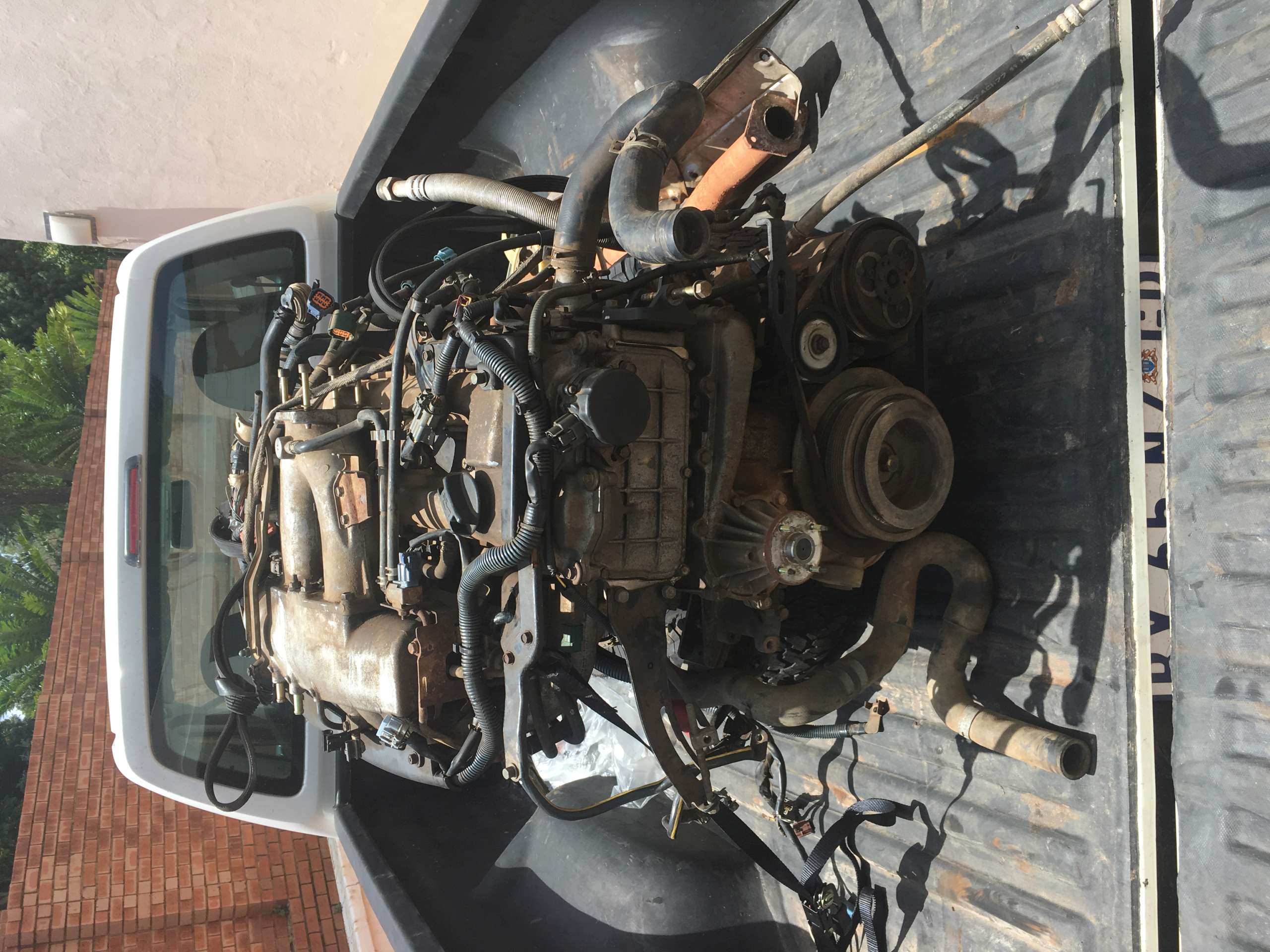

Vanaand gaan ek die enjin sommer op die grond crank om seker te maak al die kompressies mooi is ..en dan is dit ek die agterste ewenaar...
die se vacuum booster wat die "difflock" beheer was ook stukkend...ek kan vir julle fotos neem en post as daar van julle is wat sal belang stel :thumbup:

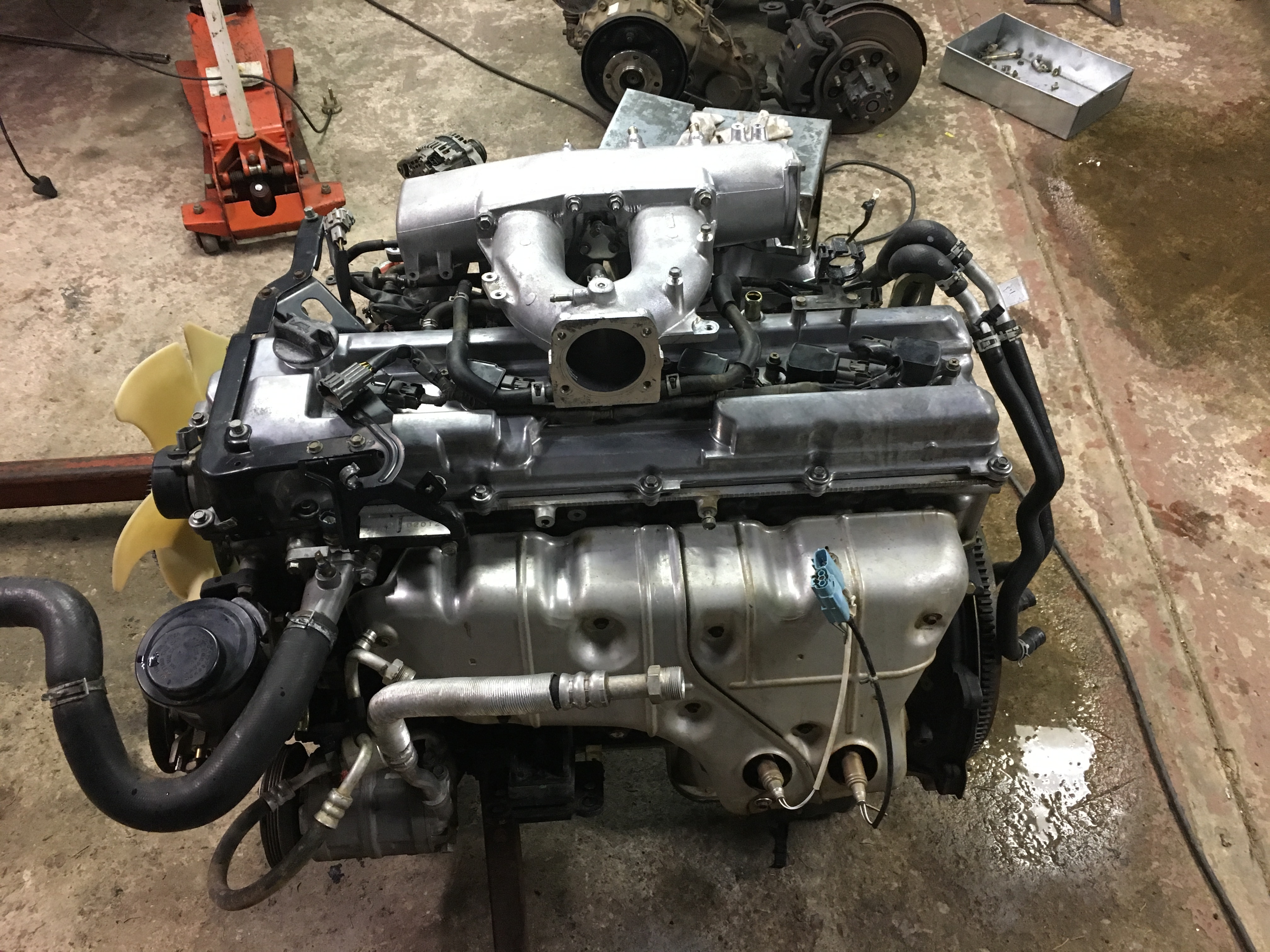

Just an update on "Cheapy"
Labour wise its no cheapy.....but for the enjoyment afterwards.... :thumbup: :thumbup: :thumbup:
So all the diffs is fitted and aircon pipes and brackets etc is sorted
Engine is hanging on hoist and ready to install

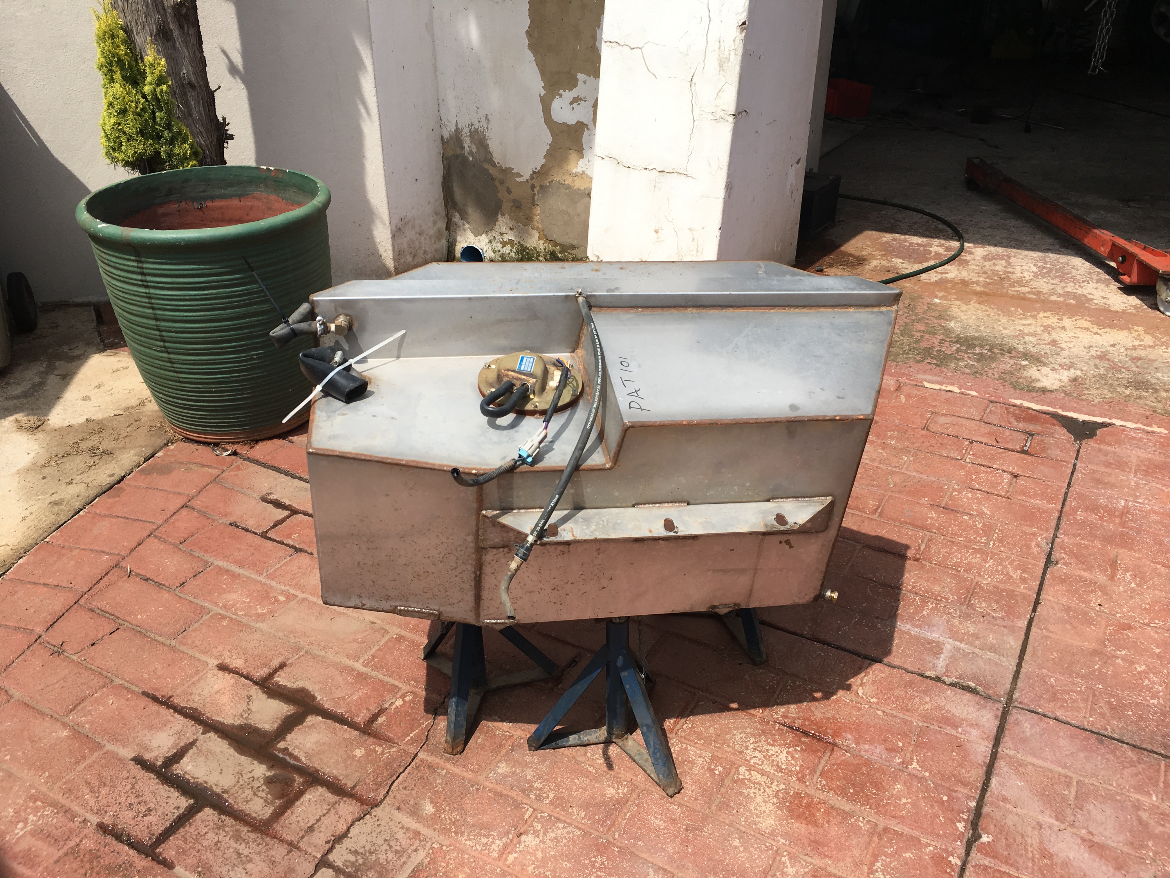

And I managed to get this long range tank in a scrape yard yesterday.... :clap: :clap:
Posts: 3364
Has thanked: 247 times
Re: Cheap handgranade ja of nee
Hoe groot is daai tenk?
