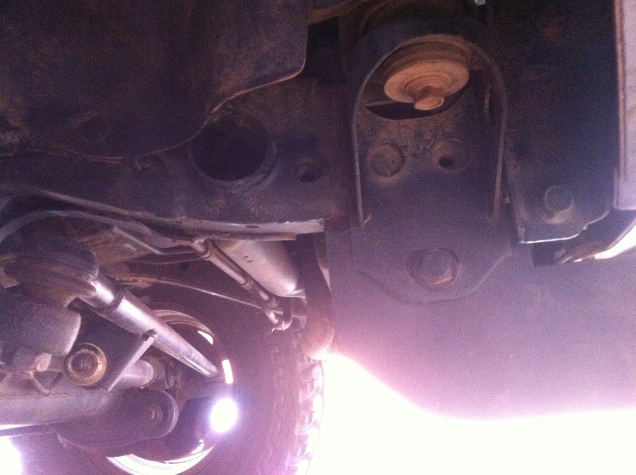

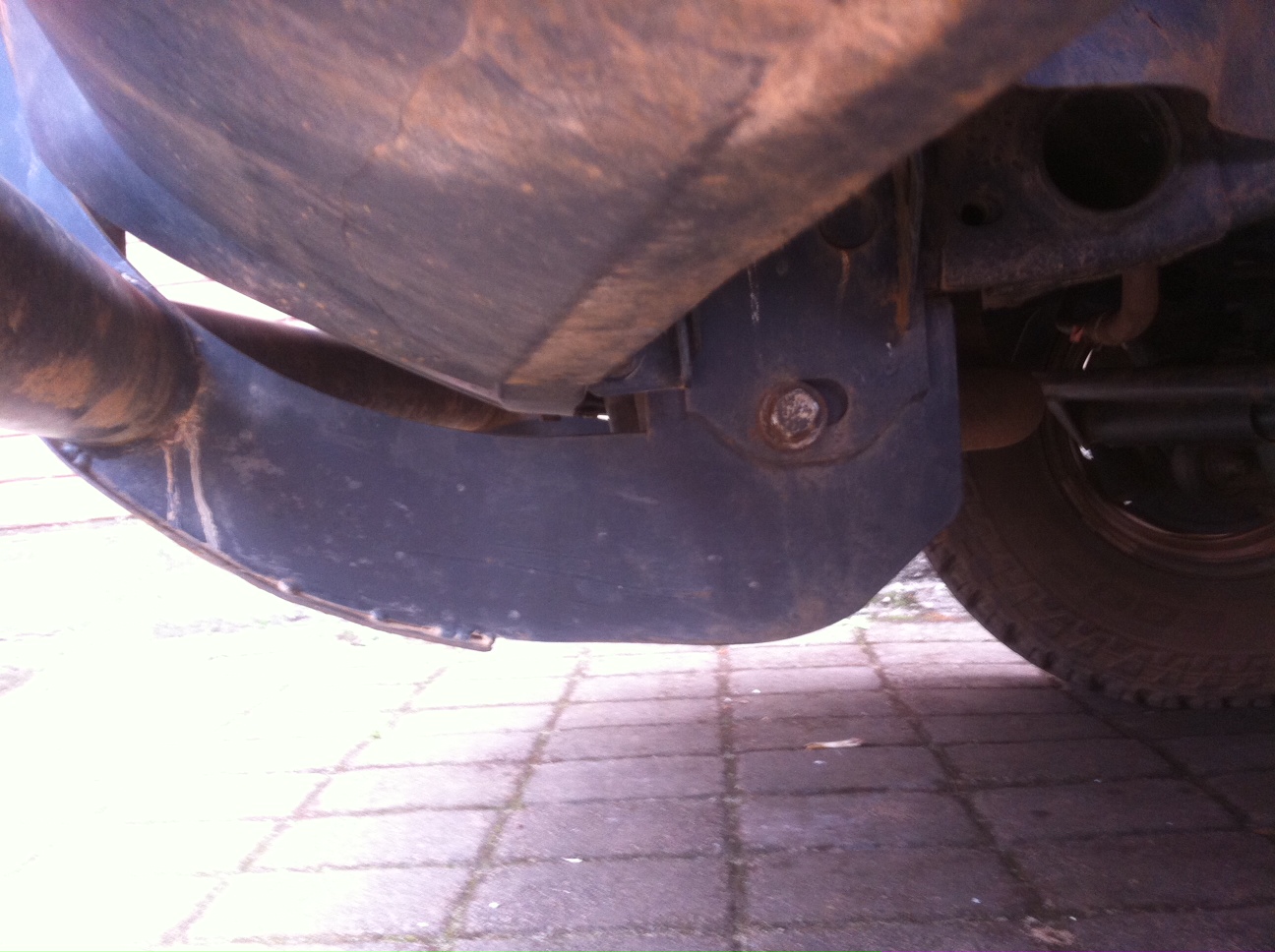

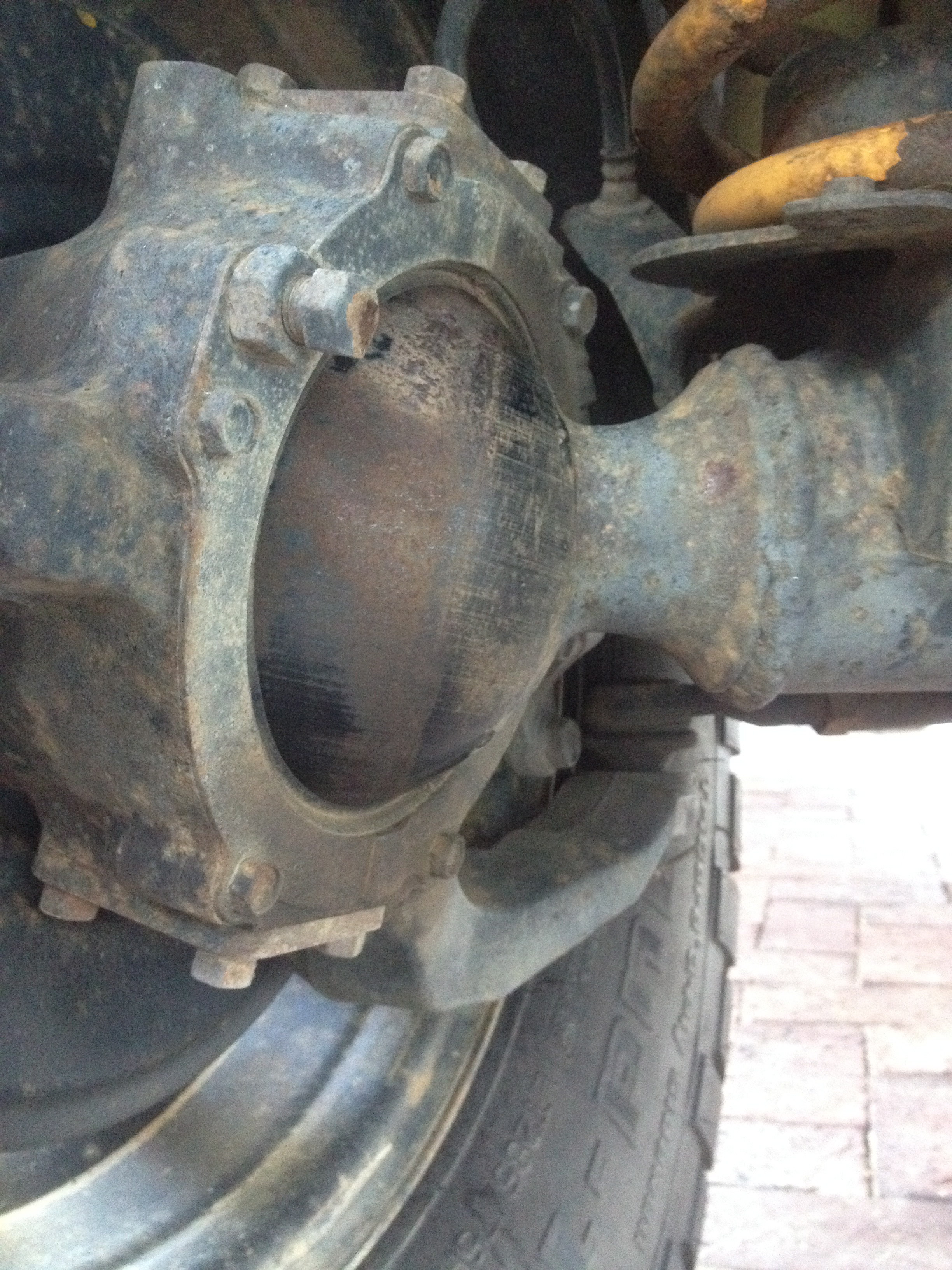

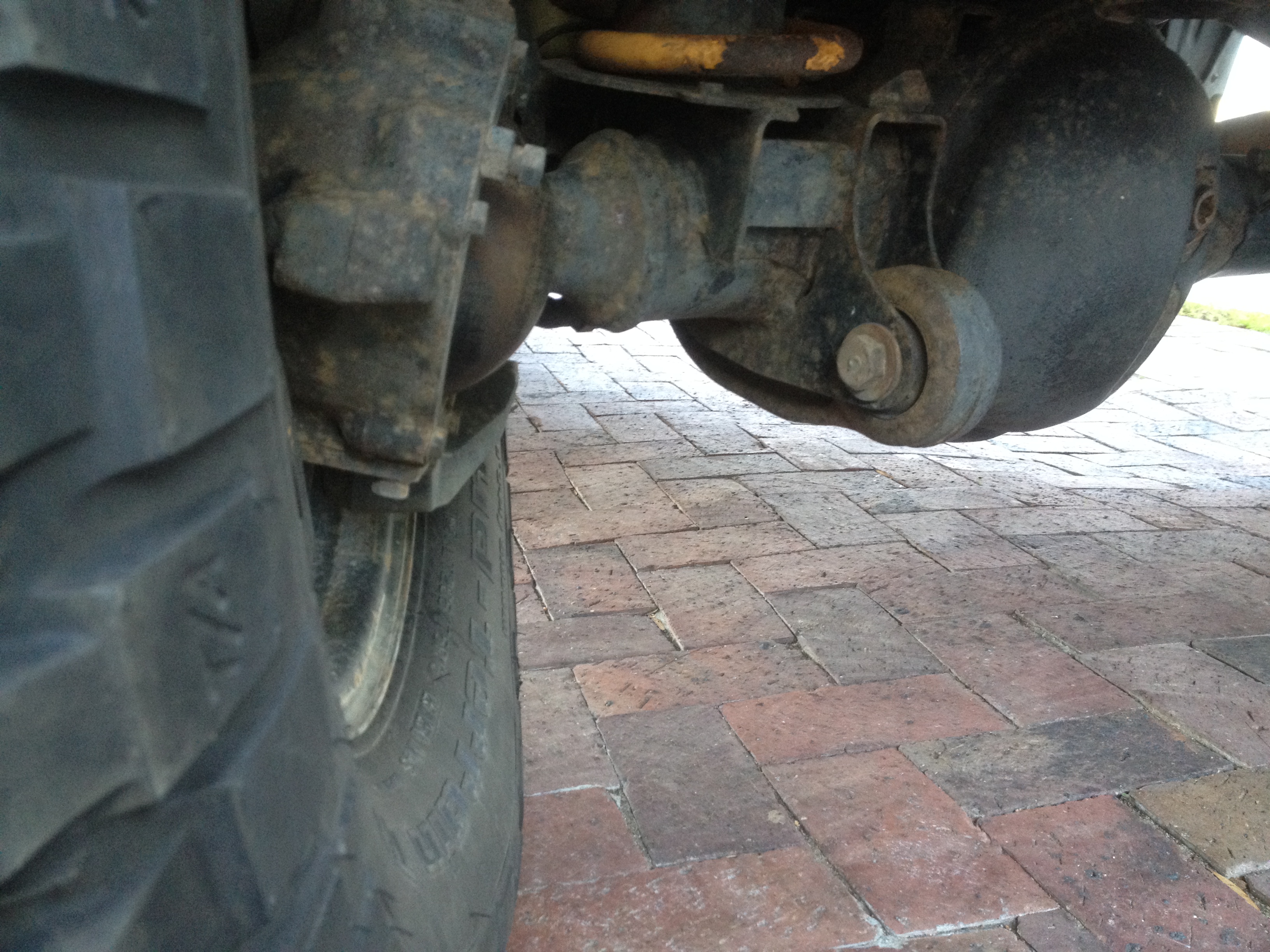

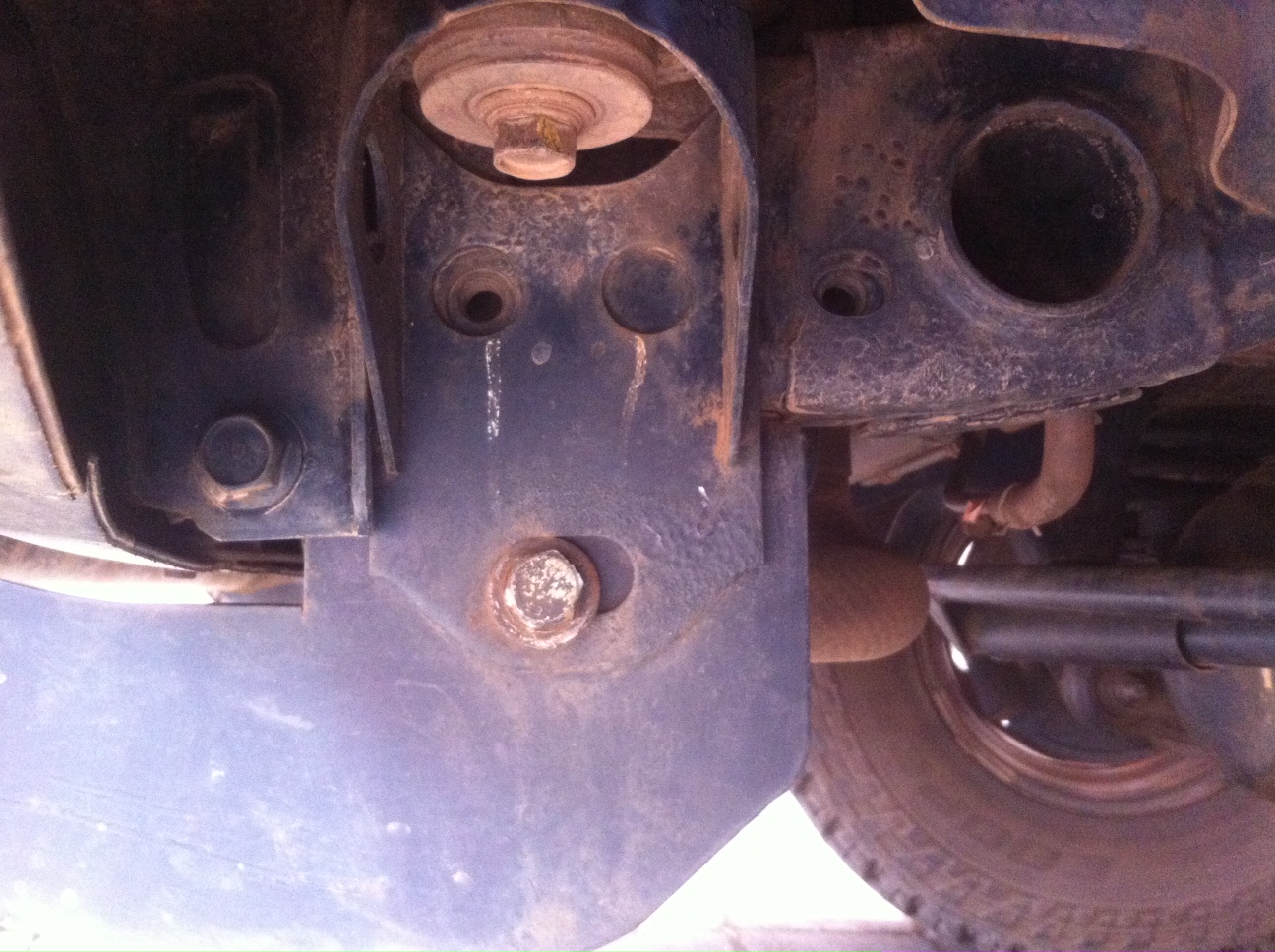

The lack of front recovery points on my pickup bother me a bit (with the possibility of going on the river trip in mind :thumbup: ).
How would it be possible to fit recovery points on my vehicle, without removing the bullbar?
Can anyone advise me on this, or post a close-up pic of the standard recovery hook fitment?
photo 1.JPG (460.03 KiB) Viewed 7346 times
photo 4.JPG (369.9 KiB) Viewed 7346 times
photo 3.JPG (520.11 KiB) Viewed 7346 times
Re: My Patrol Pickup thread...
Die gate vir recovery point is aan die onderkant of binnekant neem nog fotos dis m14 x 2 8.8 hardheid boude as dit n 3l chessie is dit 3 boude ....kyk wat pas en koop net een by nissan die 4.8 kos 500 by nissan :salute:

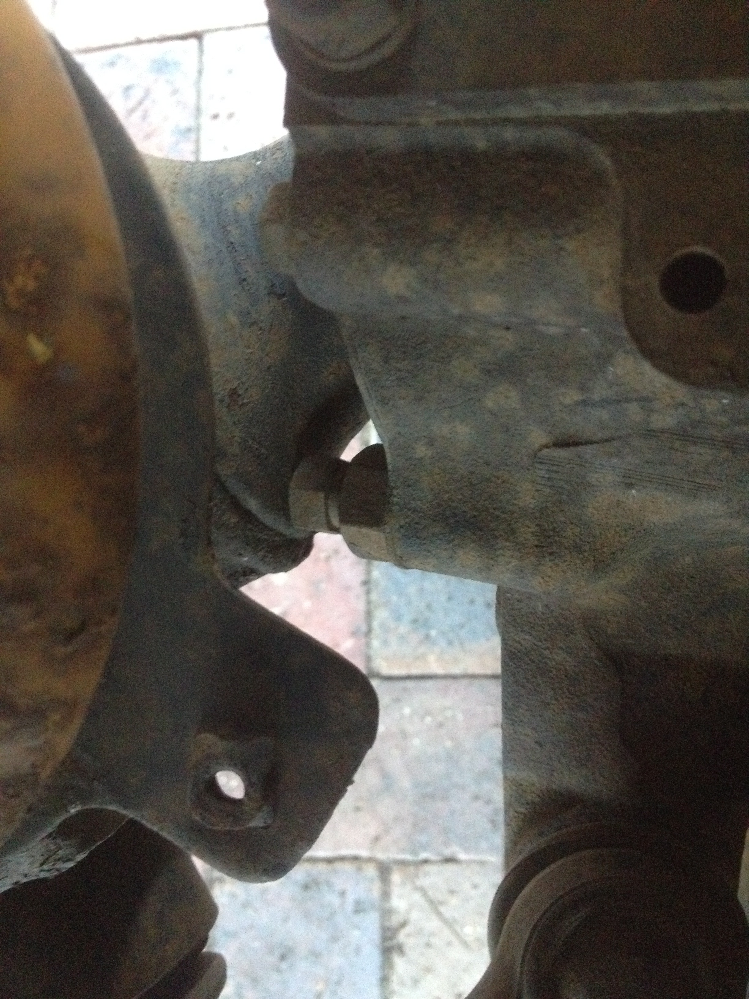

Hey bud,..I'll take a pic of the limiter nut assembly and post it here... if it was a snake it would have bitten you. hahaha.

While Russ waits for daylight to take pictures:
On the inside of each swivel hub, there is a circle of bolts holding the swivel hub wiper seals in place. One on each is a longer bolt with a rounded head and a jam nut. This is what you need to adjust. Unscrew a turn, hold with spanner while locking the nut, and try again.

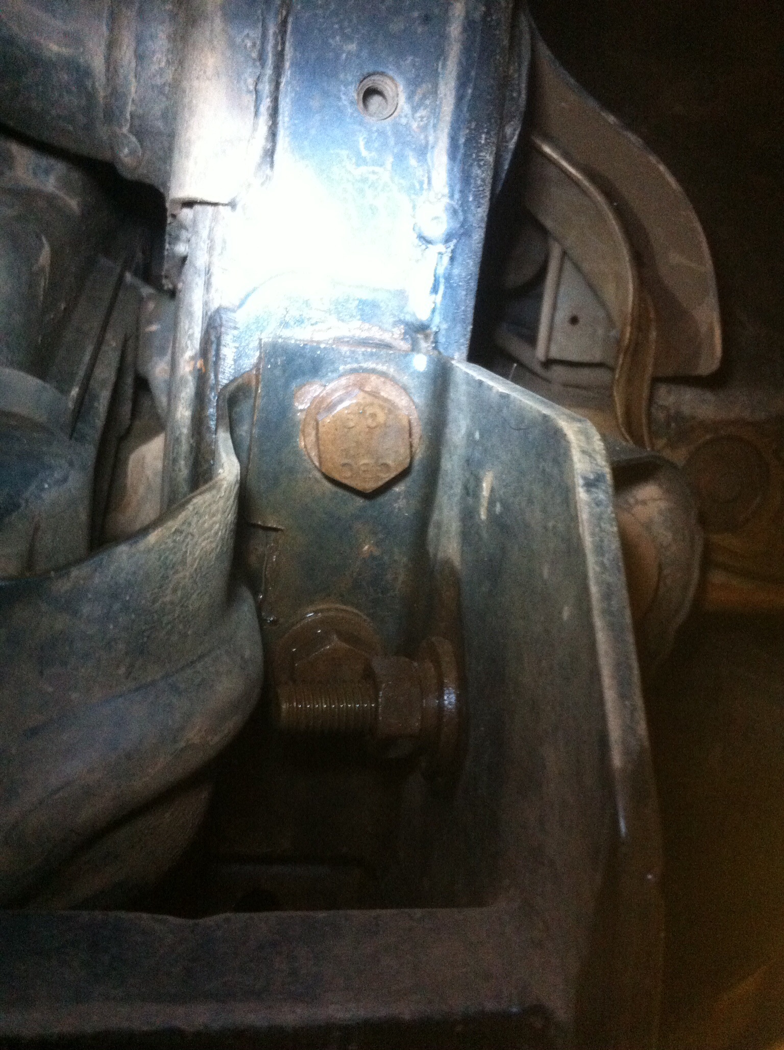

Its the Protruding nut visible in the pics. In the top view you will see the nut making contact with the axle tube, this limits the "Turning Circle" in essence, by limiting the extremes in regard to wheel axis.
Top View -  Front Left Side
Front View - Front Right
Tinus lotz wrote:Die gate vir recovery point is aan die onderkant of binnekant neem nog fotos dis m14 x 2 8.8 hardheid boude as dit n 3l chessie is dit 3 boude ....kyk wat pas en koop net een by nissan die 4.8 kos 500 by nissan :salute:
Hier is n foto van myne, dit lyk nie of daar veel plek is vir n recovery hook nie. (Bulbar is bietjie in die pad?)
