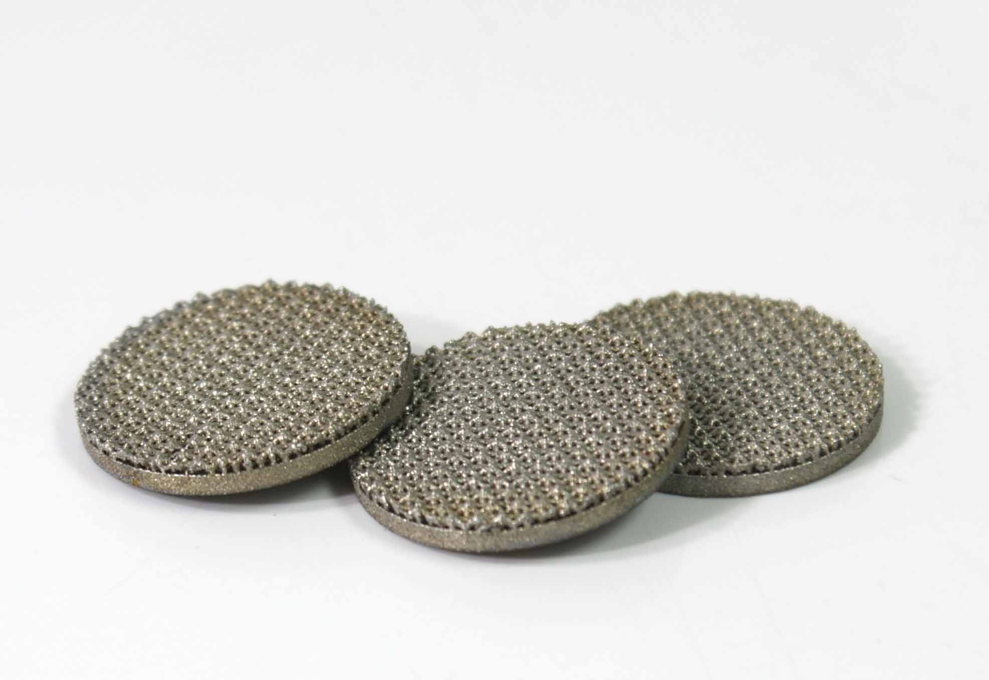

Hi Clem
The strongest material we have is the Titanium:
The structures on the coins is 0.3 mm. You can also grow fiber reinforced Nylon that is quite strong, but we do not import this material due to cost. We are doing research in maraging steel. This is used for injection moulding tools or direct parts.
The machines range from R7.5 million for the metal machines to about R4 million for the plastic machines.
The cheap 3D desktop printers is about R15 000 these days.
The CRPM website was lanced a few weeks back, so it is not up to date, but will be attended with in the next month or so.

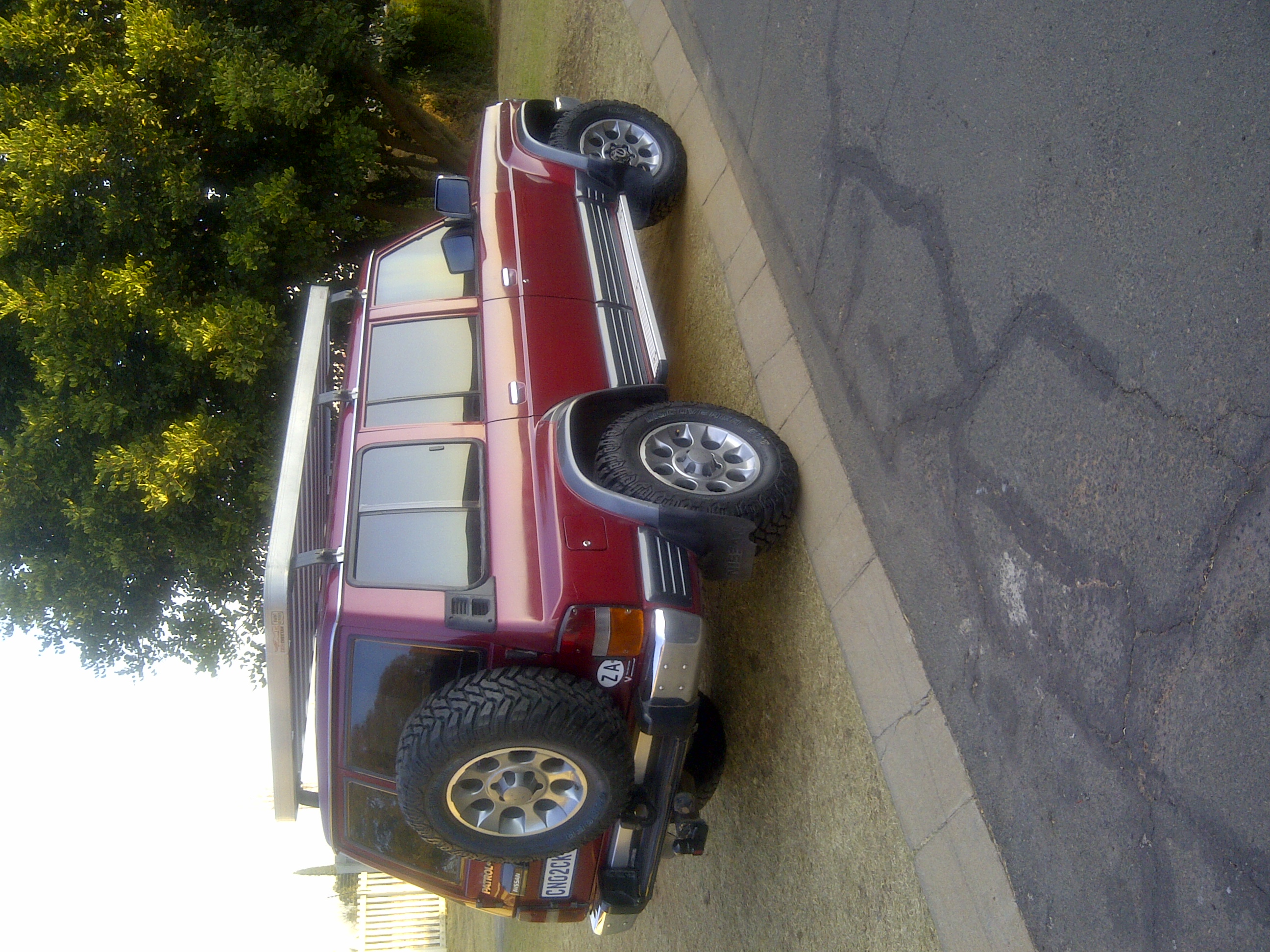

Peter Connan wrote:Andrew, the spigot (raised portion in the middle of the hub) that the wheel must fit around is bigger on the Patrol than on most others. But it's only a millimeter or two.
If the rim does not fit around this spigot, it does not sit flush against the mounting surface. Now two things happen. Firstly, it is almost impossible to get the wheels on absolutely straight (thus introducing a wobble and a lot of extra load) and secondly because the contact area is so small, it can't carry the load and starts deforming. The moment this happens, the wheelnuts are loose and then they fall off.
I have no idea as to whether Cruiser wheels fit, but certainly they can be modified to fit.

Posts: 3462
Re: GRX Second Spare Wheel & Increasing Fuel Capacity
ANDREW -- for ONE -- do not WAIT to check if that wheel seats .. do it NOW -- if it twists slightly and it's a magnesium wheel - it will break an shatterlike glass -- if it is steel it wil bend beyond use - and throw you car wayyy off aligment and f - up your bearings too
I just had the Cruizer FJ rims shaved toe fit on Thor -- cost R1050

Yours looks good, not to worry I just tested the 70's rim but put my standard on back. Not going to chance a wheel coming off again once is enough. :salute:
