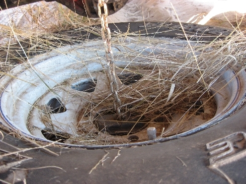

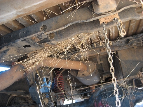

Thanks for your observations and input re the "vulnerability" of the condenser - it is a little bit of a concern to me as well and I am currently contemplating on what I should or could do to give it better protection. I was thinking more along the lines of just a deflecting plate in front of it - but that would take away normal airflow over he condenser.
It is not where we actually planned for it to go - behind where it sits now to the right rear side of the subtank there is a huge "hollowed in" piece of body work - I think this is where a lot of people would put another fuel tank. Here the condenser would have been totally "hidden" and a lot better protected - unfortunately the condenser was too big in size and did not fit nicely into that "hollowed out" area. That was the only alternative and most practical out of the way place it could then go.
So for now I think I will just test it and see how it goes - and what other concerns I might have. Then we will work from there again. For now the priority is to see how the vehicle's temperature behave - that's first prize then the rest will follow. Unfortunately the testing is a bit on hold again - we discovered my left front wheel was not turning freely whilst the car was on the lift - you really had to use elbow grease to turn the wheel. Upon closer inspection we found that the piston on the brake caliper is stuck - it is either seized already or in the process thereof. So for now the Patrol is standing at my mechanic's place.
Uncle Mac I catch your drift - but driving in grass that long I won't even consider using my aircon with the condenser in the front - just too much risk of fire in any case. I don't know if you saw the video of a guy's Prado that went up into flames from driving through long grass on a very very hot day and then he went and parked it somewhere along the line. It did not take too long for the grass to start to burn - and suddenly no Prado - Ouch!!!!
But keep them thoughts and suggestions coming - I need it and other perspectives are always welcome.
