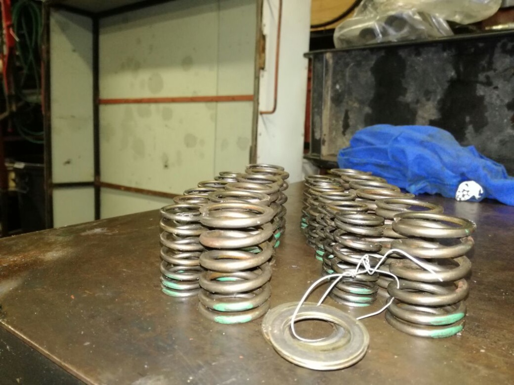

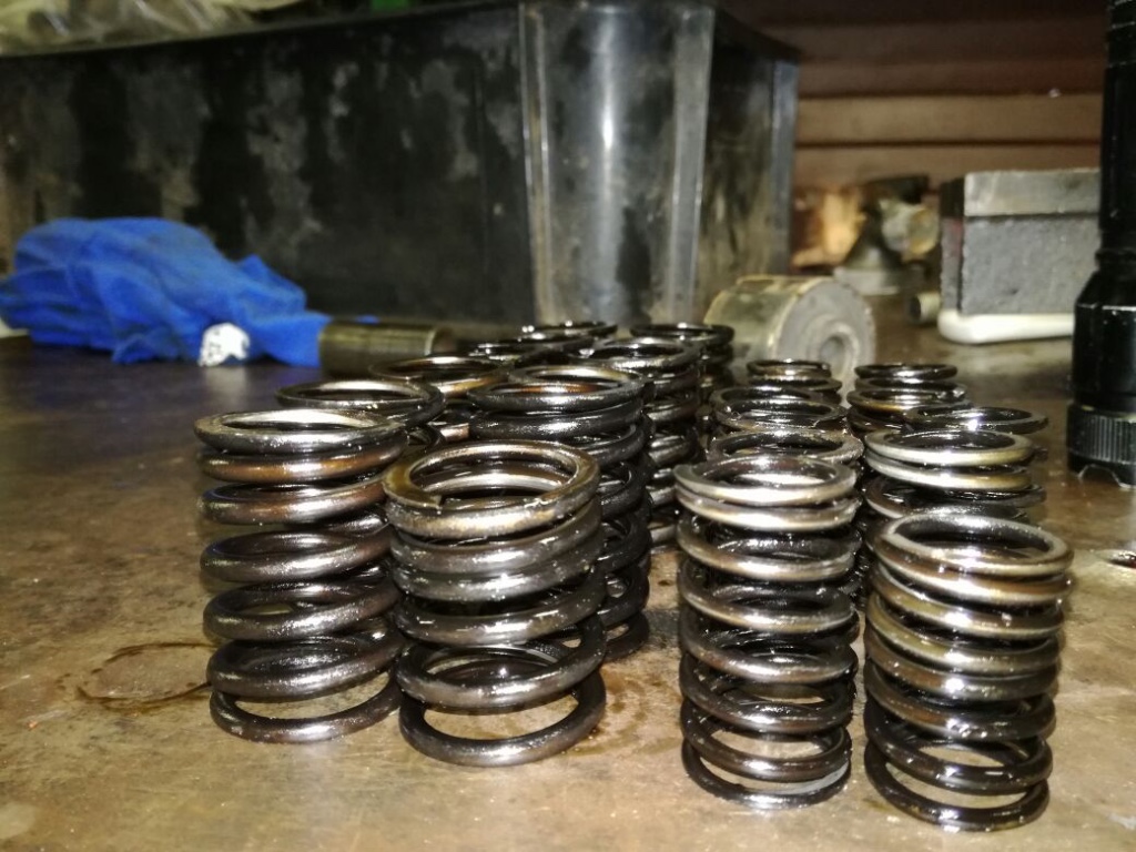

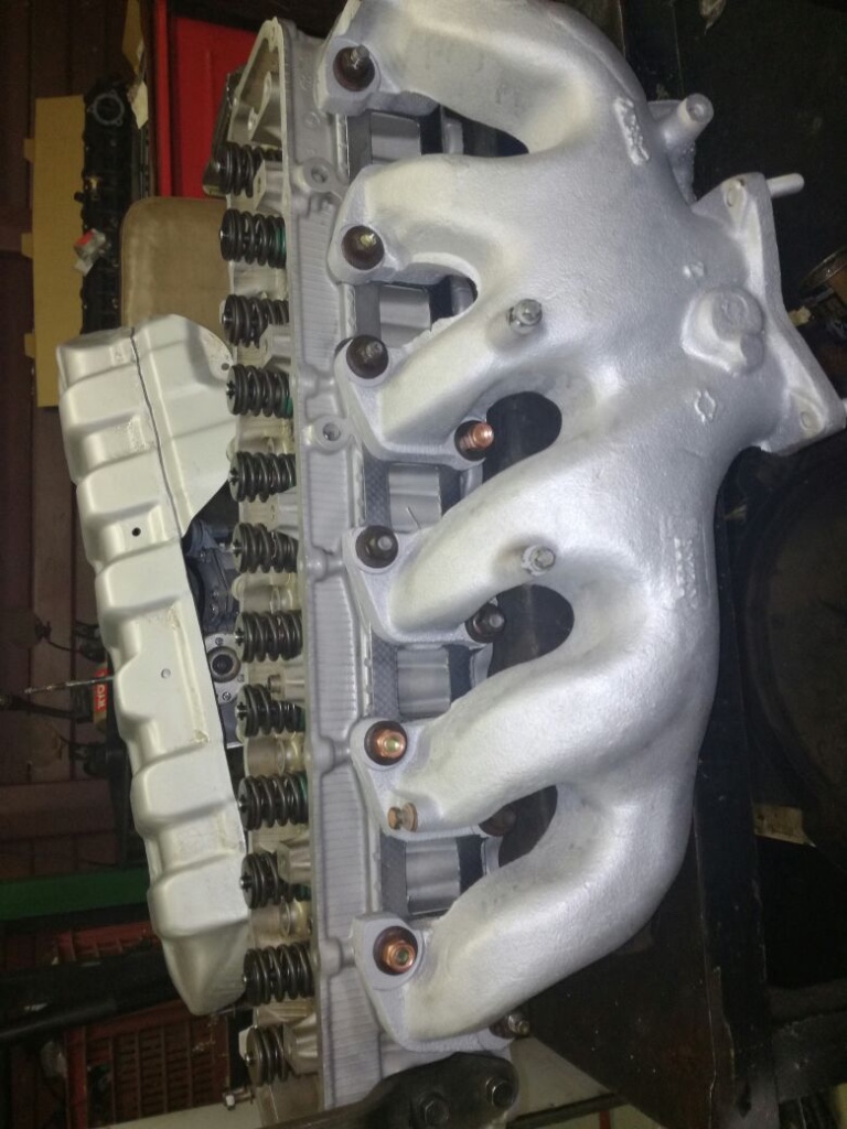

I have already posted pics of the head after being skimmed, so will not repeat it here.
The state of the valve springs were so bad the Graham does not know how the car was able to fire on as many as 5 cylinders.

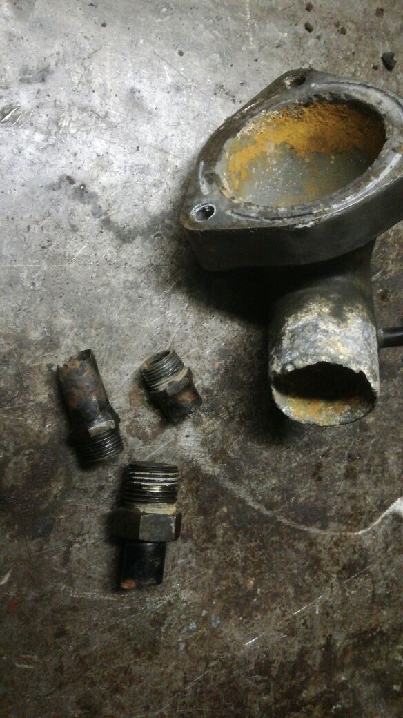

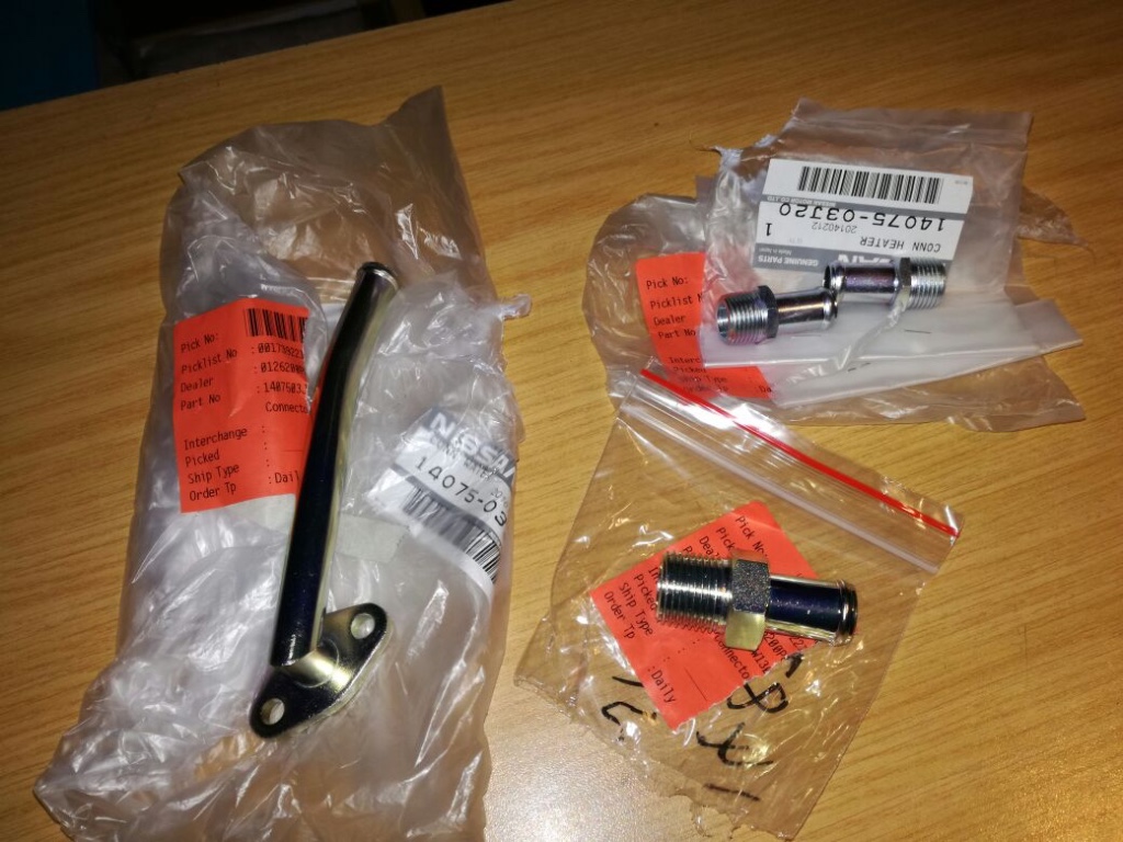

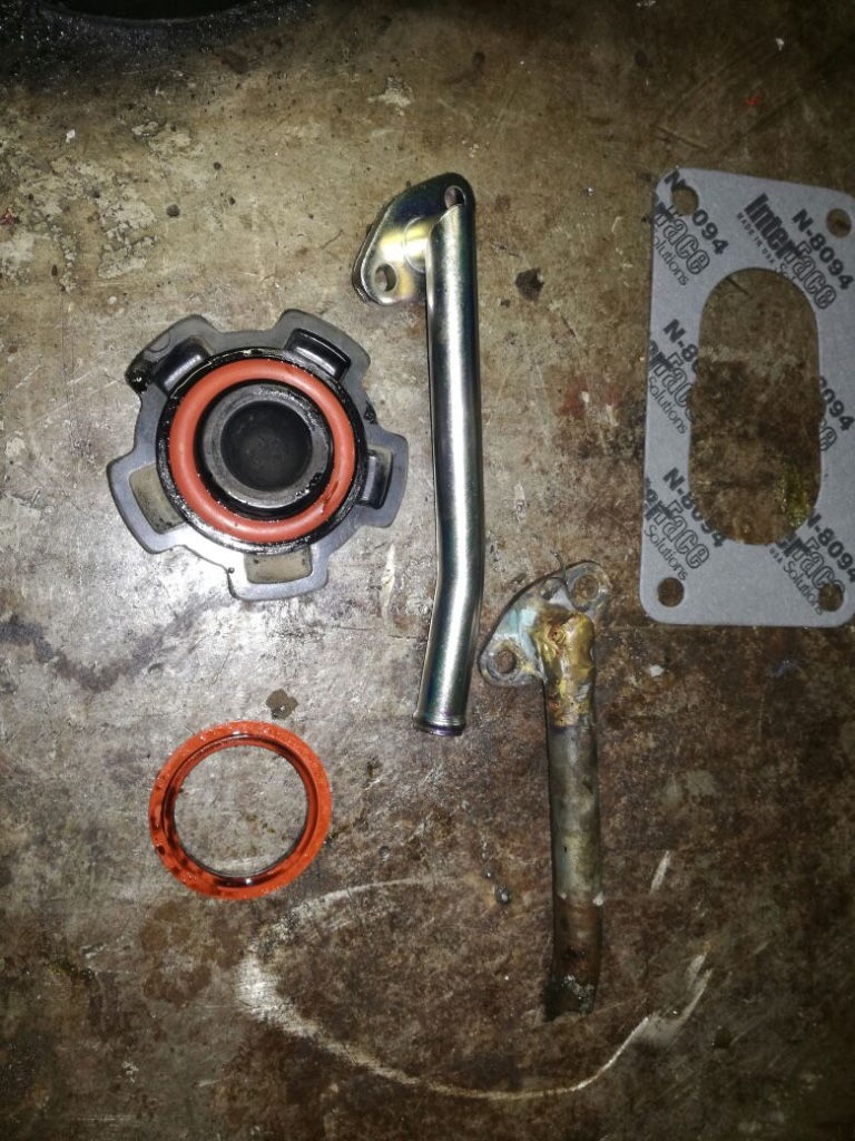

For the thermostat housing, a new one could not be sourced, but fortunately, Piet still l had his from his old TB42.
That, as well as a funny shaped pipe (looks a like a Questionmark) I also got from him.
